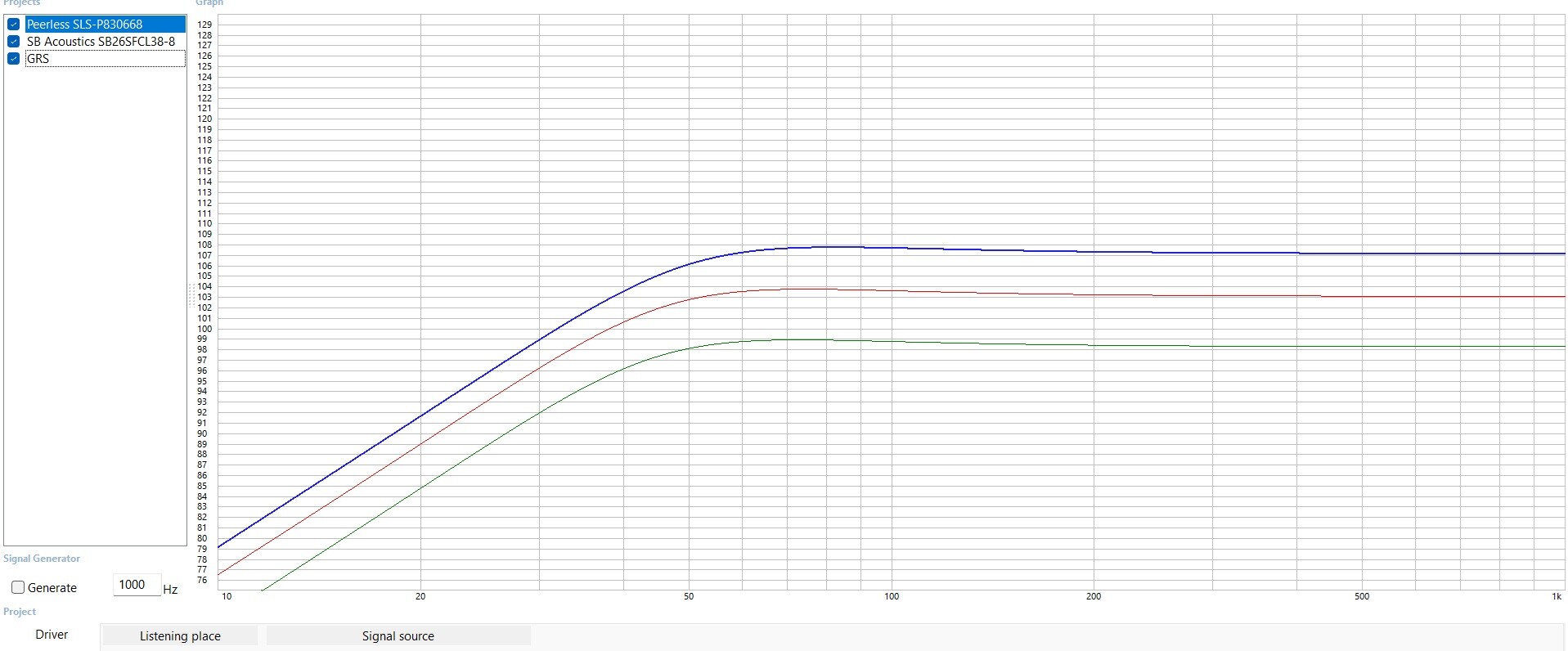

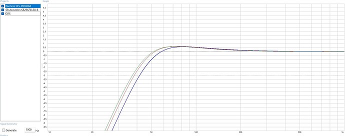

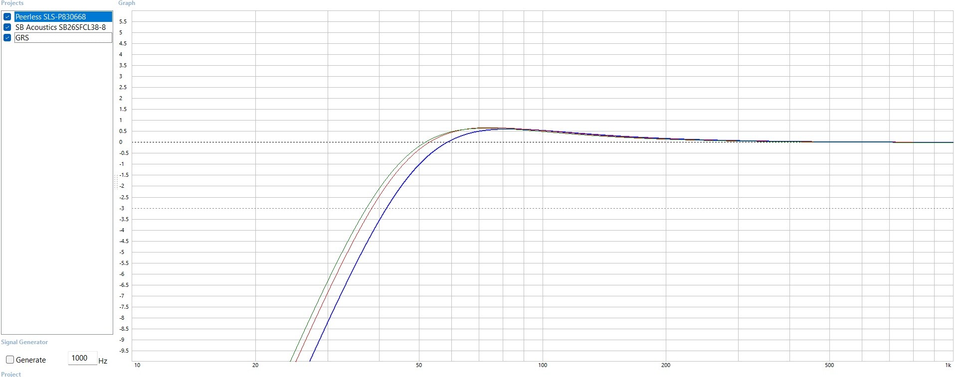

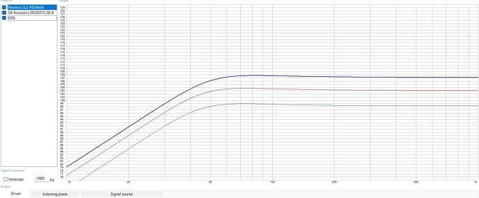

Here is a plot with the 3 woofers. First image is the transfer function, the second is the max SPL before xmax. The SB is red, GRS is green, and the Peerless is Blue.
What does excursion and SPL look like at 10, 20, and 50 watts?
All 3 have similar output at the different wattages. They are similar sensitivity. The big difference is xmax which the GRS has 5mm, the SB has 8.25mm, and the Peerless has 10.8mm. The peerless can take a bit of power. I really curious if anyone has actually listened to any of these. I know the peerless were used in the Tarkus, and the SBs have looked interesting since they came out. The GRS was just another one that modeled well in a sealed enclosure.
