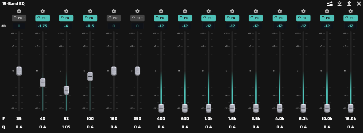

One last thought - you REALLY want to XO to a sub for the above experiment as it will be easier to remove the high IMD from the bass response to your ears/room this way - less cone travel with competing frequencies = less mud introduced via IMD.
Every frequency range delivered to an appropriate drivers’ capabilities with minimal phase shifting.
My in-room Sub PEQs:
Yours will differ for sure but it stands as an example of how to get clean instrument sound - even at low frequencies.
Looks like you have the same room mode I have, around 50 hz.

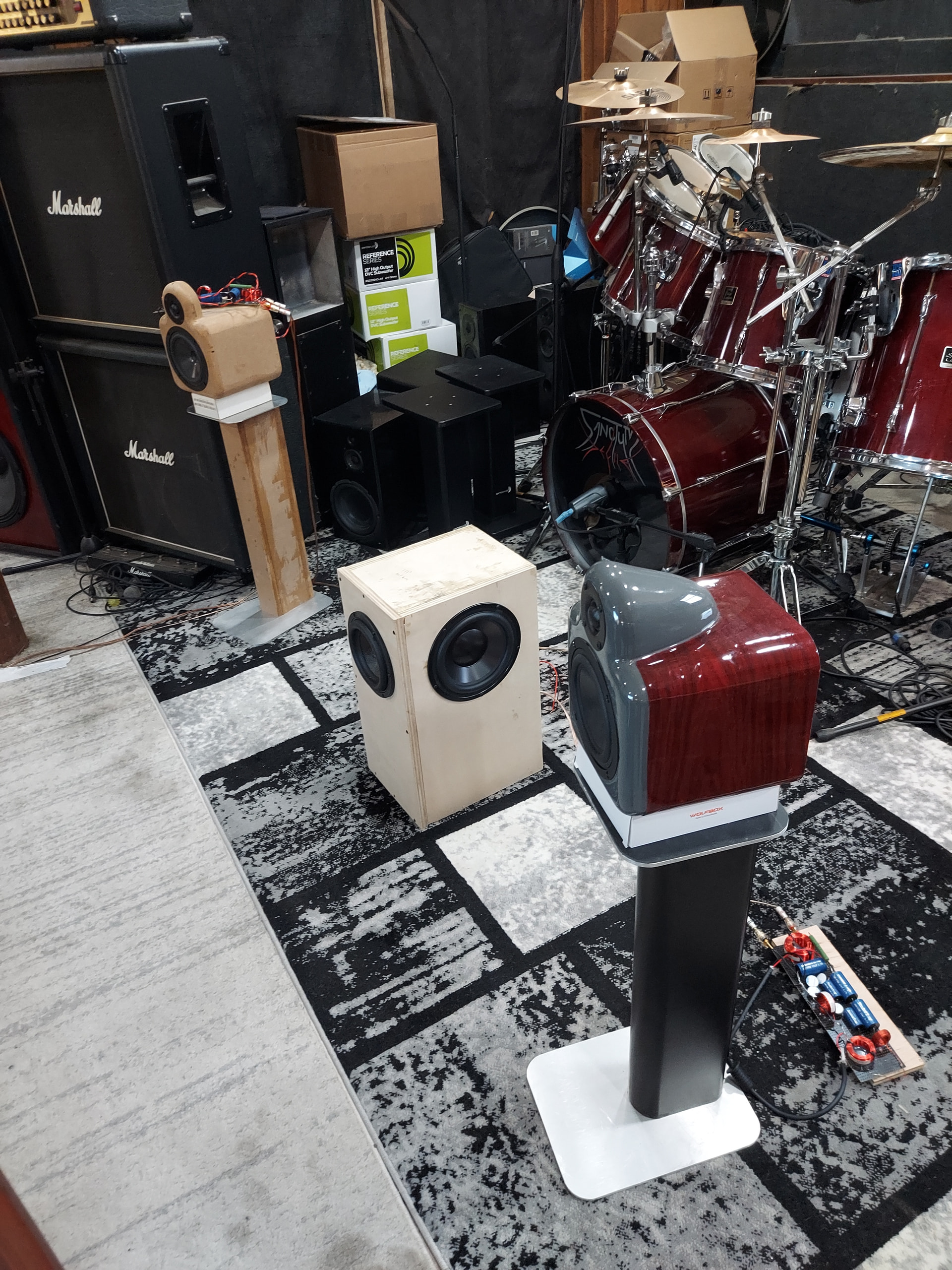

Brought the mini satellite speakers out into the big room along with the mini sub. First version I played sounded horrible and I thought, " man, that tweeter is way too hot". I tried another version and it sounded perfect.
Neither one said what version they uploaded. Remasters really cause problems.

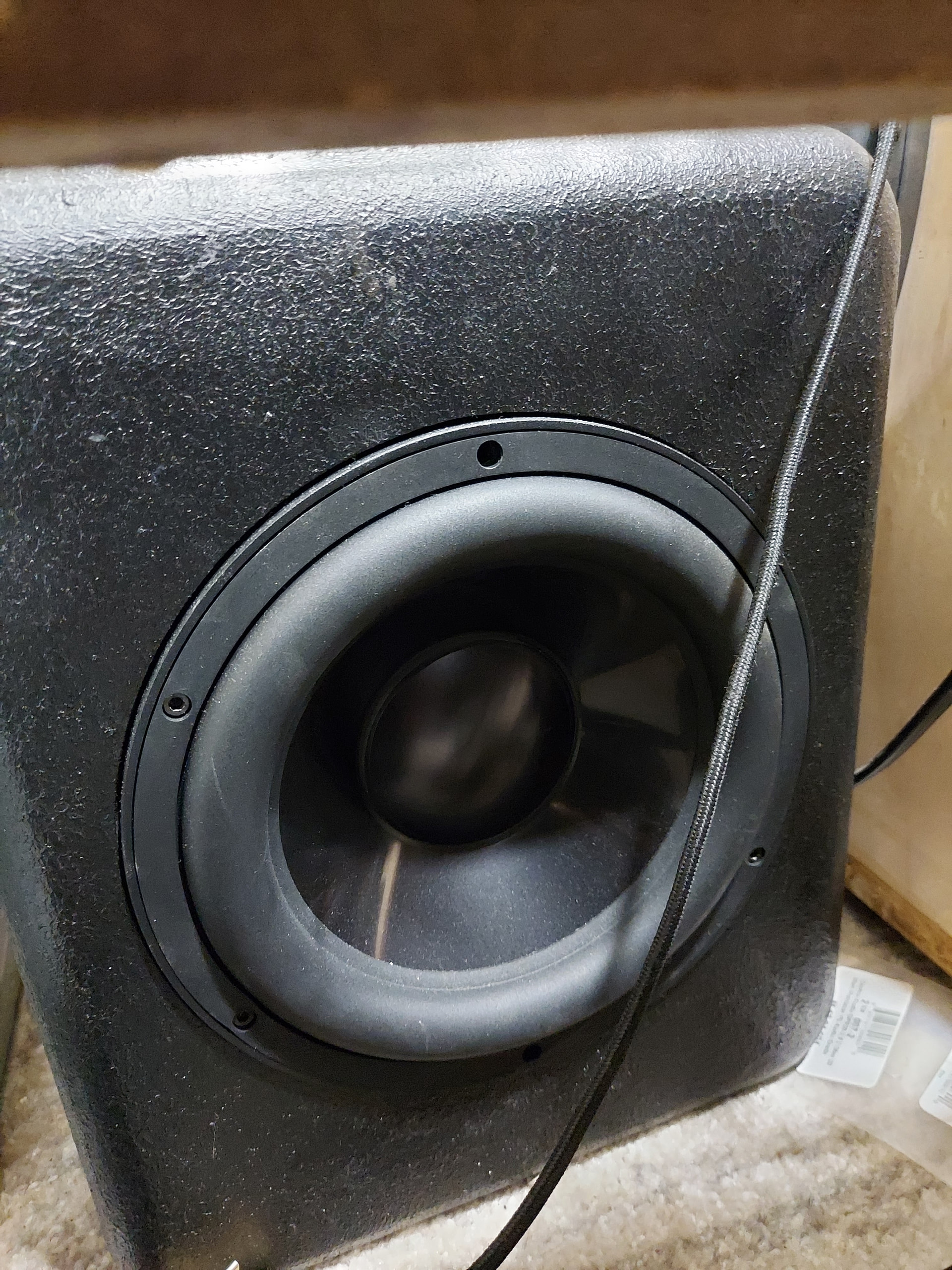

The sub with the Sats are not hooked up yet. Just got the E180HE-44 to compare to the RSS210HO-4.
Also, realized I made the stands too short. You with notice boxes under the speakers, lol!
