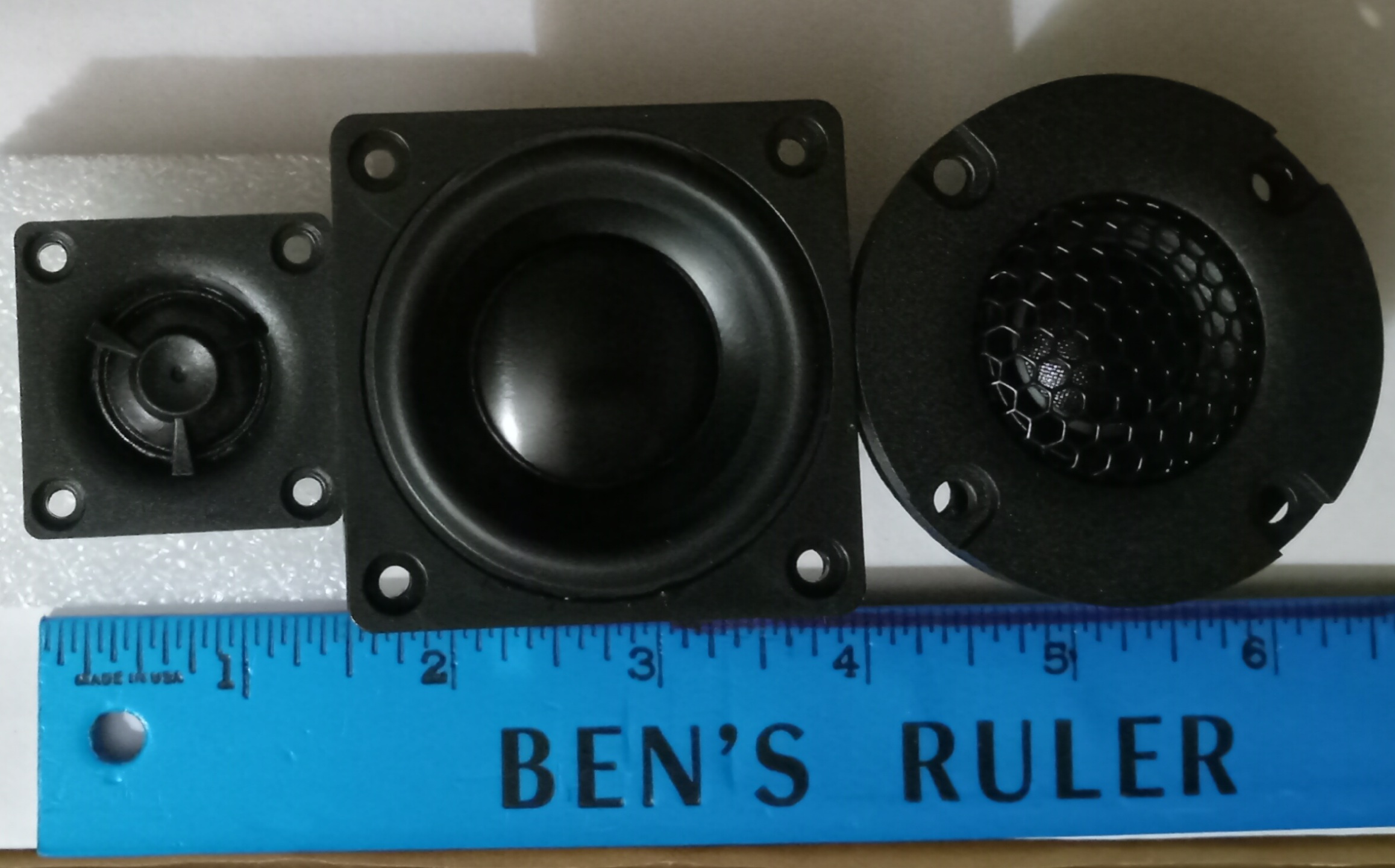

Now, I have to find out whether or not the CE35 passes the measurement tests.
The midrange has a bowl shaped cone, which i did not expect.
Aesthetically, the CE35 looks better, and I will likely not flush mount the drivers.

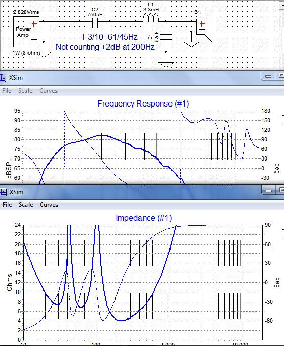

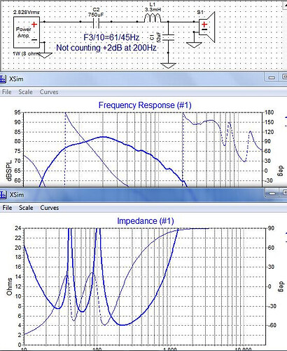

…made this some years ago , pardon the bad pic quality…It is a 3 way with NE19 tweeter , the CF120 plays down to 100Hz in a sealed section (Q = 0.5 ) the bottom of the cabinet is divided into 3 sections with 2x 5 1/4 inch (top and bottom) mid-bass firing up and down , the middle section is ported out the back ie bandpass 4th order. (The xover is at +/- 2.5K )
Brian Bunge? Thanks for the comments. I know JohnH thought it was more trouble than it was worth due to the double hump in response. However, I am not likely to use it above about 850-900Hz range, handing off to the 2" midrange. This means some of that will then be out of band and less of an issue.

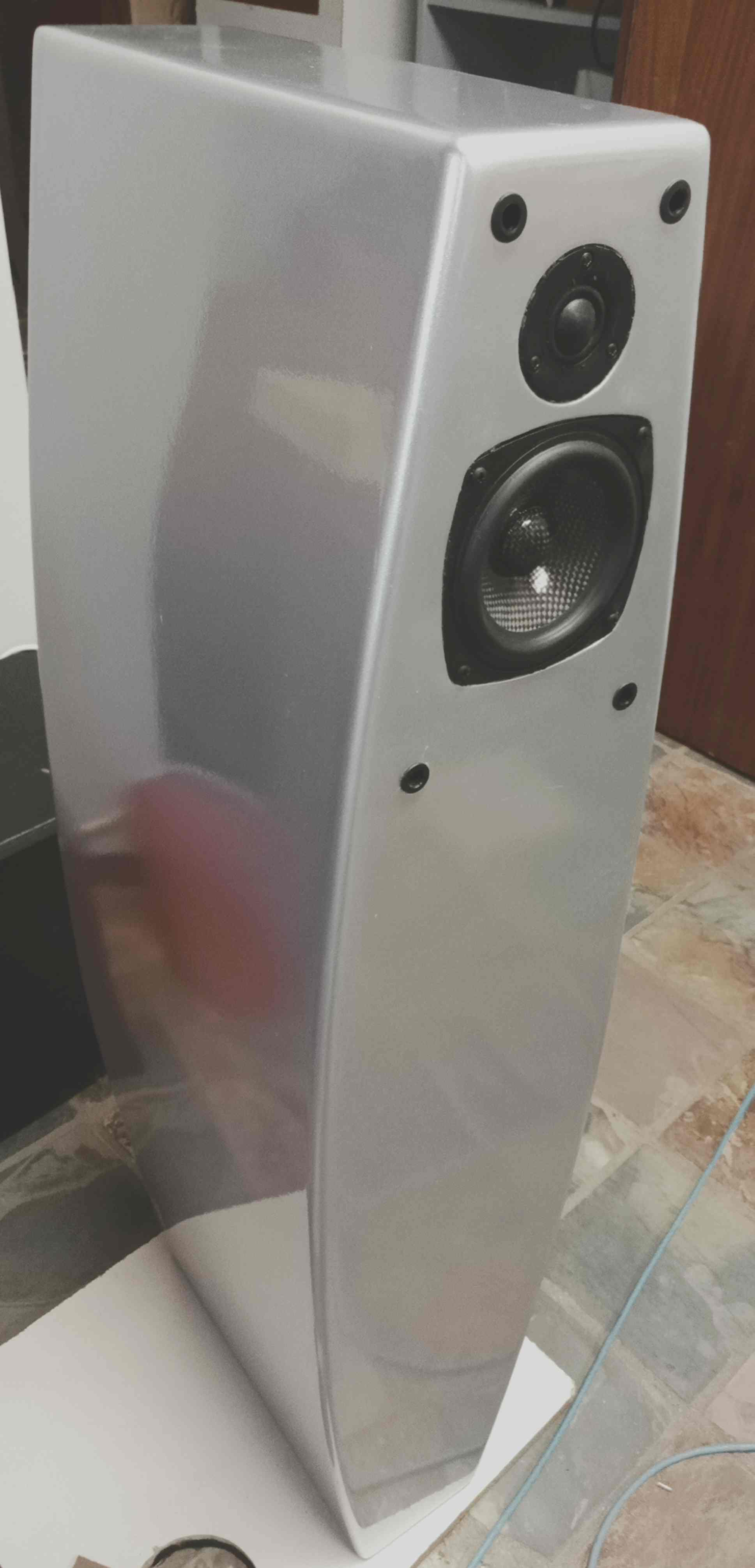

Oof. Looks like it’s got a usable range, but don’t know whether to call that a cone tweeter or a ring(ing) radiator.
I really like the curved, clean shape.
Curves good
