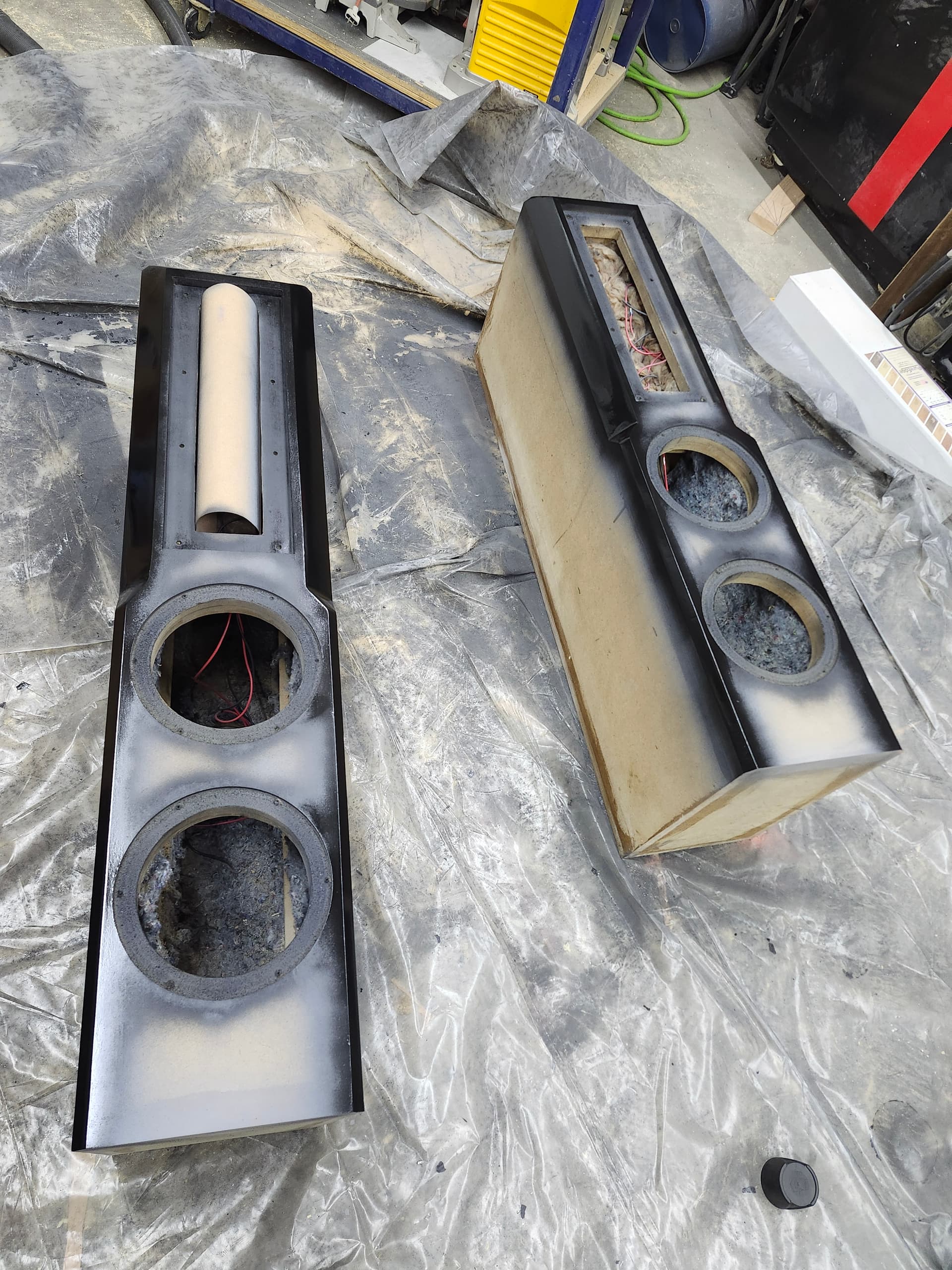

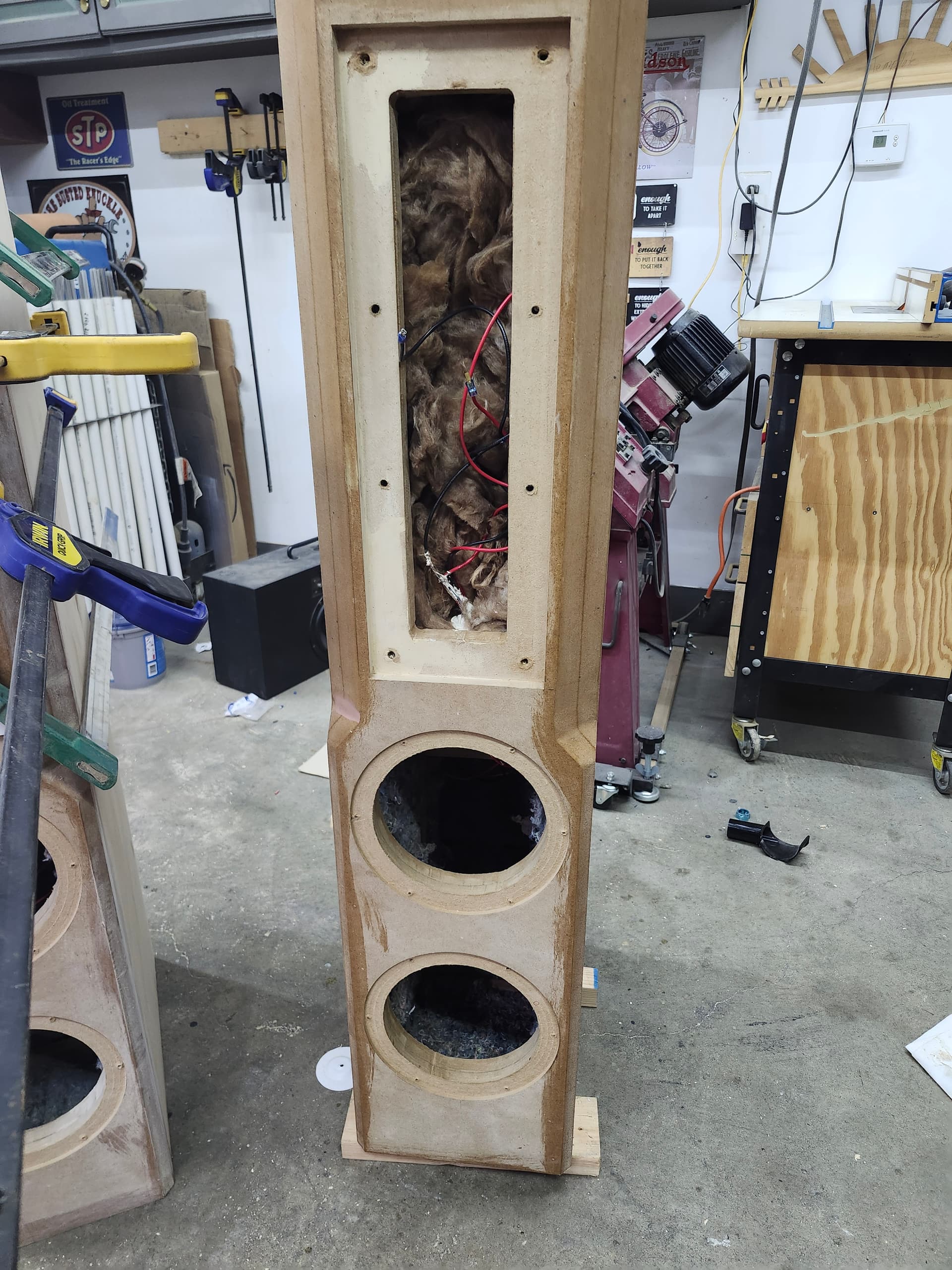

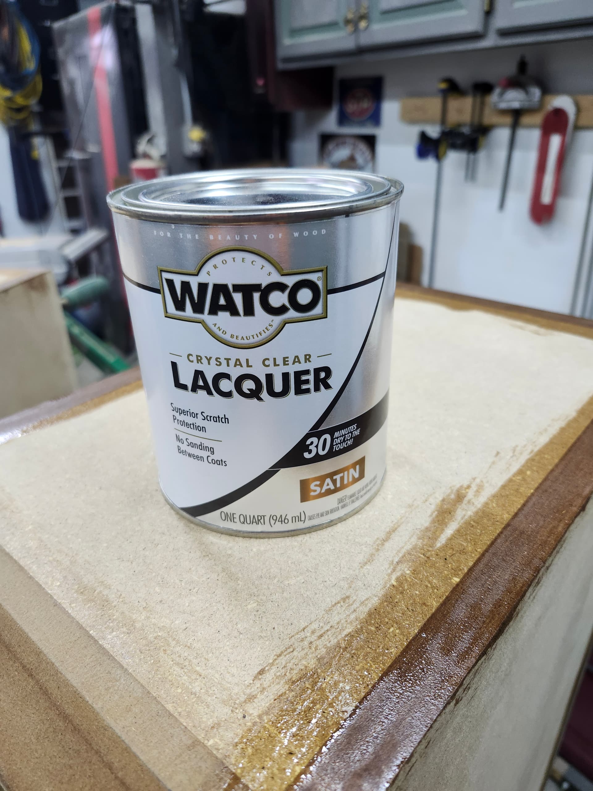

I am trying something new to prep the MDF edges. Its Watco lacquer. So far it seems promising.
I’ve used cheap shellac and cheap poly to seal MDF’s end gain with good results. My wife almost shot me the last time I used a lacquer based product in our garage lol.
Its stinky, but my shop is in a spot that it won’t bleed into the house.
I’m jealous!
I recently saw that General Finishes has a water based Lacquer. I think I’m going to try it in the spring.

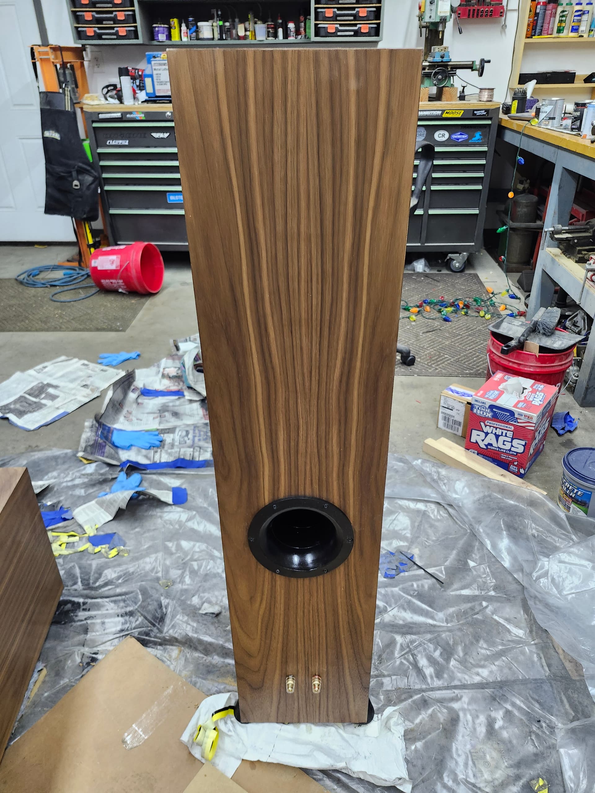

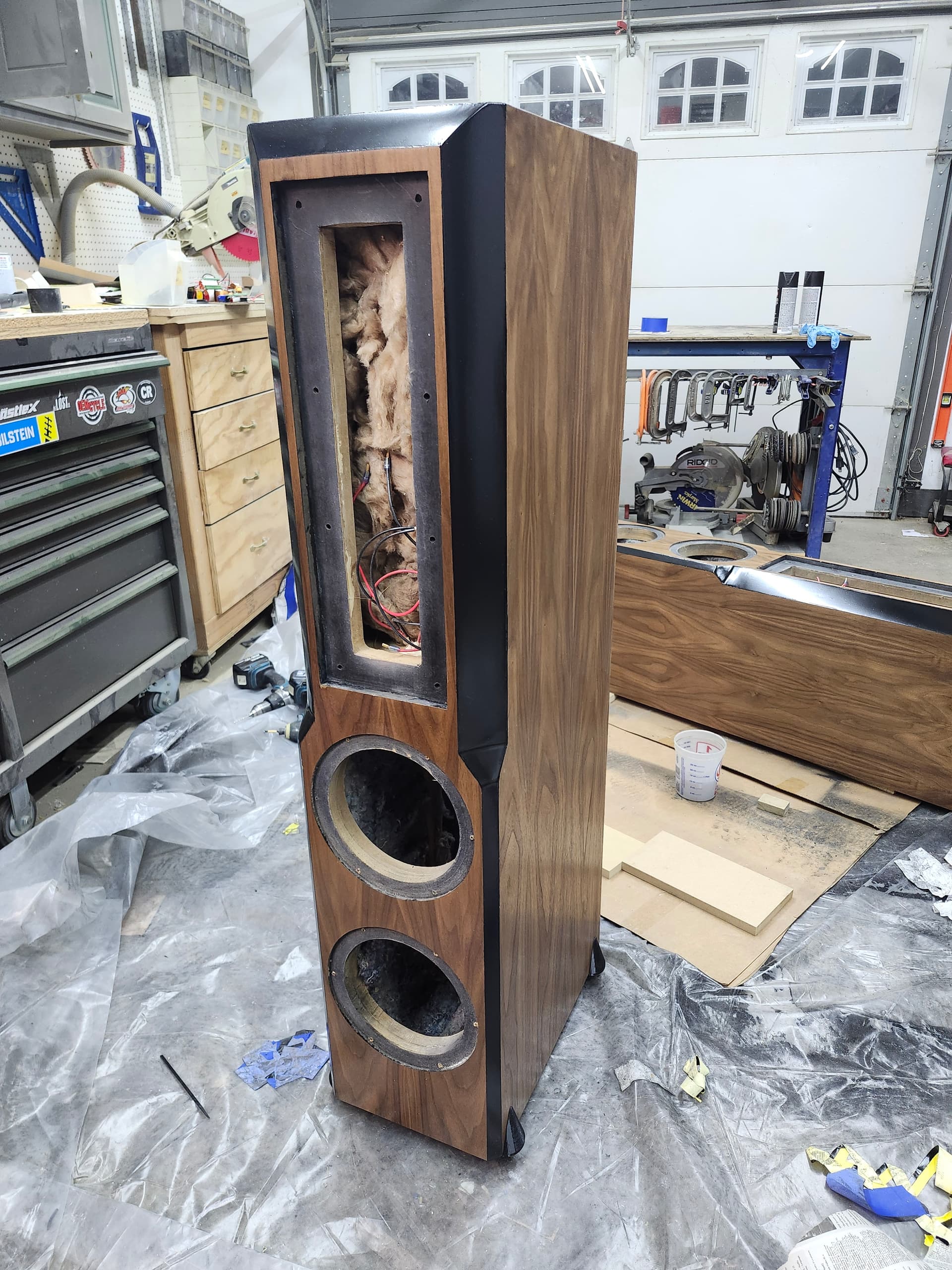

I am painting the angles black, and the rest will be walnut veneer.
I am getting the veneer polyed and getting the crossovers installed in the cabinet.

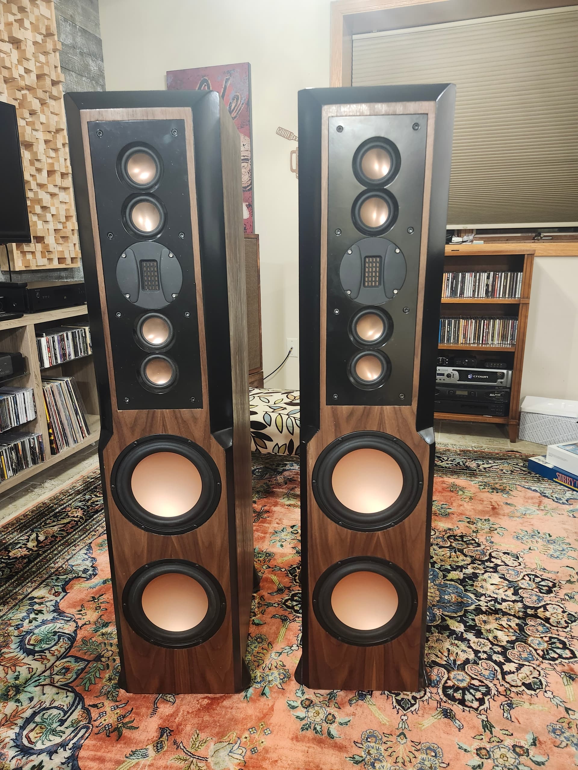

What was technique to shave the veneer overhang and not damage paint? At first thought maybe those Japanese (wrong name) flat saws. In past I would often lay veneer first and then mask off and do painting. Heat glue method?
If you mean Kevin Kendrick’s method;
He used a spiral rotozip/dremel bit in an air powered setup and just lightly grazed the edge. A minor sanding and he was done. There was a video over on PETT with regard to his Gandalfs line array build.
I use a razor blade flush to the surface to score the back side of the veneer and then break it. I then go back and sand the edge. I found I am more accurate that way then with a router. On these I repainted once the veneer was complete.

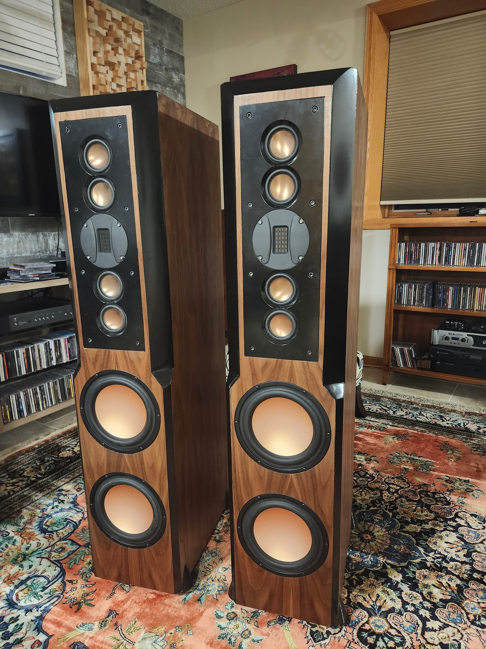

I got them assembled tonight, and they are giving me some Legacy Audio vibes.

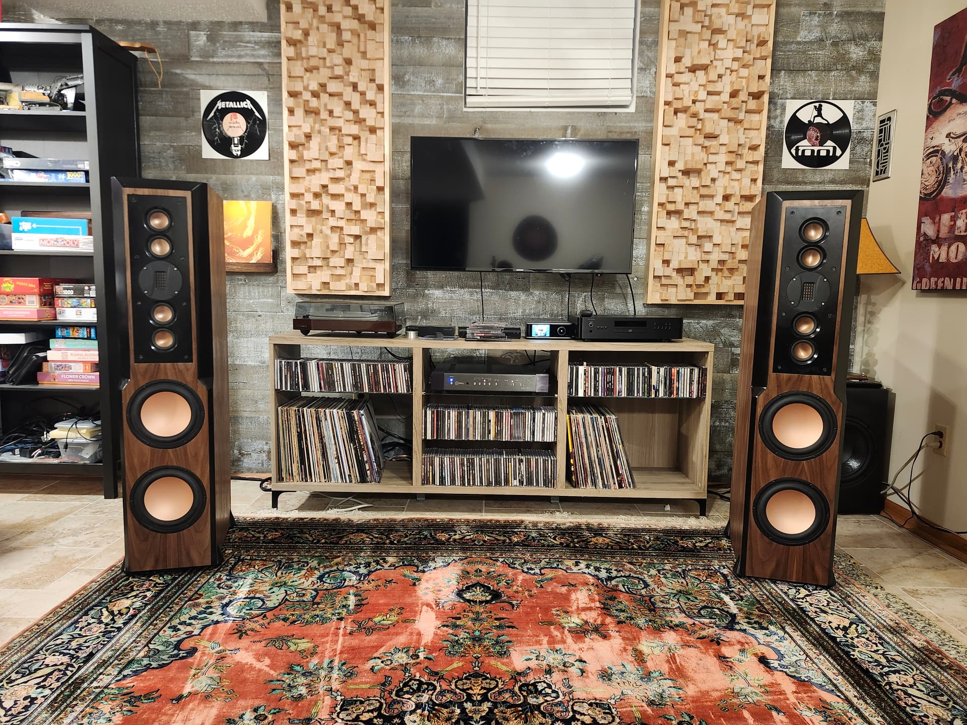

In place and sounding amazing!!
