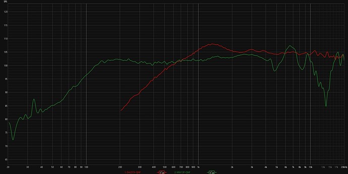

For comparison in the same setup, here is the Satori MW13TX 5" midbass and the Peerless DA25TX. Not necessarily a fair comparison since this setup costs a bit more (and I should have done the off-axis measurements on the coax) but this is more like something I’d like to work with. And so it shall be!

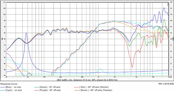

I wonder how much difference there is in the squigglies of SBA’s and Dans nearfield measurements?
SBA’s are on an IEC baffle board at 14.2" = 31.6 cm.
I really want this graph to be true . . . .
You can trace the on-axis curves and then simulate them for baffle diffraction in VituixCAD. I don’t remember the steps, but I bet if you ask AI it can walk you through the steps.
