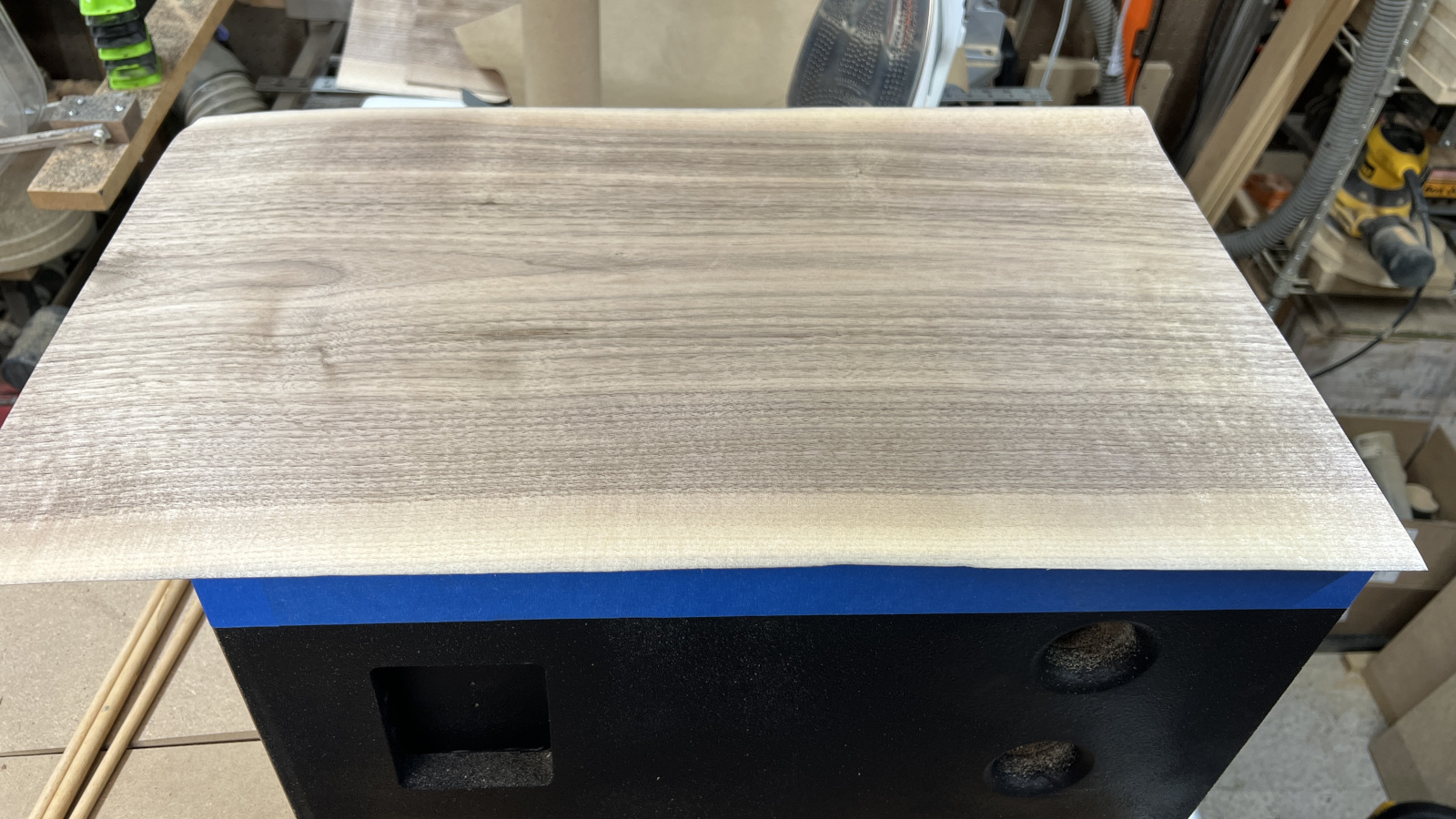

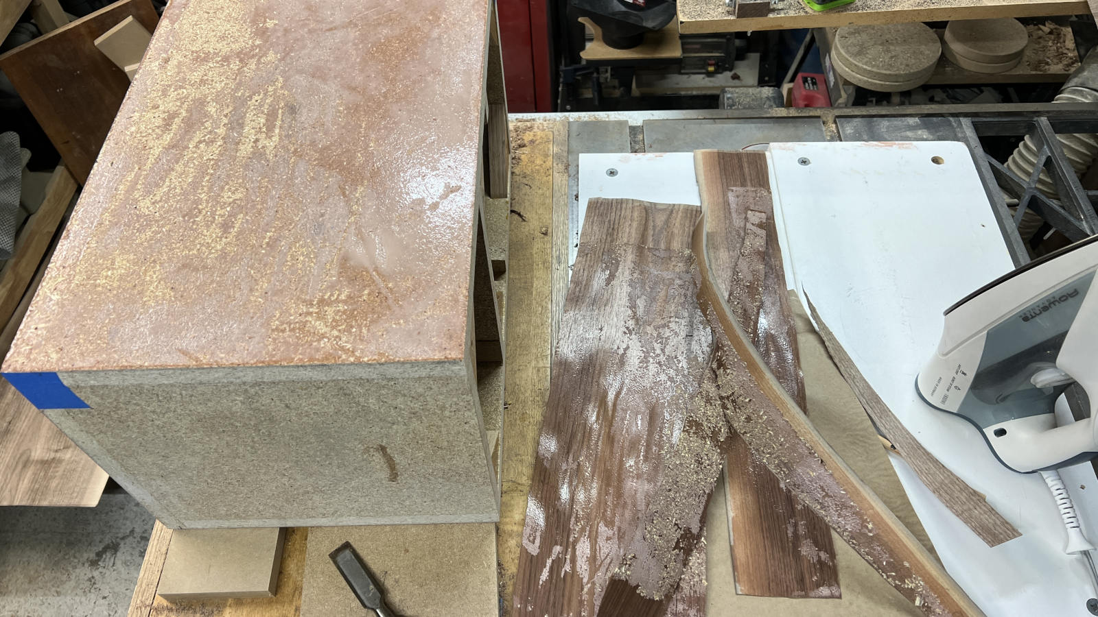

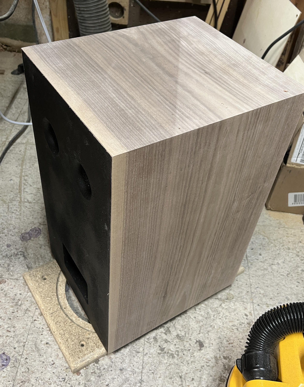

Glad I bought more veneer than I needed. 1st cabinet was a bit of a struggle but it’s done and ready for the baffle to be trimmed. Not perfect, but it’s passable. This second box has 2 sides veneered and I thought I was rounding 3rd when I realized I had misaligned an edge by a mm. Glue was still tacky and it grabbed immediately despite not even touching it with the iron. Lesson learned and I figure I’m only out ~$10.00 and 30 minutes of work.

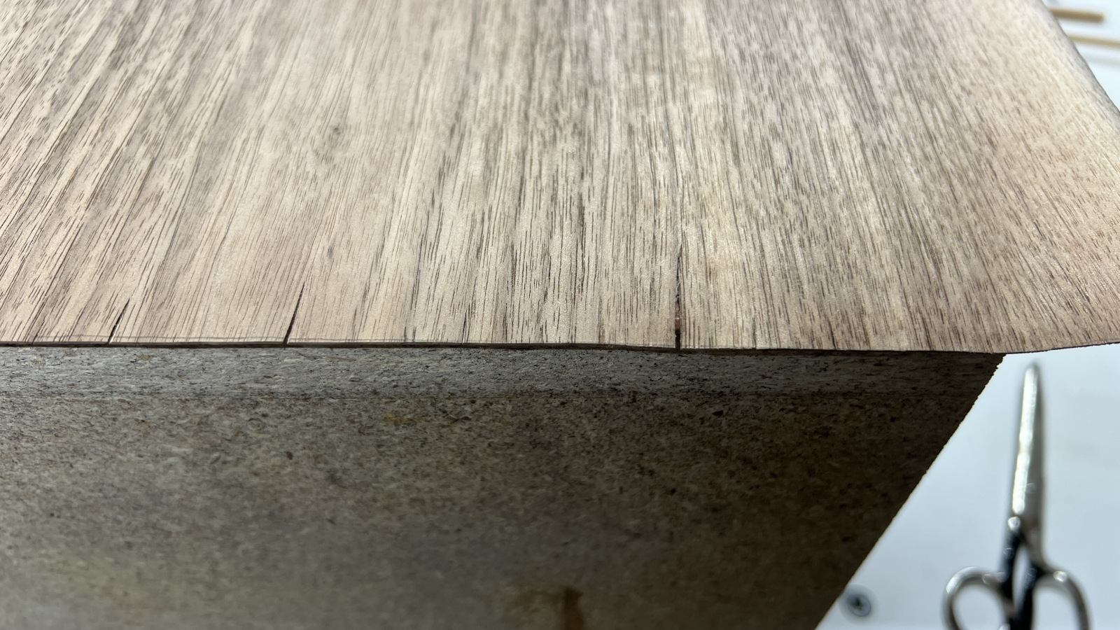

Much better outcome tonight. I have a few minor cracks to fill, but at least they’ll look presentable from 5 feet. This has been a good learning experience. I was using too much glue on the veneer, causing it to ripple. Softener did too, at least with these pieces.

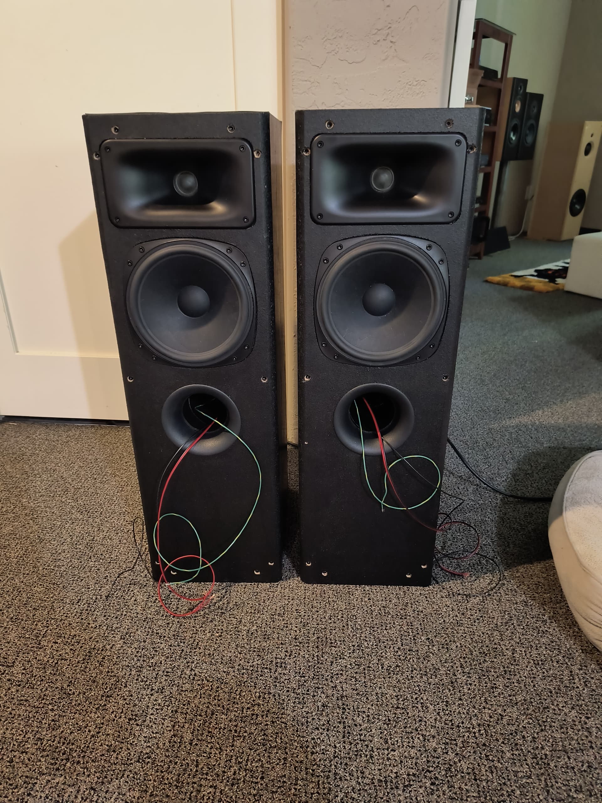

There is still some hope that these will be ready. I’ll be there either way.
Those look fun Dr. Scott!
