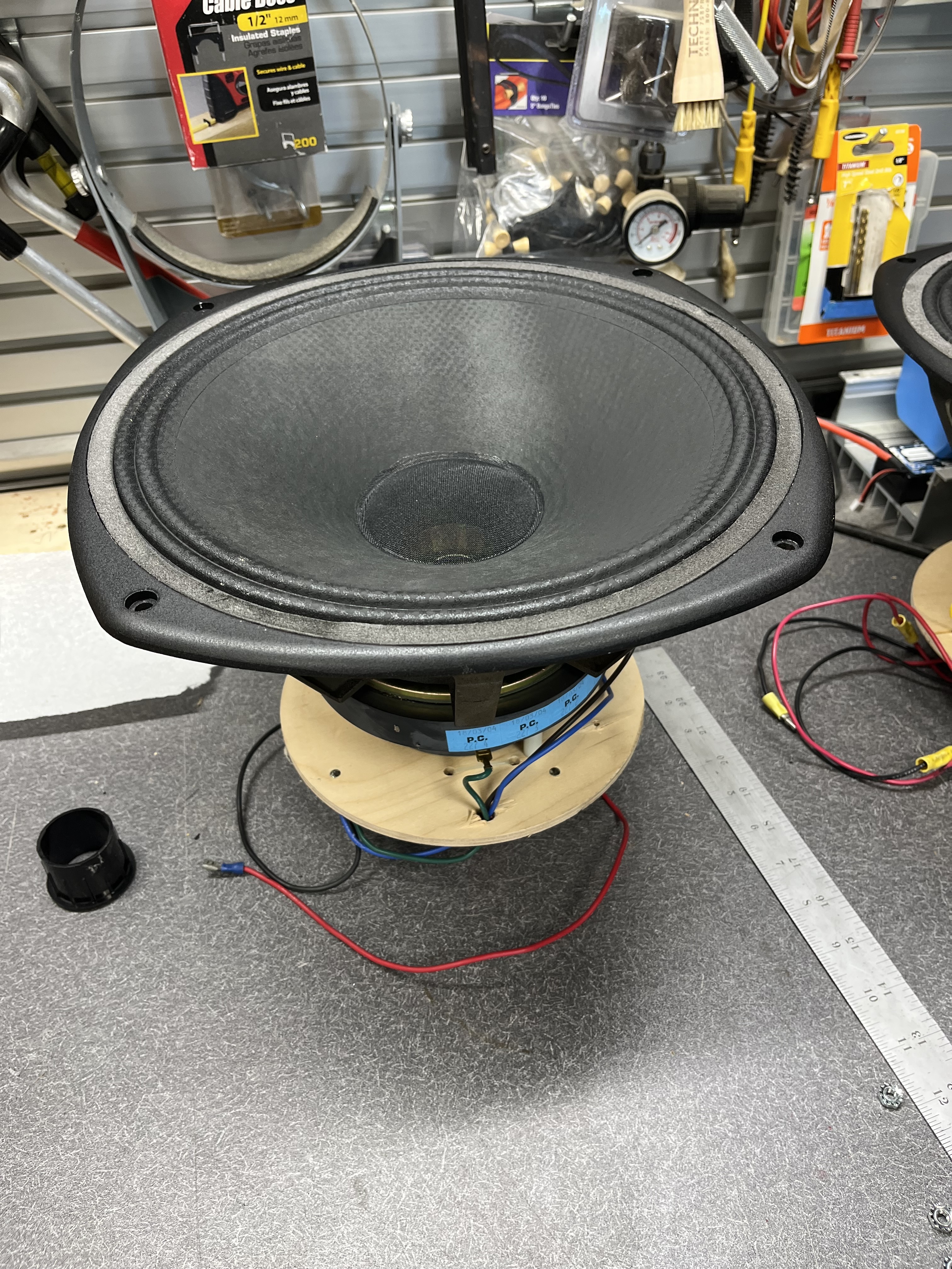

Well it’s a few weeks since the PE gathering and the bug has bitten. I’ve been wanting to do the coax thing for years and after a brief chat with the coax king, Mr Jones, it’s happening.
I have been holding out for an R series KEF driver for to long now, nothing has came close enough pricewise for me to bite. I’ve also been checking out large format coaxs too. Faital, B&C, and Beyma have really nice offerings…at a steeeeep cost, likely around what KEFs were going to cost.
But AJ hinted to a company I obviously knew about, but didn’t really consider because of what I thought would be cost prohibited… Tannoy.

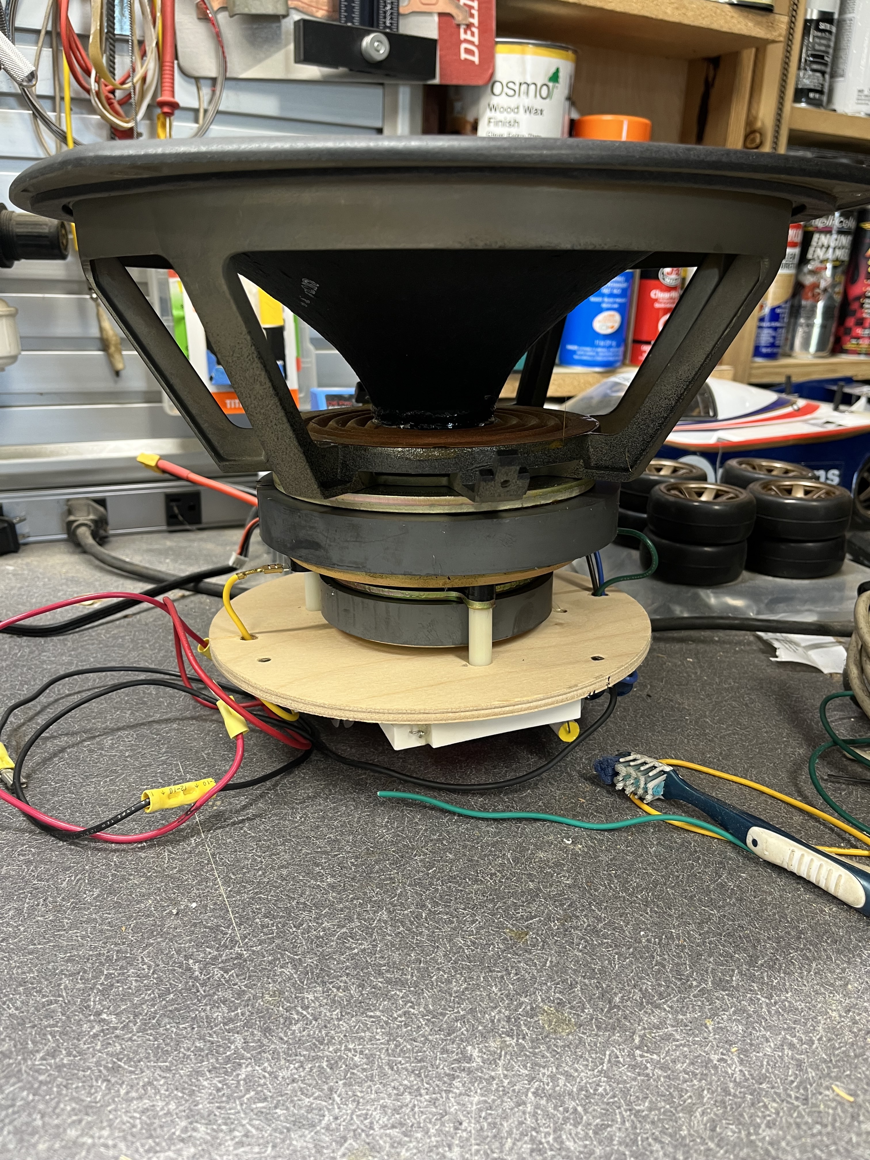

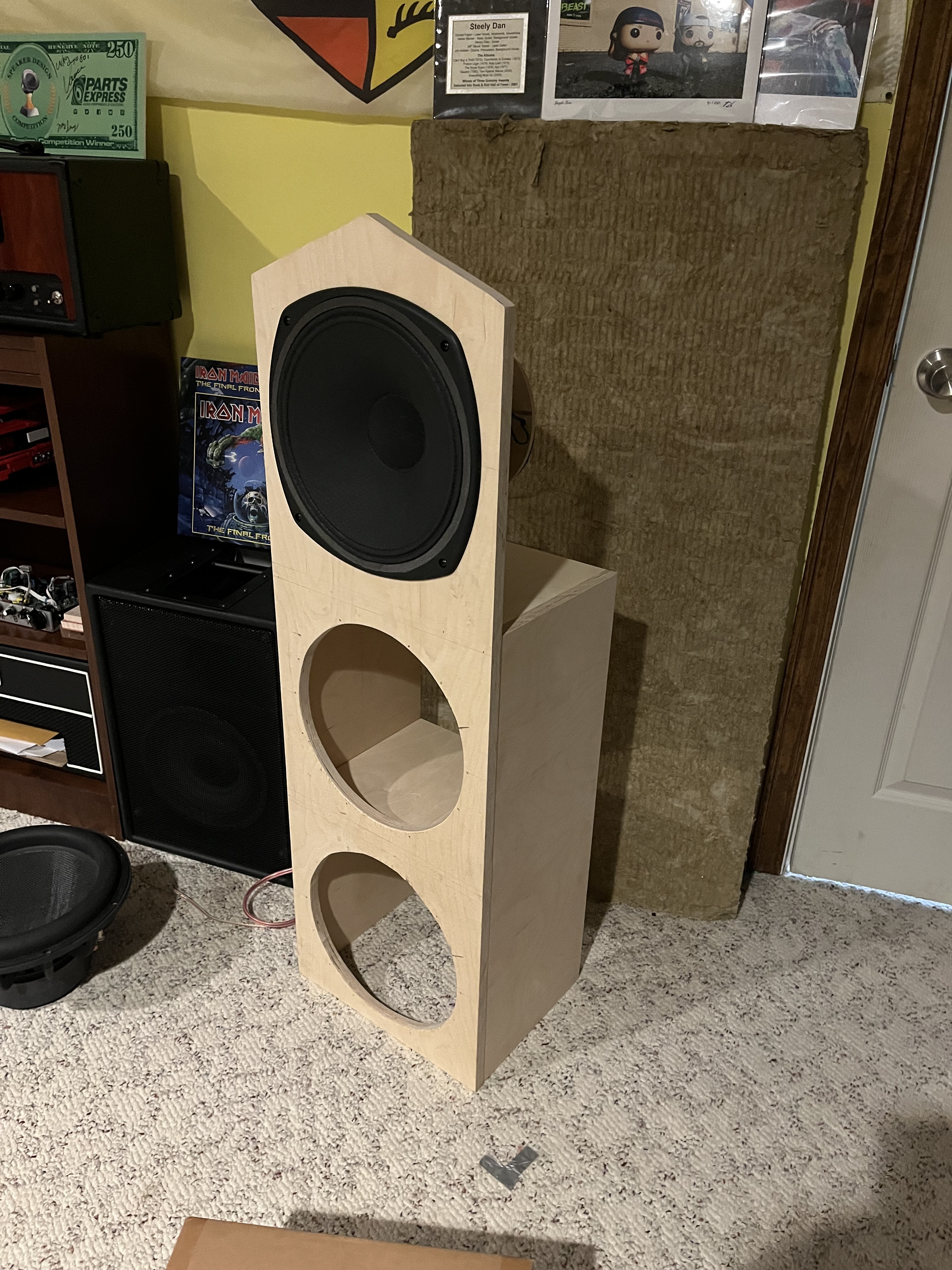

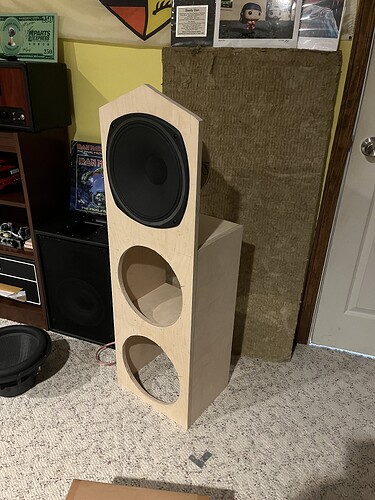

So I searched a bit and came across an eBay seller that had a bunch of these coaxs that are for overhead paging and background music.:flushed_face: What company buys 12" Tannoy coax drivers for that?!?!?! Anyway, made the deal and jumped in both feet. Let’s get this party started​:sign_of_the_horns:t3:

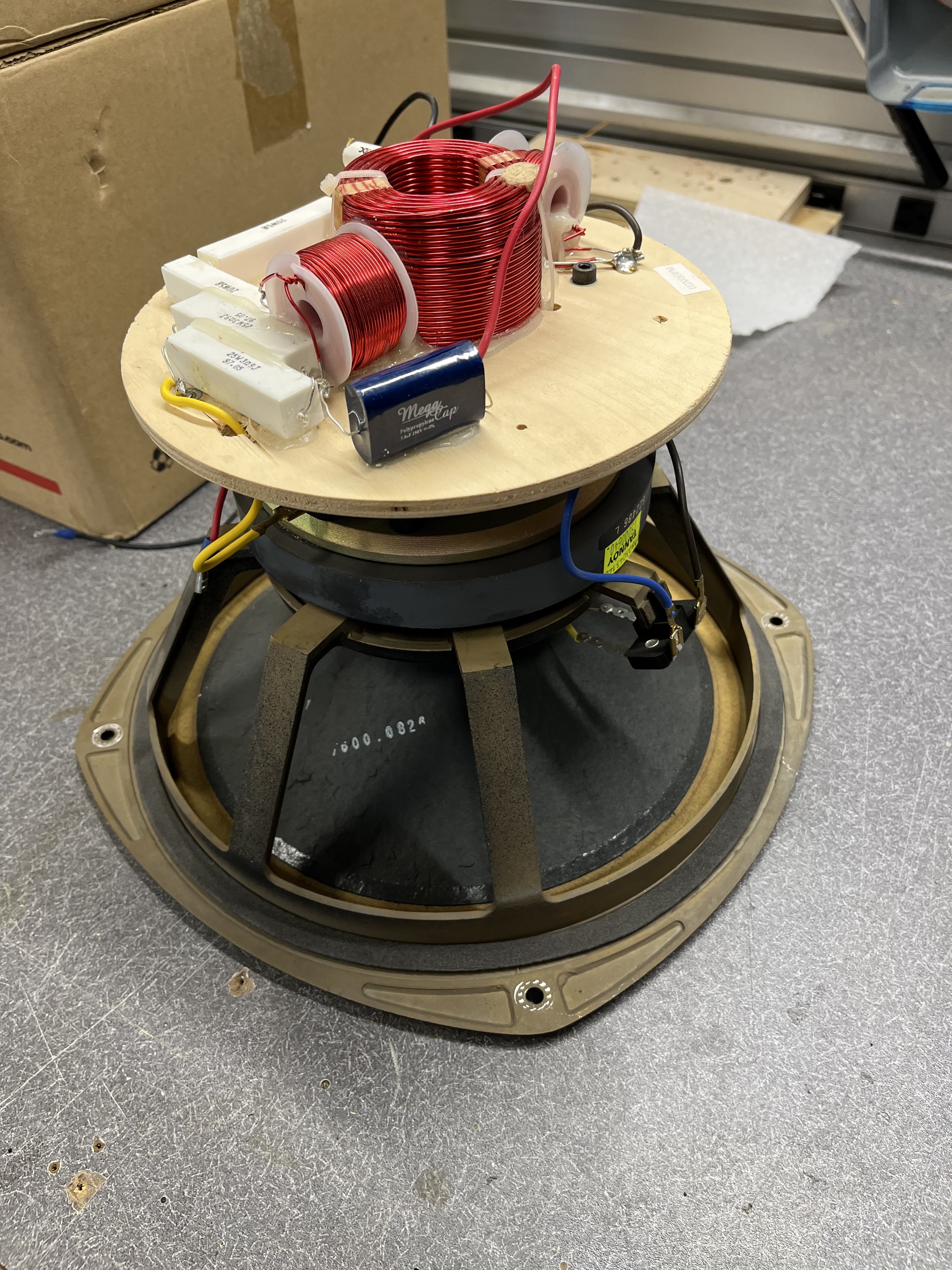

That’s also a massive coil, have you found info / review on the original crossover?
It’s a CMS 12 TDC of which I couldn’t find much on, the CMS 1201DC is apparently a newer version, but the xover on it doesn’t look like this one.
The xover is ok, not great. I just got done listening to them solo, had to EQ to compensate for the OB situation, but otherwise they sound pretty good. Once they’re fully DSPd I can imagine they’ll be quite nice.

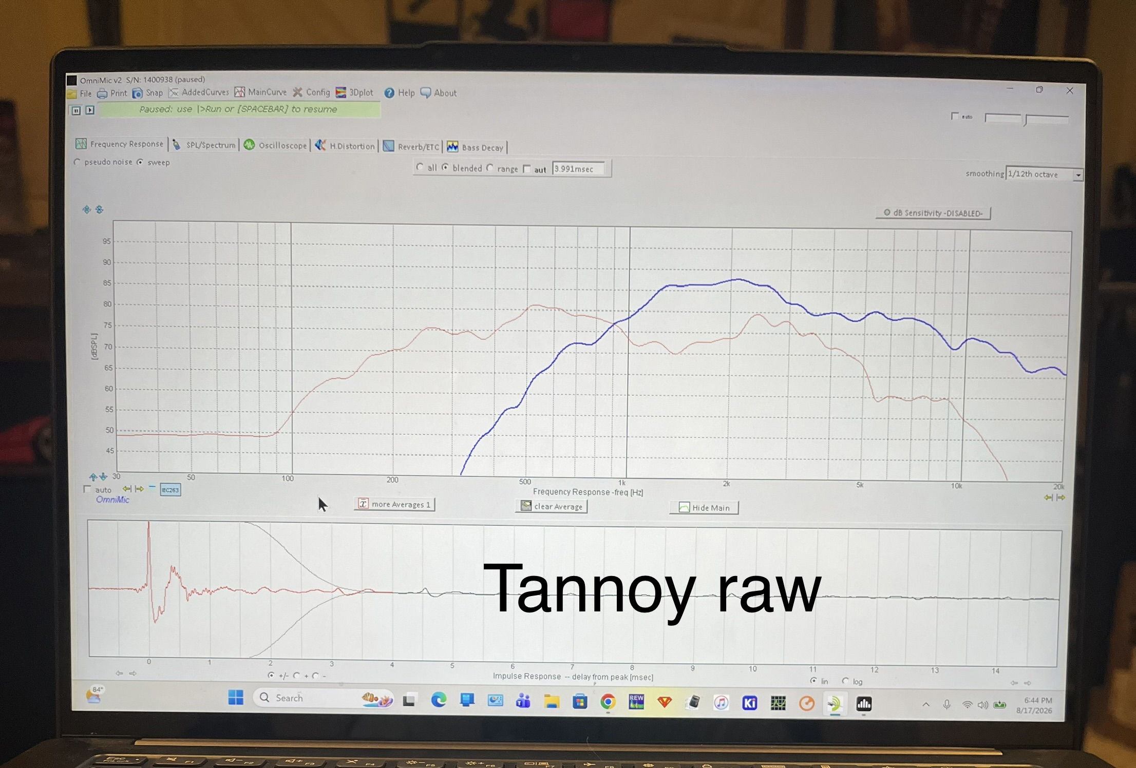

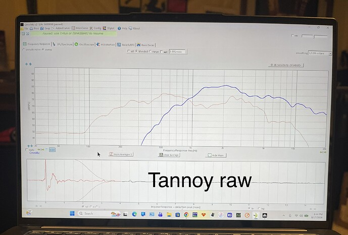

Here’s my quick measurement
The hump there at 600 is baffle/OB/ room. Otherwise, some mild breakup on the woofer and a decently mannered tweeter.
Threw the Ultimax units in to see if they would alter the coax FR. Negligible, so all good there. Waiting on some cables and connectors to get the active set-up going.

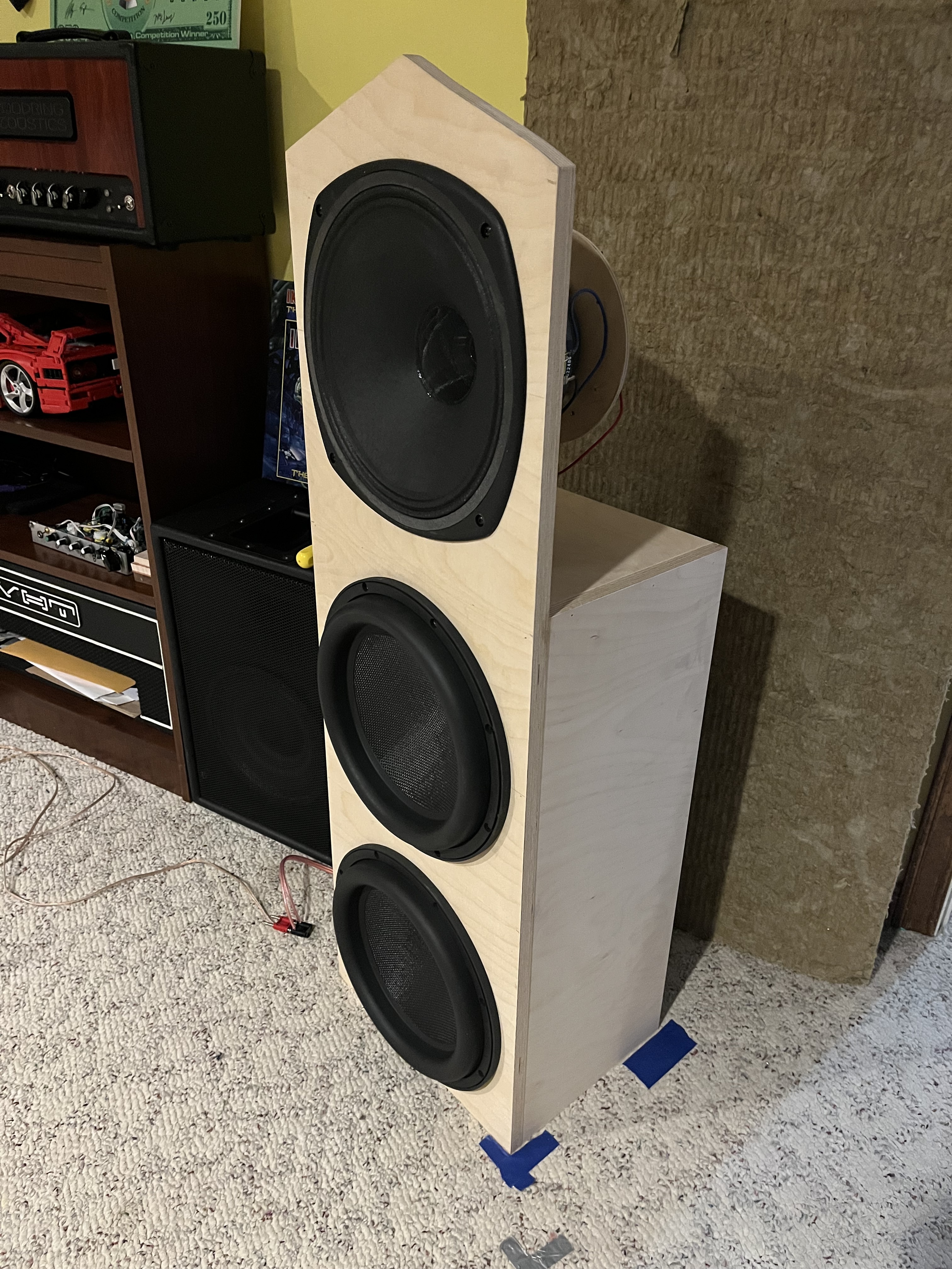

Some more listen and EQ tweaking and I’m starting to really enjoy these Tannoys.
I’ve long considered open baffles but never gone all in because of room size.
  • What are you using as an absorber behind to reduce back reflection power?
  • Do you think it does a convincing job of increasing the perceived room size?
I’d though about a combination of shaped foam, felt, and dowel rods to absorb, deflect, and diffuse the back wave to minimize temporal smearing but ultimately have not tested.
I have a Roxule 2’x4’x2" panel behind each one. Otherwise my room is set up on the long wall and there’s all kinds normal room stuff in there defusing. Nothing special.
The whole thing about needing a bunch of room to have an OB setup is kinda blown out of proportion. I think it works just fine with the baffle around a couple feet away from the wall, which is likely what your normal speakers probably all ready are.

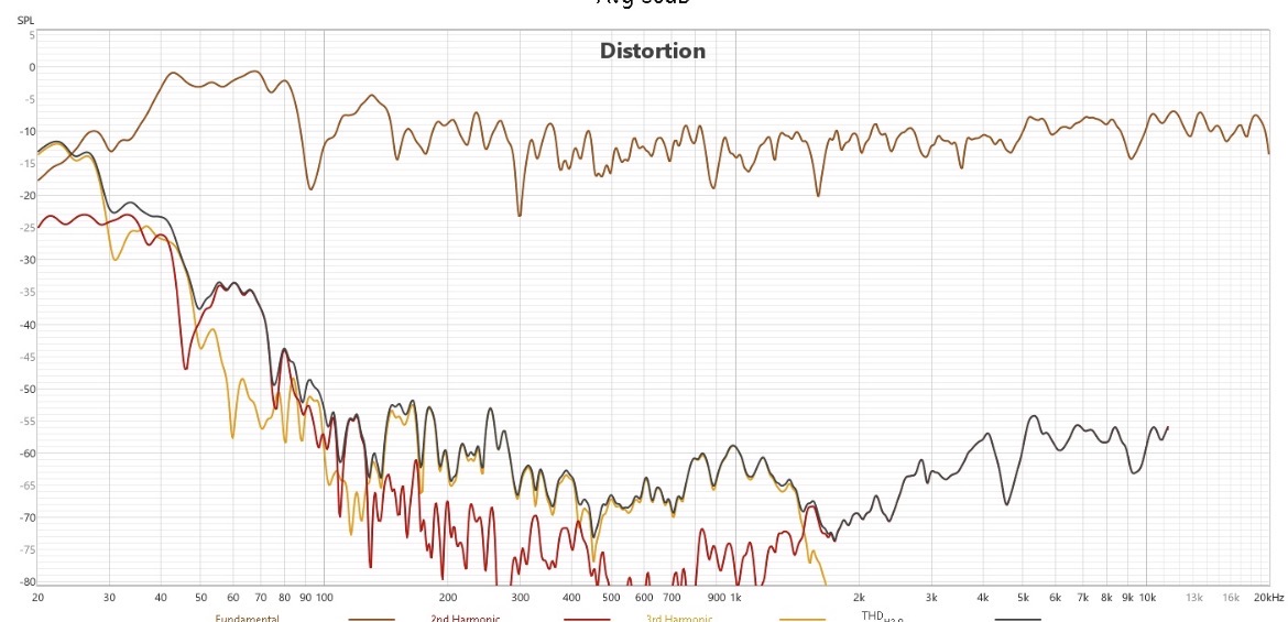

Well after fighting the whole mic/interface/REW for a couple nights early this week, I’ve had a few sessions and finally got a respectable sound out of this setup.

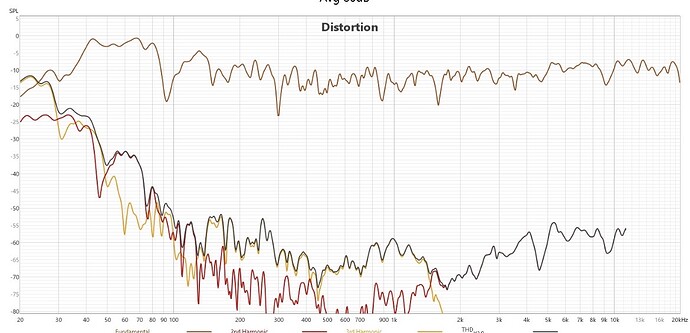

The peak in distortion @1K is probably the tweeter. I have to use it down into it’s FS area, no doubt causing it. I don’t really hear it with music, but the squiggly lines show it.

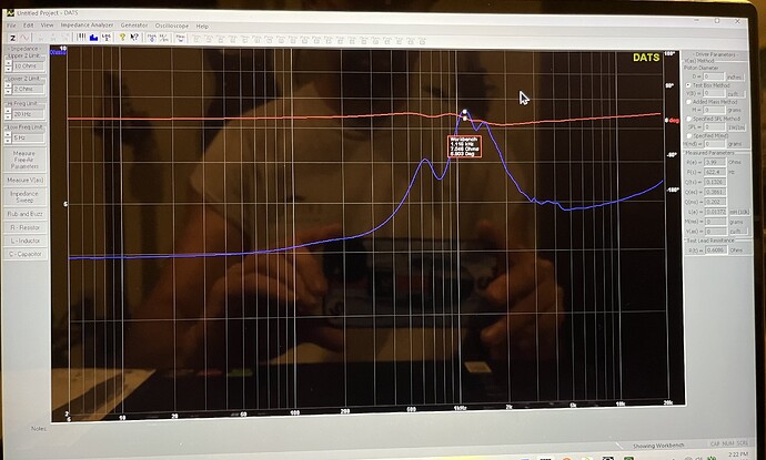

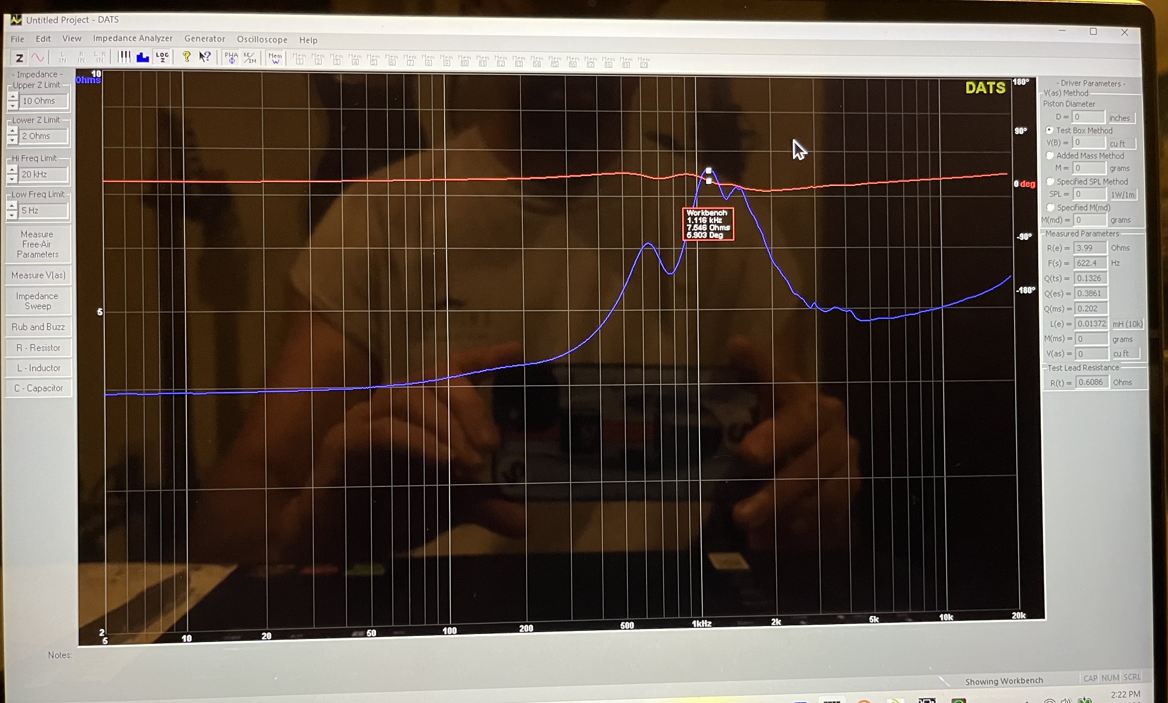

I contemplate maybe a passive FS notch? Might ease that?
Tweeter Impedance…
“I don’t really hear it with music”
Probably because it is ~45db down. What you complaining about? :laughing:
Yeah, I know, guess I just figured it’d be a bit better to address it since it’s probably an FS thing. If the woofer didn’t have such an abrupt drop at 800Hz, I wouldn’t have to bring the tweeter so low and excite the resonance.

Messed with an FS comp on the tweeter, didn’t change anything as far as the little peak at 1K. :man_shrugging:t2:
Oh well.
A swing from ~4.9ohm to 7.5ohm (within it’s used range) isn’t that much.
