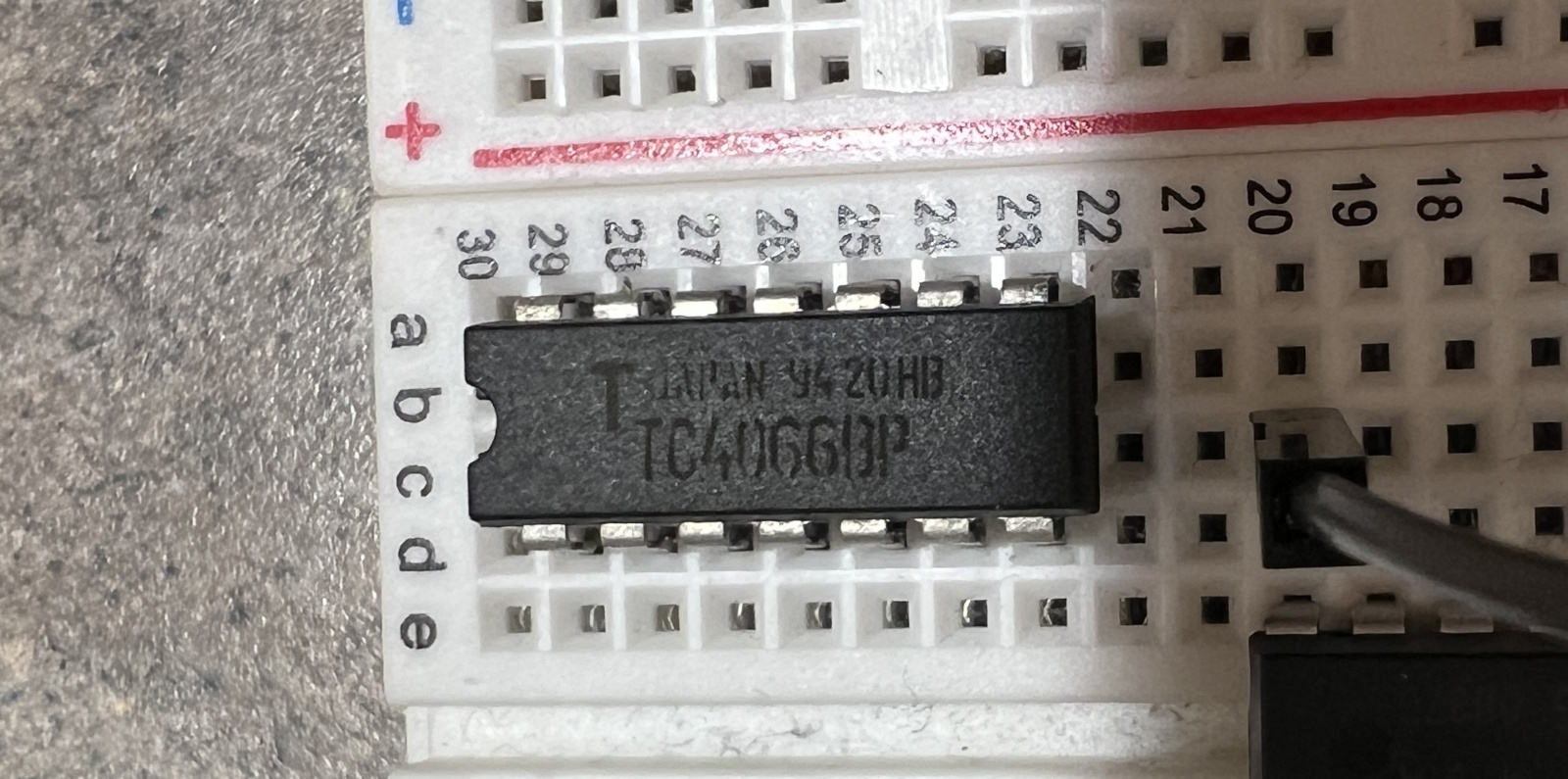

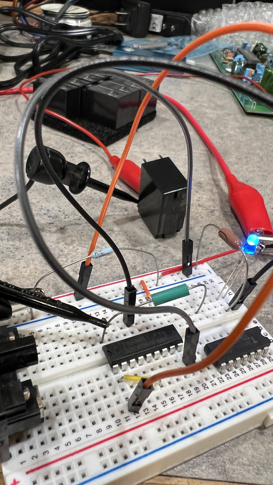

No new updates from Michael. I’ve been researching the logic aspect for IR control. I’ll use an Arduino Mini or Nano clone or ESP32. I had hoped to use the input switching IC from the old Acurus, a TC4066, but I don’t understand how they implemented it. I found a ULN2803 chip that will control most standard relays to select the inputs. It’s cheap as chips, but I’m still looking for a SS option so I can omit the relay board entirely.
I have another project brewing in tandem, a speaker/amp switcher. That will use the same basic building blocks as the preamp, but will have 8 relays and hopefully some kind of display. I’m currently looking at options for simple serial data control for the relays via a shift register chip, the 74HC595. That will reduce the pin count needed out of the microcontroller. If anyone has experience with these types of devices, please feel free to chime in because using a data packet to control something else is completely new to me.
