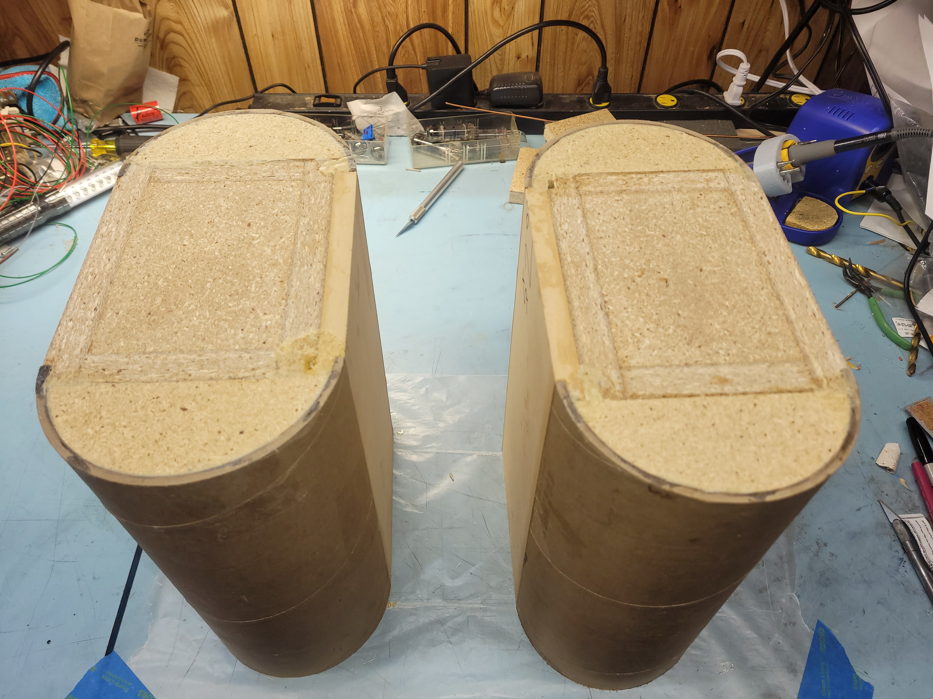

Just plugging along. Got the semicircles cut and Gorilla Glued in. Next up… fill the side cavities with some mass (pool sand, kitty litter, etc).

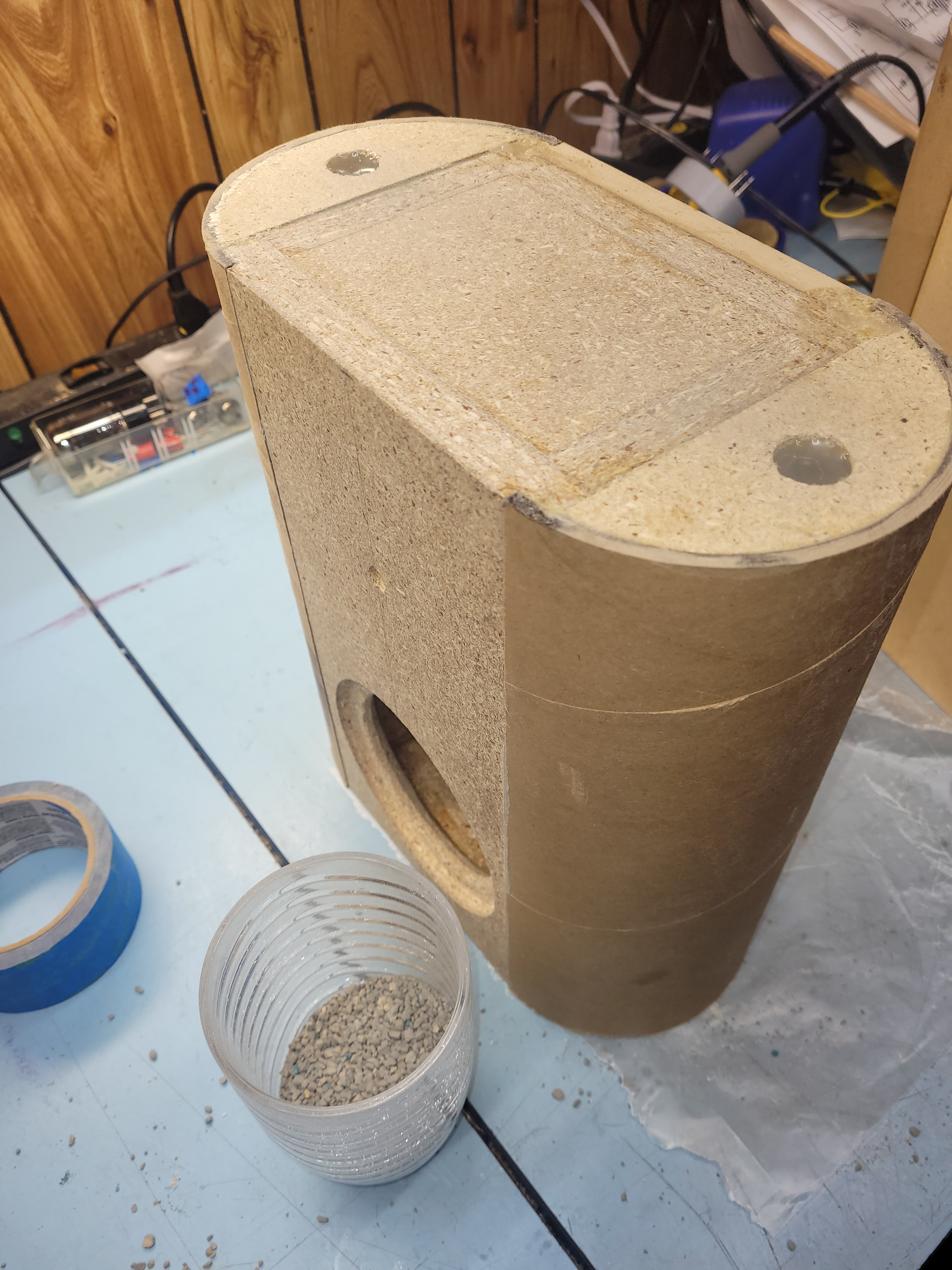

My son helped me pack the kitty litter into the side tubes this morning. I had a great shot of him pouring it in with the dollar store funnel but he refused to let me to post him. Anyway, we weighed them on our digital bathroom scale empty and then filled to the brim (shaken to insure no empty areas). +5 pounds each!!! That doesn’t sound like a lot of added mass but I can tell you that rapping on the enclosures with a piece of wood produced night and day differences. How does this objectively and subjectively improve the sound? I don’t have any measured data. But it certainly can’t make them sound worse. And it only cost ~$4 in kitty litter.
Filled with kitty litter and holes plugged with hot melt glue. The tops and bottoms will be capped with some pretty hardword pieces so the hot glue doen’t have to do all the work!

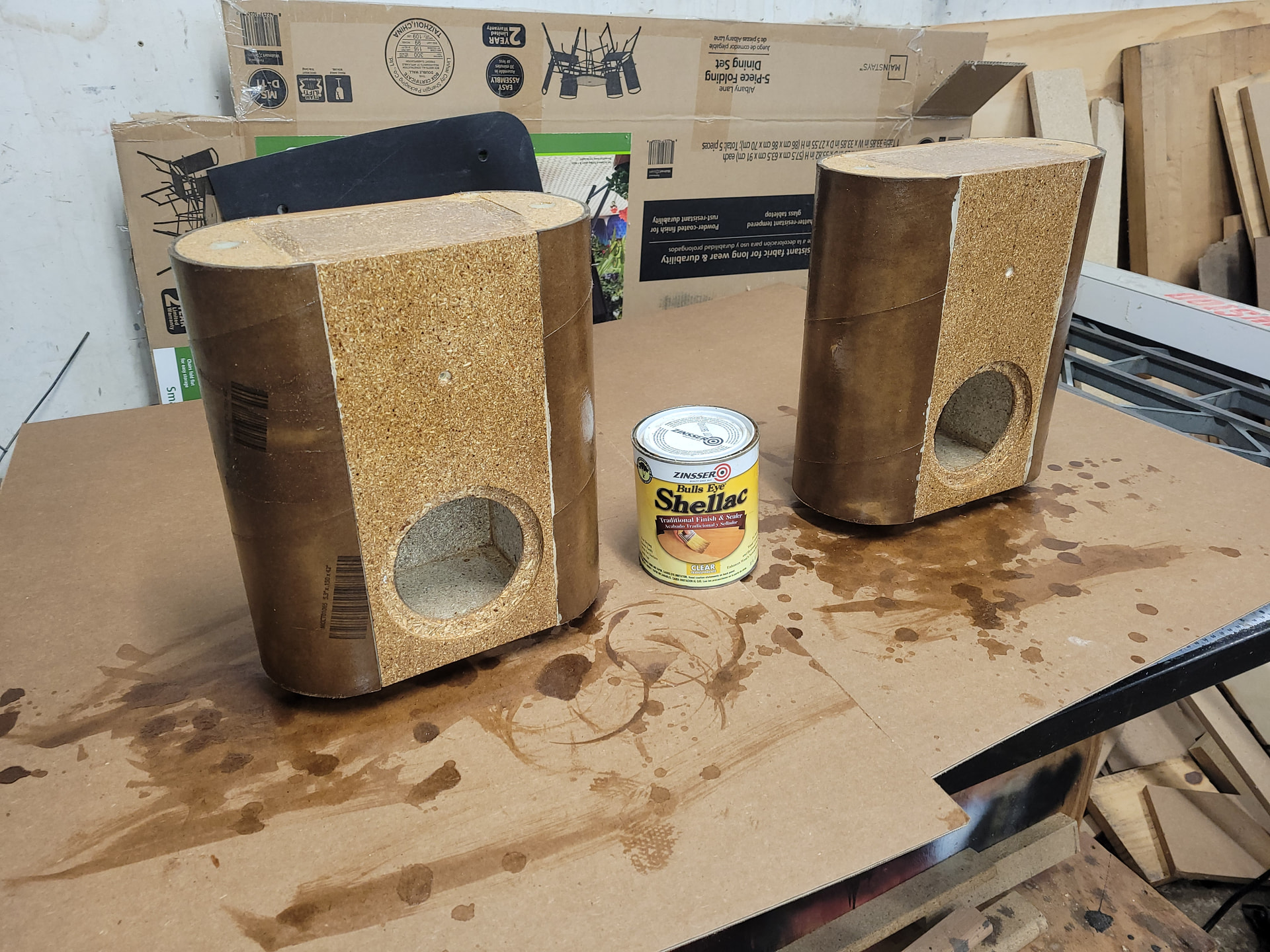

Next step is to soak/coat the cardboard tubes with shellac so I can sand everything smooth without them just tearing to pieces.

I had some time after work today to slop on several coats of cheap shellac. The only issues I have so far is with the Liquid Nails adheasive I used to glue the tubes onto the baffles. The regular old TiteBond 2 wood glue and Gorilla glue are holding like a champ. Mental note to self, don’t use Liquid Nails constuction adheasive ever again.
Funny you say that, as this is not the first time I’ve heard bad things about Liquid Nails adhesive. I suppose there has to be a situation where it is a good bonding agent, or it would not be a successful brand, however, I’ve yet to see or experience that result.

Luckily the glue joint only failed in a couple of small spots and the tube overall stayed solid and no mass escaped.
I used regular old Liquid Nails to bond concrete to concrete, outdoors. Still holding up after an entire winter. It has its place I’m sure.
I’m going to try and dribble some water in the bad spots then use a tiny syringe I have to inject some Gorilla glue and clamp it up tight. I think the Gorilla glue will stick to just about anything.
Changed plans and it worked out great. The gaps were so small/tight there was no way I could get any significant amount of Gorilla glue in there. So I had a bunch of those little Harbor Freight super glue tubes (like 10 for a buck). That stuff is like water so it easily went everywhere and guickly soaked into the cardboard, then I clamped everything up tight as can be with some 1"x1.5" aluminum bar stock that I have (those were wrapped in wax paper so nothing could stick). Some sanding, a little filler, some more sanding and then they will be ready for some paper backed veneer.
