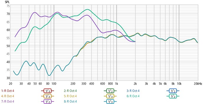

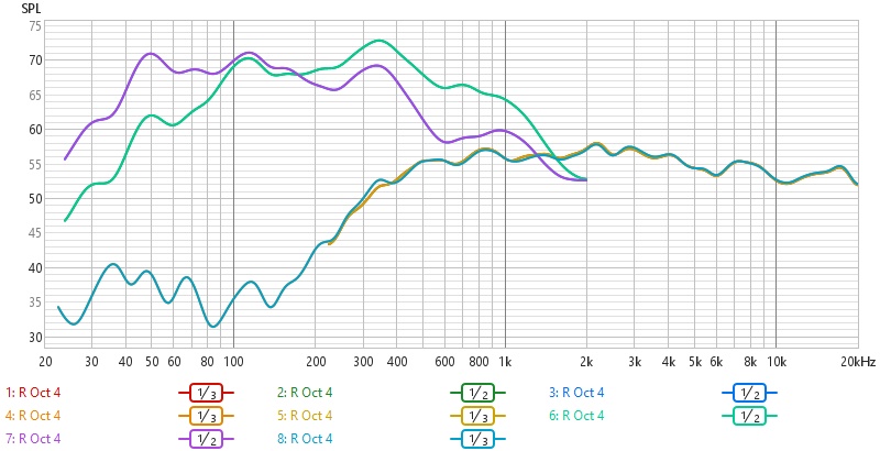

I still need to work on getting dB levels in line with measured, and to adding some eq boost to the low end, but a first for me, anyway, with a 1st order (electrical) between the woofers and the coaxial (gotta keep up with the Vandys…). A little phase preservation…

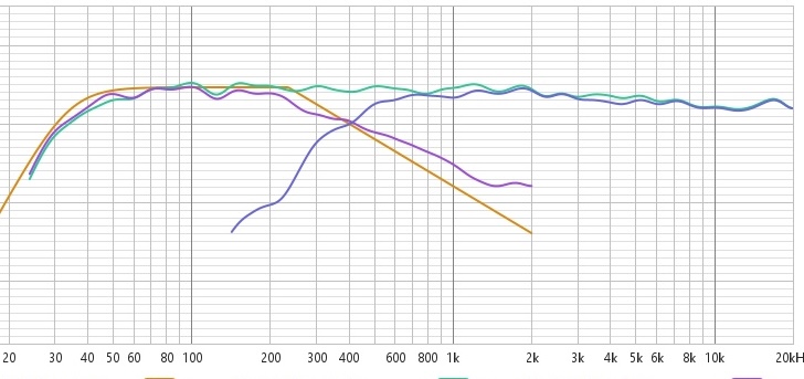

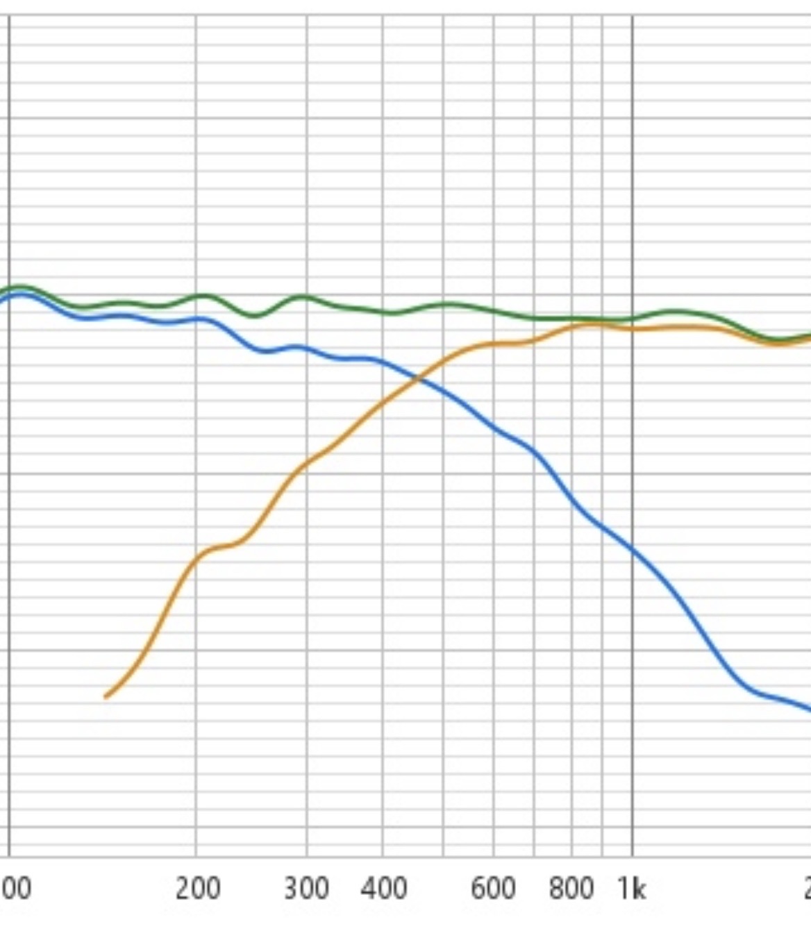

I got a lot of work done with the active filters / voicing.
One real issue with active is potentially over pushing the low end, but by running calculations you can come up with a decent balance between low-end extension Xmax and dBs, as it would be very easy to exceed Xmax at volume (the limiting driver in my build is the 10in woofer, and it helps a bit that the 12in .5 way with more excursion is a tad more sensitive). And, just as important imo, I didn’t want to mess up the 18dB/octave roll-off of the open baffle. Sealed and ~transmission lines exhibit a slow roll off of 12db/oct, ported and PR with twice the steepness ~24db/oct, and open baffle combo of driver and baffle ~split the difference (porridge that’s not too hot, not too cold, just right).
As such, a nice tool I found helpful is to first set target frequency curves in REW (yellow line in pic below). In the case of the low-end I set a 3rd O (18dB/oct) target at 34Hz (down 3dB at the corner) which gets me nearish to 28Hz at -10dB, and 30Hz at -6dB. Not a perfect match, but it’s a target.
