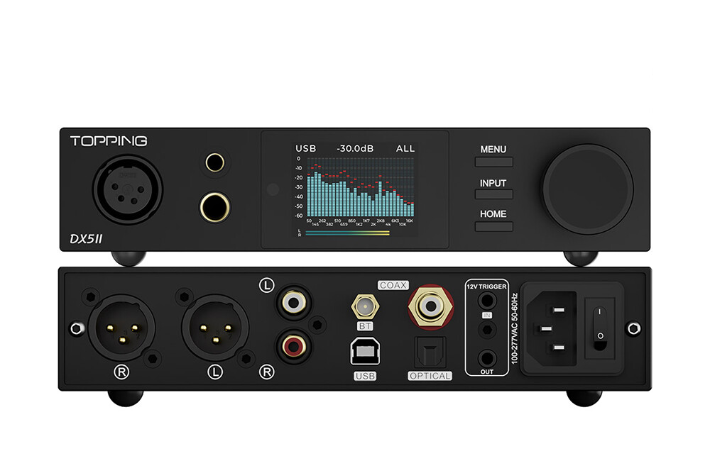

I too have been looking for a balanced output dac and they all seem to stop at 4 v untill you jump into the $300 range. Both Topping and SMSL have some nice dacs with remotes in that price range that meet all your needs.
