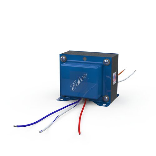

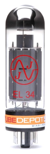

I scratch designed and P2P built a 8 WPC SET amp that used Russian EL34 tubes, a single 6DJ8 preamp/driver tube (thanks Tom S.), and these Edcor output transformers:
Don’t be dissuade by the fact that they are sold as “guitar” amp transformers. They sound and perform excellent! The 40 - 18 kHz range is less than 1 dBu down. Unfortunately they have doubled in price since pre-covid.
These tubes… not an arm and a leg expensive:
