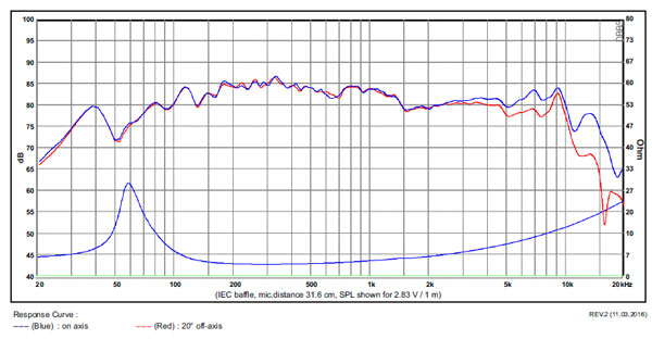

Mark made a sb12 fullrange no filter kit that was really impressive, might be the best filter free speaker I have ever heard. Speaker Scott did something similar with 2 drivers but I have not heard that speaker.. Speaker Scotts work is always well documented and highly regarded.

Mark’s SB12 full range sounds interesting. Got a link?
Not sure who Speaker Scott is…link?
Scott Hinson aka Speaker Scott.
chrome-native://pdf/link?url=content%3A%2F%2Fmedia%2Fexternal%2Fdownloads%2F1000007329
I think Mark’s are almost identical. He might have some cnc cabinets cut.
