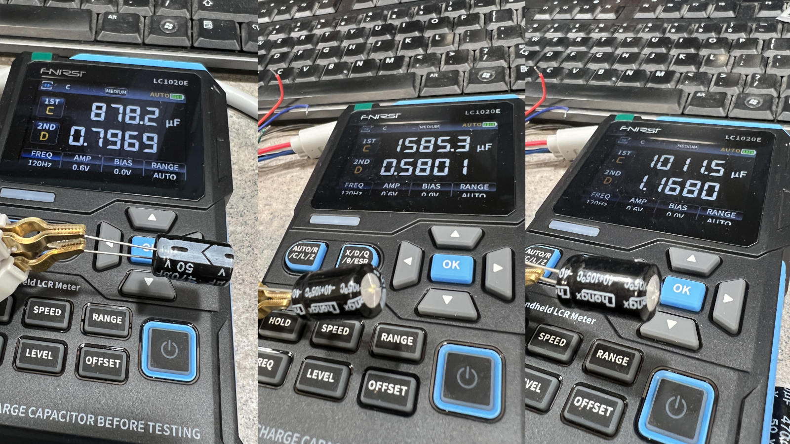

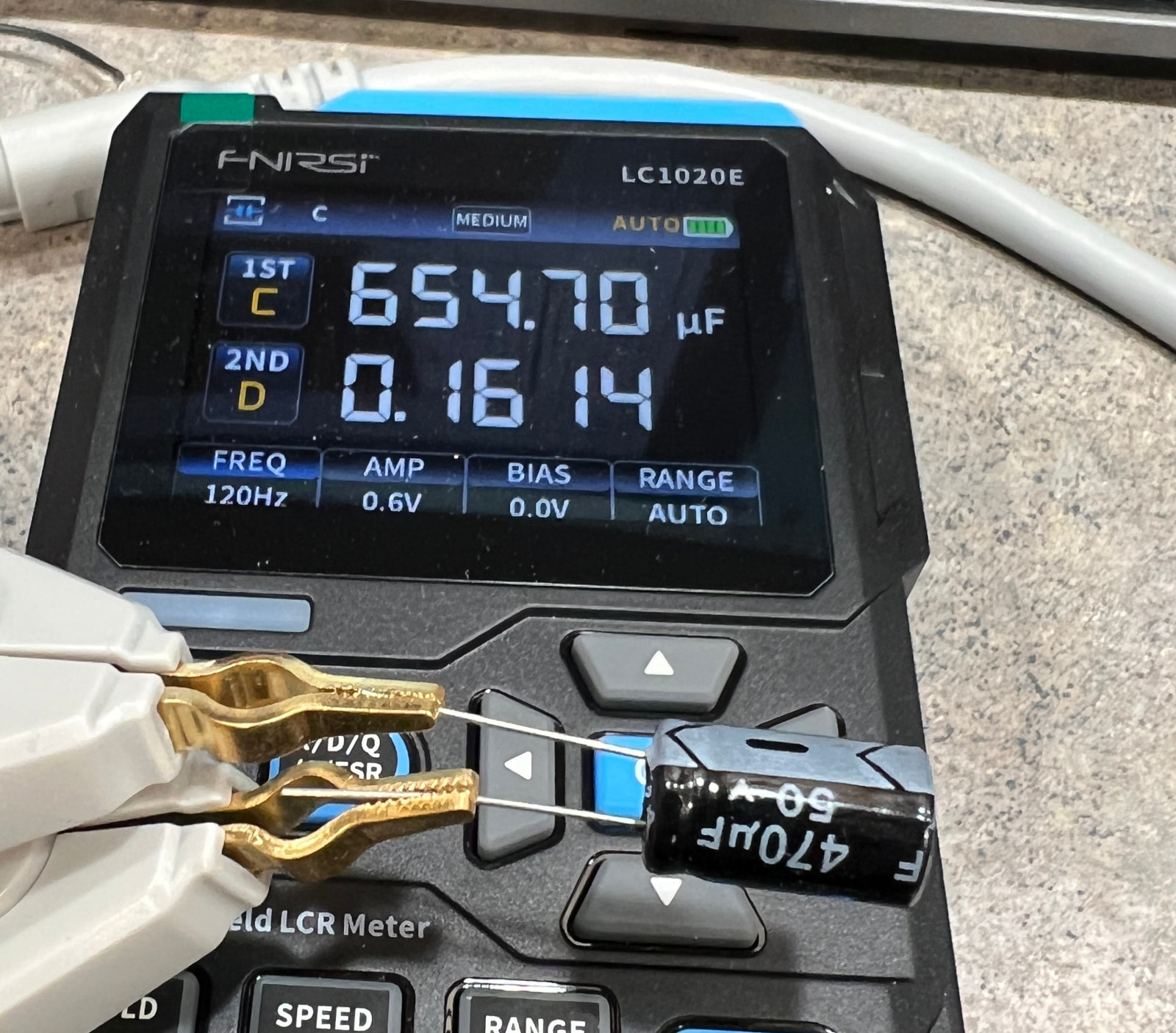

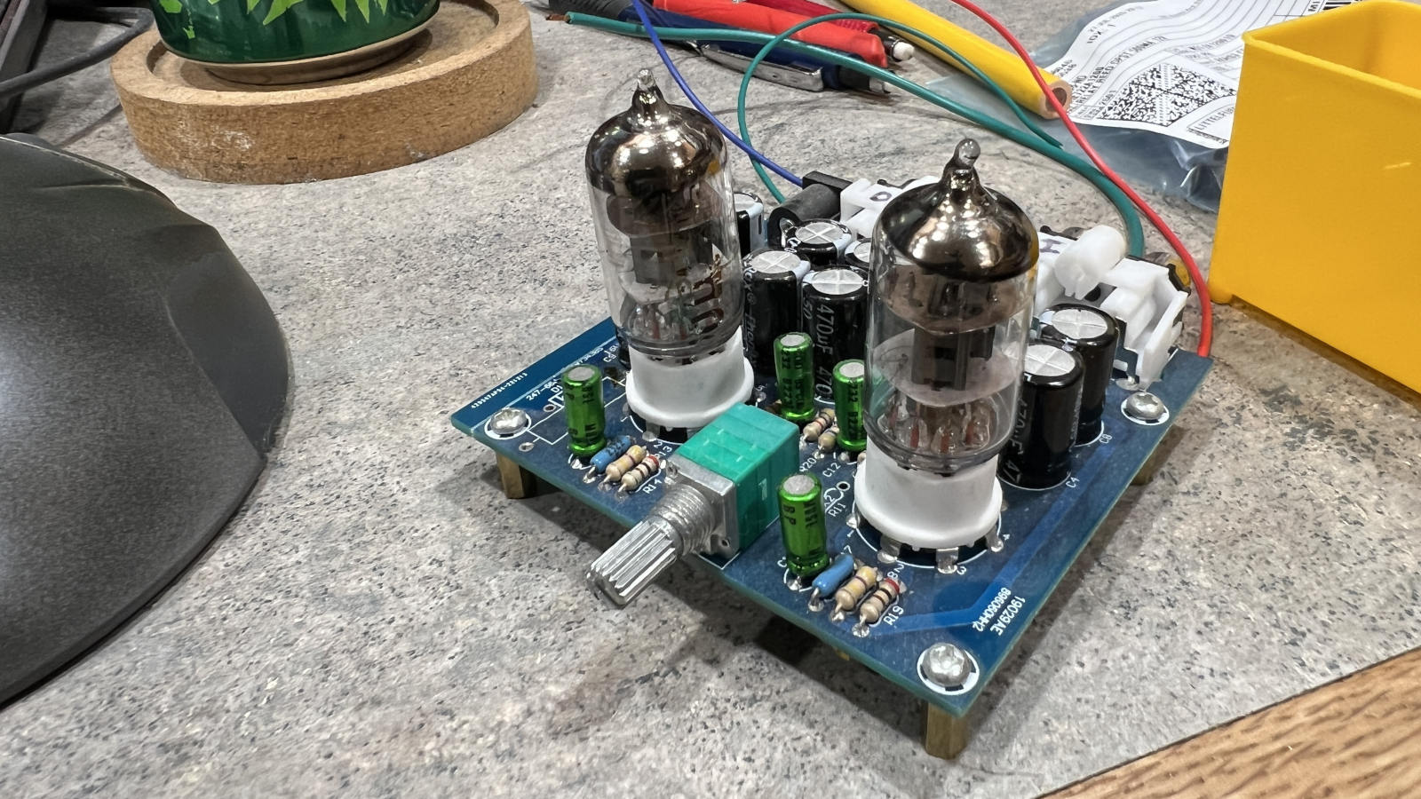

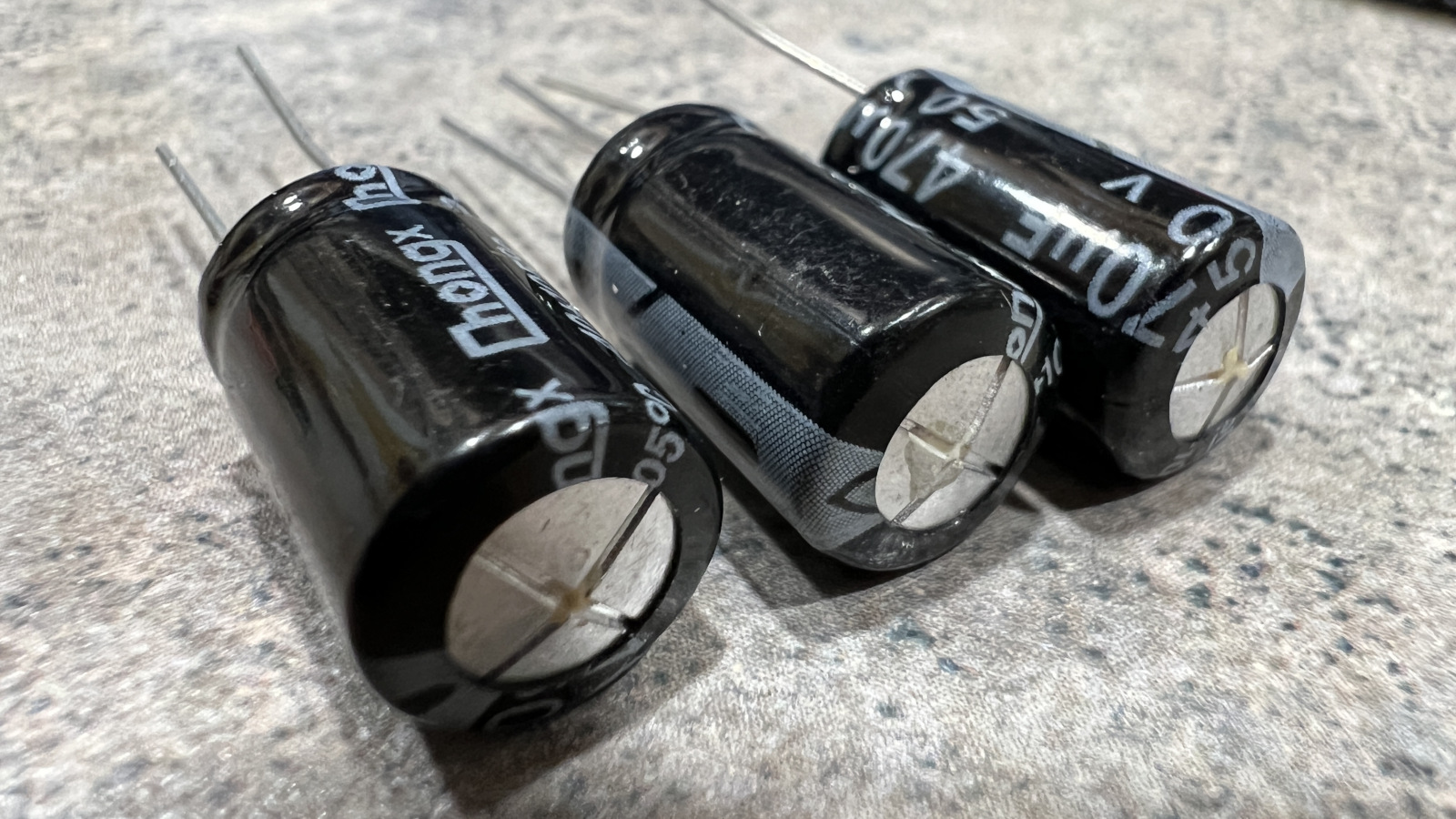

Going through boxes & bags of parts today, I found the bits I didn’t use on the 2nd 6J1 preamp kit I built. I decided to see what the Chongx 470uf caps looked like on a new little LCR meter I got. Most were a little low, a few a little high, but 3 of the 9 in the bag were really high and already venting. These caps have never been used and the kits were purchased in Nov of 2023. I suppose it’s to be expected considering the low prices for these kits. At least the boards are decent quality.

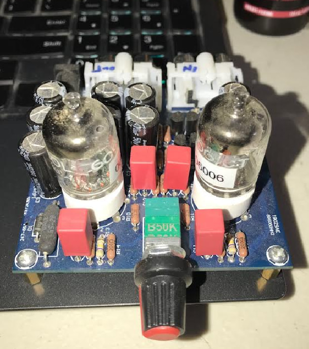

No bulging caps here. Rubycon polarized, wima films, dale resistors, don’t remember which pot. Really like the way it sounds especially with the tung-sols. Don’t remember what the kit cost, but the upgraded parts were way more $ than the kit.

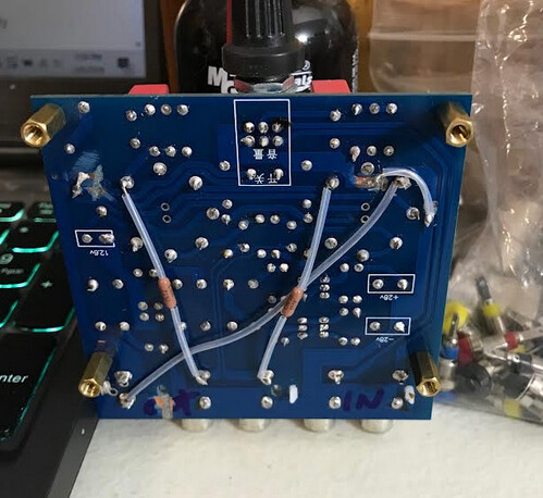

Did you modify the board?
I just got that meter last week as a birthday present. I like to so far because it grabs resistance faster than any of my other handheld meters and much faster than the DATS v3. I just compared it to my Keithley 199 bench meter for resistance and it seems to be at least in the same ballpark, which is close enough for my needs. I’m sure not one to sweat a few hundredths of an ohm.
I built the 3850 clone that MB reviewed in this video - https://www.youtube.com/watch?v=r8cKlzlzcLI

That looks great! I think that’s the stock pot. That’s the same one I my first kit, pictured above.
It’s strange, but the one I built with the stock PS caps doesn’t have any bulging. They are all a little low, but still within 20% tolerance. I checked a few new 470uf Nichicons of various voltages and they are about 15 - 20% low. I have read some manufacturers now deliver caps that are lower in value than the stated rating. Their form of shrink-flation.
