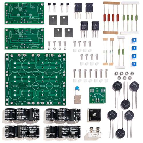

I can tell you there’s really not much to building a Pass clone kit. I think I spent most of my time pondering the power supply wiring.
Oh - here’s the design details on the F5m straight from Nelson - https://cdn.shopify.com/s/files/1/1006/5046/files/F5M_DIY_AMPLIFIER_R1.pdf?v=1709576510
