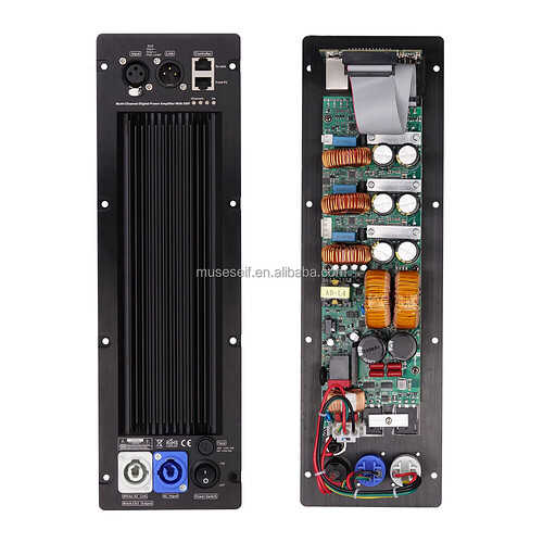

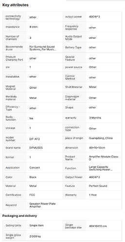

I have been looking at the EIFMUSES “EIF-AF3” one here,
https://www.alibaba.com/product-detail/3-Channel-Amplifier-Module-Class-D_1601278112513.html
for $195.00 USD each.

They look like they are built well. Getting the most out of the dsp will likely be a big learning curve. Im guessing that the gain will be set pretty high witch can be a problem when trying to make it work for home audio.

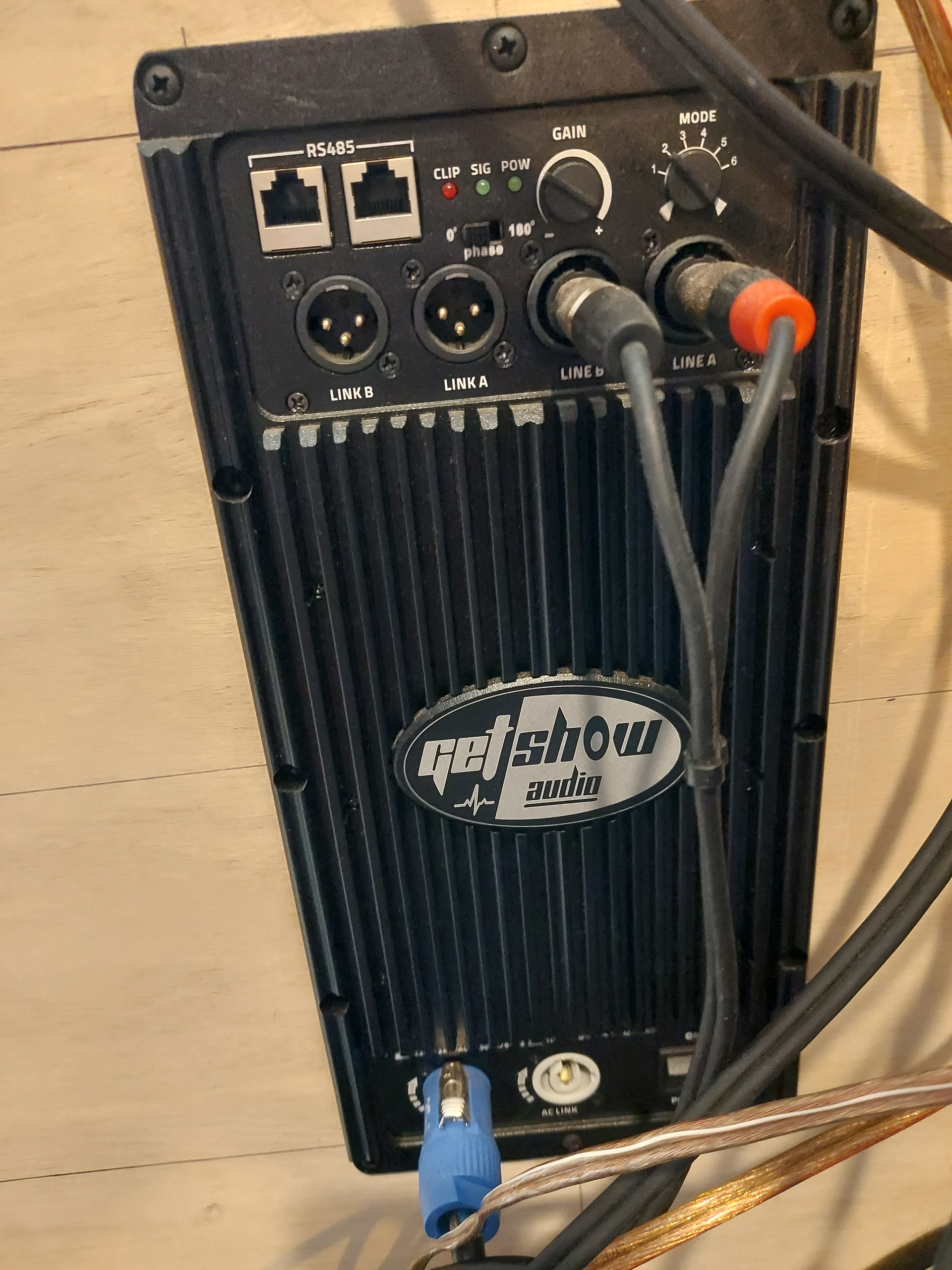

I have only used the Getshow amps for subwoofers. They work very well for that. Still haven’t tested output on them. They claim 2400 watts but I am guessing 600 rms. I don’t have enough resistors yet to test above 500 watts. I did test a home style plate amp that is rated at 350 watts. It tested 360 watts rms and 440 peak. It was 100 bucks. Now they are up to 125. Still great deal.
Edit: The dsp in mine is really easy to learn and has many capabilities. I only use the crossover, eq and level adjustment. Mine also has a mode switch which lets you have six setting that you can program into it. Choose the settings without hooking into the computer. Very nice!

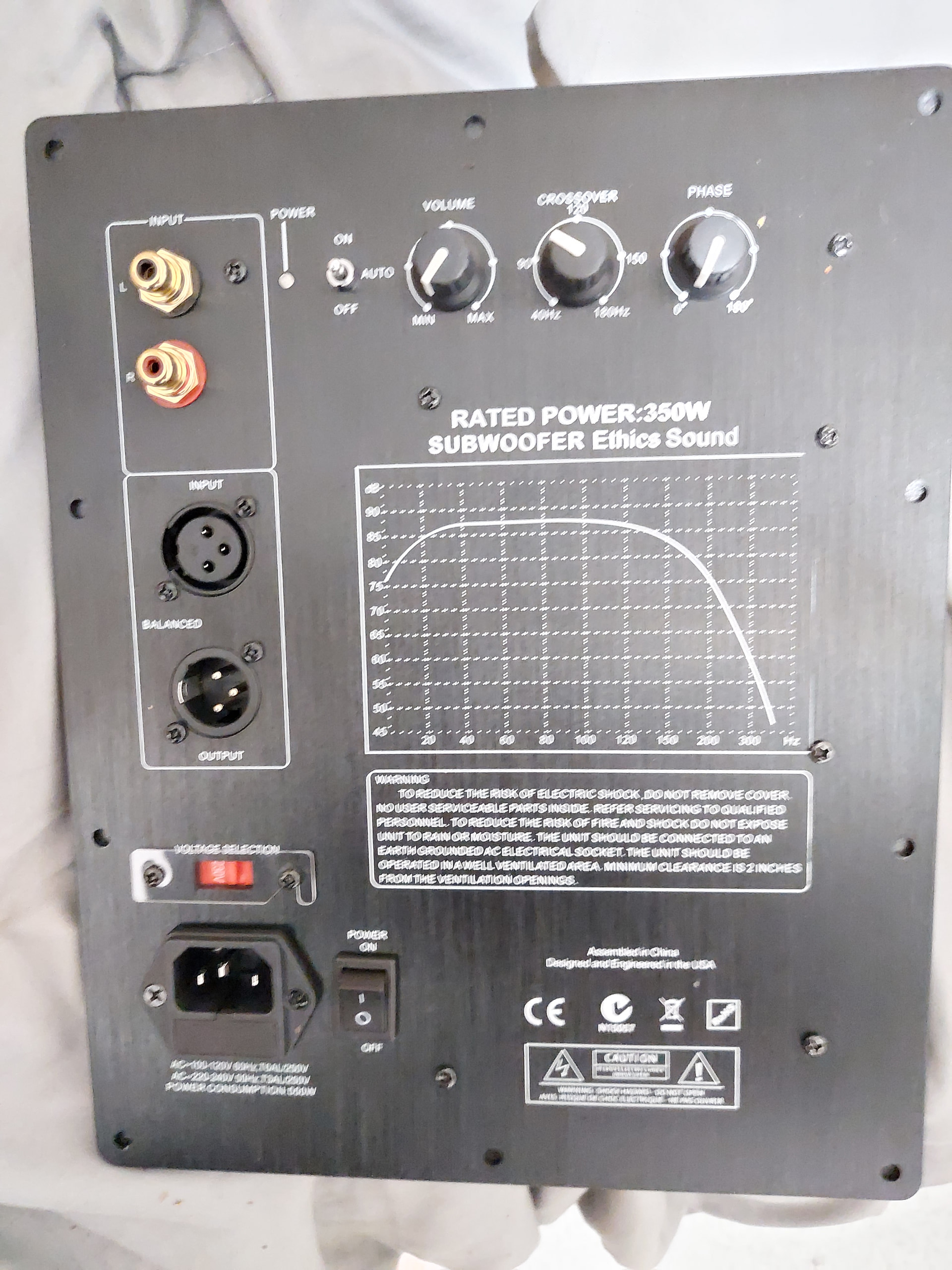

Where did you get the 350W plate amp?
Yes, the 350watt looks intersting, esp if you can do PEQ for 125$. The 6 setting makes it very versatile, can build in different levels of BSC for the woofer for near/far placement, etc.
Does it roll-off the high end or is it full spectrum? The 2 way Dayton dsp amp rolls off one at 1000Hz.
The 350 watt one is the non dsp one. When I uploaded the pictures they inverted the way I wanted them.
The Getshow is the 2400 watt dsp amp. I think it is full range. Single channel.
The 350 watt one has a crossover varitable from 30 to 200hz I think. No eq. It is a subwoofer amp only.
