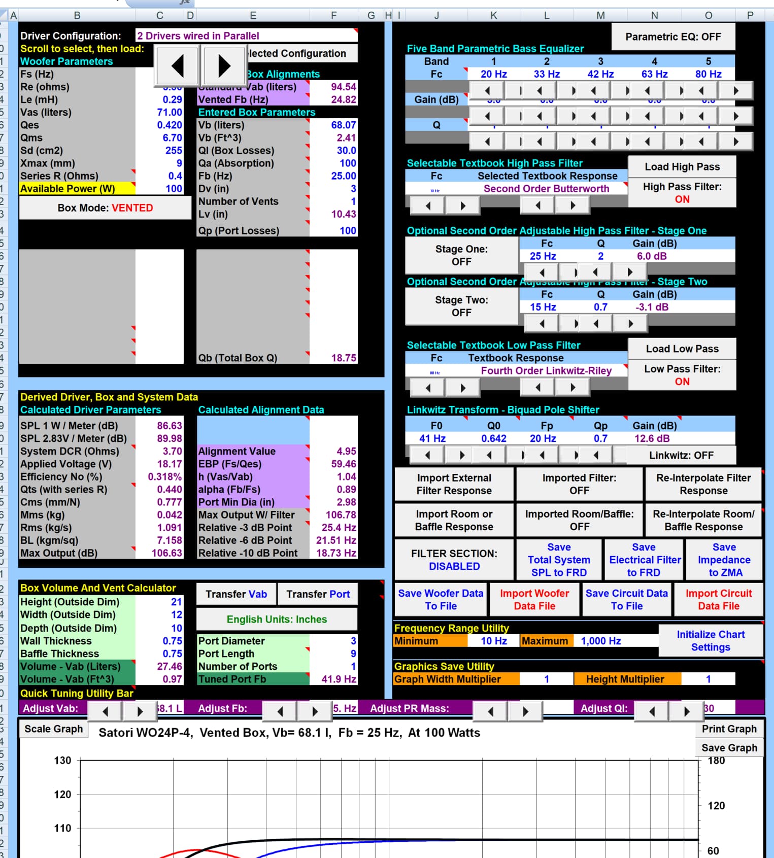

Is anyone using Jeff’sThe Woofer Box and Circuit Designer 6.0 to work under Windows 11?
I am using an old copy of Excel that worked under Win 7, but now the arrow icons are all big and hiding some of the cells.

I can run WBCD under Win 11 using Excel 2010. The key is to install the 32 bit version of Excel. You could also try running the Win 11 compatibility troubleshooter on your Excel .exe.
