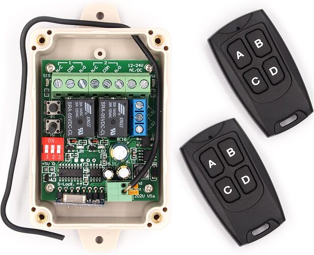

https://www.amazon.com/gp/product/B0BZNPKM9C/ref=ewc_pr_img_2?th=1
Add a 12v power supply and some binding post and you have a remote A/B switcher.
Interesting Ken. I was actually wanting something remote.
are those clean enough and handle enough power to run audio? Would it work for a preamp level signal?
I have used a similar Parasound speaker switch. It is pretty clean if you don’t use the impedance protection feature. It looks like it can be switched off on the Audtek unit.
12v 10A=120 watts per leg so 240 watts max. No relay is perfect but they are still used in almost every intigrated amplifier for both speaker selection and protection.
They should work for signal as well. Ideally you wouldnt switch the relays while playing music to avoid any carbon build up but to be honest we arent listening at levels where any of these are real concerns.
If you were going to do switching berween signal and speakers you should add a volume pot on the signal outputs so you could level match for better A/B comparisons.
If your serious I could probably whip up a scematic. Might even have some parts.
