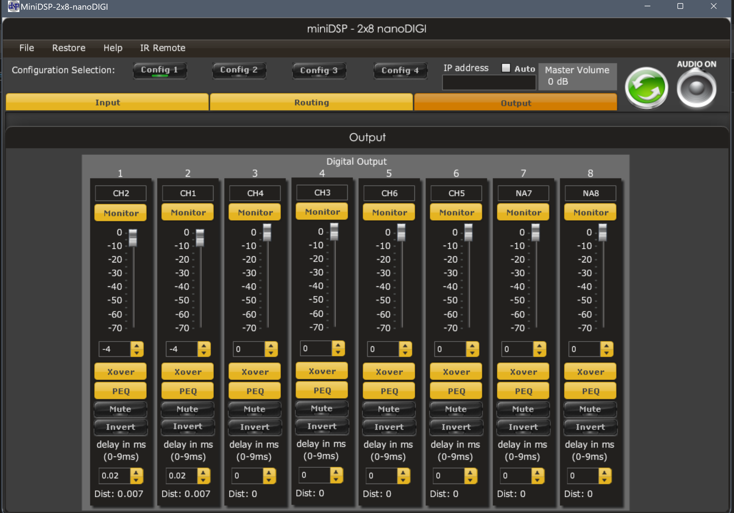

The same thing generally. We might understand phase delay in degrees at a given frequency, but the MiniDSP software allows the user to program milliseconds of delay for a channel. I suppose they can be equally precise or imprecise .
Yep, you can set the time delay in Ms in the nano-digi too.

screenshot from Nano Digi 2x8 - this is the output stage where you can set the delay and the channel volume for level matching.
