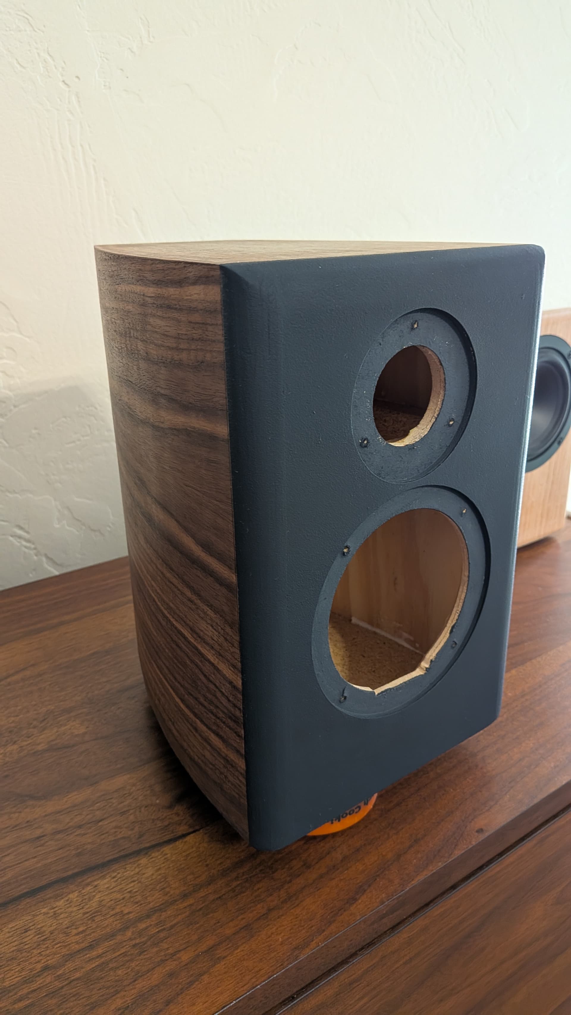

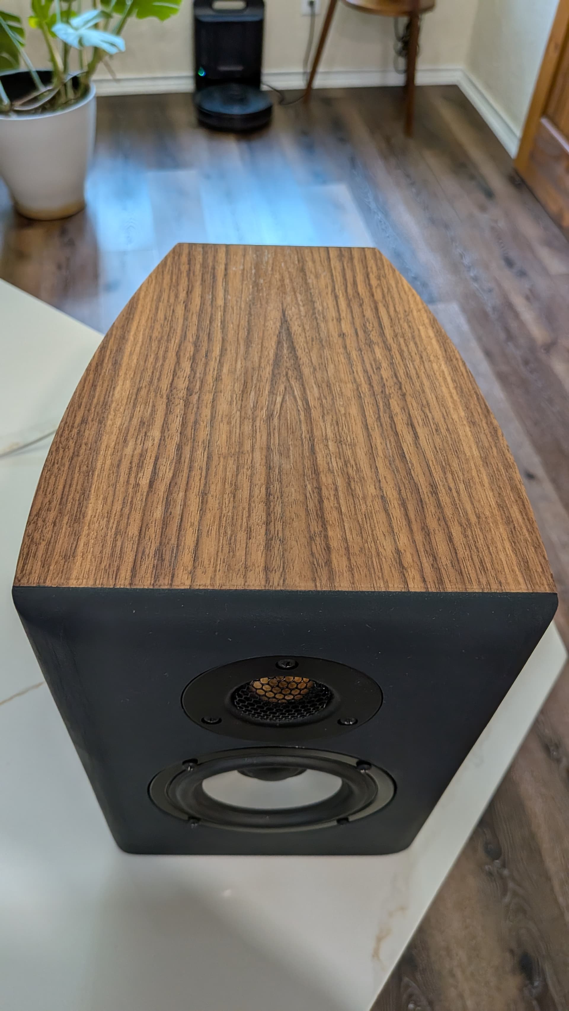

What is the veneer, it looks great?
Cheap band it walnut from PE.

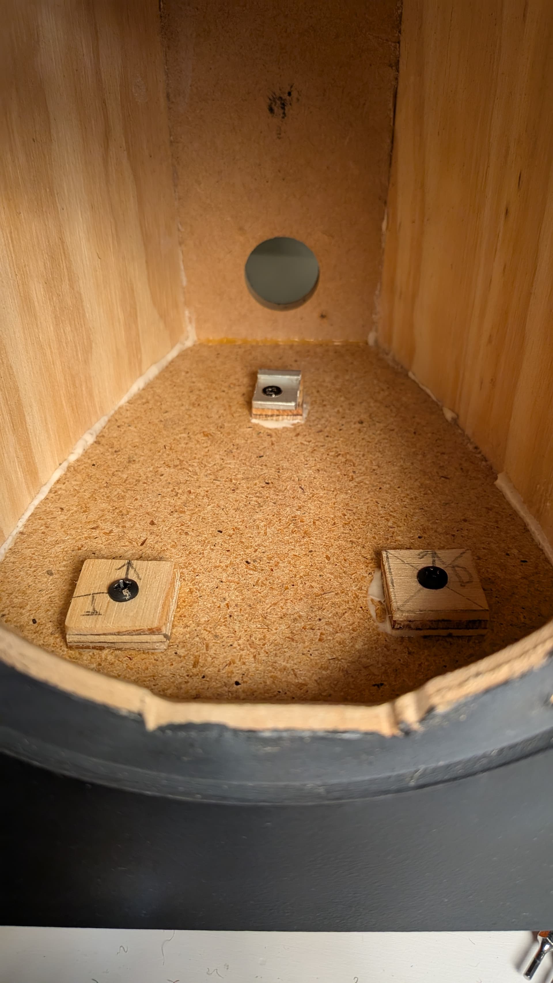

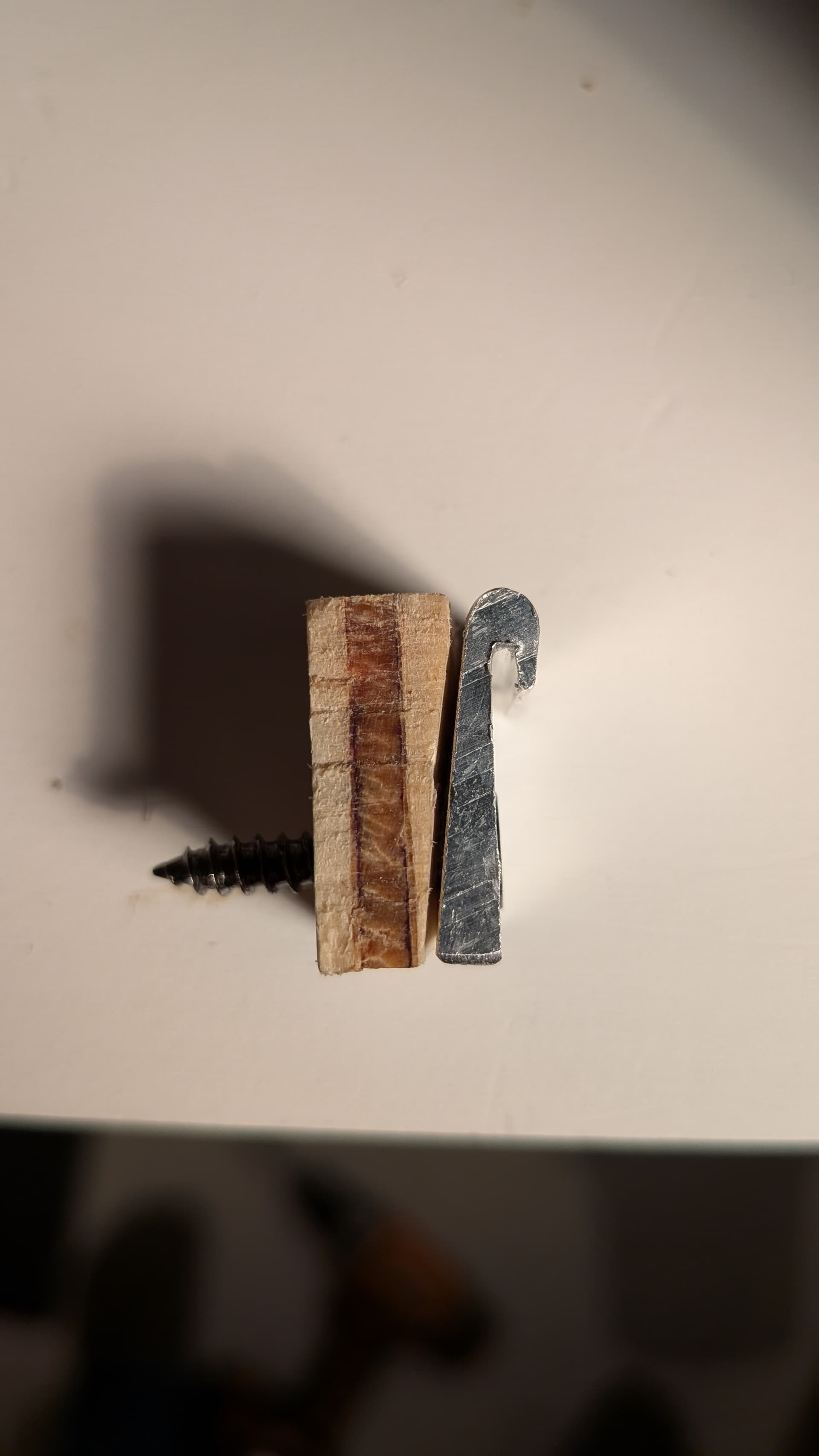

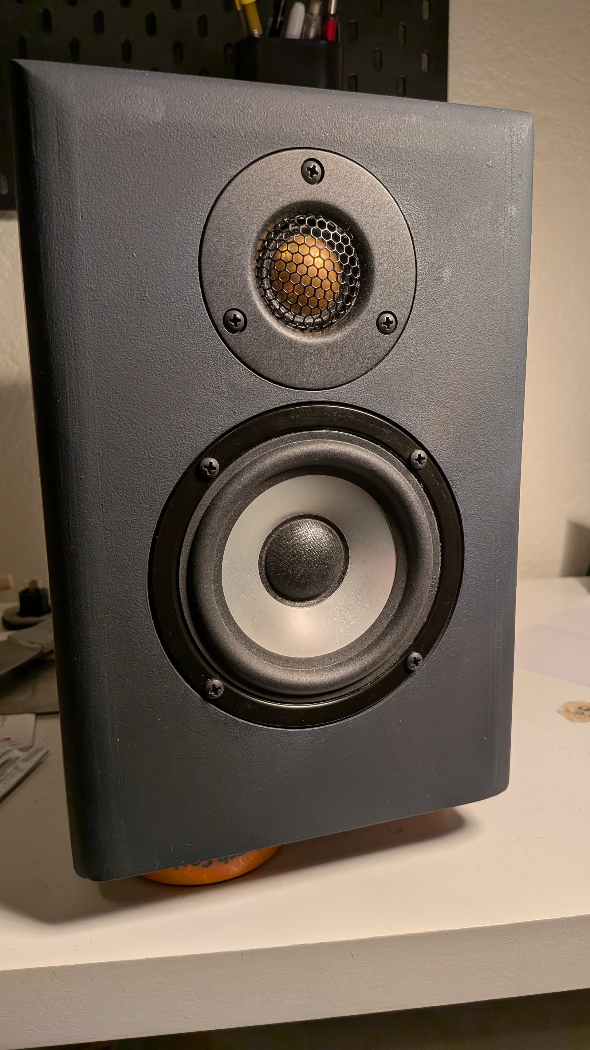

Made some stands with a sink hook and ply for the xo board.
In theory they work.
Alignment was a bit off, but works.
And that is one, the other is still in painting.
With more light, not my best veneer job, but should hold. I hope…

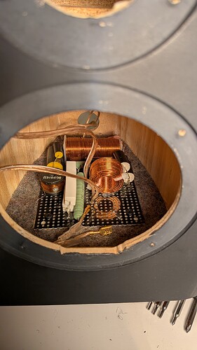

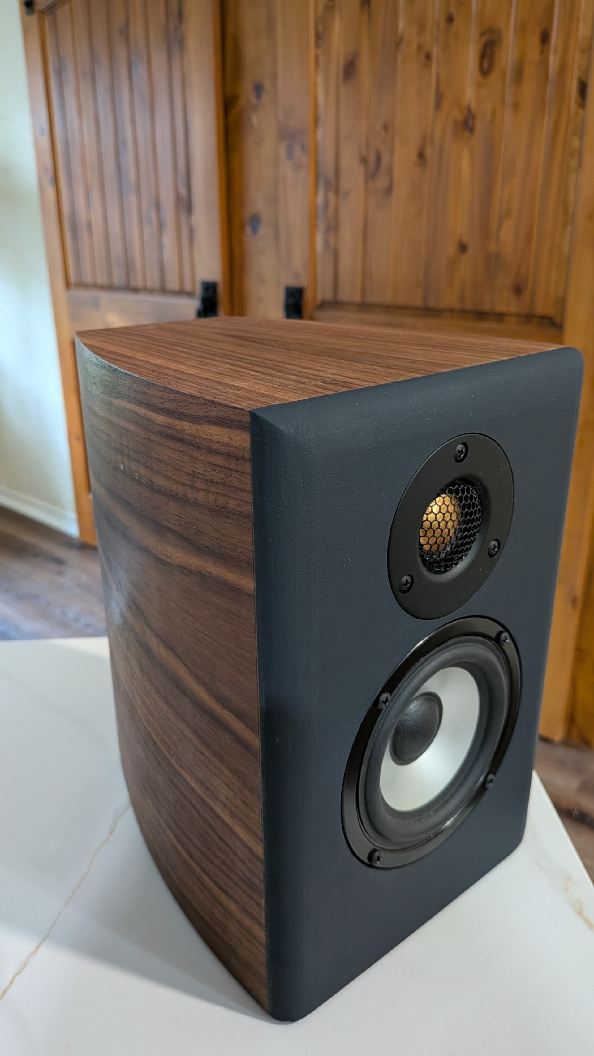

They look great! Any details on the drivers, crossover, etc?
Looks amazing to me! Was the top piece already book matched or did you do that?
Dayton DA115 and a MeloDavid tweeter.
I’ll get more details when I’m at my pc.
It was already there, just had to cut the right piece.
The tweeter didn’t look familiar. More details and measurements if you have them will be greatly appretiated!
MeloDavid CB25M from:

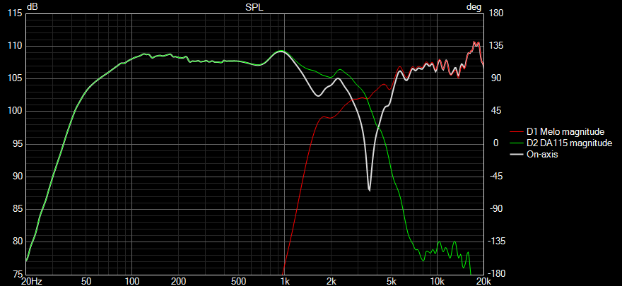

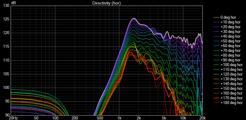

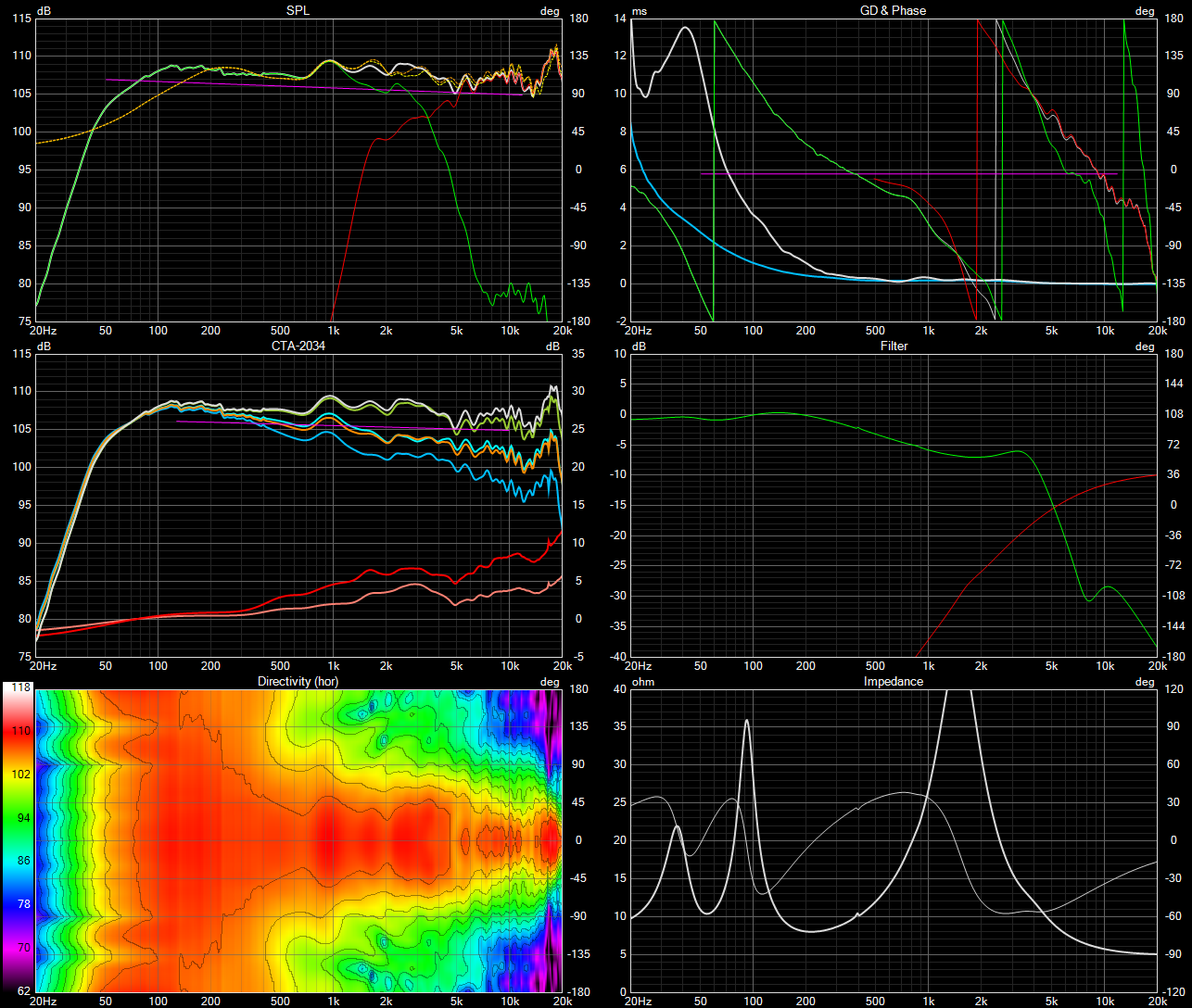

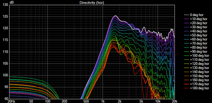

Simulation and both measure responses:
Then they were 2

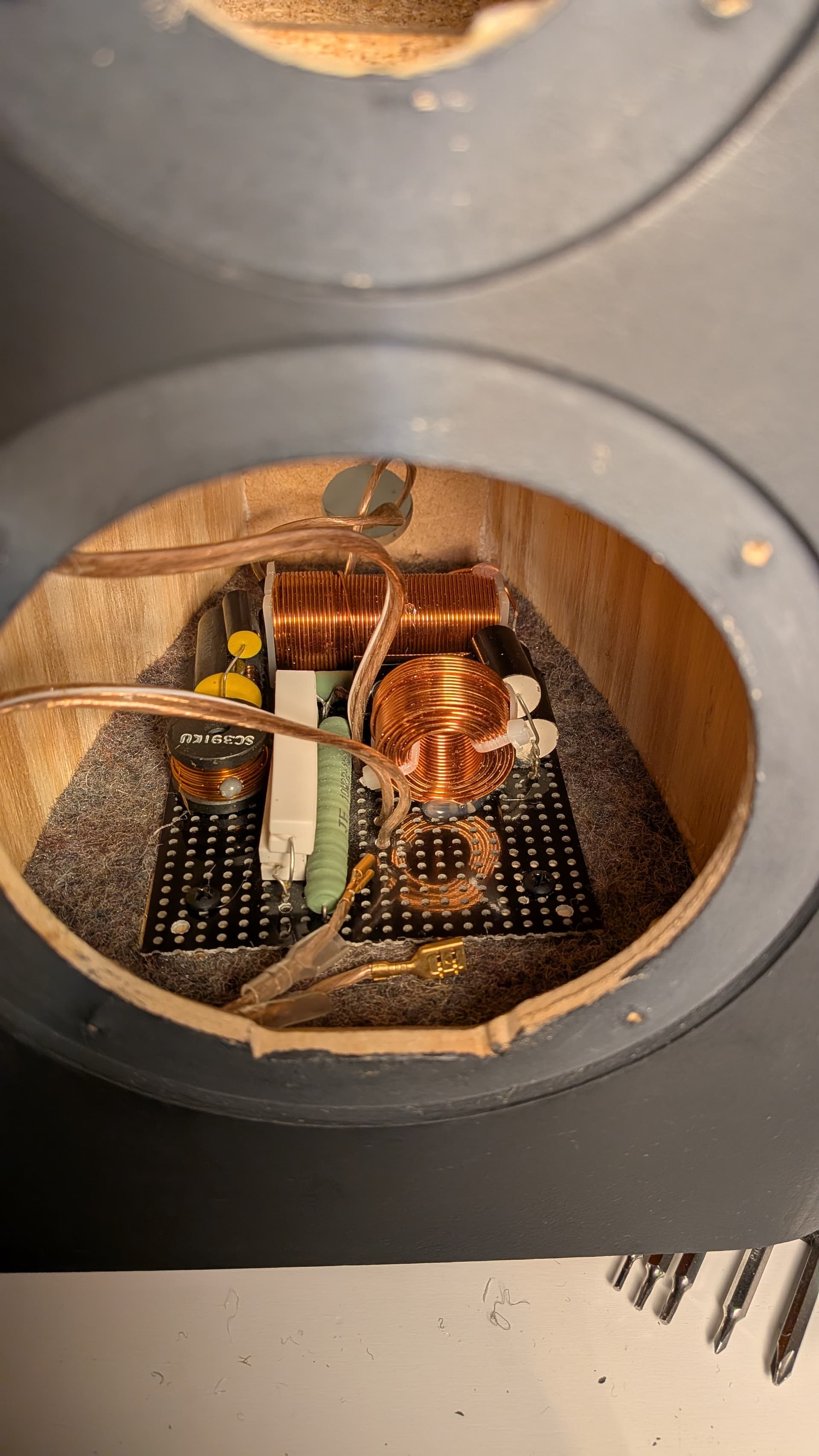

This is the XO that is in there now.
Should the tweeter polarity be inverted?
No
