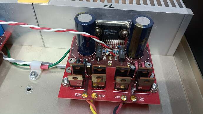

Can anyone in here identify this amp I was told it was made as a DIY project back in the 90s or early 2000s.
I dont think its too old. Its a nice kit for sure. Can you send a pic of the IC?
Looks nice and clean.
I think that looks like a chipamp.com product.
Found it :slight_smile:
Yep basically same as a dual 3886, looks to be running parallel mode with the output resistors, though sometimes they want to fight each other without a some active dc offset correction circuit. Works but can run hot.

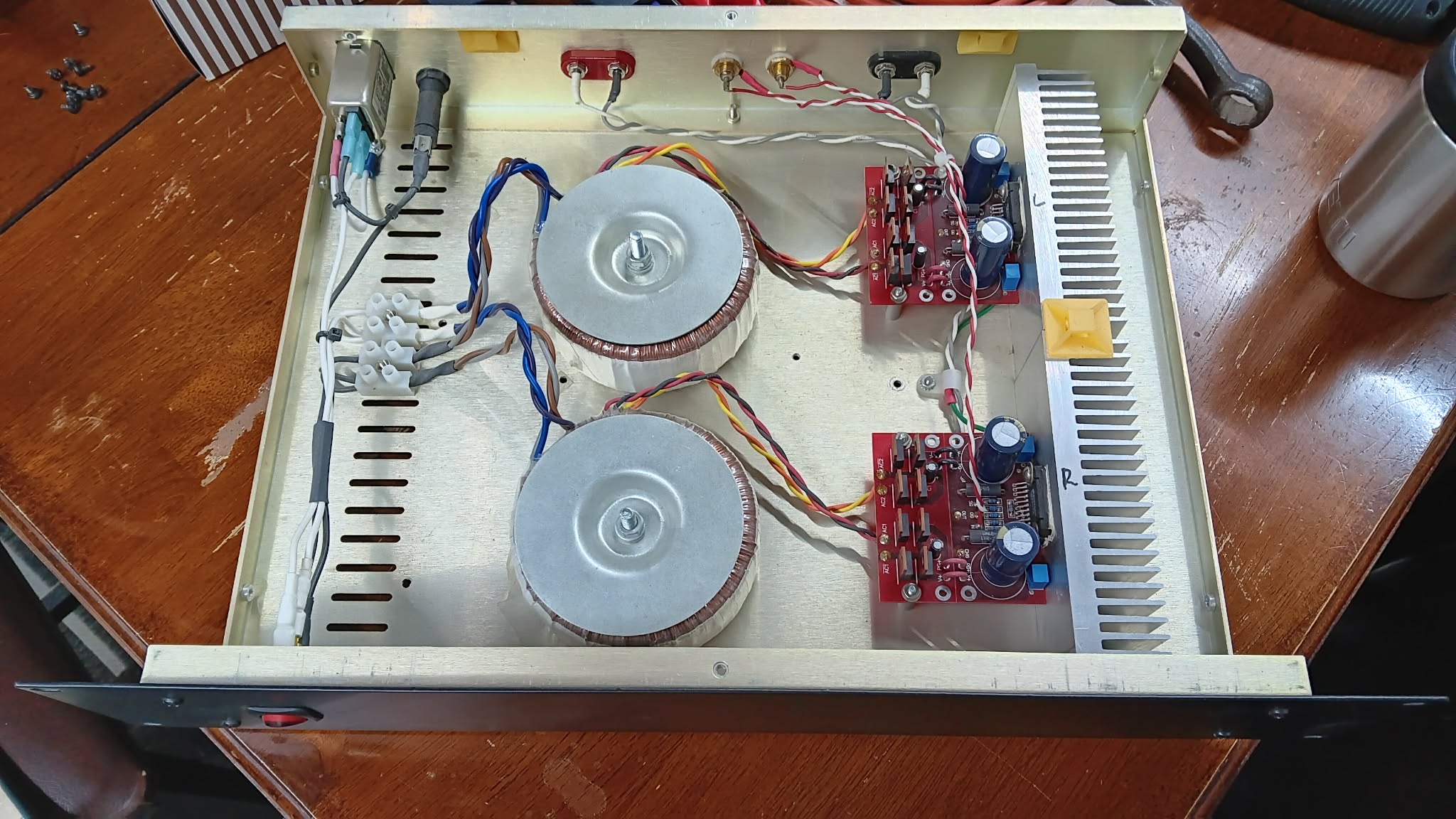

Nice dual mono clean layout.

Looks like its about 120watts per channel in that configuration. I would love to know how it sounds vs a class AB of similar size.

I feel like I’ve seen that amp before. If I had a guess, it looks like a build Hong Nguyen did quite a while ago.
Edit:
Nope, was not Hong’s build. Google soundhobby to find his.
