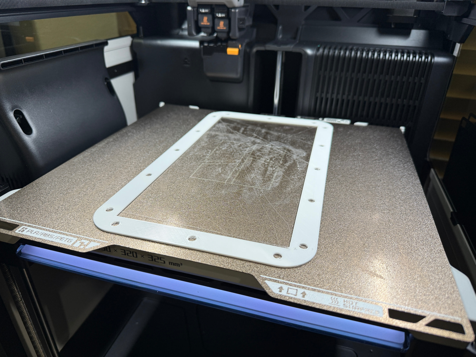

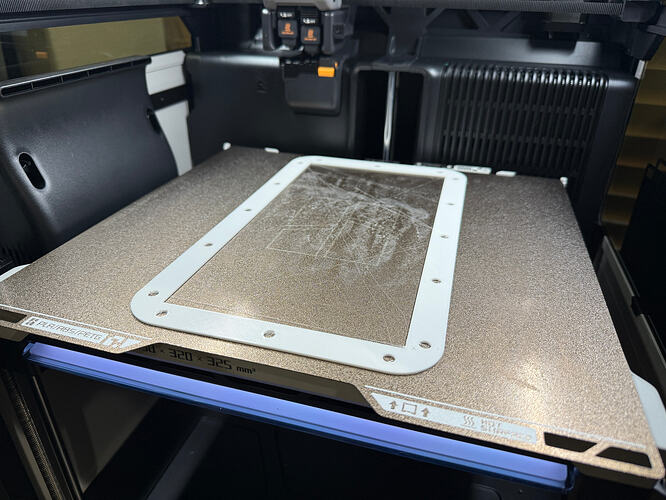

Couple of things.
First, I wasn’t paying attention when purchasing the TPU feeder and only recently realized I had to print some parts and assemble the thing. Not a big deal, should have read the fine print. Second, I realized the design blocked the input ports (brilliant design!), so I found an alternate design on Makerworld where someone fixed that and made some other improvements.
So, all that said, it worked great! I made a benchy and a gasket right out of the packaging. Definitely had some spiderwebbing since it doesn’t come dry out of the bag, but for this stuff it was fine. I have it drying now before attempting my mid cup liner design. This is Bambu 90A, about a 2 hour print using stock settings. Thickness is 1/16” and is used to seal a removable rear panel on a speaker I’m working on.
