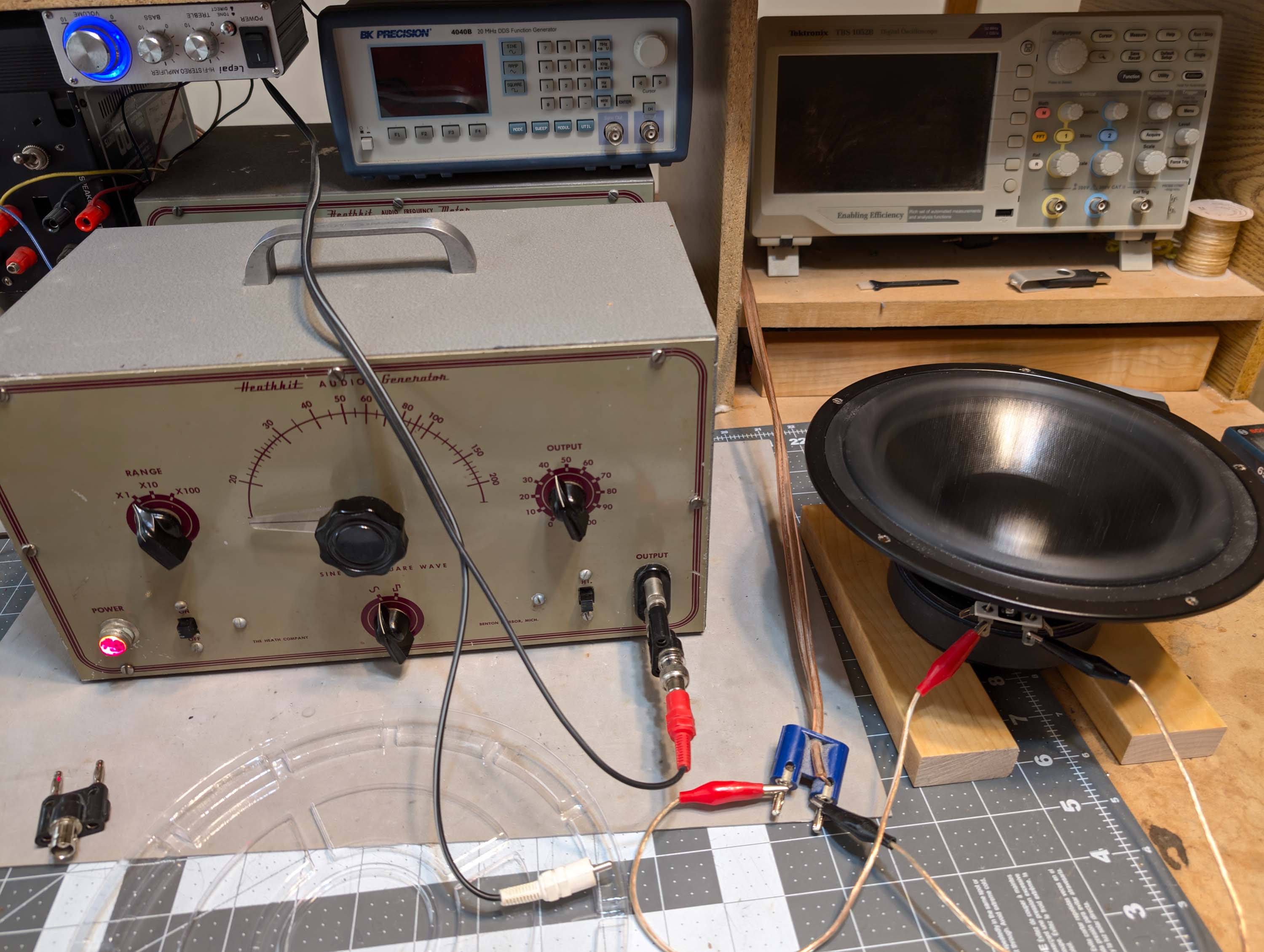

Thanks guys! As a parting shot, here is the old Heathkit being used to break in an 8 inch woofer at 15Hz. Signal is sent to the little Lepai 2020a amp, which can drive the 8 ohm voice coil at roughly 1/2" peak to peak without issues. I locked the shutter speed on my camera at a quarter second to create motion blur on the woofer cone and surround. :smiling_face_with_sunglasses:
