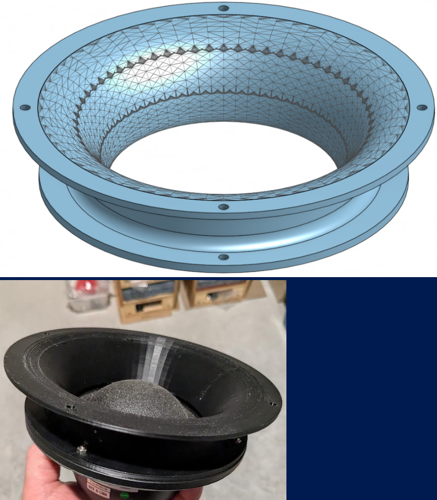

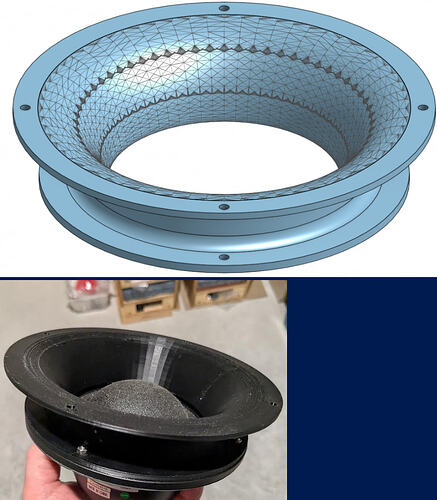

I’m happy to share the waveguide STL, but I’m in no way an expert. I have yet to make progress on the build with the DM-7500.

Previously posted on the Old MWAC Site by silverD:
Hi Steve,
I haven’t done anything more since my post. I’ll share the STL in a few minutes, but I’m also willing to ship out my prints to someone with DM-7500 who can take better measurements than I.
DM-7500 Waveguide final.txt (1.8 MB)
Change from .txt to .stl

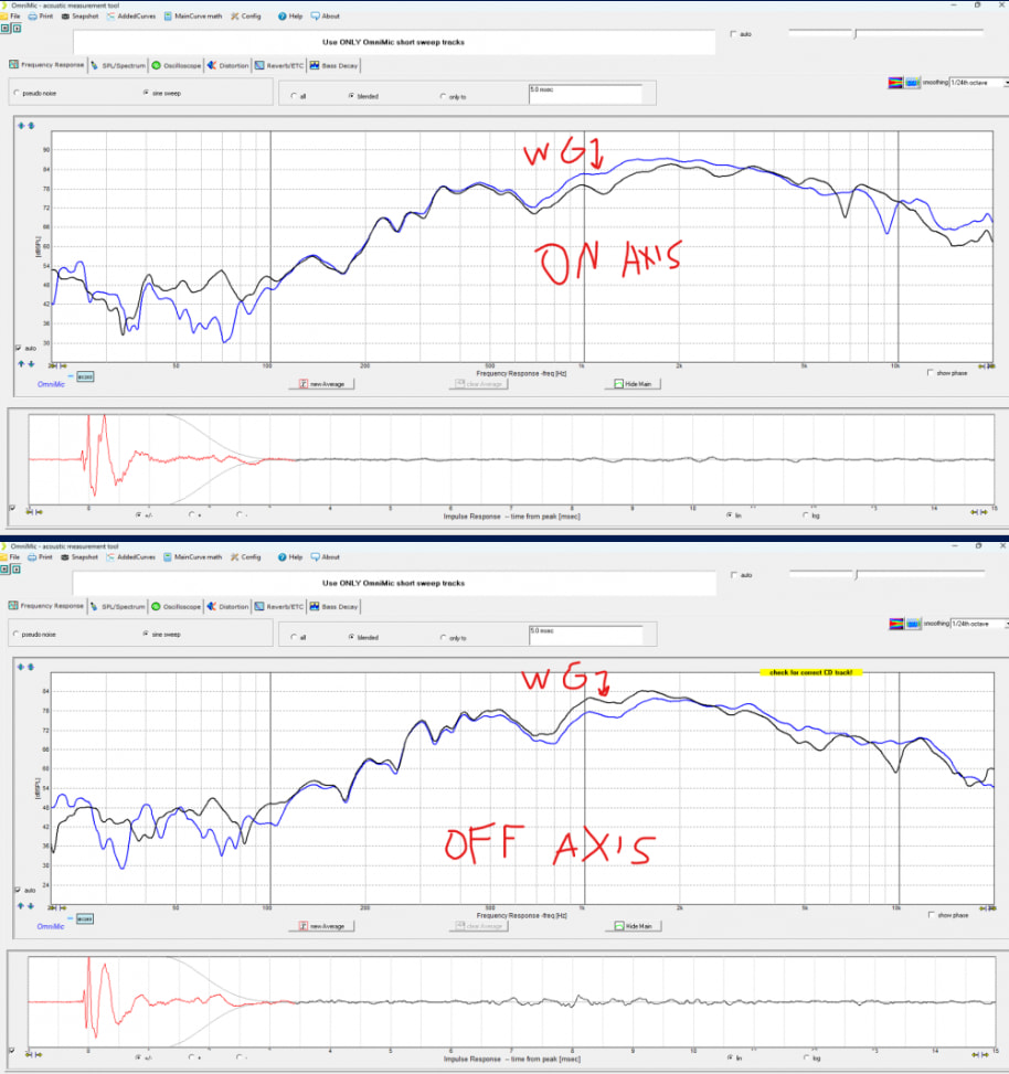

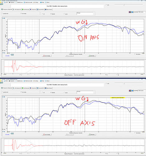

I still haven’t bought these. Got a new job so speakering was put on the back burner. ^^ I was wondering if we had any measurements for the 7600 on vs off axis performance anywhere. JR (or was it you steeve?) posted DM 7500 on and off axis measurements that indicated around 1.2-1.5kHz the 7500 had a sort wider response than may be desirable. Which may or may not have been part of what you were hearing in them. I’m not sure.
