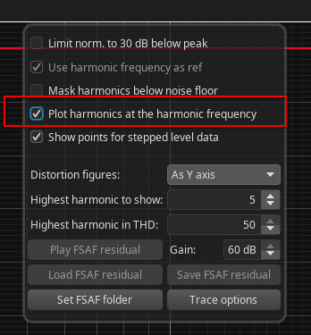

Great measurement, though I always recommend checking the “capture noise floor” box in REW. Reading and interpreting graphs is hard for some though, so can you do us a big favour to help interpret these measurement results? In REW, take these same two measurements, and check this box in the controls (gear icon) and post the images again for everyone:
This option displays the harmonics at the frequency they occur at, ie the frequency in which they’ll be heard, rather than a relative level to the fundamental that creates them which is the typical view of distortion.
For a closer inspection, you can use the overlay tool. Select “Overlays” at the top of REW, then go to the distortion tab, then you can select 3rd harmonic for starters in the controls for a direct overlay of the before/after measurements. Change to dBr scale.
Last, just a reminder that REW includes a screenshot tool for creating images, just click the camera button in the top left of most any graph, you can copy to clipboard there and paste directly to the forum, easy peasy.
