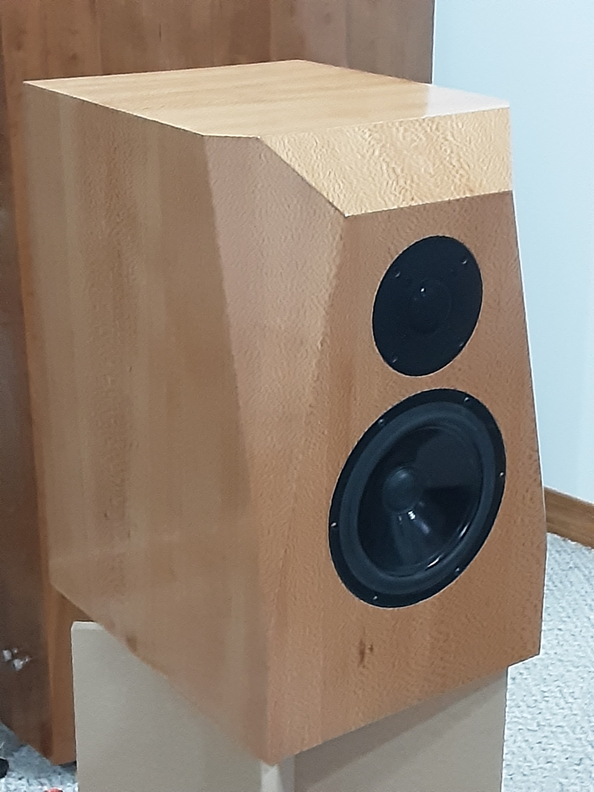

Honeycombs redo
The Honeycombs were my entry into the Indy speaker challenge of using only 5 parts, but I was never thrilled with them and I spent more time on the cabinet construction than the crossovers. Fast forward to a couple of weeks ago . Bevernbi sent a pair of 4.7uf aluminum and oil caps to try, and the honeycombs were the only speakers that were using that size with an electrical 2nd order crossover. Can of worms opened.

What woofer is that?
Looks like Seas CA18RLY, coated paper 7 inch, smaller magnet version
Yep Seas CA18RLY.

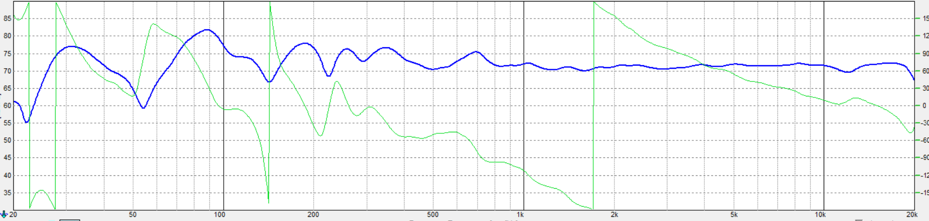

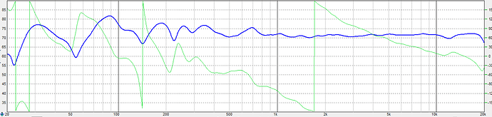

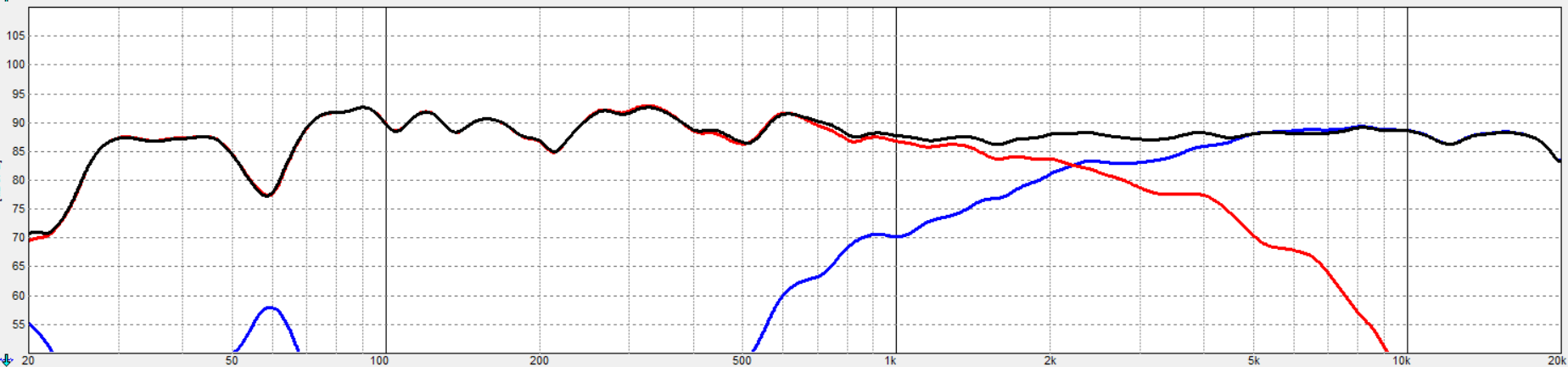

Here’s the wavy lines for these.

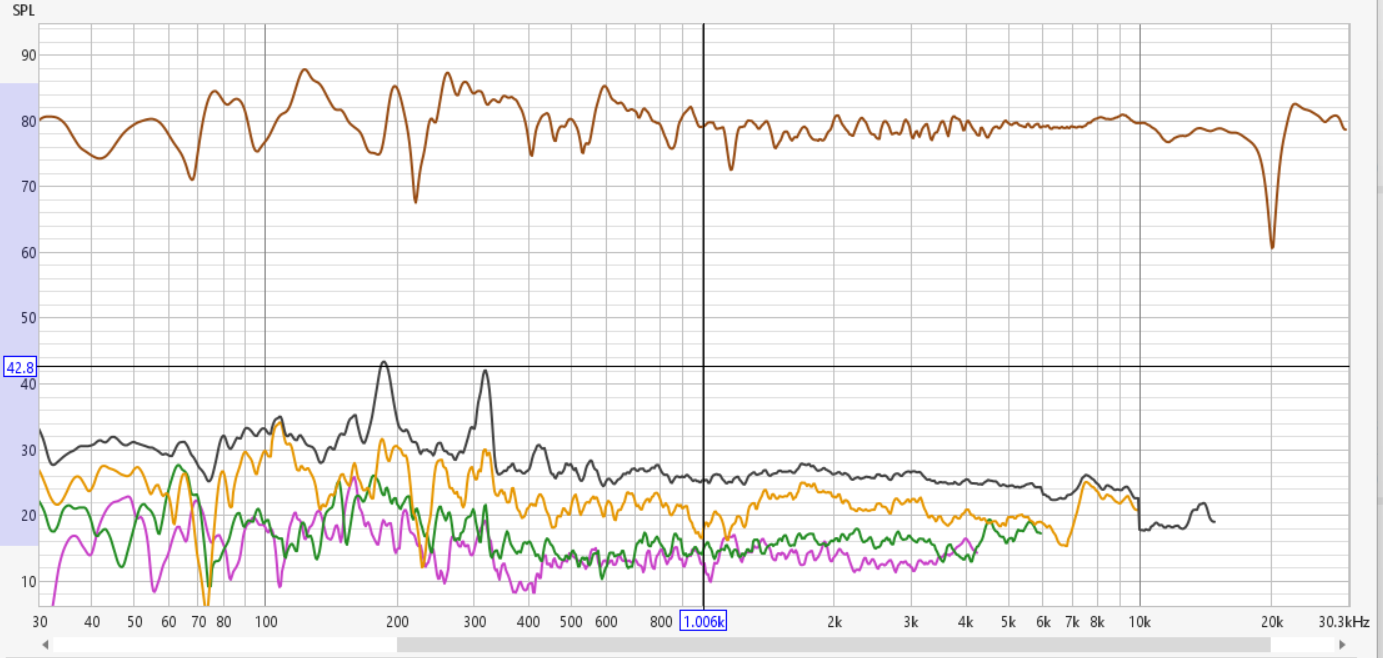

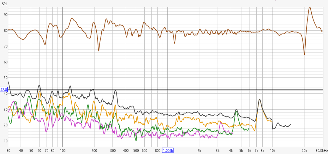

Here are my distortion measurements
no notch filter on breakup

Definitely confirmed on the notch. Nice! Are these coming to Indy?
