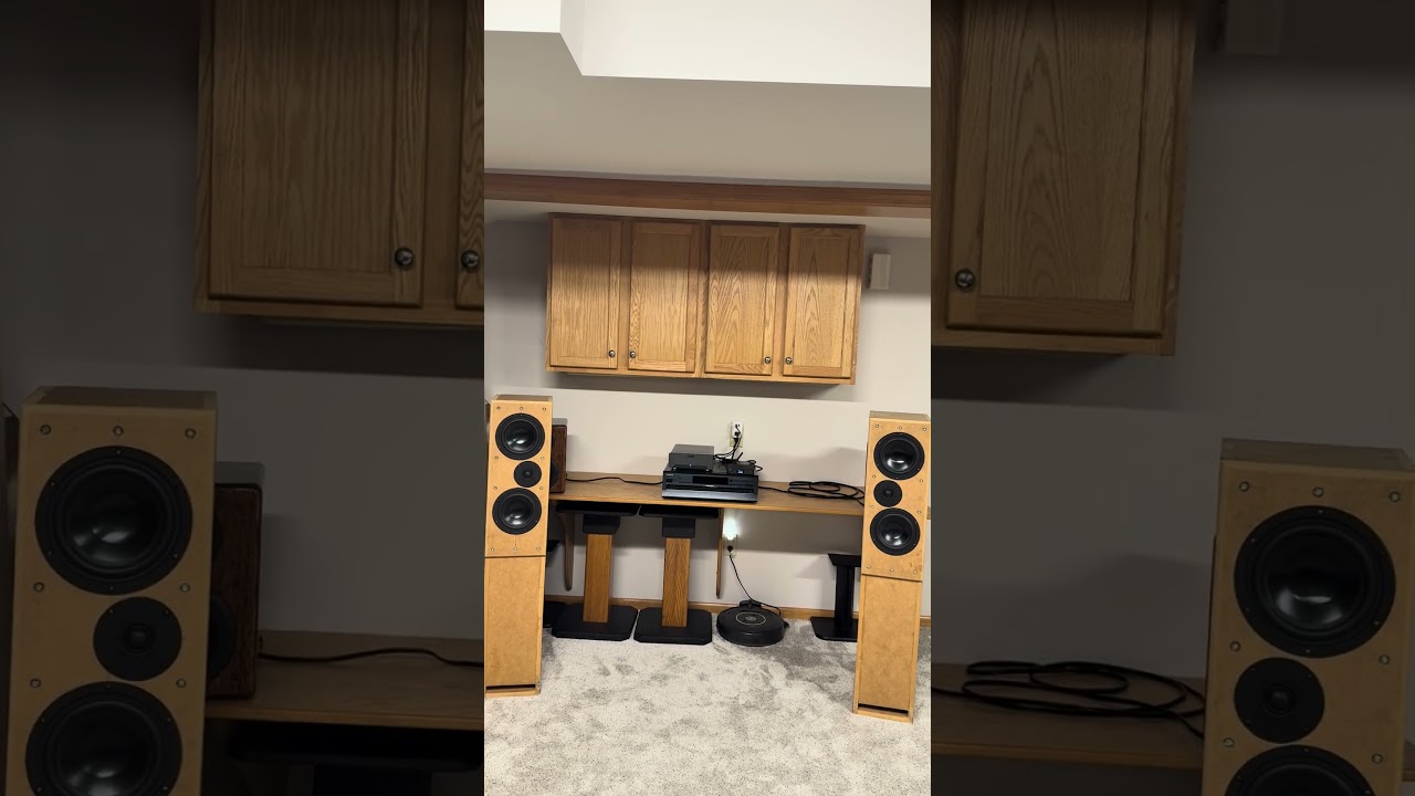

Hypex NC502MP I bought off eBay from Vance in a Ghent Audio case. With my low sensitivity 8ohm bookshelfs it’s been fine. But when I try to play 4ohm moderate sensitivity speakers I get a horrendous squeal from the speakers.
When I first power the amp on it’s dead silent, then as I presume the PS caps charge the squeal gradually increases in amplitude. The severity does come and go some. Last night I recorded the below video where it was atrocious. Tonight during my workout it was audible with no music playing but quiet enough the music would mask it.

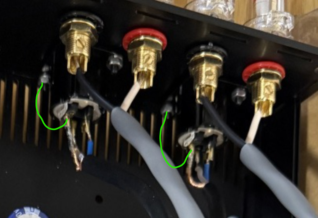

It will do this with or without the inputs connected, although the pitch does change slightly if the inputs are unplugged.

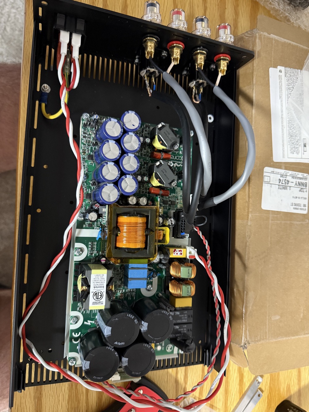

Here is the internal wiring.
Does it do that with any other speakers you own, or just those MTM towers?
I’m curious if it isn’t the speaker somehow.
It does it with both those in the photo and the Alphas. It also does it with the Duality Peerless, which are also 4ohm, but being that they’re lower sensitivity (by a solid 5-6db) than these two it’s not as aggressively loud. But yeah, not an issue with the speaker itself.

Ug, sounds like something up with the built in power supply section. Feel bad as not guru on smps stuff and know Vance not a shady character.
Glanced over datasheet where nothing jumped out immediately as needing handled (like pulling some pin to ground etc.)
Think maybe an email to Hypex in order to understand what likely cause is since would guess they’ve heard the complaint/symptom before.

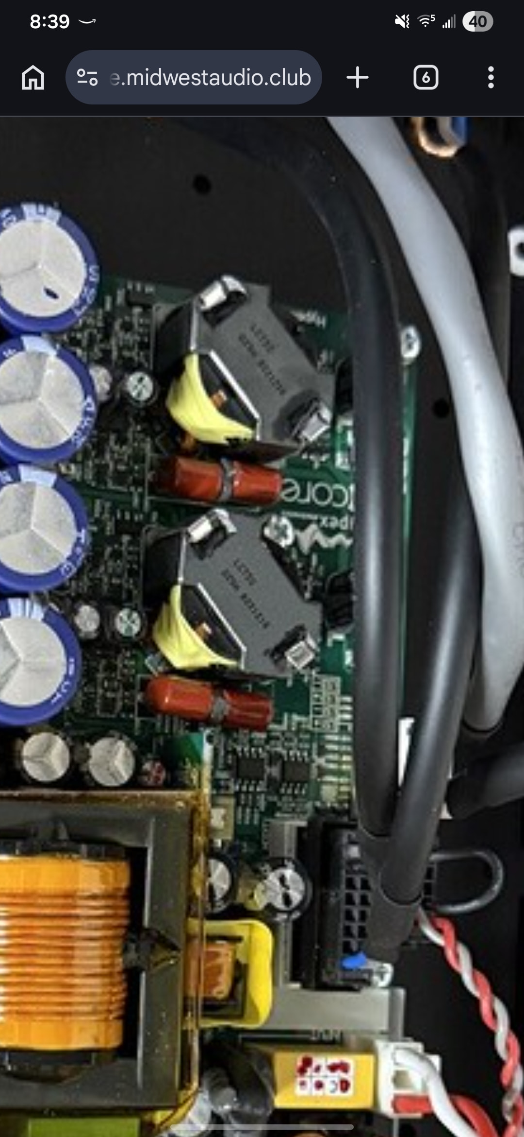

Top right hand corner ther is a capacitor and inductor that are there to filter the switching noise out of the amplified signal going to the speakers. I would check them to make sure the values are within spec and that they are soldered in correctly. Larger components like that can shake loose and are harder to solder in correctly as the inductor sucks the heat away from the joint like a big copper heat sink.
I wondered if something like that could be the cause. High frequency behavior and differing loads were my hunch. Since these are known for good filtering, I brushed that idea aside earlier.
The amplifier makes this noise even with no wires connected to the input. Is this still a pin 1 problem even if there can be no current on pin 1 because there are no input wires?
I should make this change regardless based on those app notes
I don’t know a lot about Class D amps, but the general rule is if both channels exhibit the same problem, that points to the power supply. Do you know what voltages are supposed to be coming from the supply?
I do not know PS voltage off hand. I’d have to see if they have that in their tech specs
