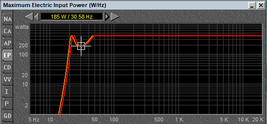

It bottomed out occasionally ever since being installed in the Besta cabinet. It turns out that little bit of power limit that shows in the model was in fact dangerous and movies would hit that 30Hz spot hard. From my initial analysis on that page I thought “this shouldn’t be a problem”
That was in fact a problem it seems. The old 200W plate amp shouldn’t have been able to over power the woofer, but it did. Likely I was clipping it a bit when it bottomed the woofer. Funny thing about clipping a subwoofer amp, it’s not as noticeable as it is on a full range speaker. That distortion is easily hidden by all the rattling things all over the room at that point.

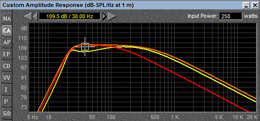

And now for the replacement, dropping in with the same diameter hole and 8 machine screw threaded inserts to match to the 3.4 cube box tuned to 22Hz. I spent way too much time agonizing over different models to make a decision.
The red line is the GRS 12SW-4HE, the orange is the RSS HF sub that shows a very slight advantage. The yellow trace is the MX12-22 which appears to like a smaller box and / or a little higher tuning. I also modeled the Ultimax II, which looked very similar so I didn’t end up saving it.

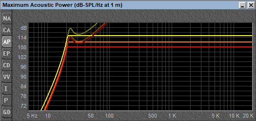

All of them work without that over-excursion threat in this box. The GRS is maxing out at 108.5dB @ 250W, the RSS at 111.6dB @ 400W and the MX12 at 115.5dB @900W. Using my same 200W plate amp, those SPL advantages disappear.
I couldn’t help but go with a GRS. Based on the cost and specs this should by all counts be a downgrade. Even though other options like the RSS or the MX12-22 all model well, they don’t have much of an advantage over the GRS unless I also pump at least twice the power into them. The remaining variables are if the GRS specs are reasonably accurate, and if there is a distortion difference in the higher end drivers. I have an 8" version of that GRS and it’s specs do measure close enough to published values to make the modeling good. About the distortion, I’m sure there is a difference but doubt it’s large enough to matter in my application. Ultimately the GRS was about 1/3 the price for similar performance so it won! It arrives today and should be back in service very quickly.

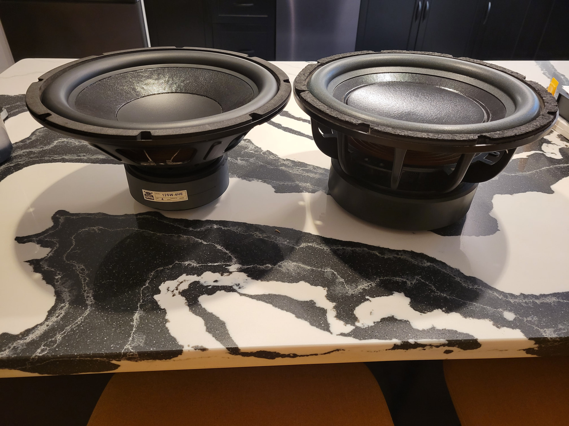

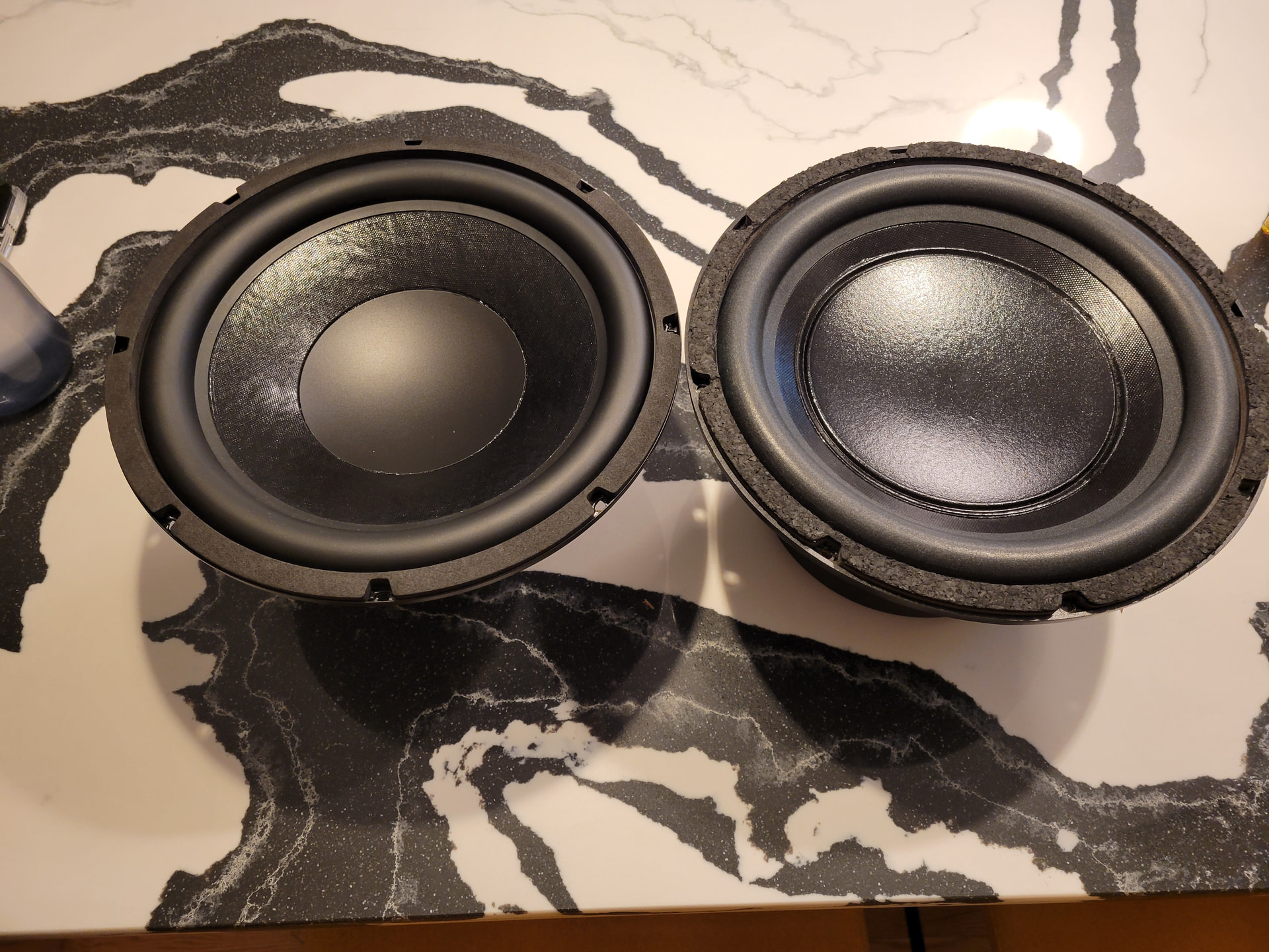

2 woofers, one obviously more expensive, but the other actually moves freely. Powering it up tomorrow.
