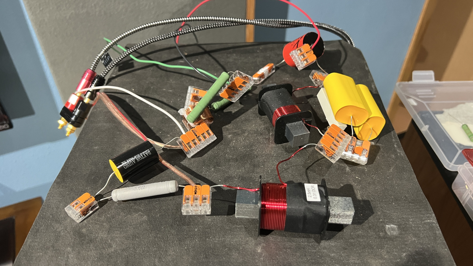

The Voicing thread put me in the mood to take another stab at my design for this year. I leaned heavily on the headphone matching approach. Went from a 3rd order electrical on the tweeter with a contour filter to pull down the top octave, to just a 2nd order. Woofer is 2nd order with a notch filter. I chopped it from 16 parts down to 10 and it sounds better too.
