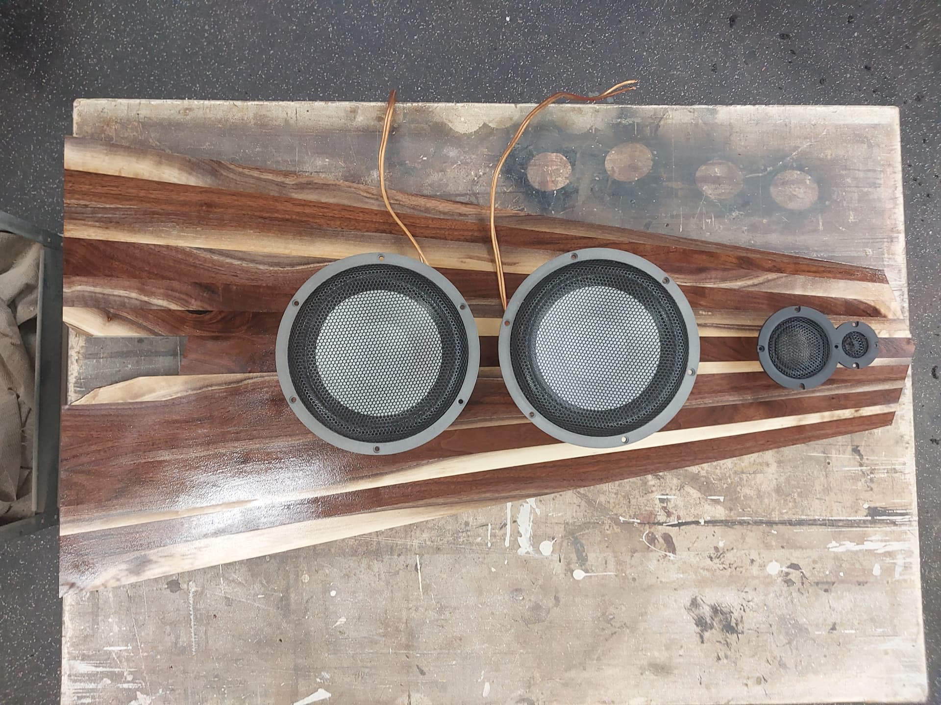

I had some walnut live edge slabs 1.5 inches thick for speaker baffles.
Rocket3W.pdf (12.8 KB)
I decided to rip them up into tapered strips and glue back together using PVA glue tinted with powdered pigments. This allowed me to not have to run every strip on the jointer. It worked pretty well with some dark grey glue showing in some areas. Drivers will be rear mounted for maximum wood exposure. The rest will be made of double refined 3/4 MDF. This will be a simple slim cabinet with a front port down between the legs. Drivers are Fountek FW222 8inch woofers and Dayton CF50 and CF18 matched pairs. I plan to spray paint the woofer cones to make it all matchy matchy. This will be all passive. I would also like to incorporate some workbench casters for ease of moving.

Cool project. Looks nice. To be fair, I think the drawing looks a little egg shaped toward the top. So maybe it really is Eggguy. :smiling_face_with_sunglasses:
If you spray-paint the woofer cones, you will add mass and change their frequency response in unpredictable ways. I think they look perfectly fine as-is, if you can live with them.
I like the overall appearance and shape. This project will be groovy.
It could still be a TL
Love the appearance - I would have that in my Living Room :grinning_face: :grinning_face:
Cheers / Robert
That looks great!
I don’t see anything wrong with what you show in the photo. Front mounted and not color matching looks good. I guess the large color variation in the wood allows for the variation in the drivers.. to me atleast.
If you can’t live with the cone color. Yes, paint would alter mms and potentially have other effects. I wouldn’t be too scared to try painting cones myself as long as the paint is very watery and do the lightest mist coats to slowly build up the thinest layer required, in order to minimize changes.
Yes it could, but I was thinking about keeping this one simple.
Yes one light coat. The grill helps to obscure it anyway. Probably gonna add only a fraction of a gram.

According to winisd a round port tube should not be closer to any internal wall than its diameter, yet a slot port is typically all the way down to the bottom. I am considering a front slot port 1x9 by 6.75 long Internally it will be at the bottom but due to the backward tilt it will be 1.75 off the floor. Any better ideas out there in speaker nerd land?
My only advice would be to design the slot so that it is fully adjustable. Then tweak it to final length using NF measurement data.
“should not” as in: The result will begin to deviate from their model. Not that it is a bad thing. Just more of an unknown.
Generally I hear that slot ports will result in a lower tune than the typical calculators will show.
Thanks, I plan to make the back of the cabinet removeable in order to blind fasten the baffle. So I will be able to adjust the slot port length.
