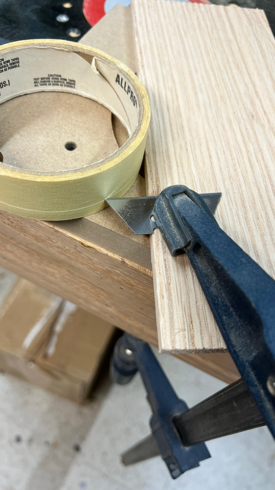

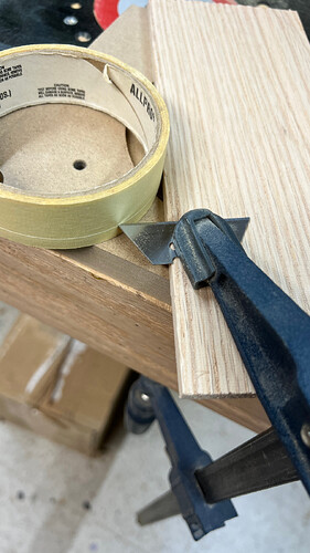

Need a thin strip of masking tape to wrap a router bit bearing?
I have had better luck putting the painters tape on the edge of what Im cutting. When I have done the tape trick the tape always seems to fall off.
YMMV
Heatshrink over the bearing might work well, never tried that.
Also dump the 1/4" flush trim bits. Use at least a big 3/4" diameter bit. It’ll have a bigger bearing that’s also thicker.
If you have to use a 1/4", find a dual bearing one.
