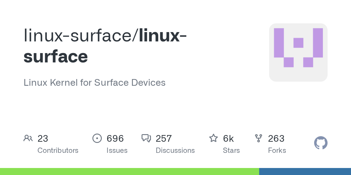

There is a whole project around Linux on Surface just to address some of the hardware. It isn’t up streamed yet so requires manually installing a different kernel.
I can wait and see how that project evolves, the device as-is works pretty nice.
Some information in there about why Linux isn’t quite ready to play nice with the Surface and some of its hardware. As a small laptop, it works great out of the box, but if you want to be able to use it as a tablet then it takes this additional package. Will be awhile before I attempt that.
