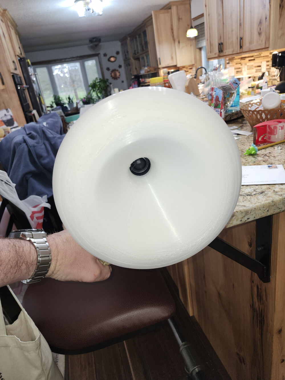

I was working on a speaker that I had built a couple of 3d printed horns more based on looks than anything. The link is below.

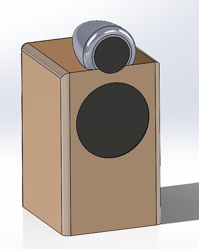

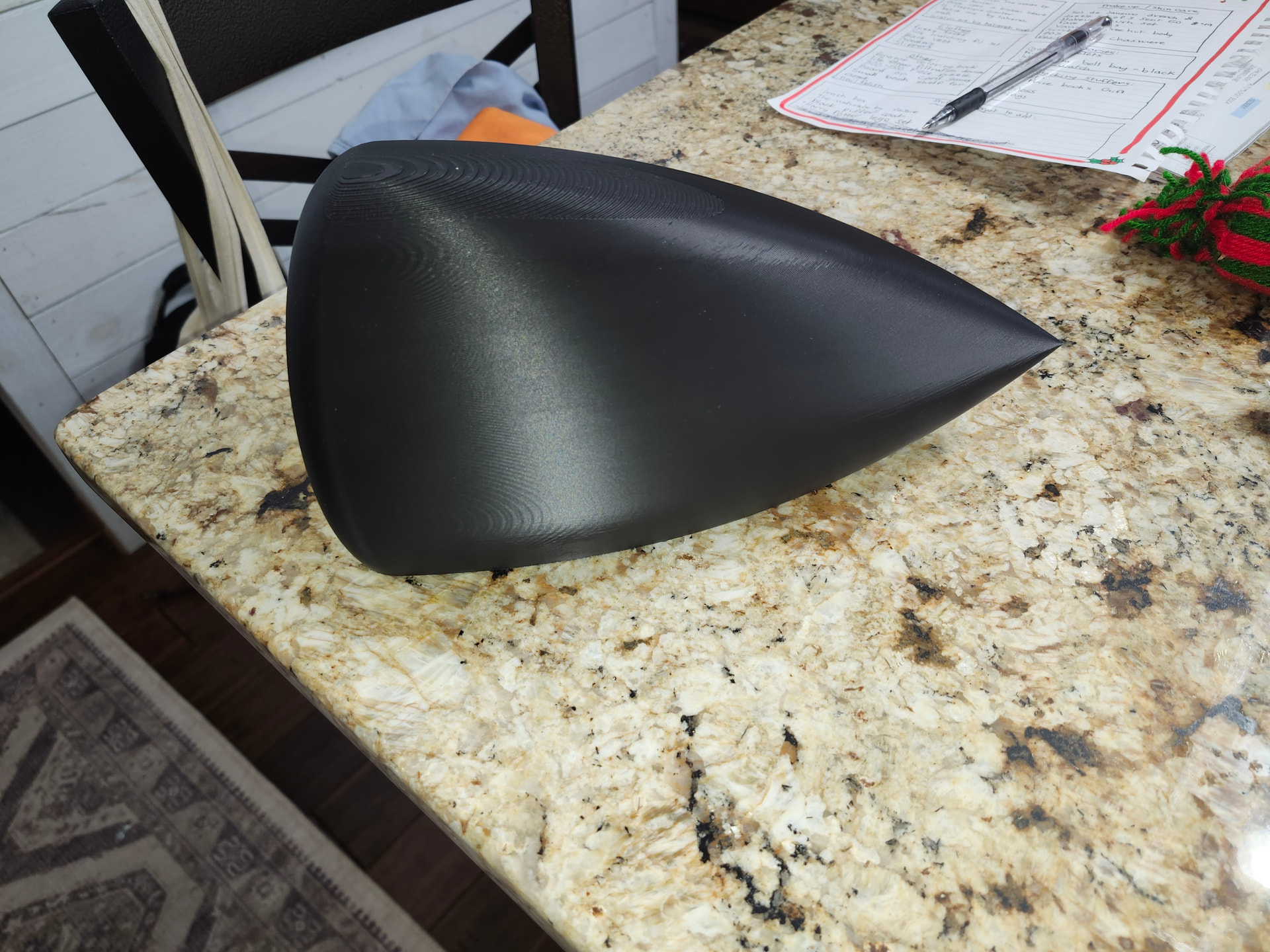

I used the beastmode tweeter and the DA25BG08-06. I wasn’t happy with either of them in the horn. That is my fault for sure, because I did not use any modeling to make the horns, just Solidworks and some online images that I was modeling after. I really like the woofer in the current alignment, and still want to use it. I thought I would make a speaker pod for the top and use the beastmode tweeter. We will see how this one goes.

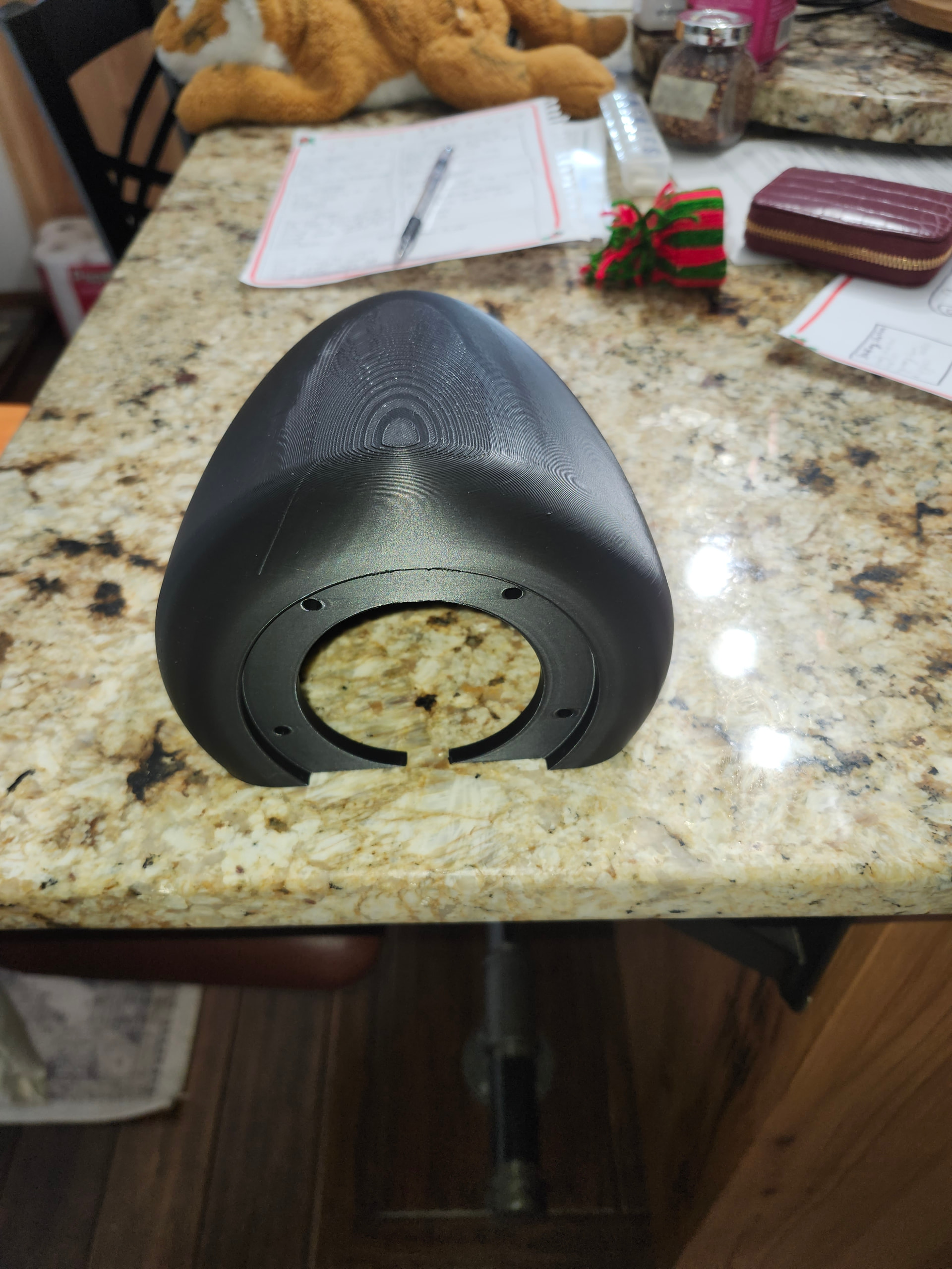

That looks phenomenal. I will interested how the tweeter measures on the pod. I will get something printed overnight. The hard part will be routing the lower part of the tweeter into the front baffle.
3d printed template to the rescue

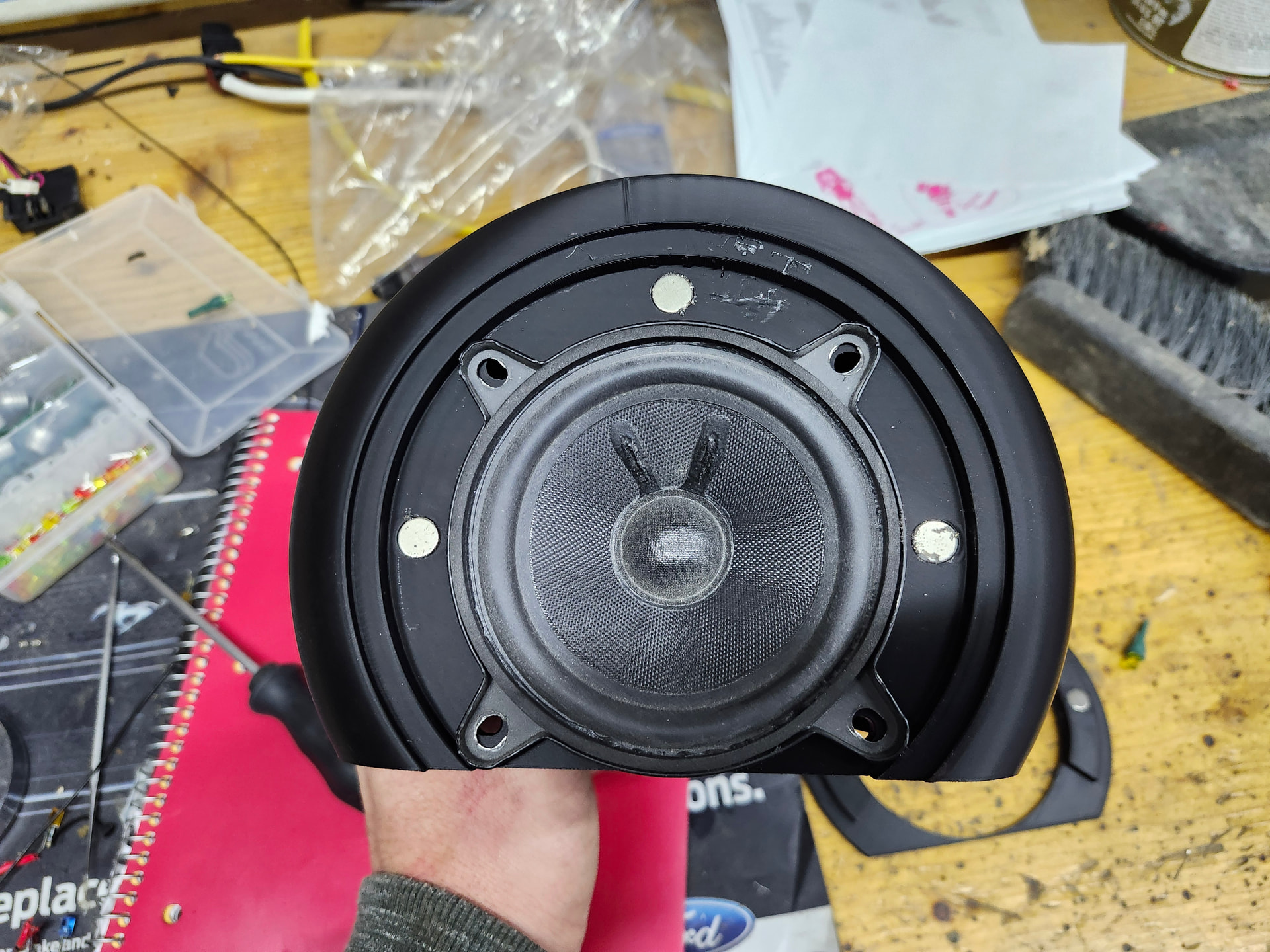

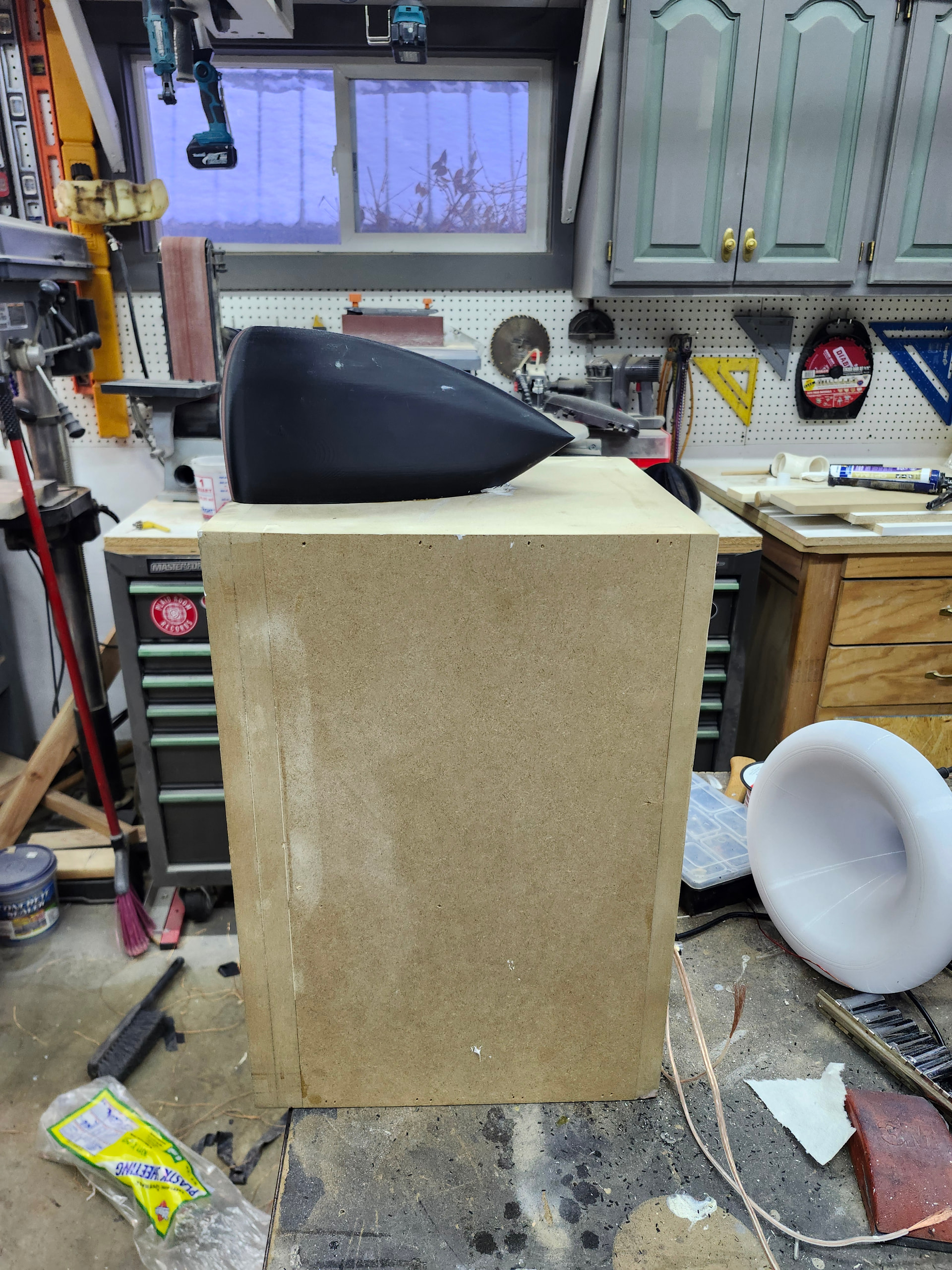

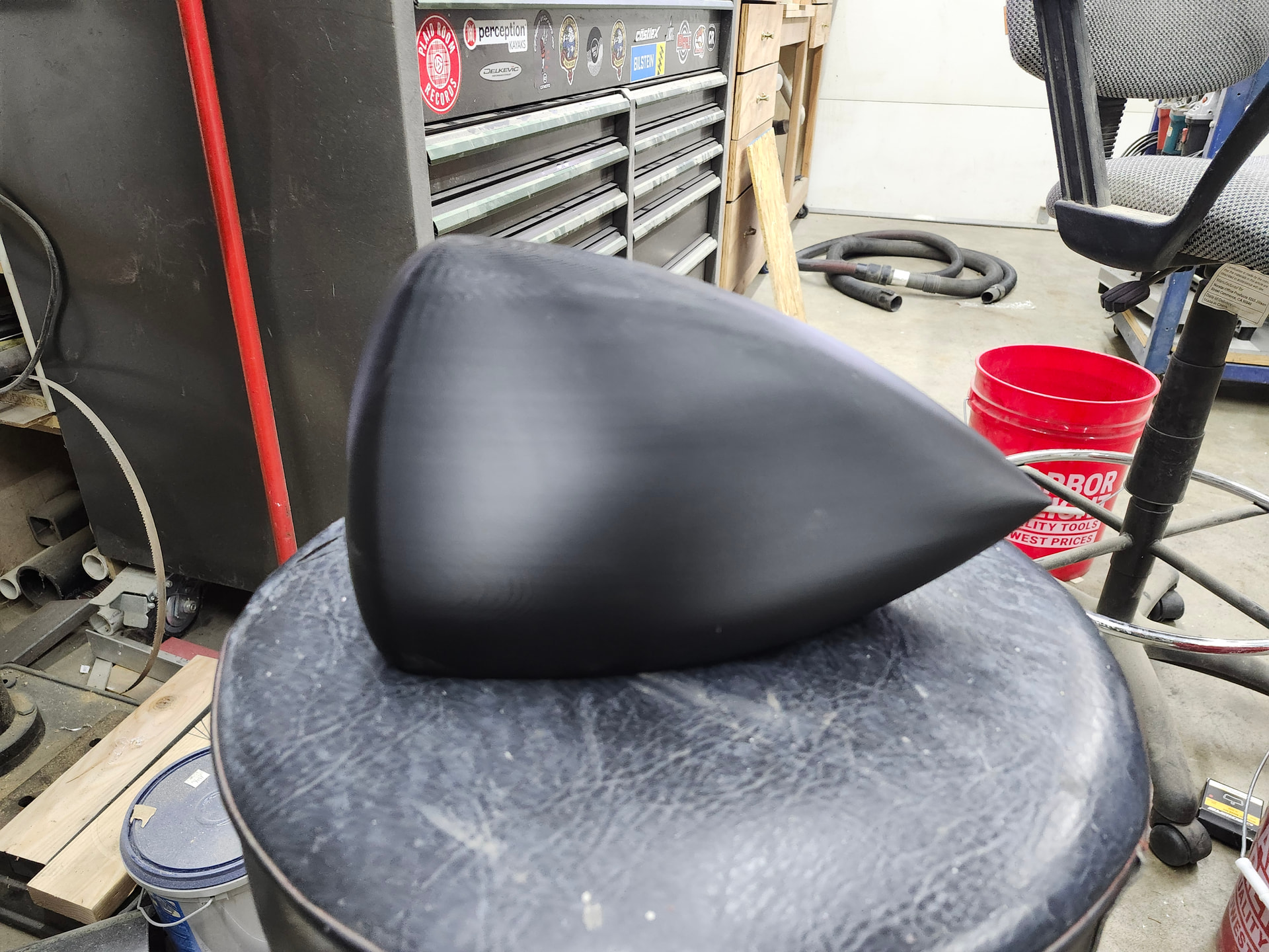

I got one of the pods printed. I will try to get it mounted this weekend and take some measurements.

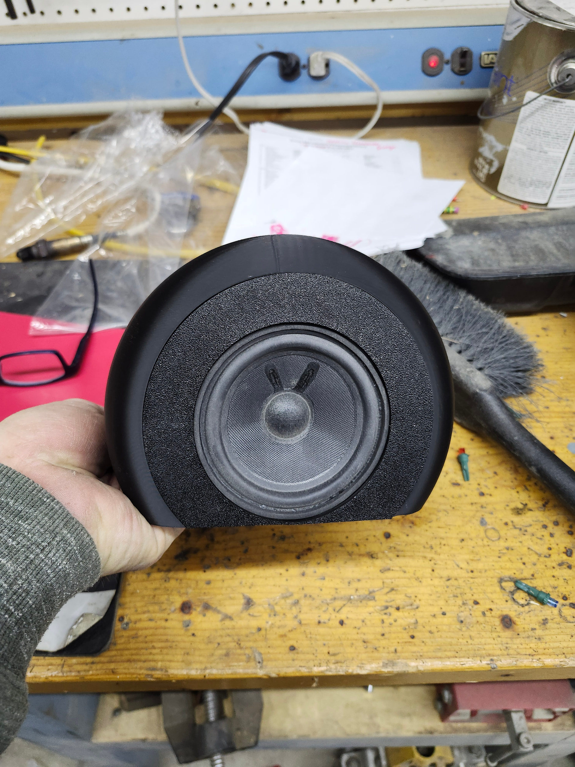

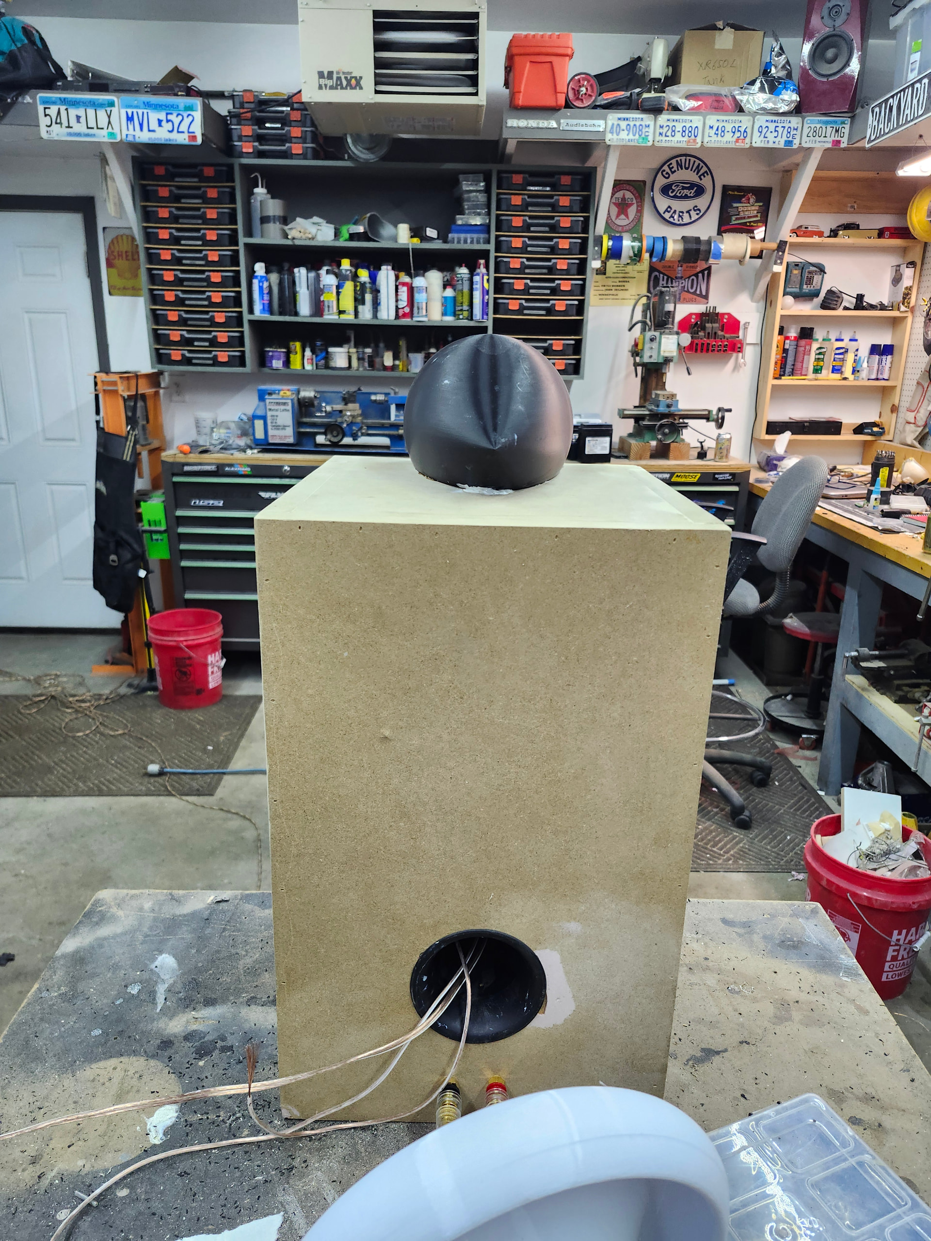

Got one put together and started taking measurements.

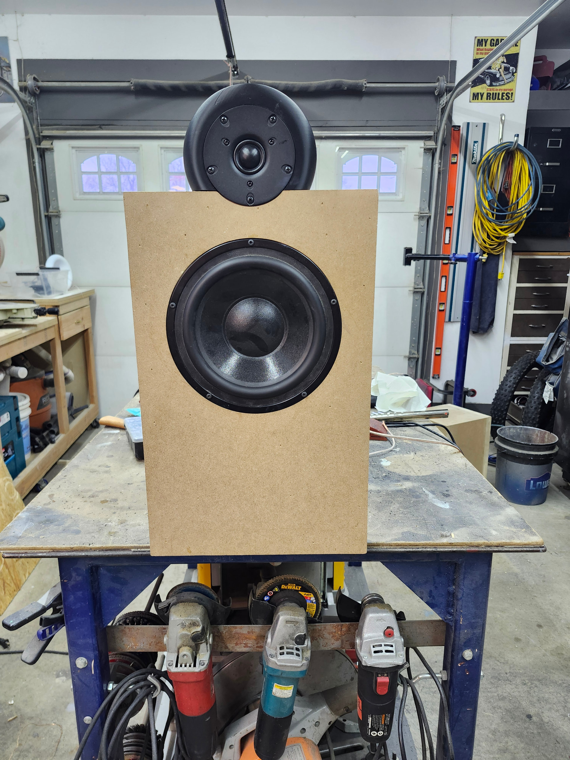

I got some measurements taken, and they don’t look too bad. My only concern now is whether the CTC distance of the woofer and tweeter it too big. I was trying to still use the box for the woofer, but may be better to just start over. Not sure yet.
Glue a block inside the top front corner so you can carve some meat out the top of the cabinet and push the tweeter farther down the baffle? Could probably even freehand the notch/cutout with a router. Any uglieness would be hidden by the pod housing.
I modeled it in CAD and few ways, and I think I am going to save the drivers for a future project.
Lets see it. Maybe we can make suggestions to make it work.

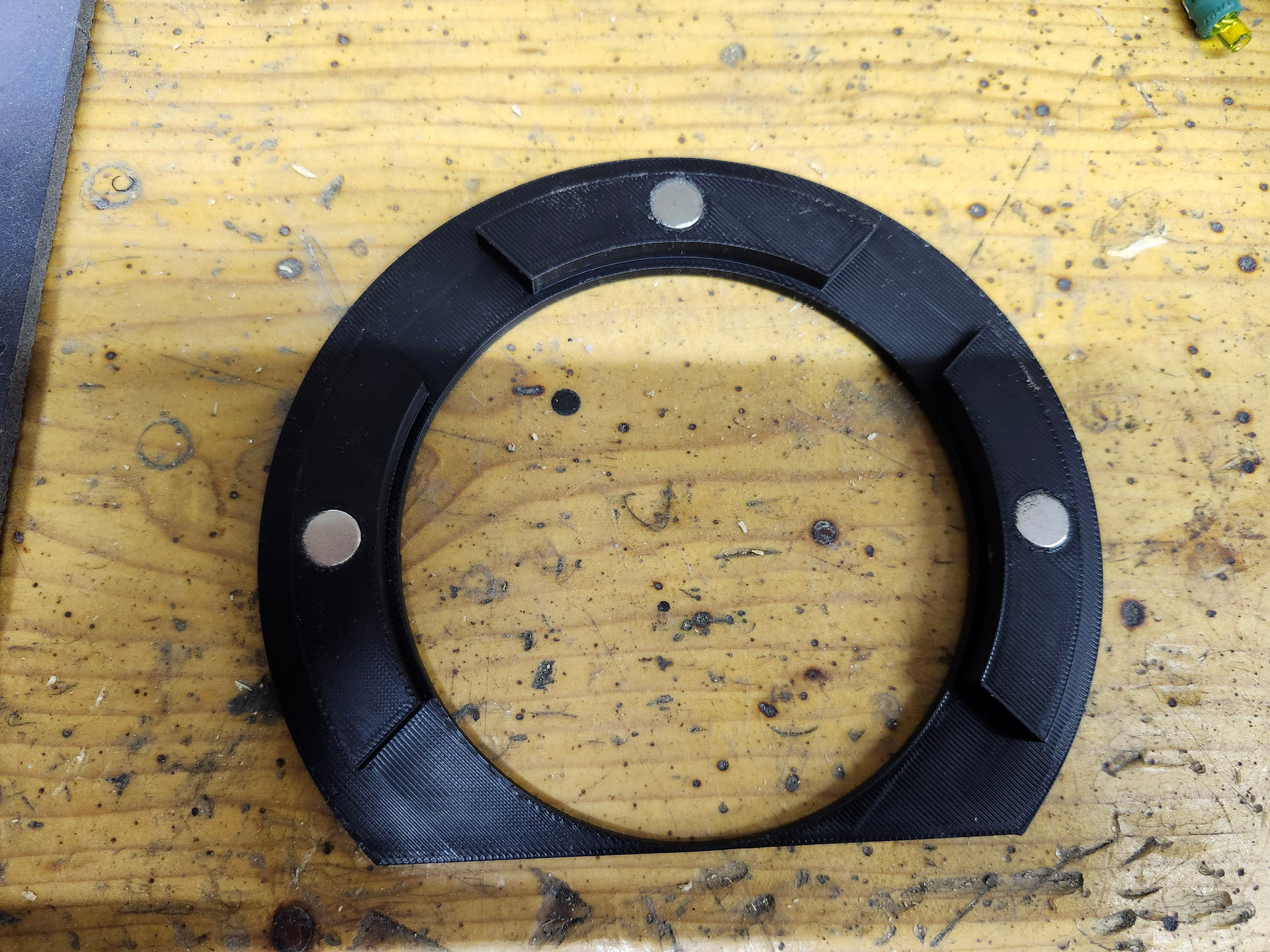

I decided to make a WAW with a Faital Pro 4FE35 that I had laying around. I made a magnetic beauty ring to hide the ugly ears of the 4FE35.
