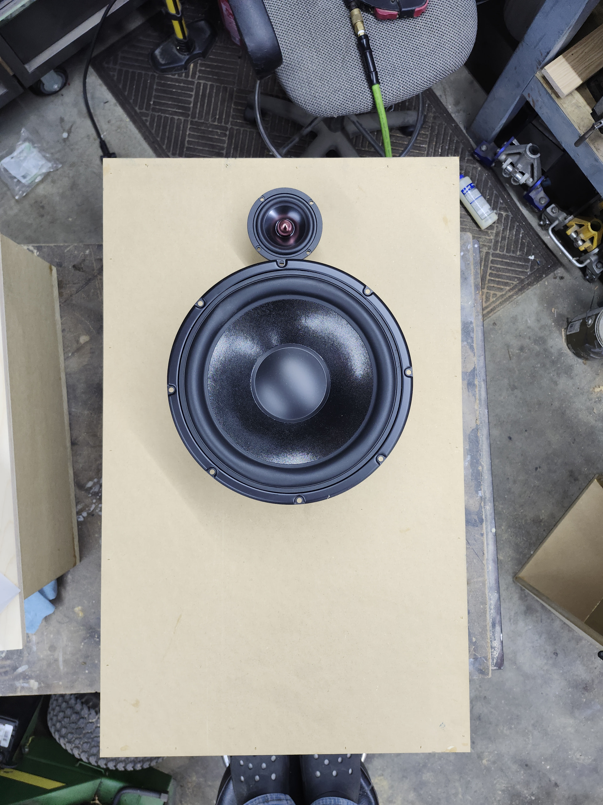

My version of a Devore Orangutan O96

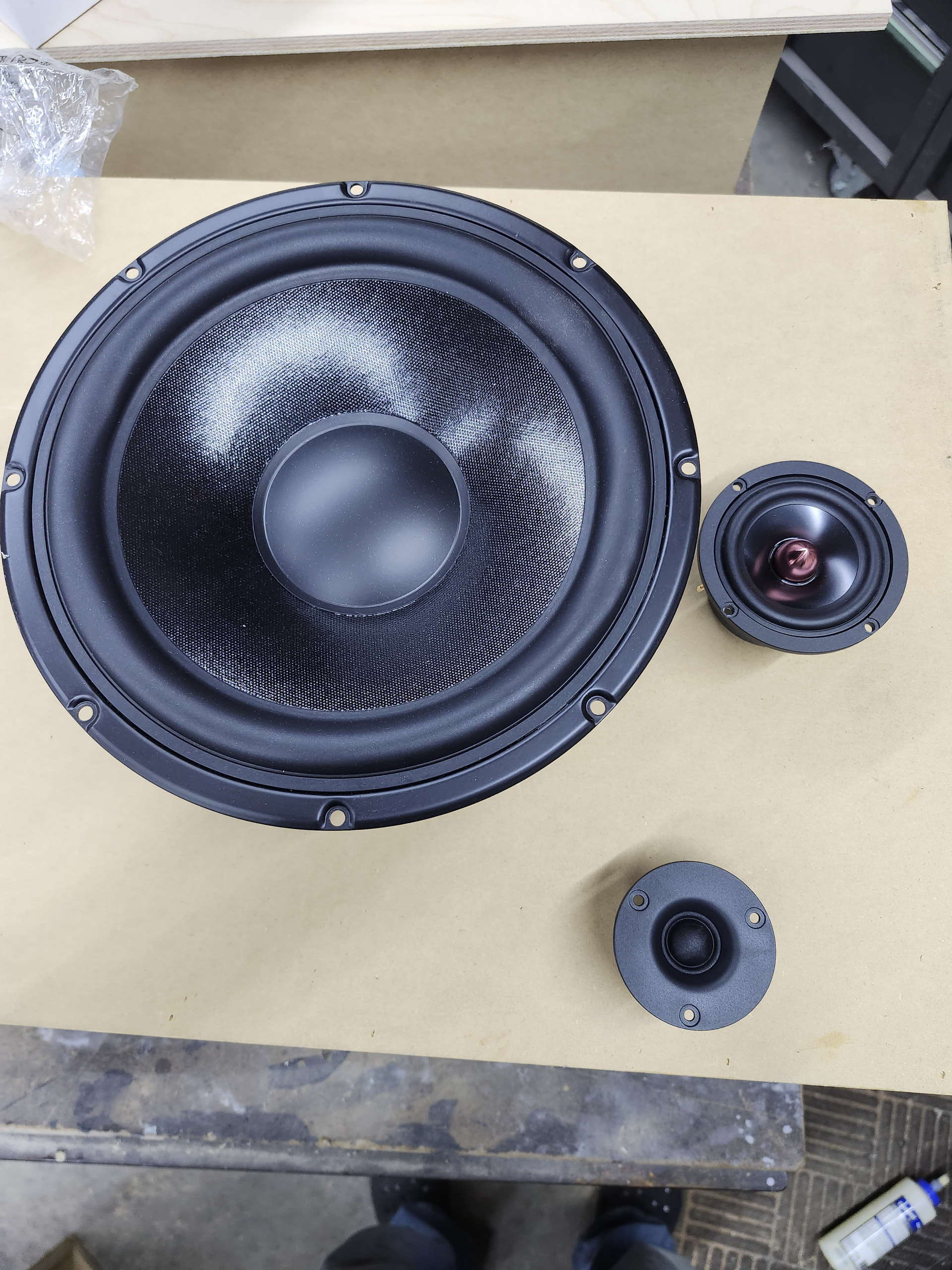

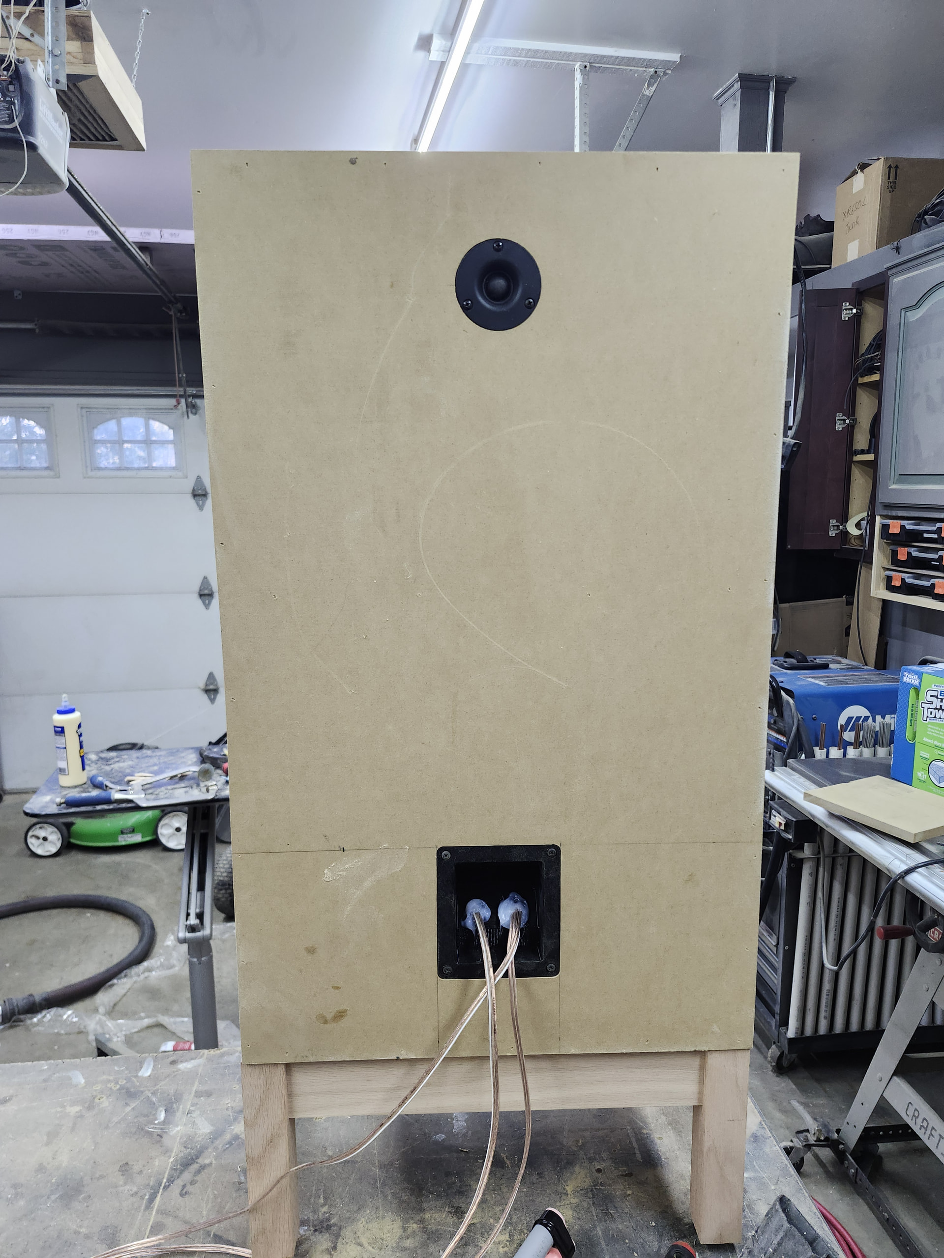

I have always loved the look of the Devore Orangatang O96. I am doing something completely different though. I am going to use the Denovo Audio PS92-8A as the mid tweet crossed to a sealed Peerless P830668. On the rear i am going to try the Peerless DX20BF00-08 as a rear firing tweeter. If I dont like it, I may not use it for the finished design, but I have never tried one before.

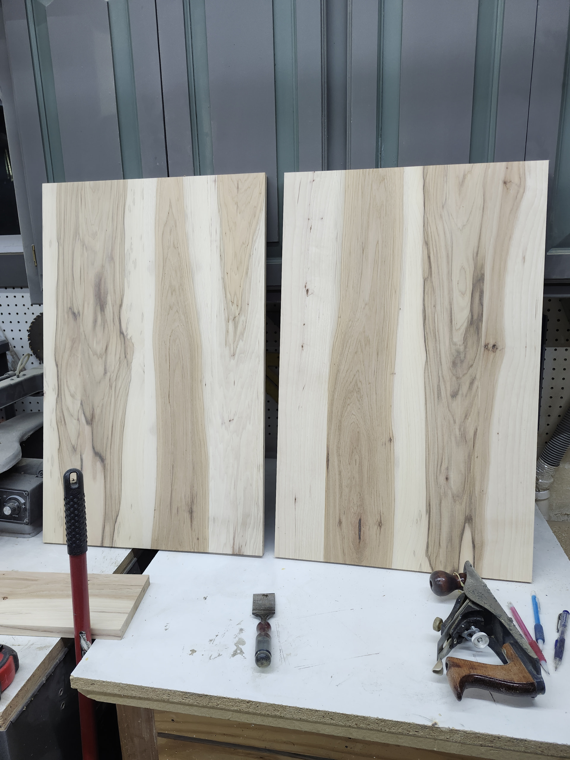

good looking wood pieces

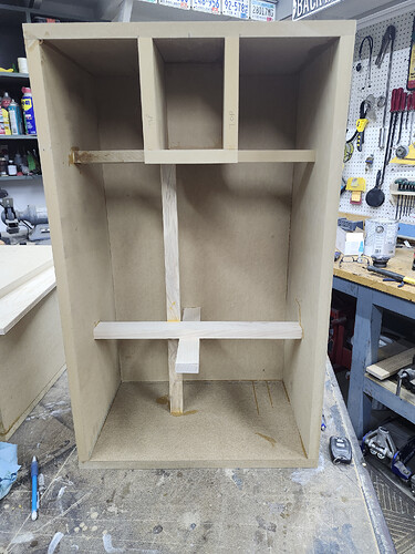

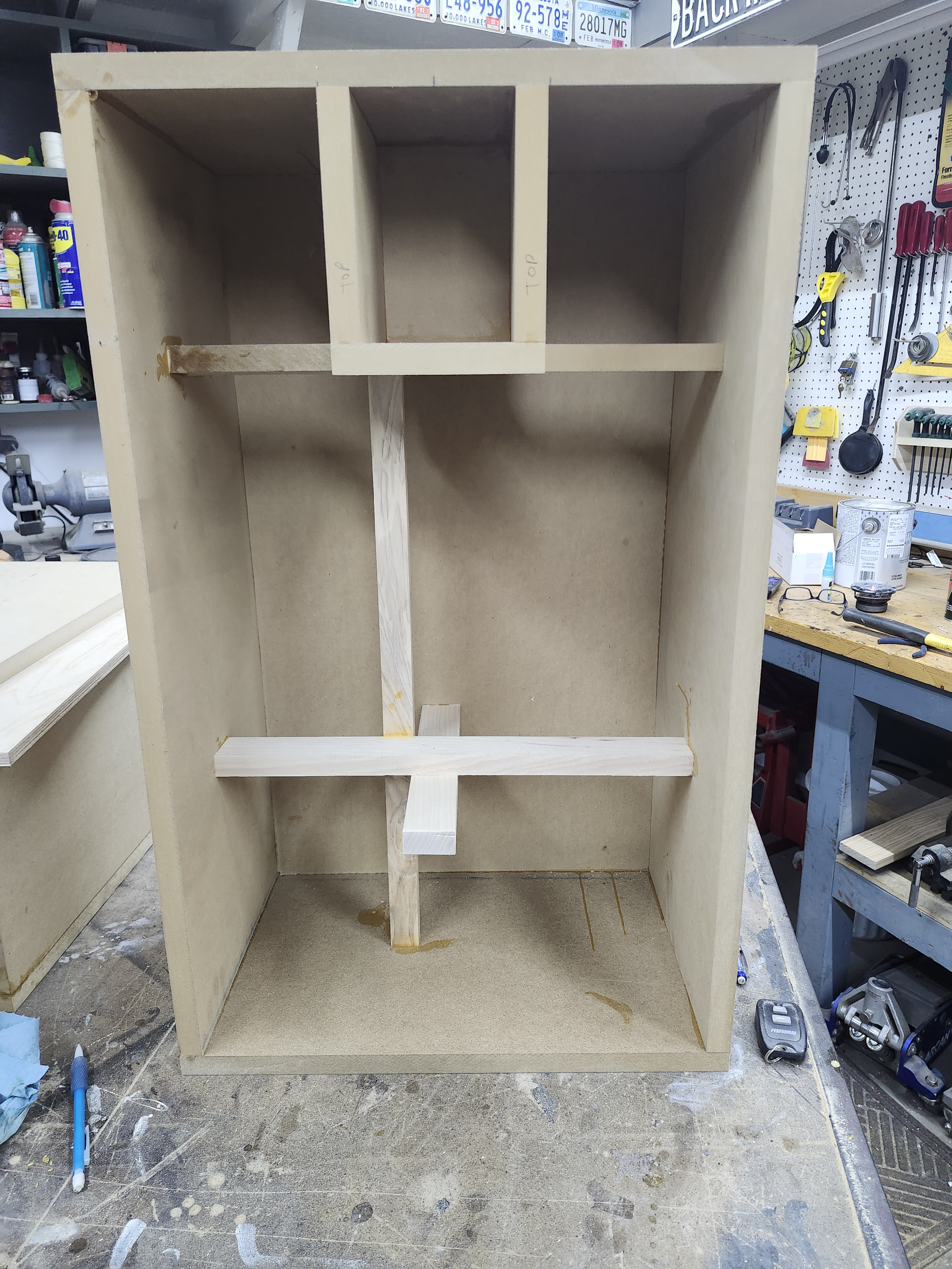

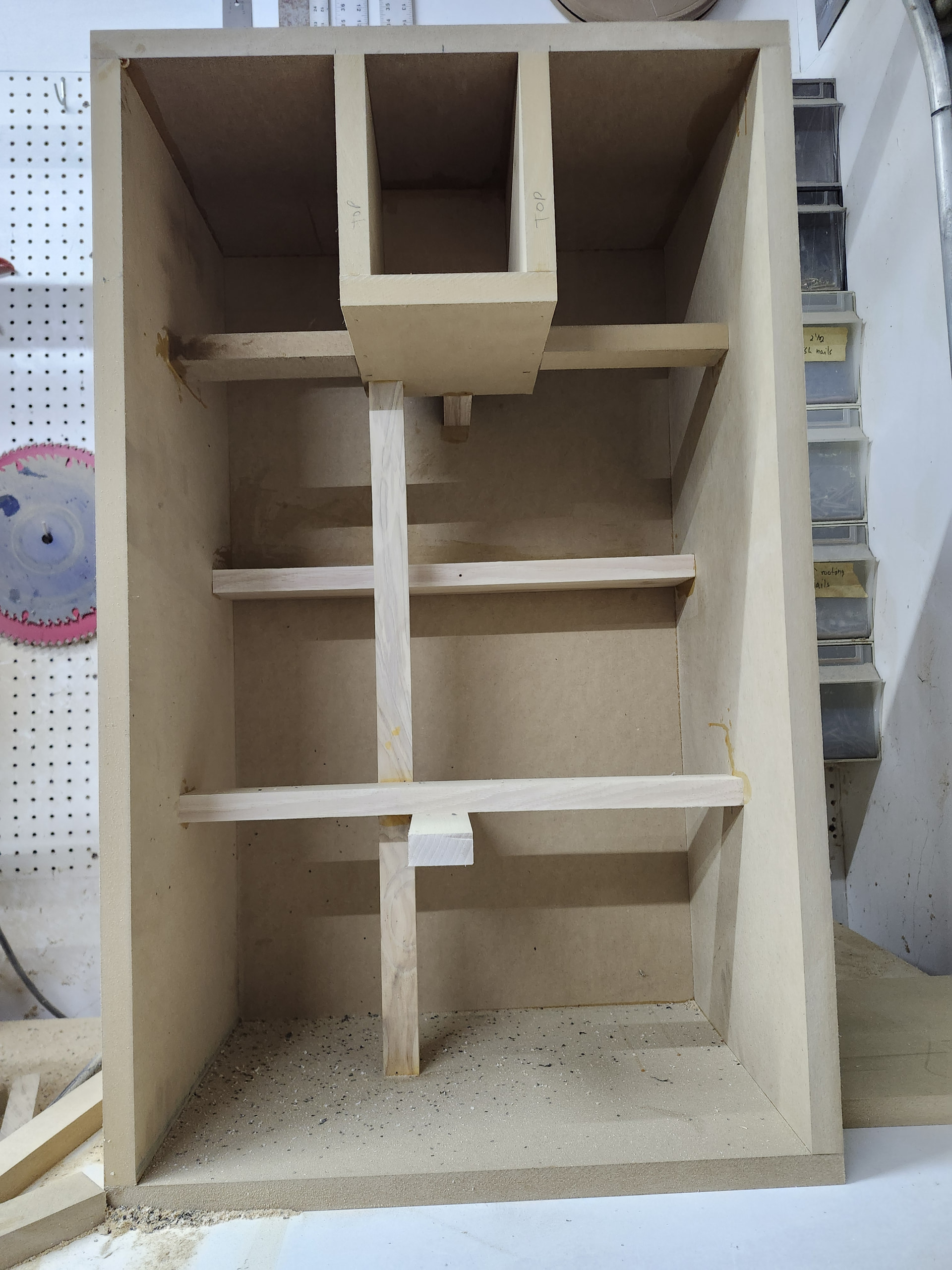

Made a little progress today. Next up damping material, then machining the fronts for the drivers.

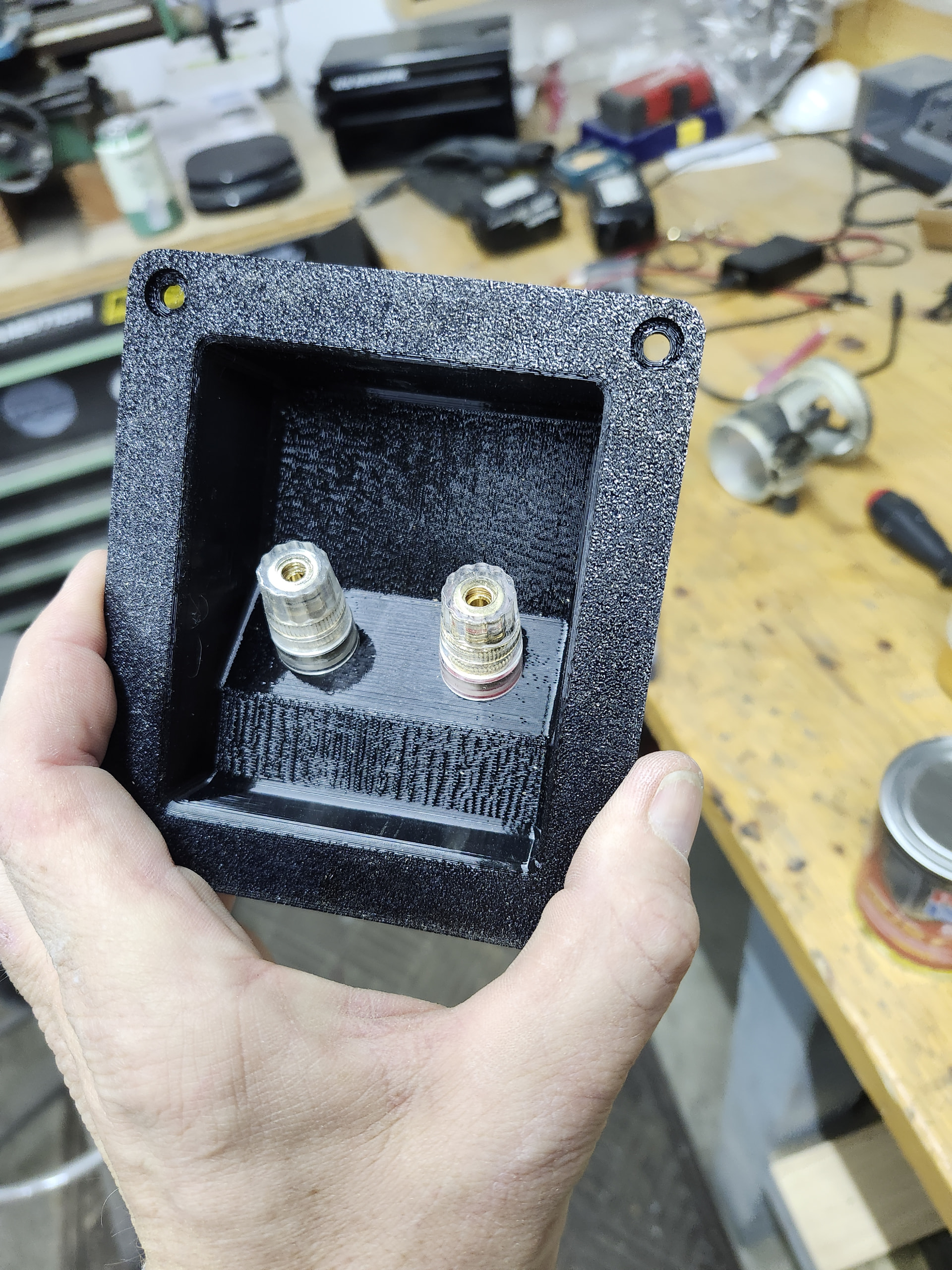

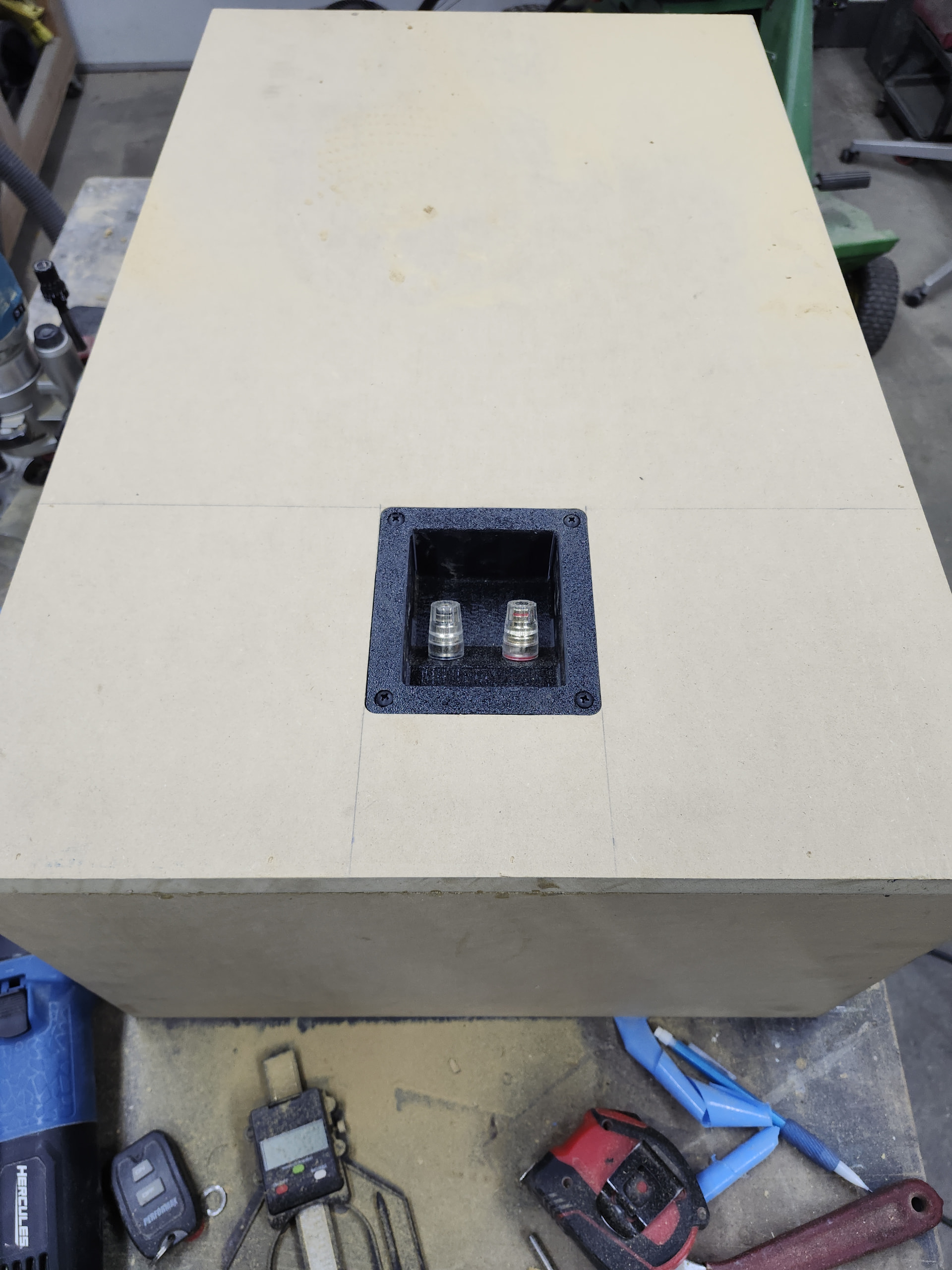

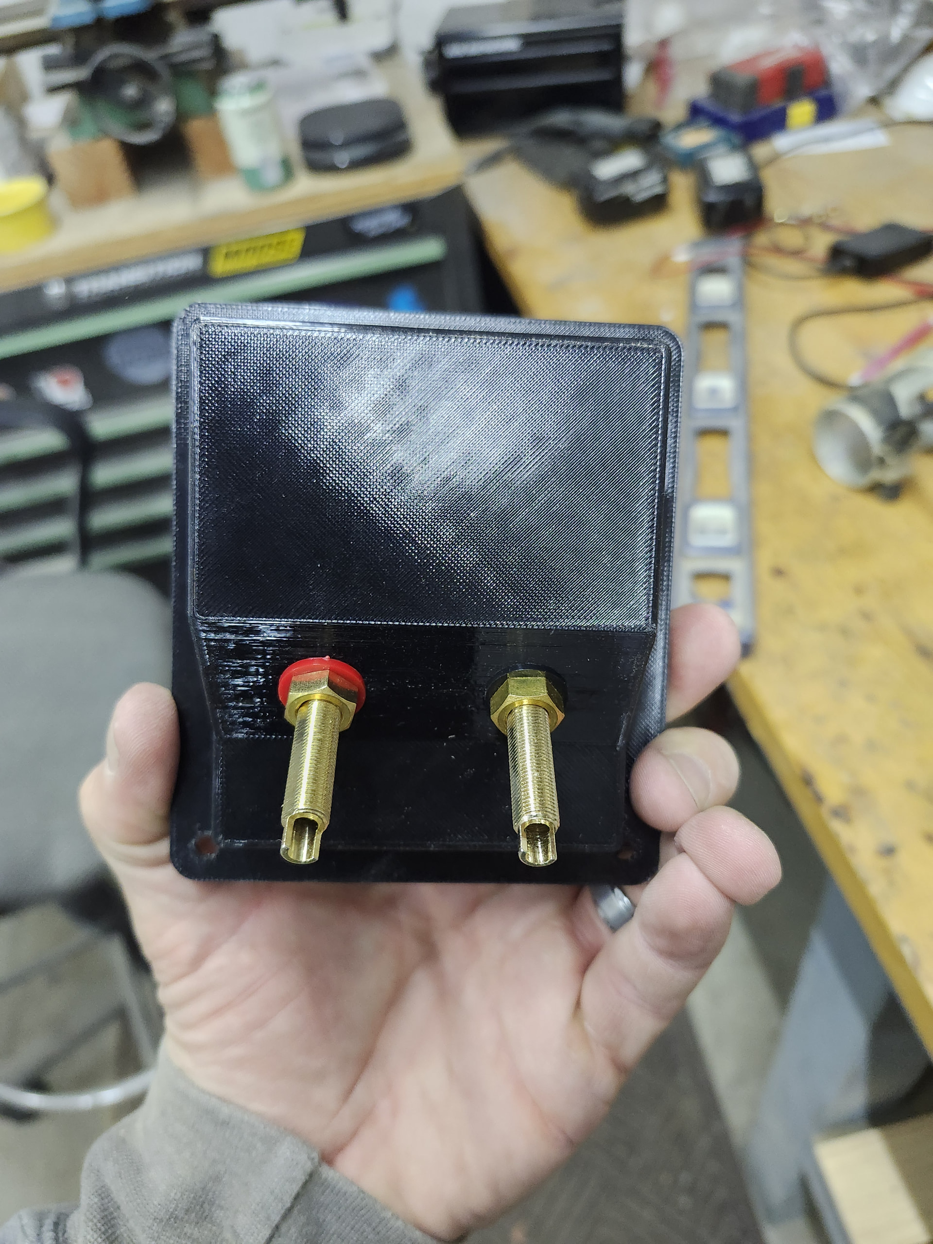

Not a lot of progress, i was building a sub for a friend using a GRS 10SW-4HE and the Dayton SPA250. It wss a great combination. I got a couple of terminal cups printed and a little extra bracing added.

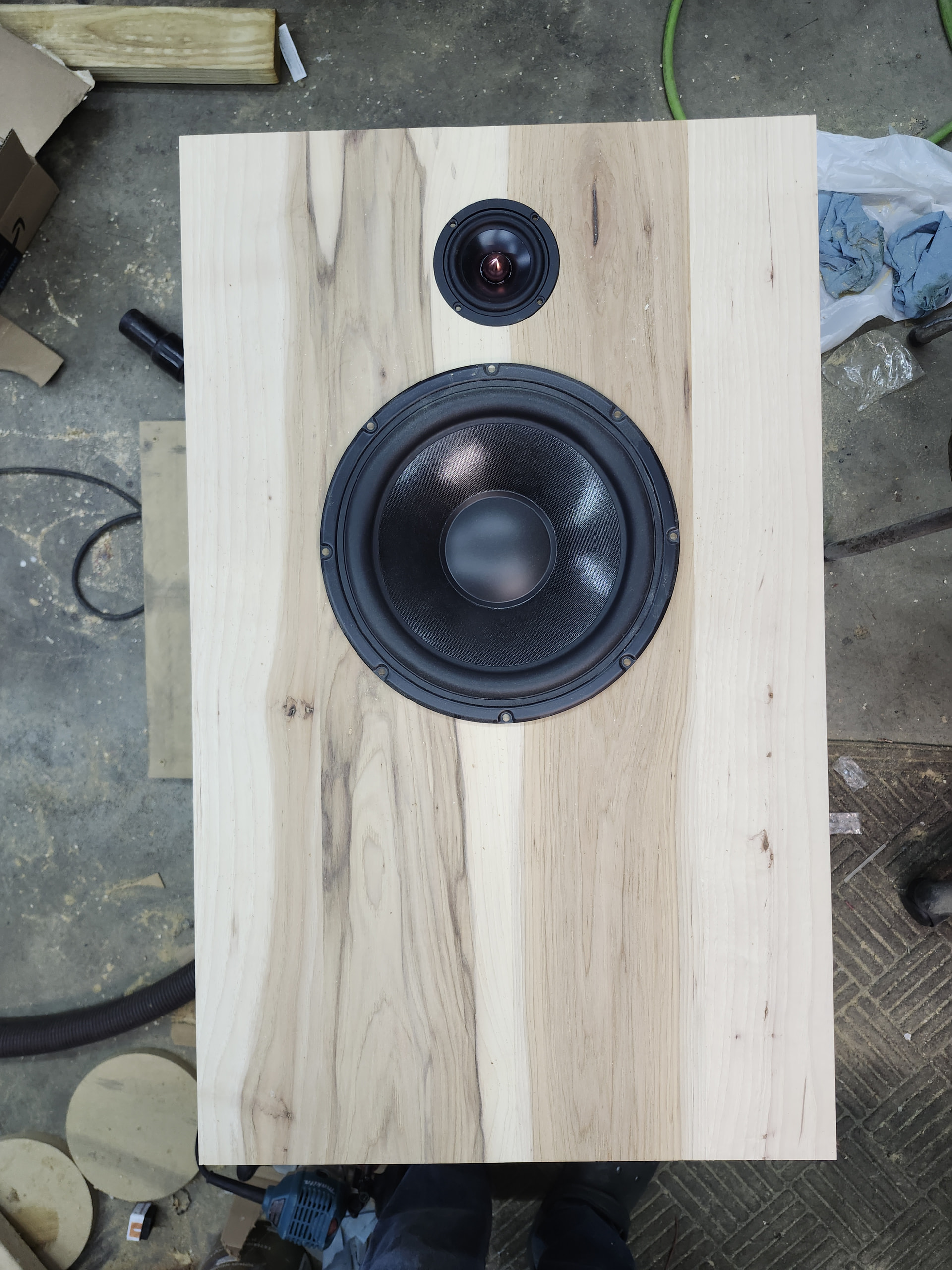

I got the baffles routed last night.

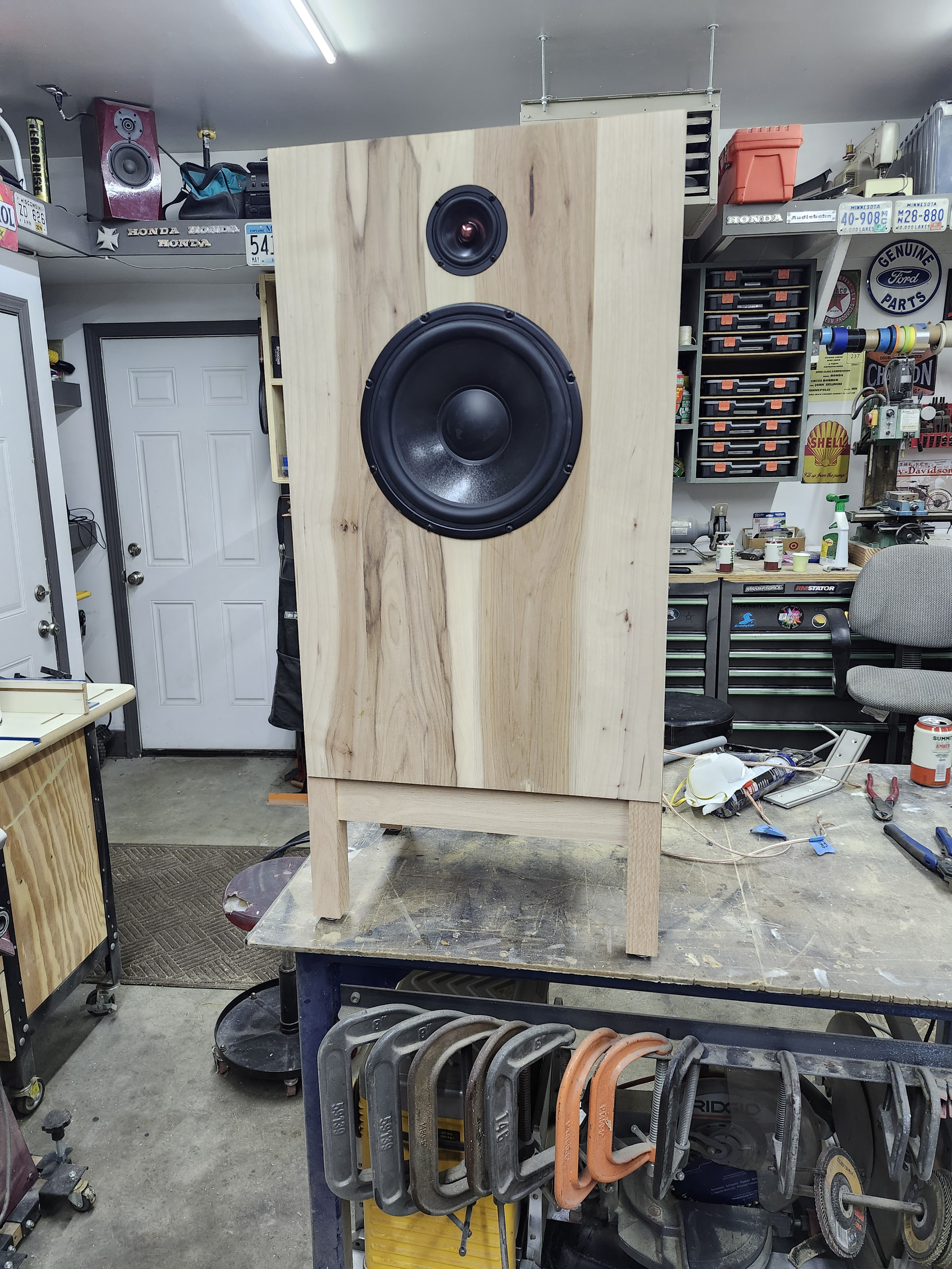

One assembled and ready to measure. I am just waiting for the wind to die down. The stands will be painted black.

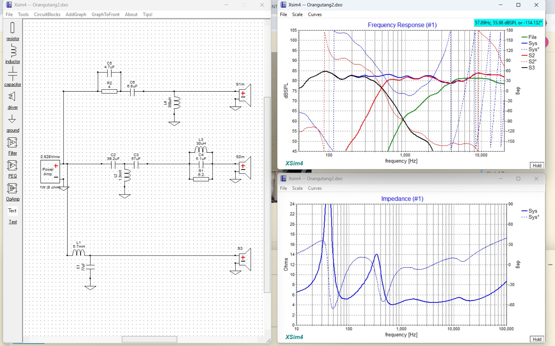

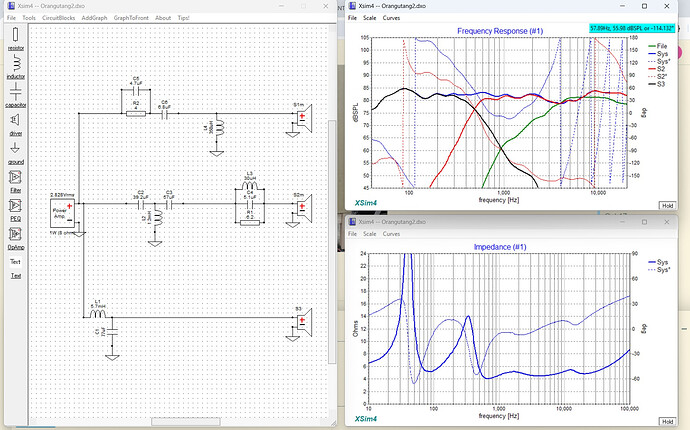

I just threw together a crossover to start doing some listening. This one took quite a few tries before I got something I was willing to listen to. I have only listened to a few minutes, but sound promising so far. I will have to play with the rear tweeter level, but so far it sounds pretty good.

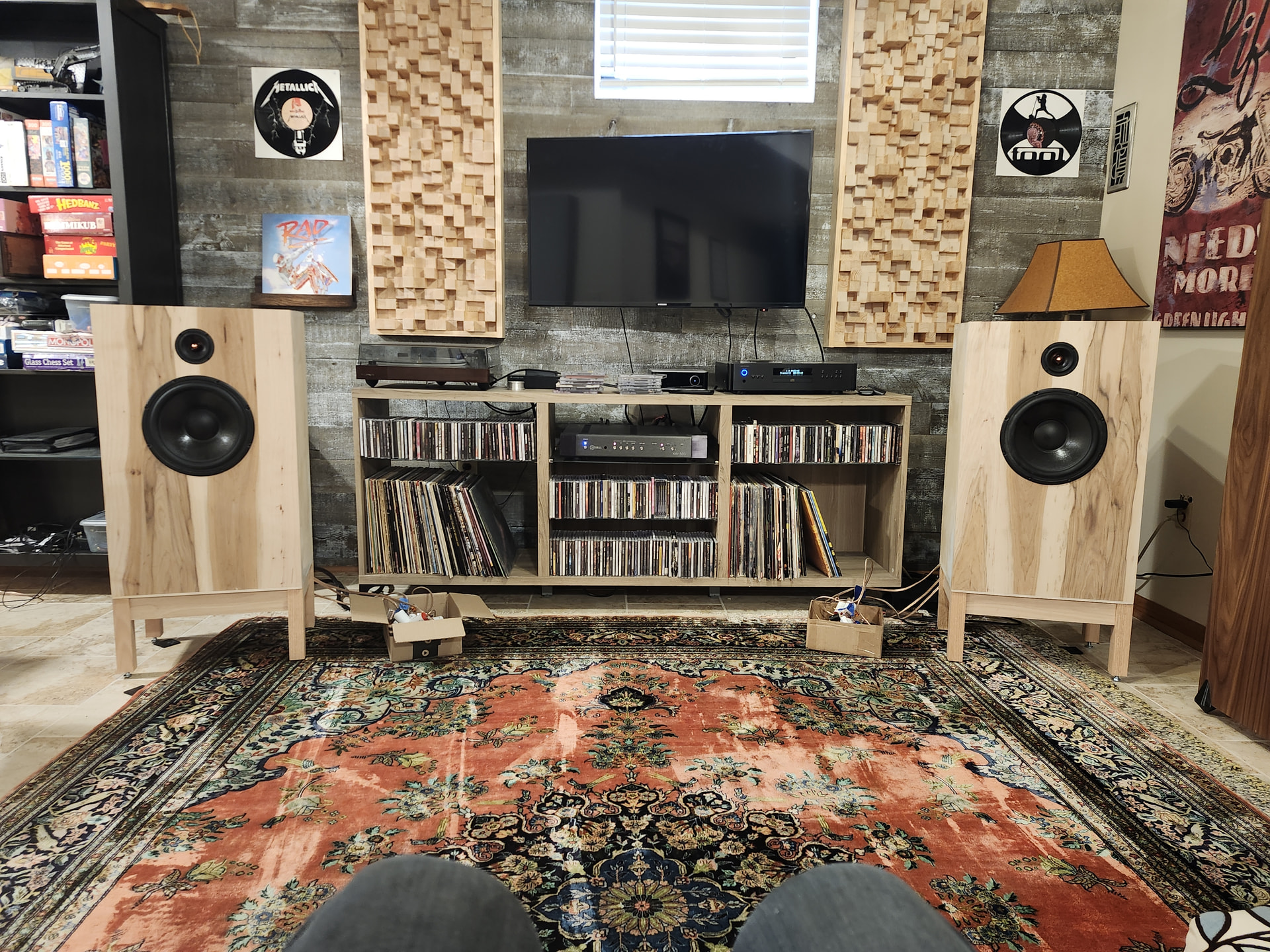

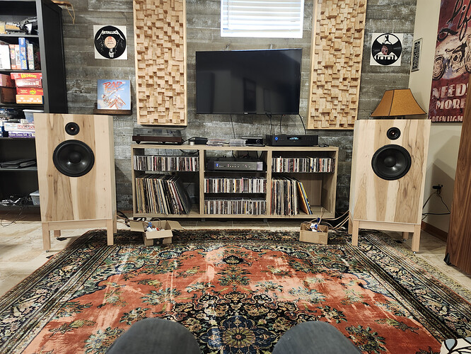

Here is what they look like in my room..
Pecan?
Hickory.
What is your listening assessment of the rear-firing tweeter?
So far it seems to give a bit more enveloping soundstage. I set the output eaqual to the spl of the fullrange in the front. I need to play around with output in both directions and see what it does. I will spend more time with it and also have a couple friends give their feedback. I will report back
I have been able to spend some time with these the last couple of nights. I turned the rear tweeter on and off a bunch while listening. I noticed a few things. Even though it is rear firing, it still enhances the treble. It helps add some air to the full range in the front. It also seems to add some perceived width and depth to the sound stage. It does diffuse the center image ever so slightly due to the reflections. I did end up lowering the output and changed the 4ohm resistor to a 5ohm resistor. Overall, I like what it does. Next step is to integrate my subs. The 10 does pretty well, but due to being sealed, it could benefit from having the subs on. Overall I am pretty happy with these so far.
