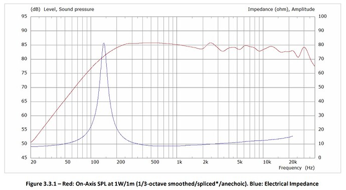

PDF attached. Sensitivity is low at 85 1W/1M, do not know 2.83V, nominal imp is 8 ohms, so at least can be done in MTM for higher sensitivity or combine with a sub and big amp. polar looks good to 45deg for 5khz, so pair with small ribbon or tweter.

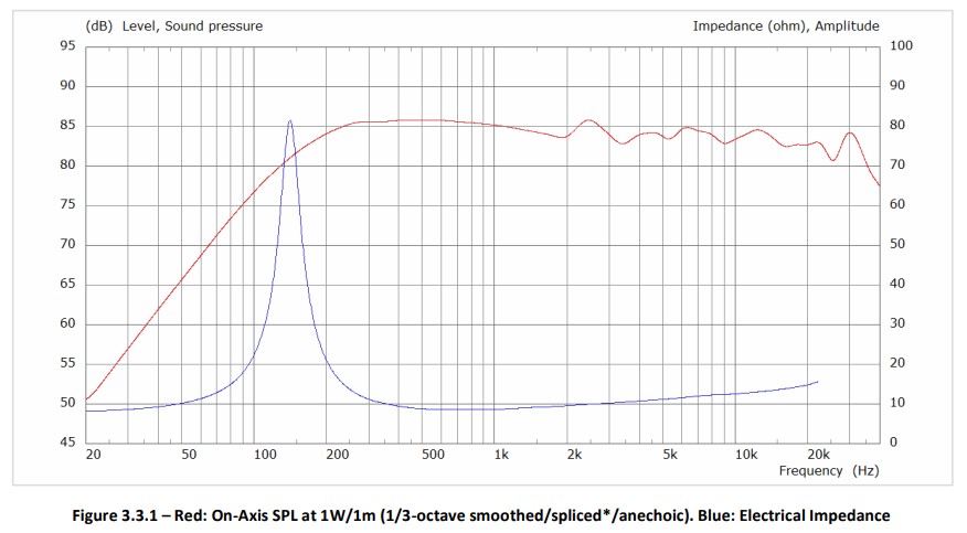

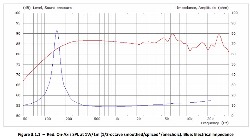

No idea, but they improved the on-axis response.
Old:
New:

Like the improved response!
As I understand it, the smoothness of the FR response from about 2kHz to 20kHz relates to the bending wave technology employed. A sandwich cone is used with concentric rings on the back side. This affects the polar response and breakup modes. They must have improved the positioning or weight of the rings. The cone has a little more mass than the BMR’s that I used in my MGU speakers, so that is probably why the on-axis highs above 2kHz roll off just a little bit more. This should be easy to correct in the crossover.
