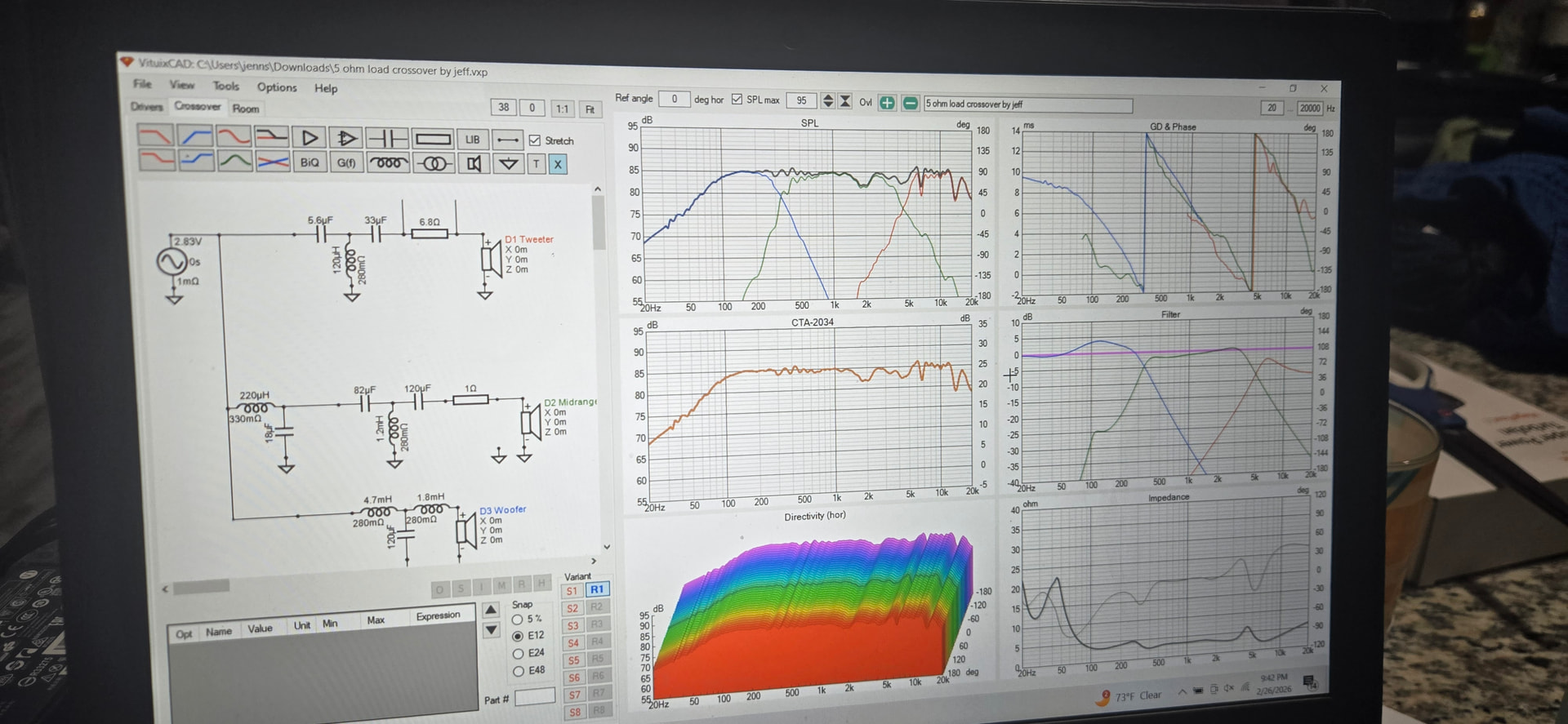

Dirk sent me here. Figured i would post a few pictures but I’m too new lol. So here is the crossover network. Thank you for letting me join the group!

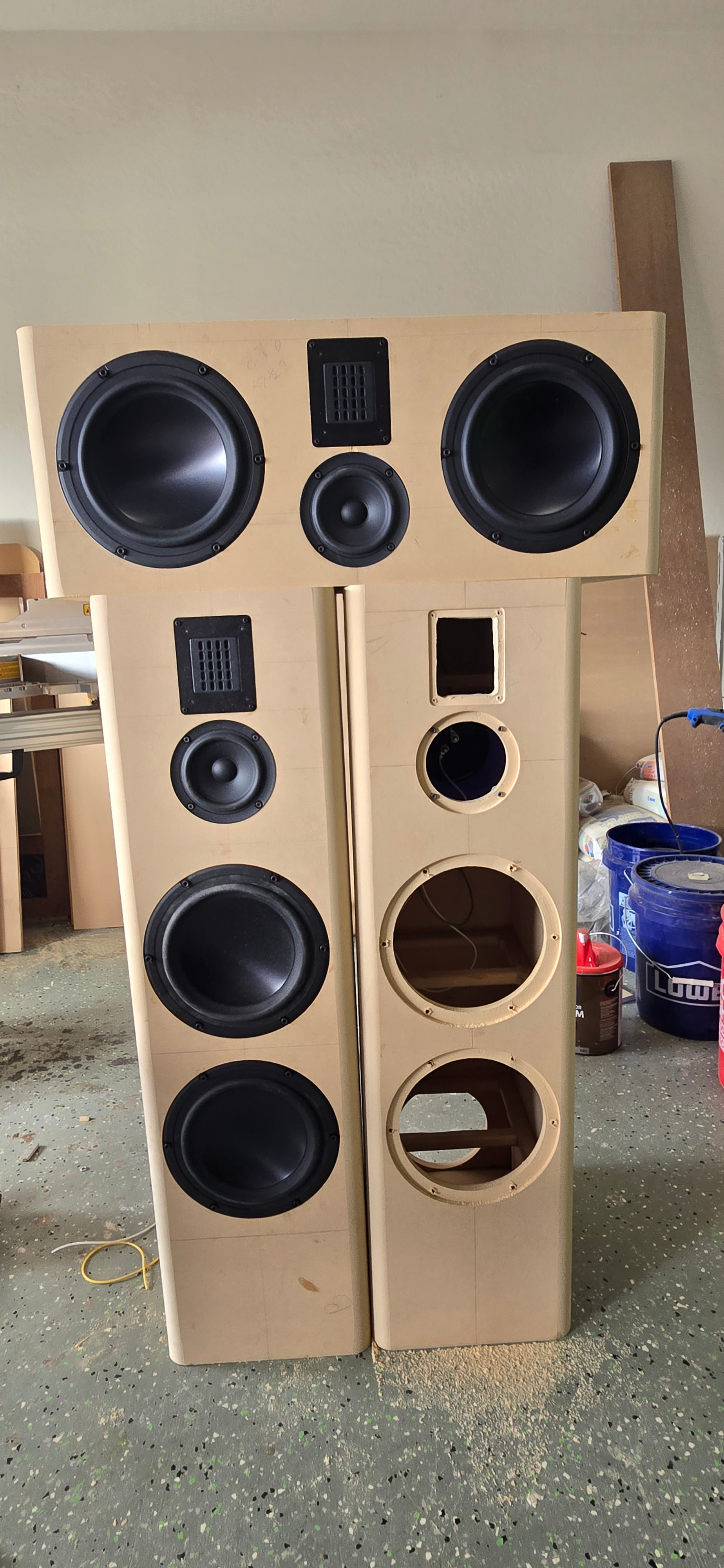

edit:Changing to show the cabs.
You should show off the cabs so far :wink:
Done. :slight_smile:

Crossover

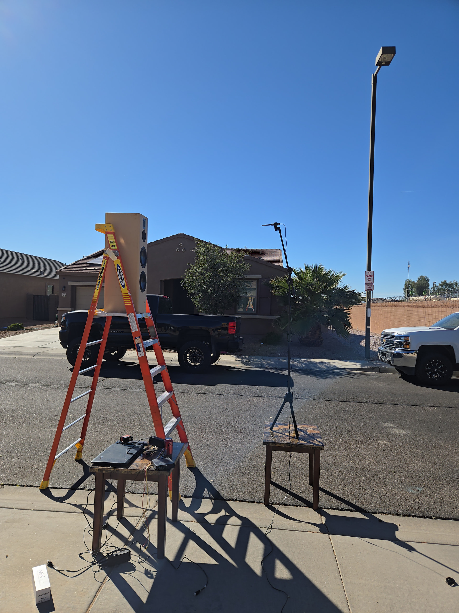

taking measurements

Here are the drivers
Tweeter:grs PT2522
Midrange: SB12MNRX2
woofers:SIG225
Lucky, here in SoDak wind is pretty constant.
I have jets (f-22 and f-35s) fly over so I had to wait between jets to take measurements.
