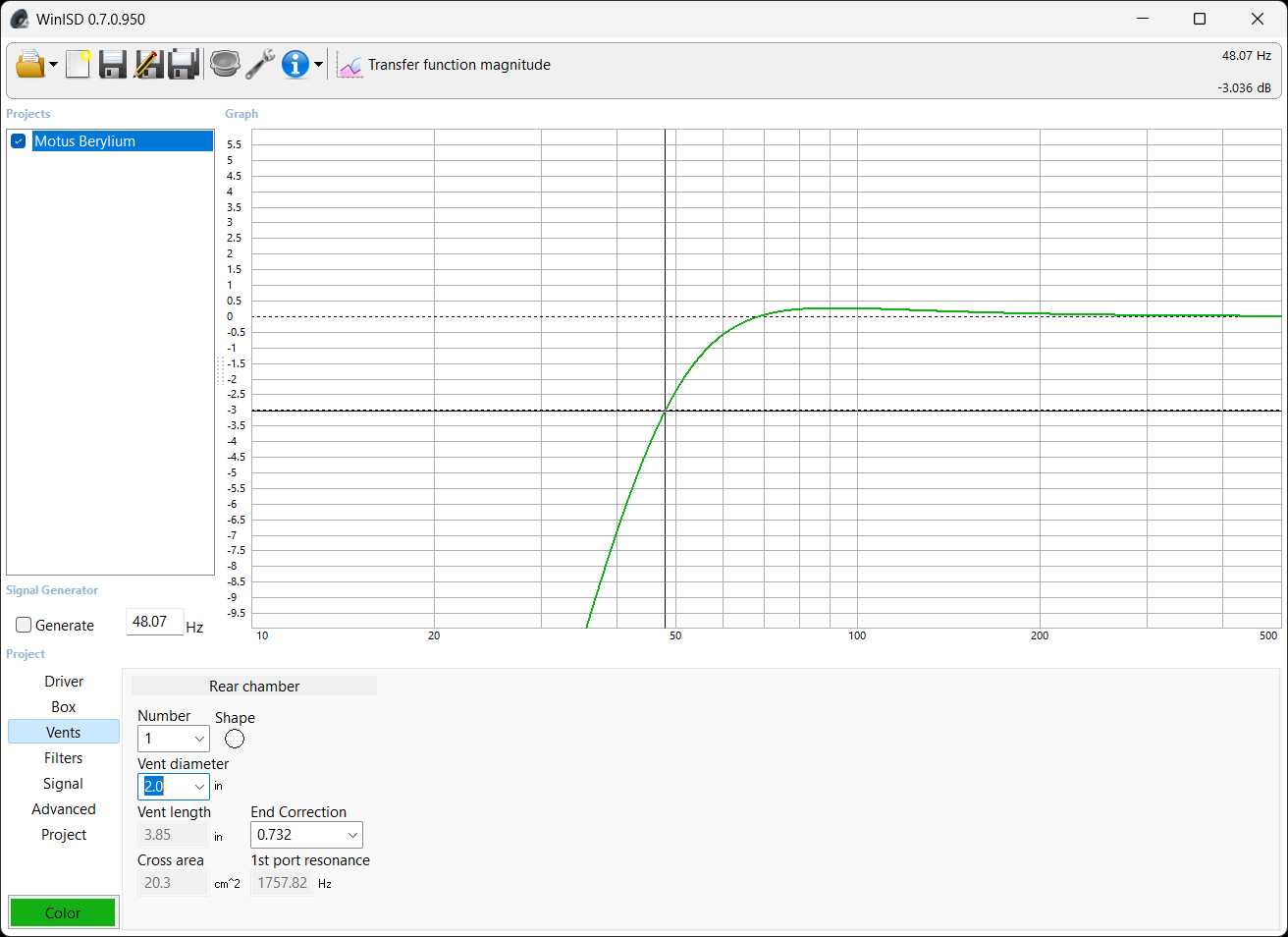

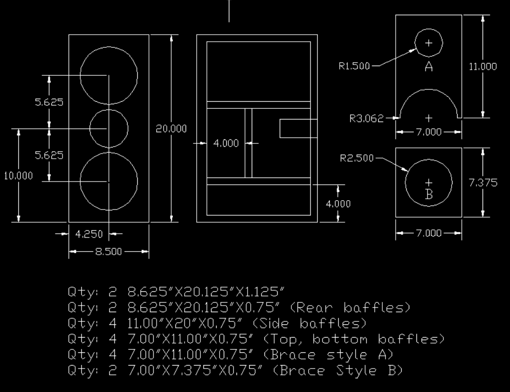

MTM using Motus 5" and a Chinese Beryllium tweeter. Should be a pretty good performer based on past experience with the Motus drivers.

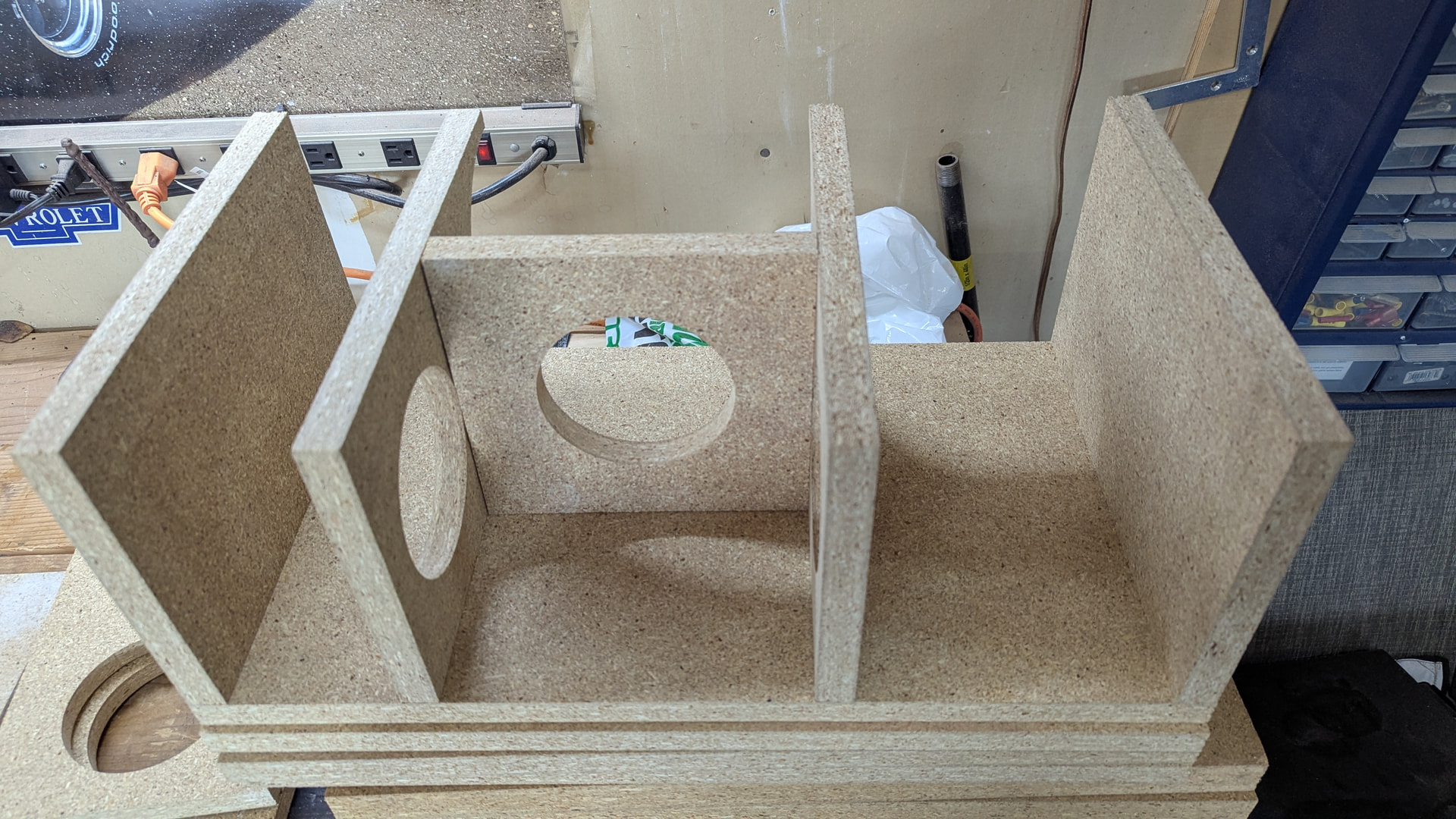

Cut the flat packs today, will do glue up later. My least favorite thing so I always seem to find ways to procrastinate.

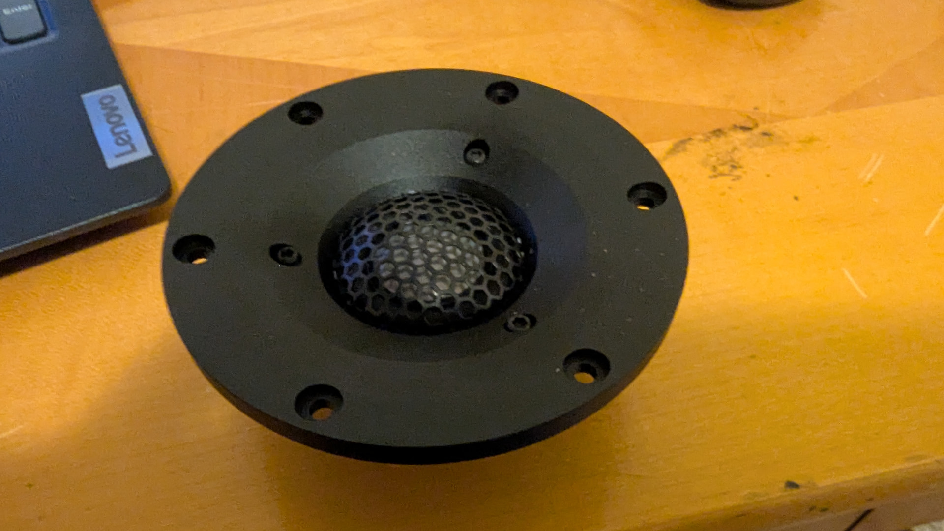

Picture of the tweeter. Definitely has a DXT vibe to it.

I will be adding a couple smaller braces to tie the top and bottom together.
Is this the Beryllium version of the ceramic in the previous 3ways?
That was also a Be tweeter.
Oops, so second use of the same model then? Shows how much you liked it. :slightly_smiling_face:
It’s a different model.
Must be a secret?
They are NLA and so there is no link to them.

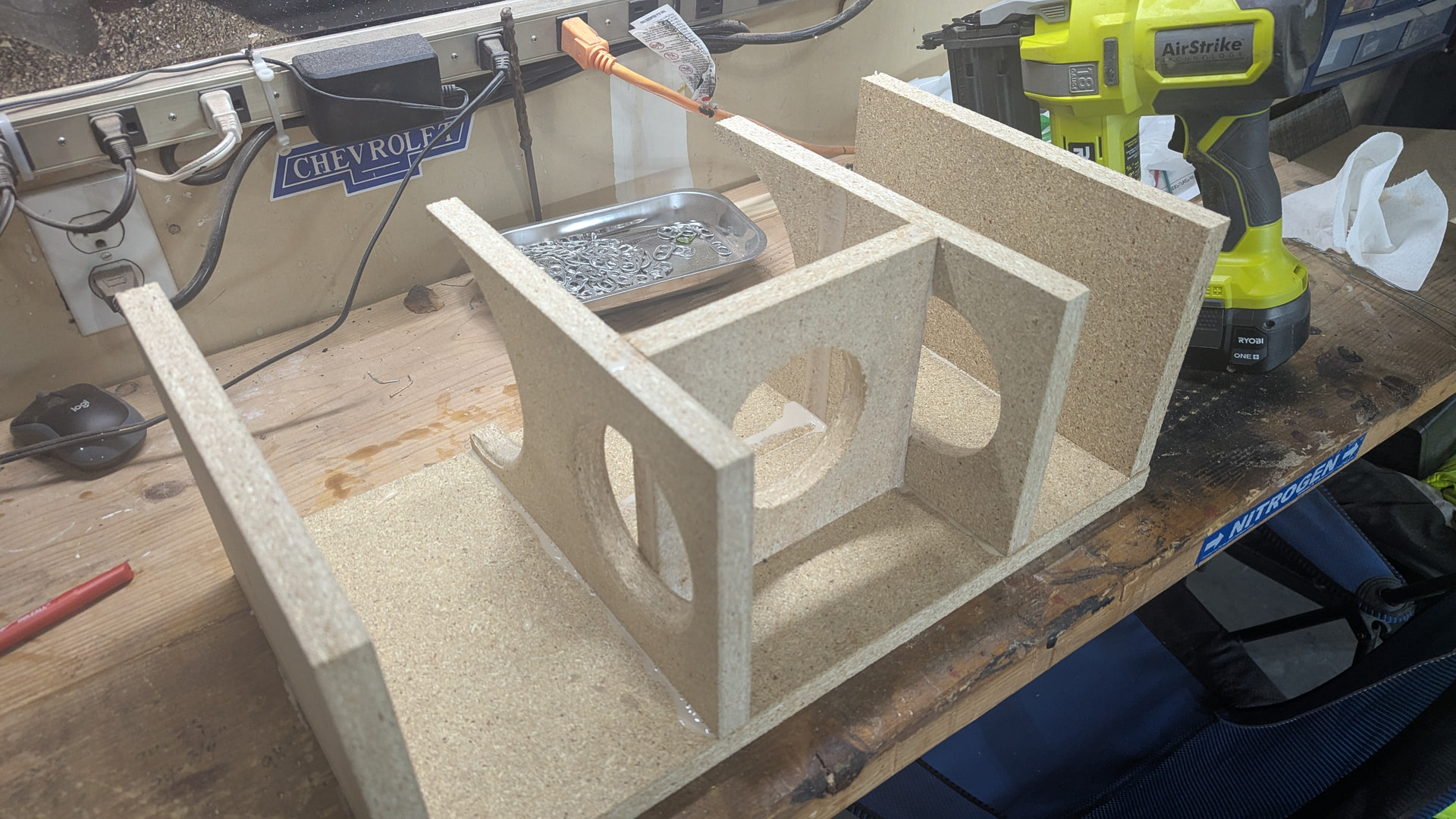

Started glue up.

Been too humid here for working in my garage, else these would be all glued up. Waiting for a break. My garage is always 10 degrees warmer than outside which means it is around 95-100 in there. I just sweat too much these days.
Yeah I grin and bear it, Fans all at warp speed.
Heat be damned, glued some more up.
