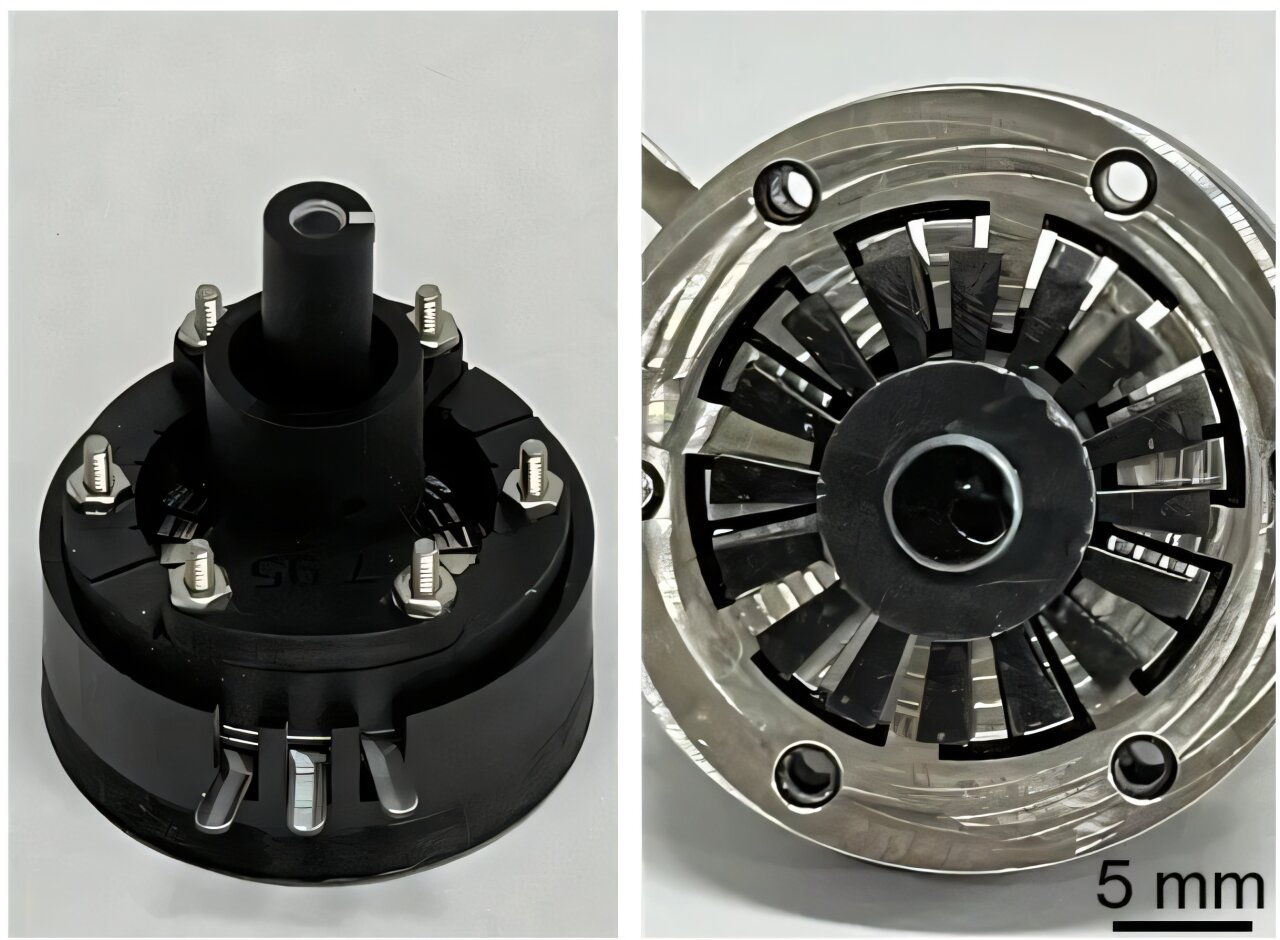

Wow!
We could all be driving cars with ferrofluid motors
Wow!
That’s pretty neat.

“Ferrofluid” has always referred to ferromagnetic fluid. Ferroelectric fluid is not the same stuff as ferromagnetic fluid, much different from what’s in your tweeters.

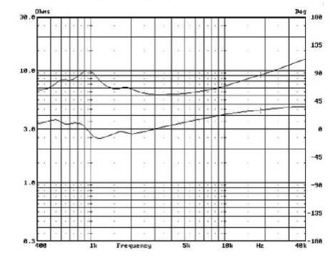

HiFi Compass recommends removing the ferrofluid from the HiVi Q1R, he claims it makes a significant difference in the detail of the tweeter. However one of the Q1R tweeters I received from PE apparently did not have enough/any ferrofluid based on the shape of the impedance curve, and that driver measured horribly. FR and distortion were both markedly worse.
Impedance of that one looks like there’s not much you could do to make it worse. Maybe stick to the Dayton silkie if you want a cheap Dynaudio copy.
Insufficient fluid is definitely a problem, it needs to bridge the gap the whole way around. I imagine it can perhaps accumulate to one side of a motor if it’s encountered some impact during shipping, or perhaps just from sitting unused for a long time.
In either case, I’ve found many tweeters are easily disassembled, many others glued tight requiring significant effort to disassemble. A small vial of ferrofluid ordered from Aliexpress for $10 and a toothpick to drop it in the motor gap can turn some otherwise bad tweeters into quite decent ones.
