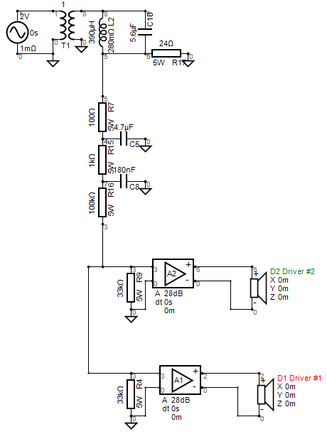

After winning a pair of woofers at InDIYana . CSS LDW7-8 generously provided by Dan and Kerry. And after talking with shenanigan Dan. I have decided to use them as mids. instead of the satori textreme 7.5” It will still be a hybrid speaker with a PSU and 2 channel amp board. Passive crossover around 1500 and maybe a second order high pass on the mid around the baffle step point. 375Hz I think. A
Not Endgame.pdf (179.3 KB)
nd something like this before the sub Ampl. I dont think I want the mid to carry all of the BSC and end up with a tower speaker with 80 Db. sensitivity.
