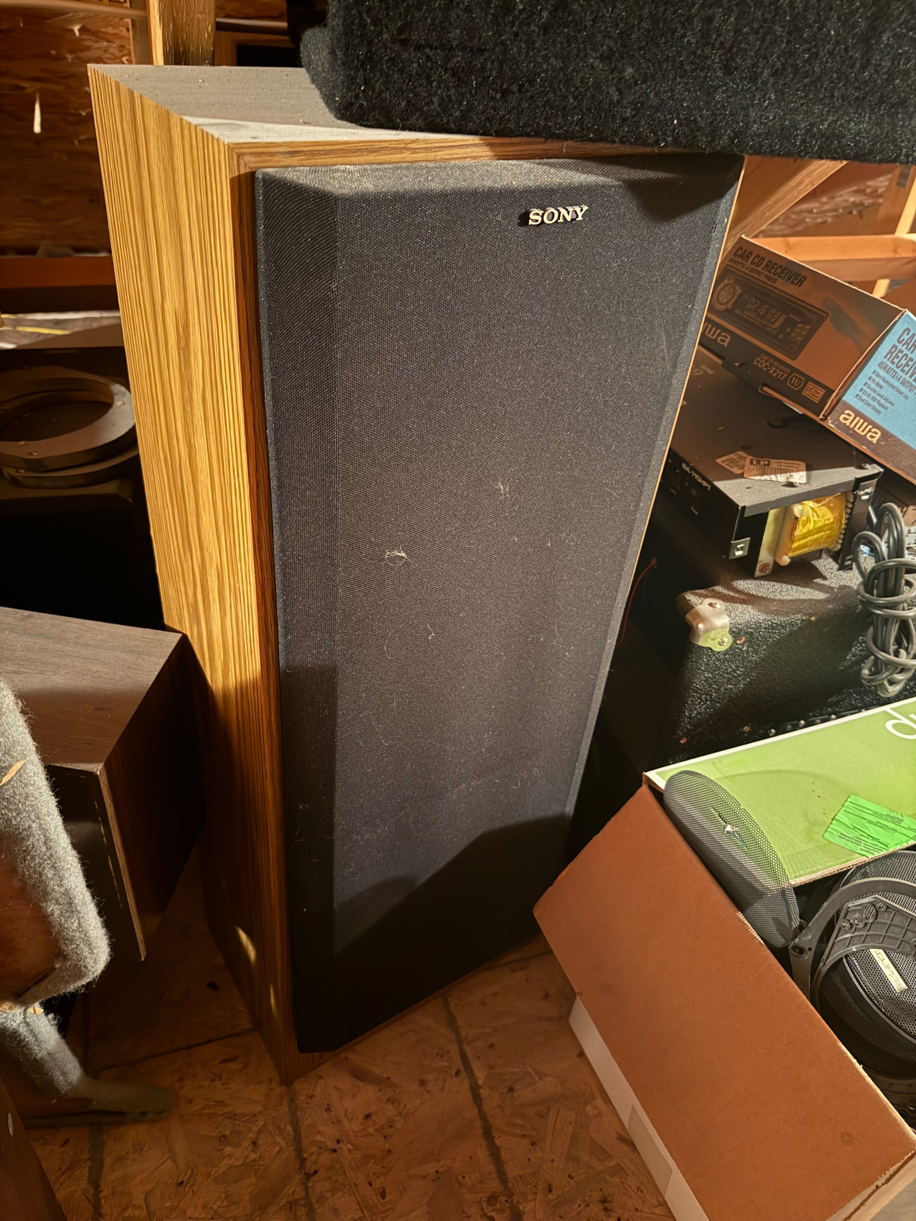

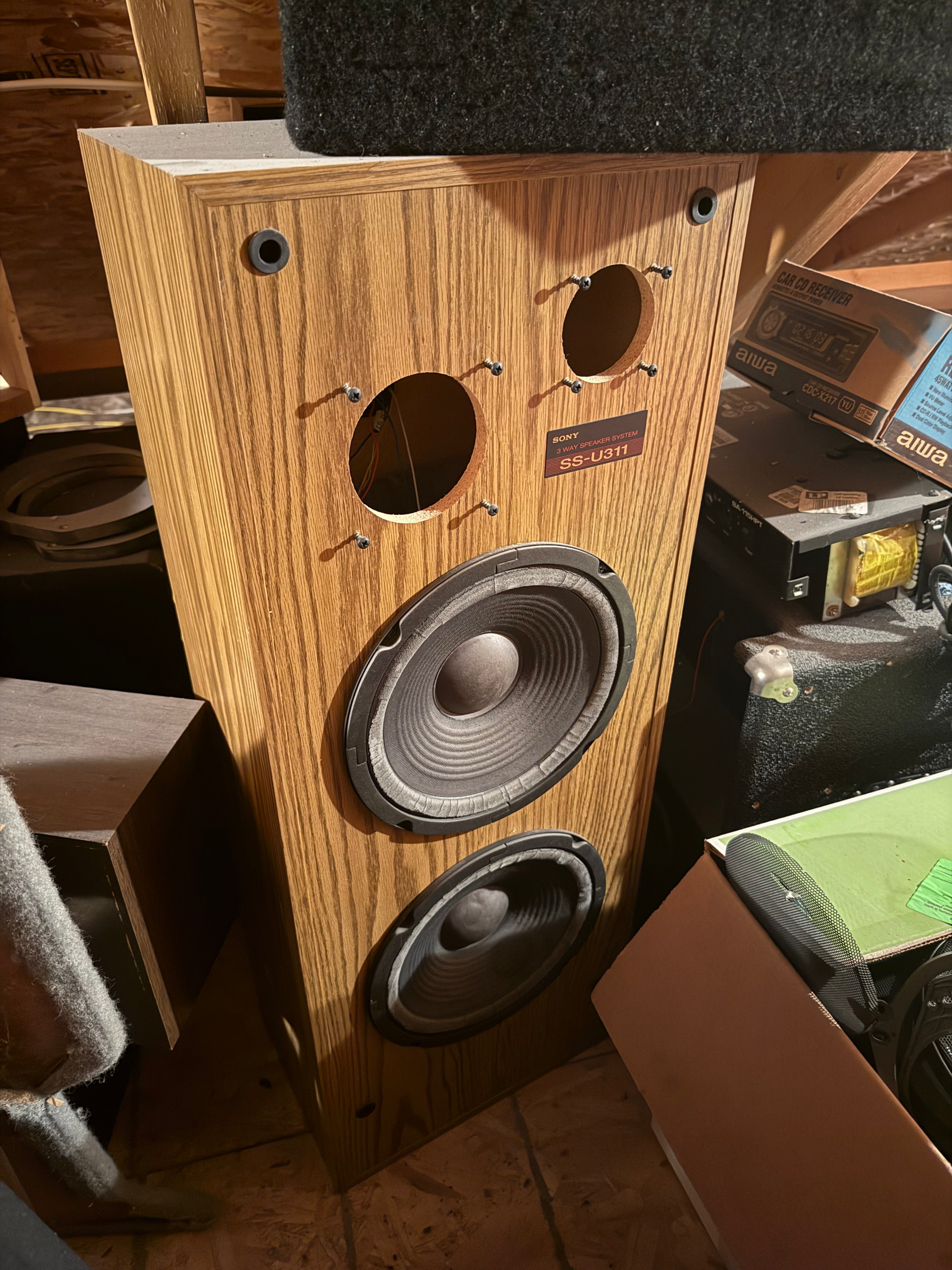

I foresee a fresh matte black baffle and some bracing in some big Sony cabs I have in the attic. Golden Oak vinyl - Quite period correct for a build like this!
