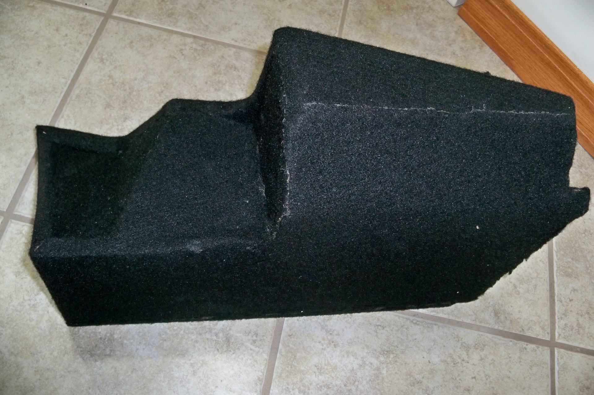

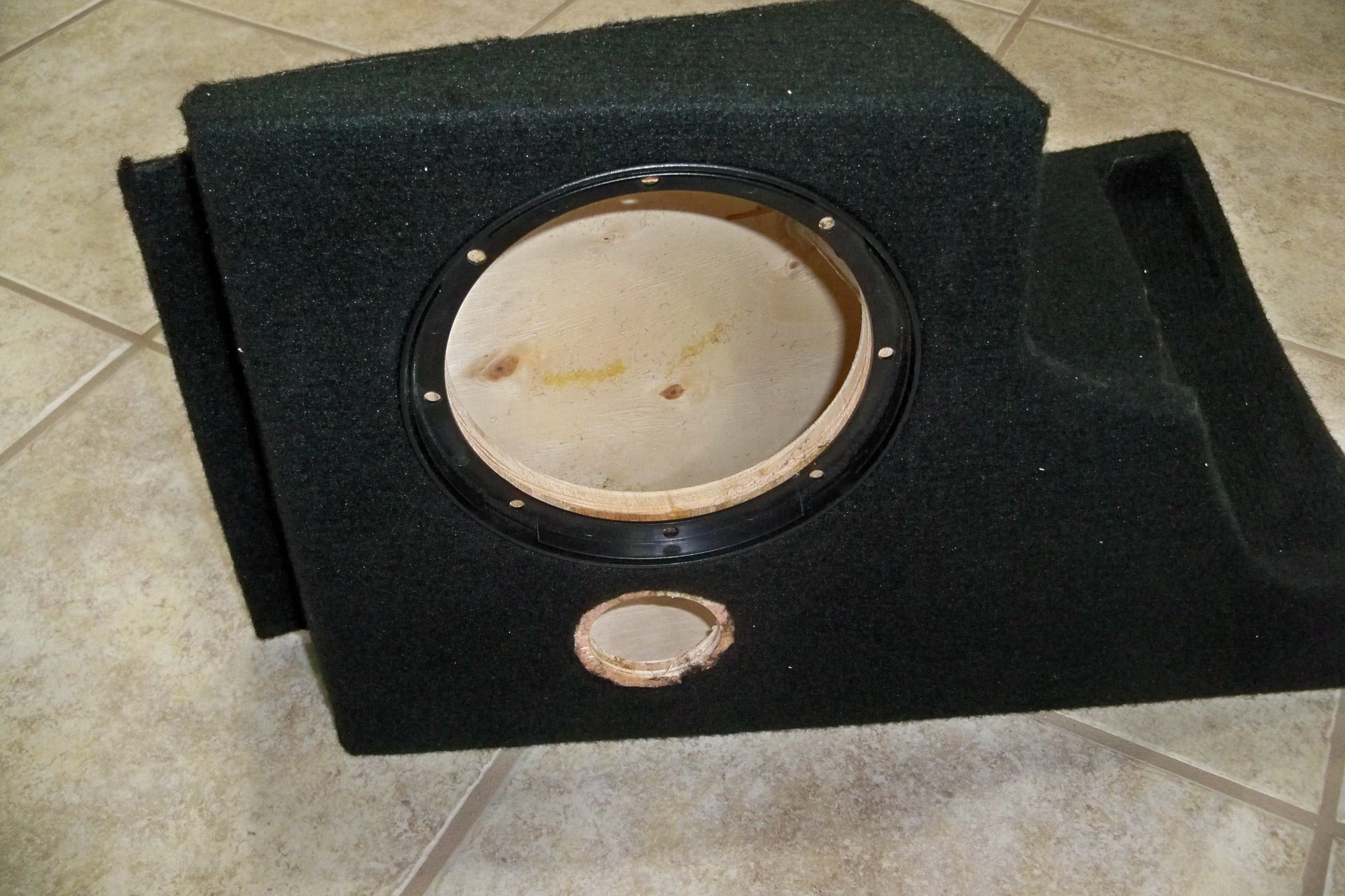

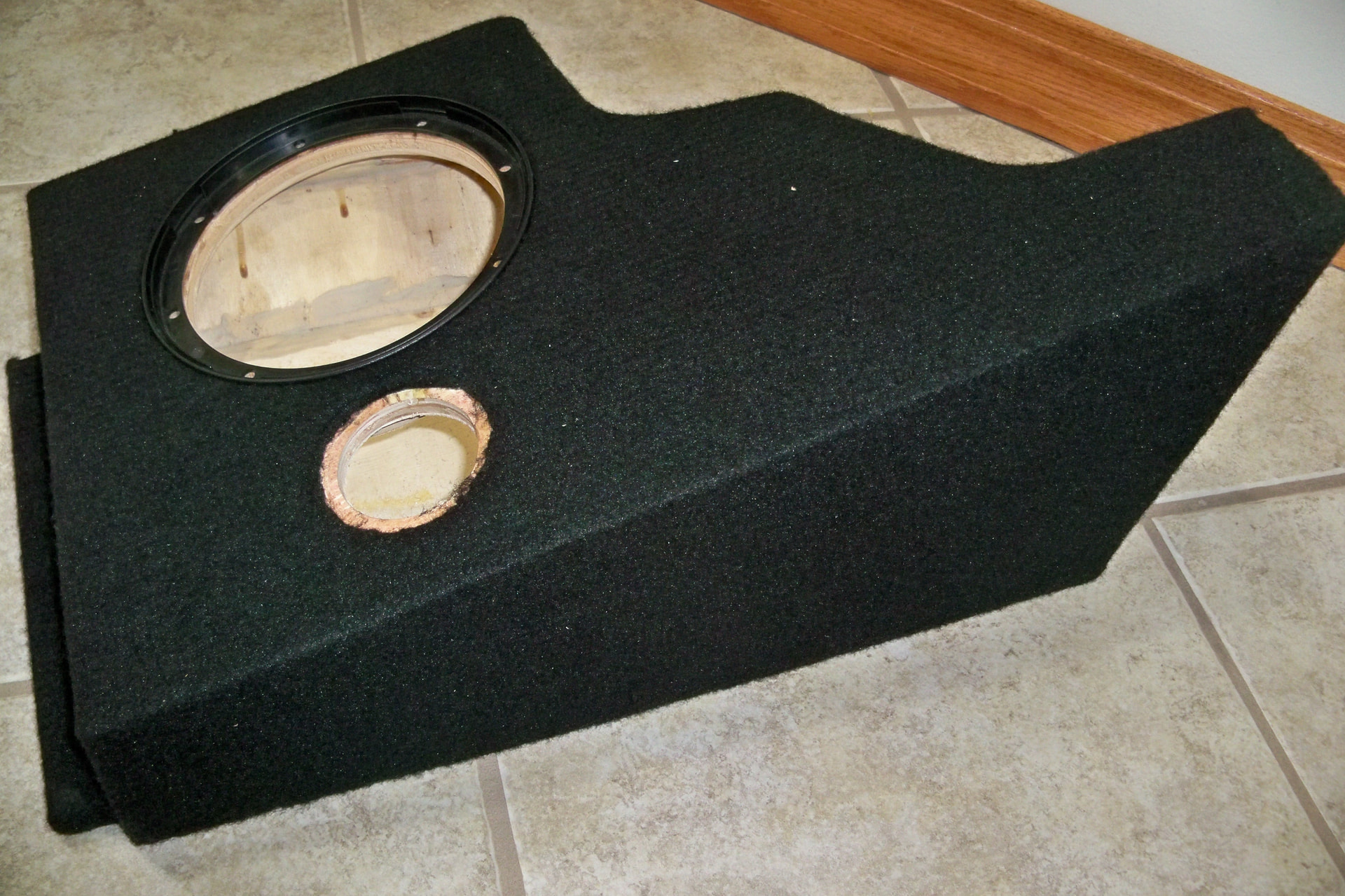

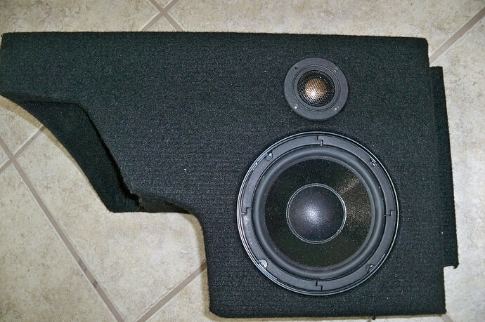

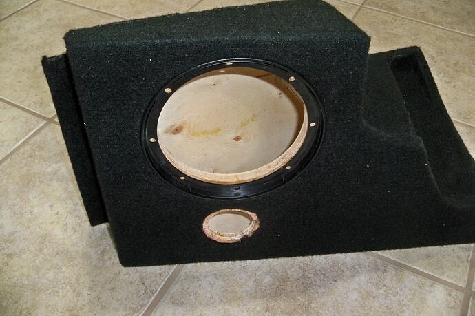

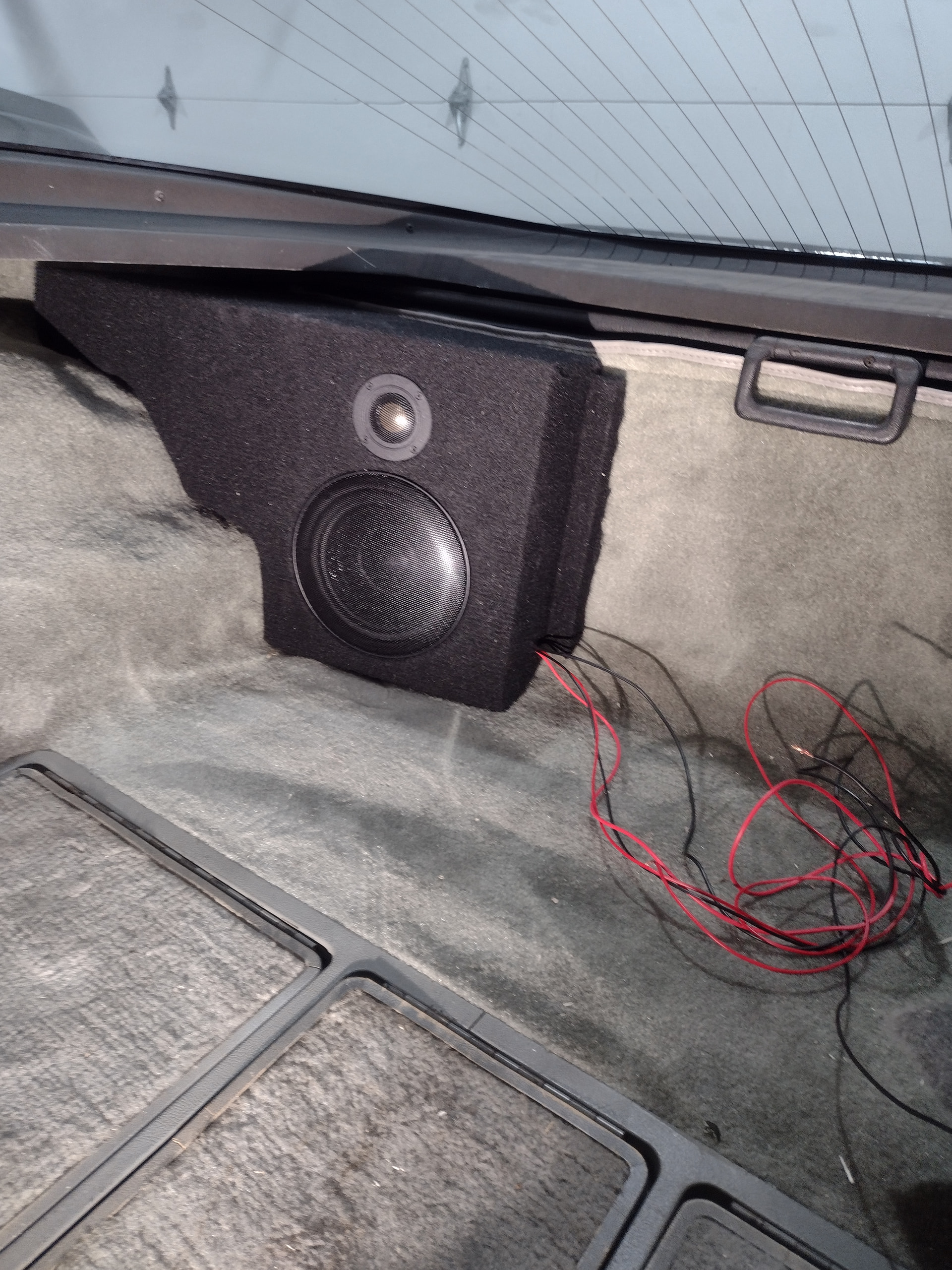

I’ve been slowly working on getting some decent speakers in the old corvette. The stock were 6x9 tucked into the corners open baffle. This is my solution. It uses DC160-4 woofers and MCM tweeter that I believe Craig gave to me.

Wow very complex shape. I don’t think I’d have the patience to get all those angles correct.
I need a pair of grills like that for some DC160’s. Could you share where you found those?
Thanks.

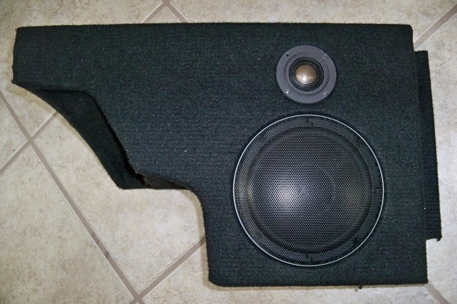

The grills came from Parts Express and fit the DC160’s perfectly.

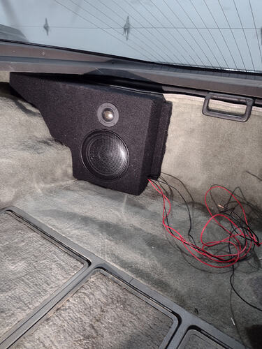

This is how they will fit. The amp will go between and be framed out flush.

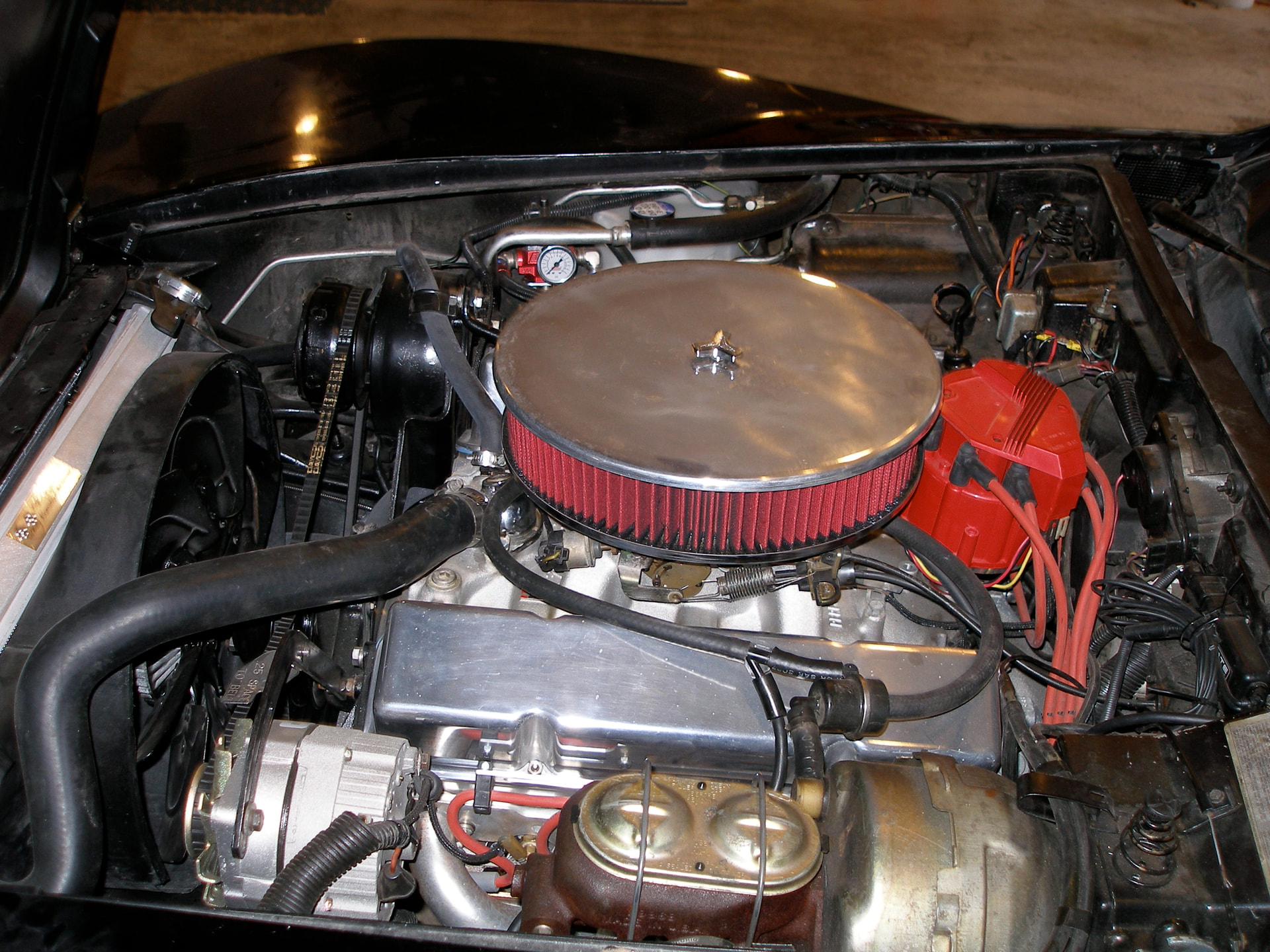

The paint actually looks pretty nice in the picture . Was that a L-48 or L-82 car ?
It was a L48, but that engine and transmission is now in my pole barn. The current 350 has AFR CNCed heads, hydaulic roller cam and Comp pro magnum roller rockers. If I have time this year it will get fuel injection. Most likely Edelbrock multi port. I also swapped in 2004R transmission.

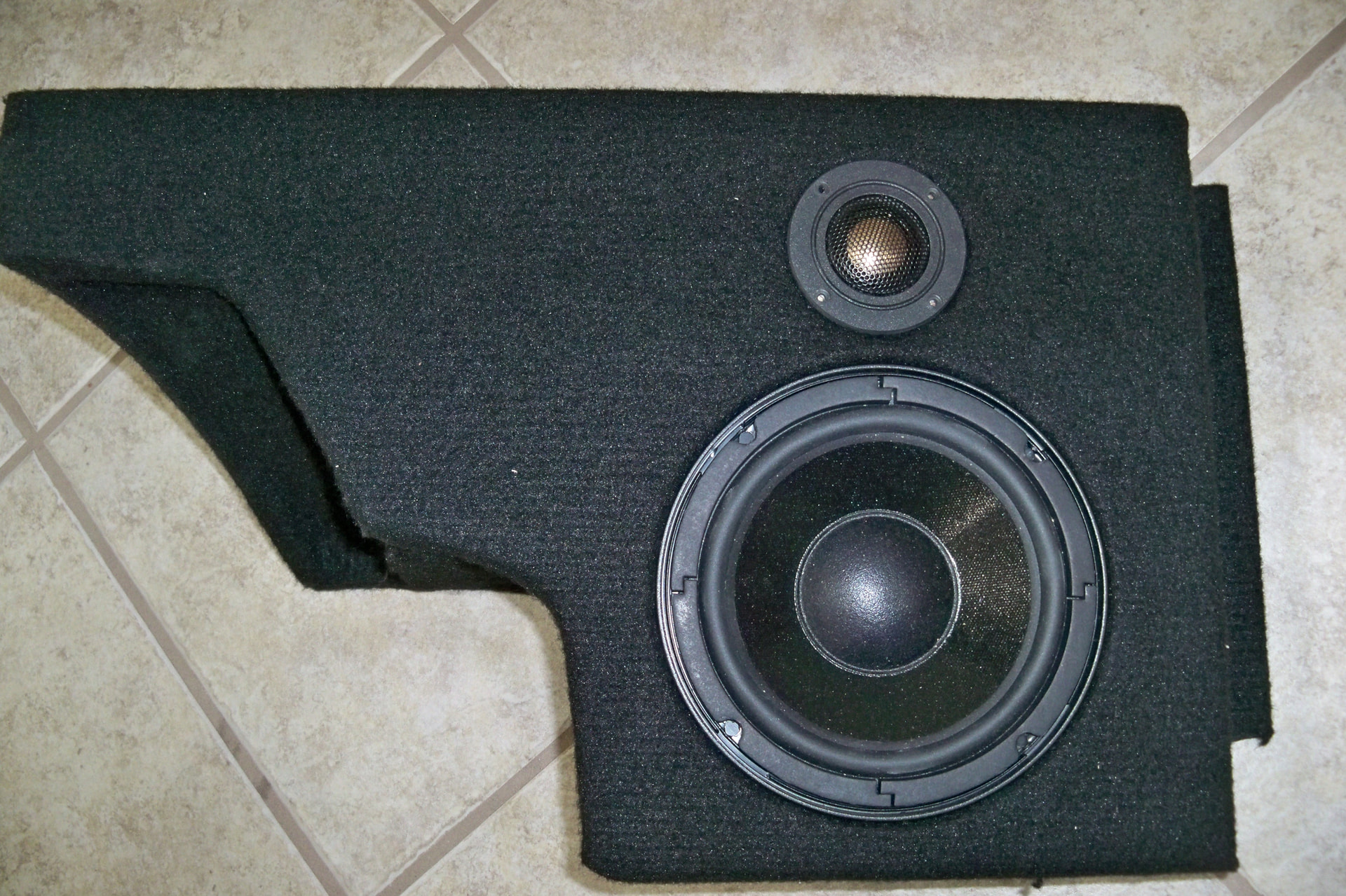

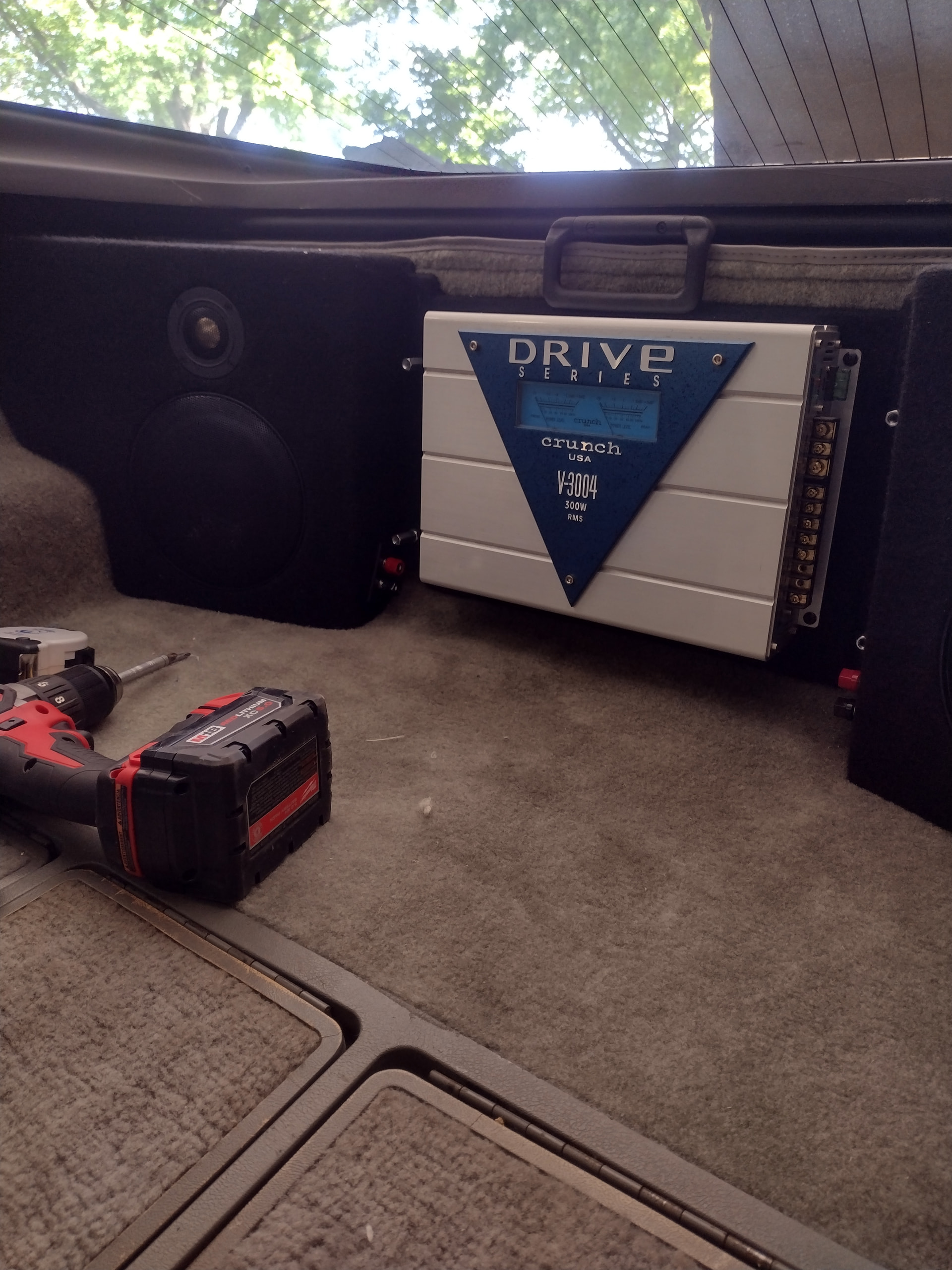

I made some progress this past weekend. If the vet was steel I would have mounted everything with rivnuts, but being fiberglass, I opted to cut 1/8" stainless plates which I drilled and tapped for 1/4-20 bolts and used them as backing.
Are you using a crossover in the amp or doing something passive?
