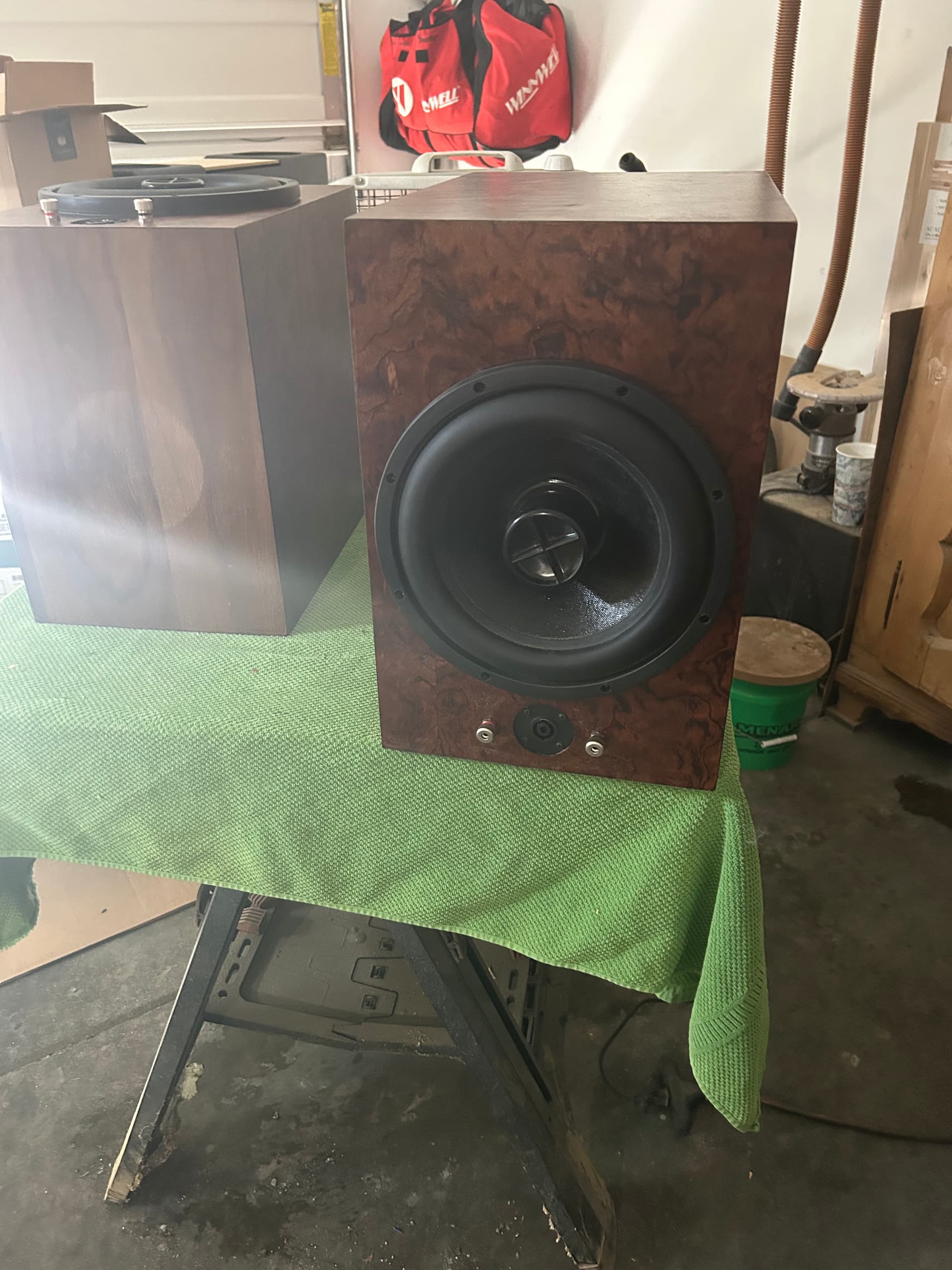

But had built 1.2cuft box, used RSS210HF and a visaton waveguide. Built unfinished box mid-late 2024 figuring tinker with active but it just not work out - ignorance heh.
Then figured, before veneered figured make hole larger, got a 3D printer Dec2024 thus could make replaceable midrange cups. Tried to use for Indy25 tweeterectomy, using Mark Audio pluvia7 and tinkered with repurposed Seas L12 coax. Abandoned the pluvia+rss210, so much padding. Was wired with speakon in back where L12 passive xover sat inside. Then doing better measurements on spin jig, noticed how bad the mid cup resonated, massive distortion under 300hz. I was also bummed veneer job not great. Think oversanded some of the mdf where absorbed and swelled from the wood glue (iron on method) - plus burly type veneers finicky. Almost wanted to scrap the whole box and repurpose the RSS210’s… then figured new use. Have pair of Morel CAM558’s on hand, one used other discounted - should check for consistency of the two but not gonna invest more so roll with it.
Picked up some of the little peerless faceless tweets on clearance from PE, think Joseph Crowe had some writeup and horn for them as well. Printed up ‘faceplate’, this time also isolating better with speaker gasket and added set of binding post on rear to have access to all 3 drivers - because oh yeah, there’s a CSS APR10 on the back of this box.

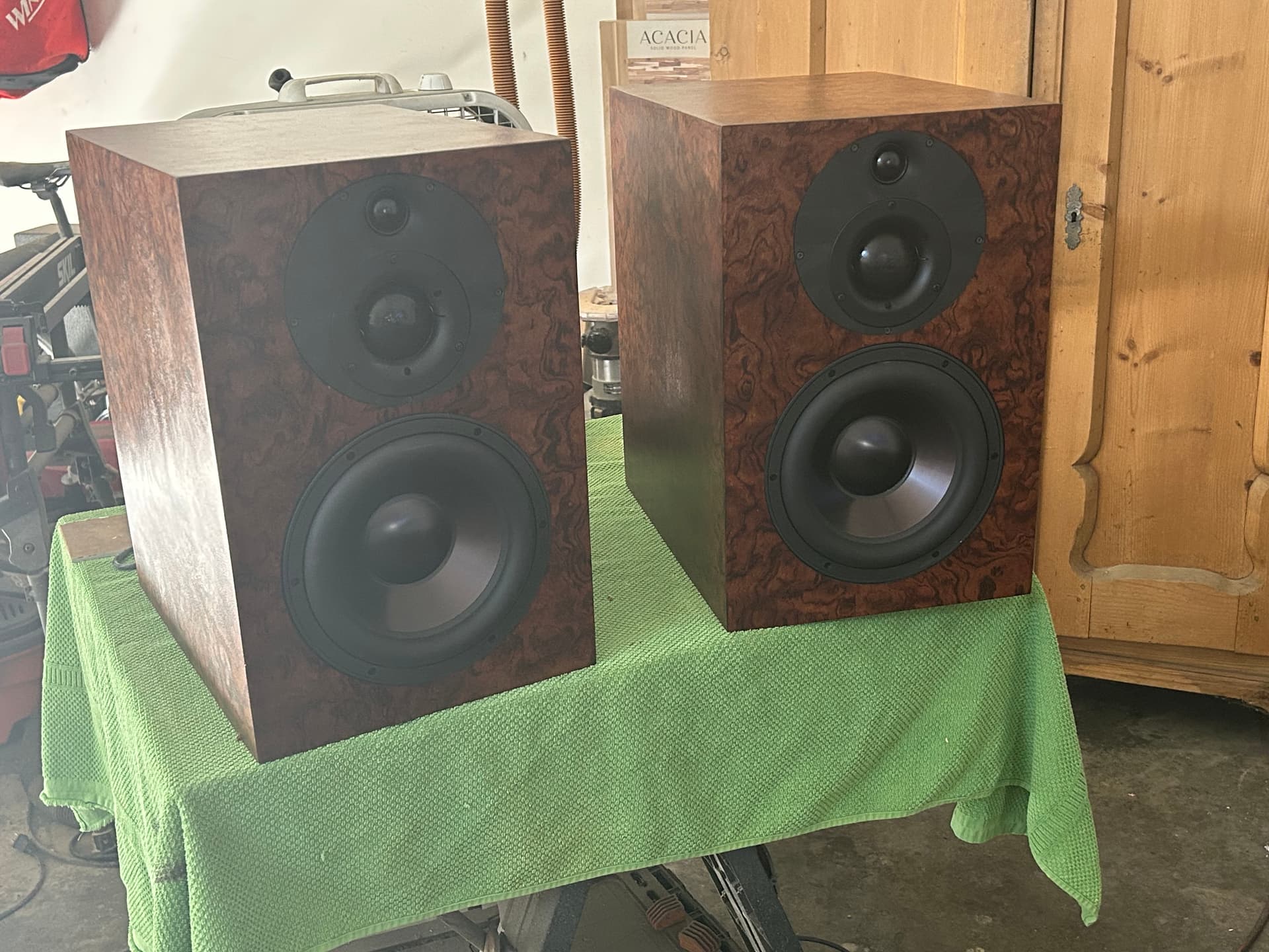

Pic of them when was on verge of getting them out of site, mentioned on group chat couple weeks back
So… the pic of the blub’s, not get to taking measurements yet, sometime this week.
Saw notes about Ben getting RSS210 up to 850. Not feel as guilty padding down lighter voice coils found in the dome mid and tweet. Imagine gonna have to nasty diffraction with the mid equidistant-ish. Could have twisted the mid-tweet but i’ll keep with the aesthetics and hopefully deal with that fallout. Targeting about 800/3500.

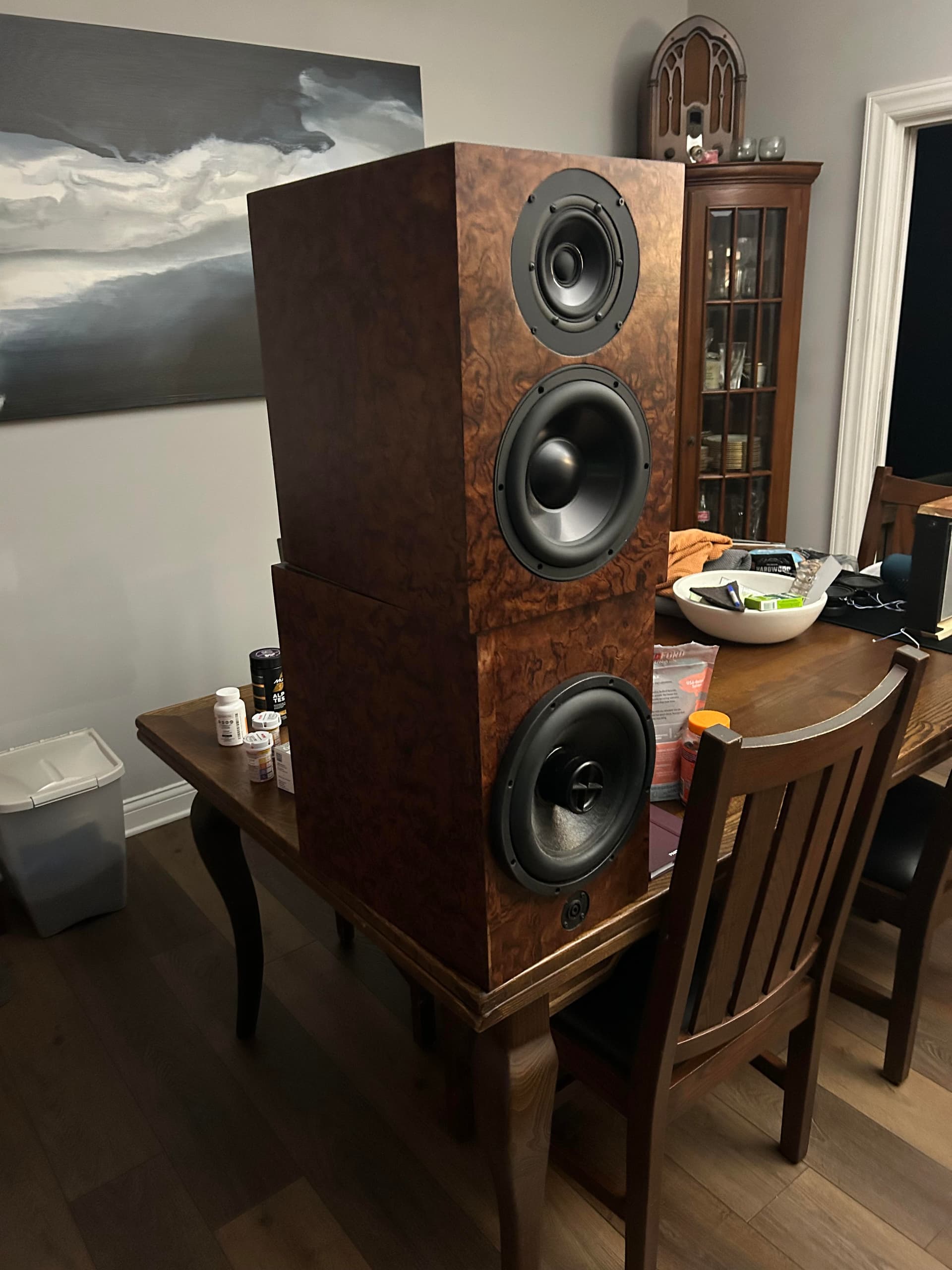

not even sure what gonna do with these as have no where in home in need of speakers heh

You’ll always find somewhere that could use (another) pair of speakers. Also, these are neato.

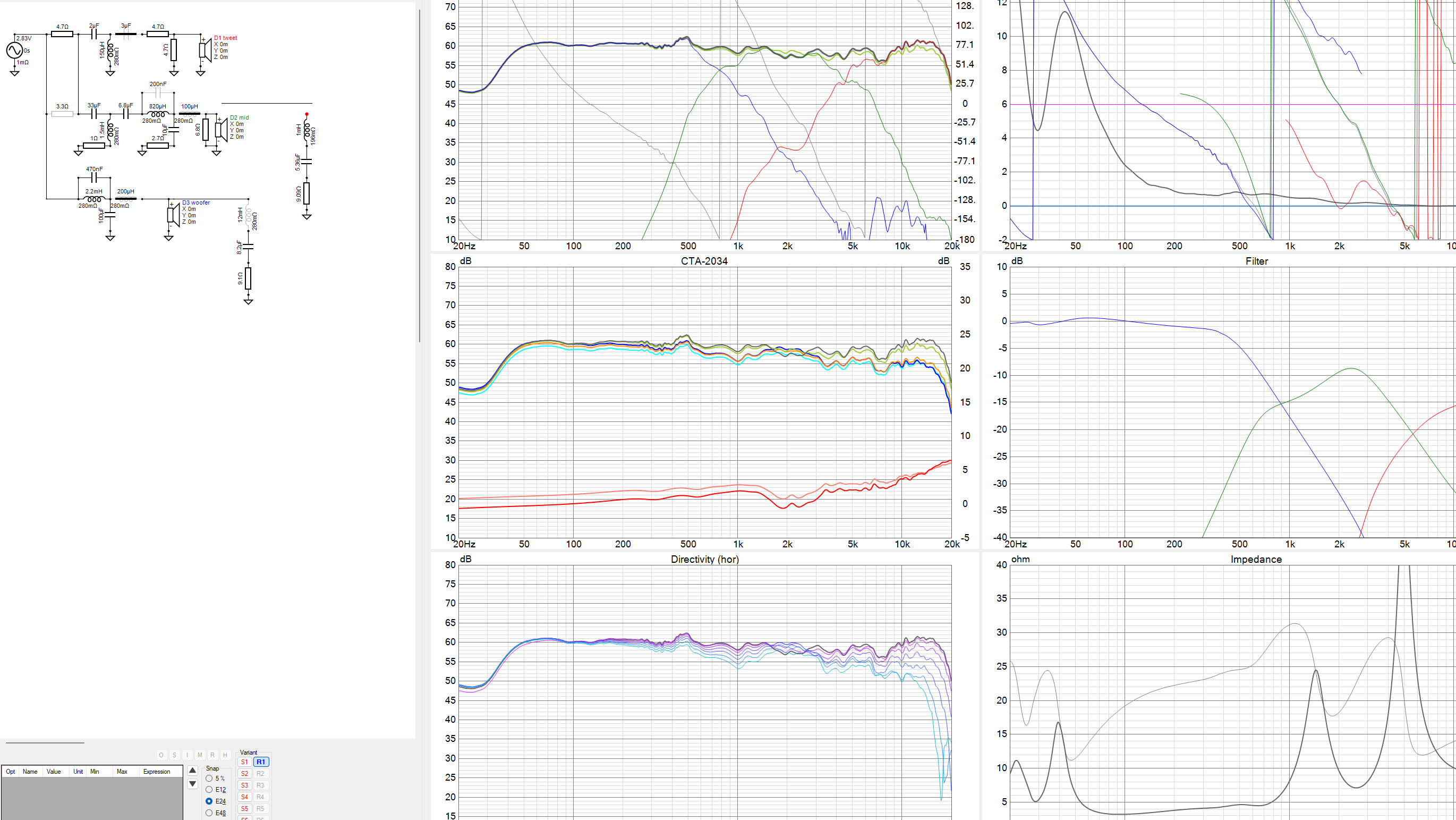

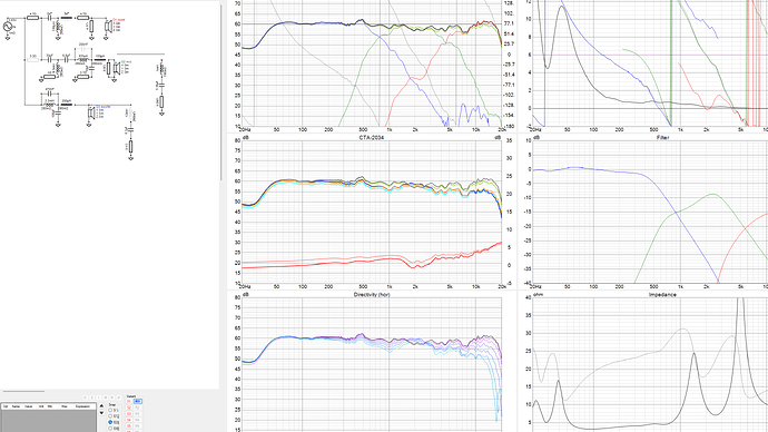

Did take my measurements, tried couple variations but landed on this to start.
I notice the dome mid bunches up 2k area and saw that while measuring where 0-20 sinks, but then bumps back up as get out further in angles. Run things through dsp, no filters but can tinker with simulated notches. Like have a notch off to the side in xover schematic that notches 2k but not try with and without yet, have to run through some more test tracks and wire up the other one since my ears aren’t reliable with single speaker.
Also an optional notch on woofer for the 500hz bump, but not as prominent on on axis measured xover. Definitely not an efficient speaker heh, but i knew that would be the case (didnt spl calibrate rew measurements so ignore the 60db)
