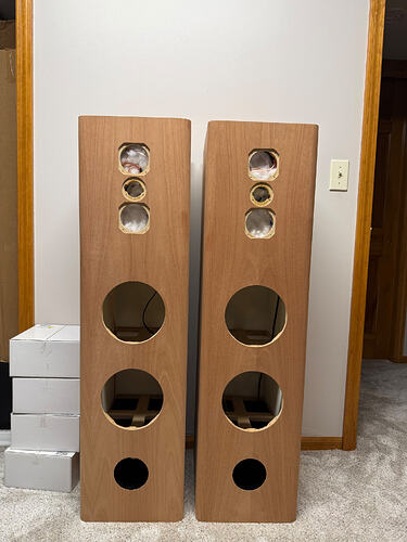

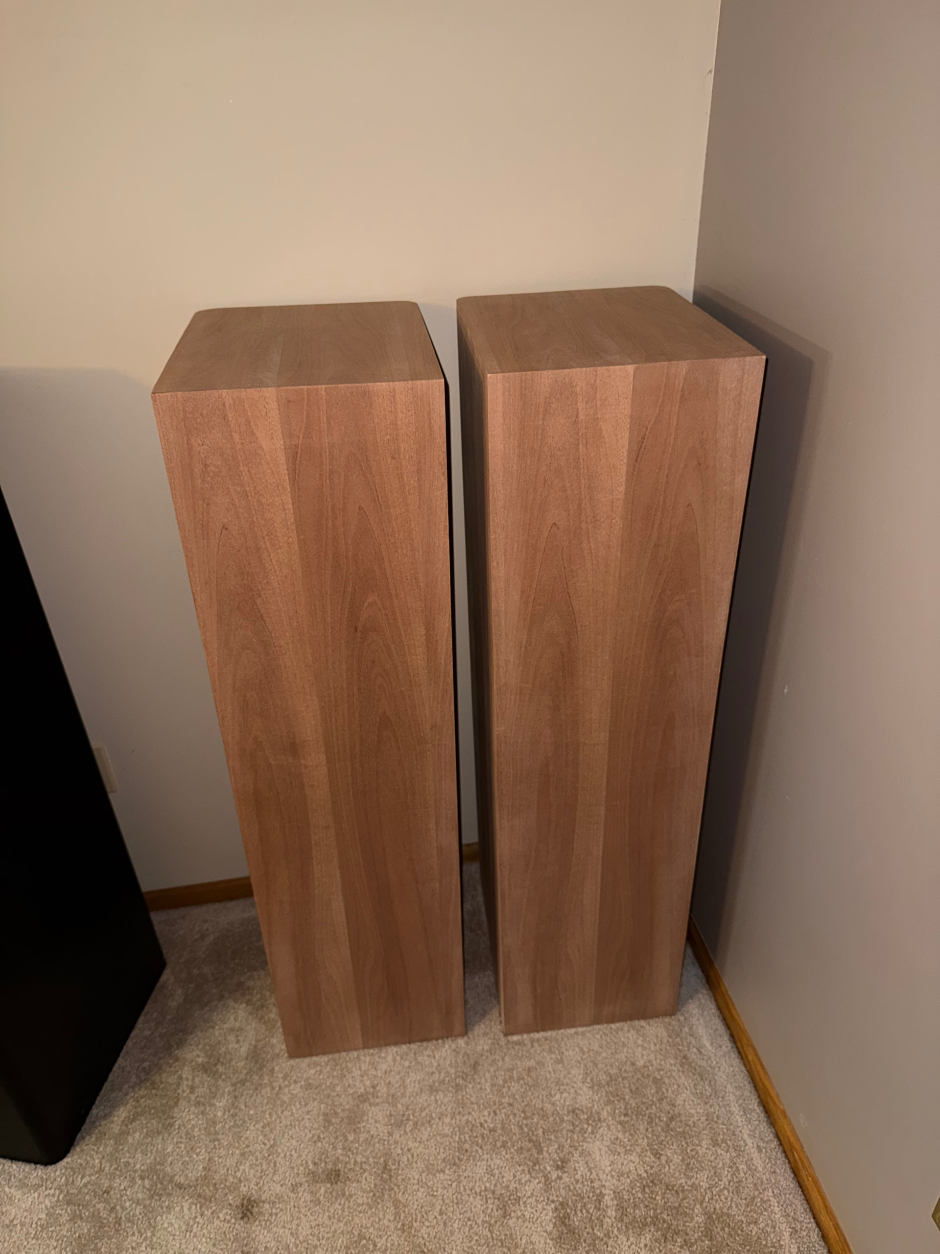

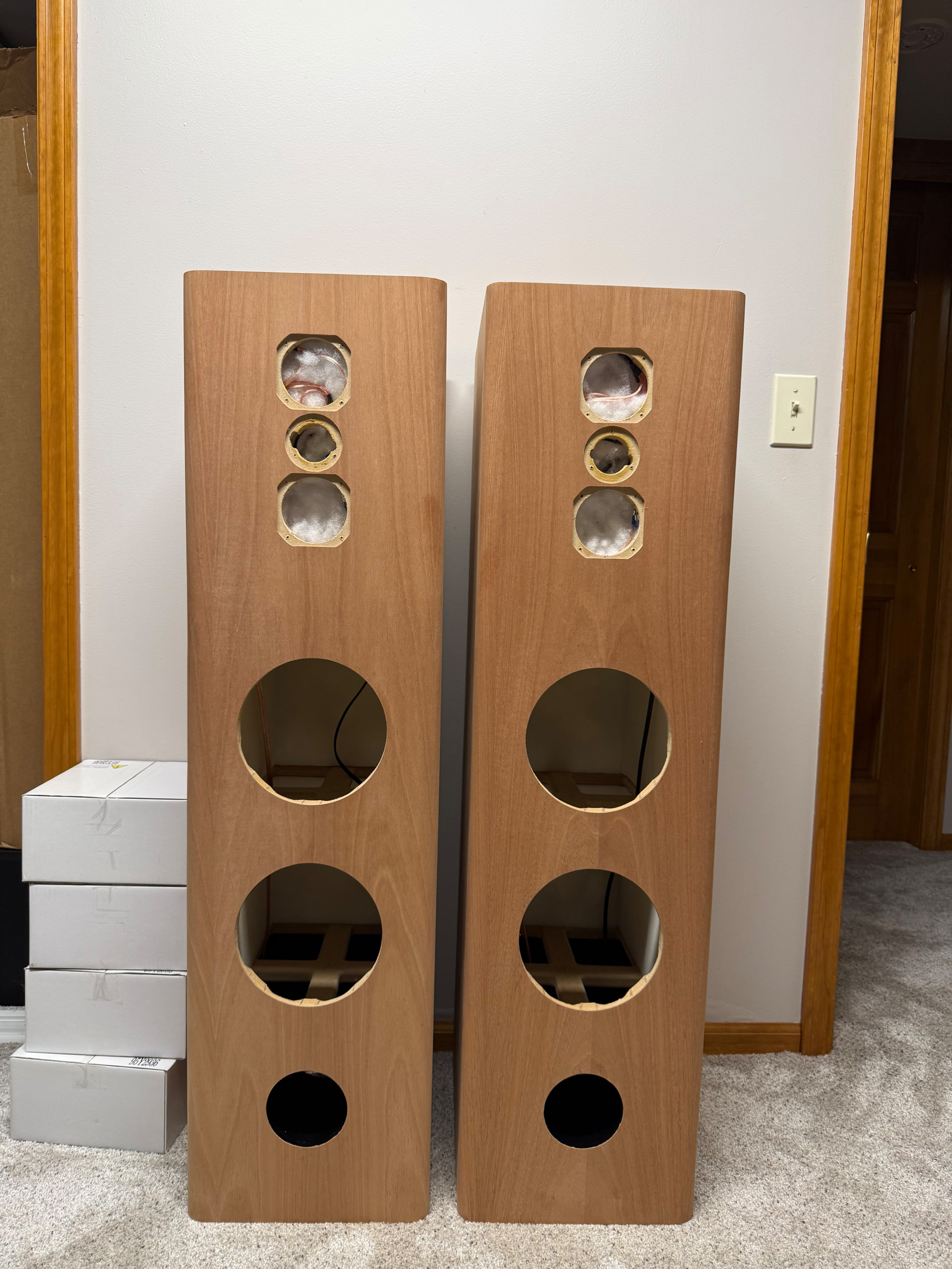

Finally working on getting the Peerless towers ready. Have the Mahogany veneer applied and edges trimmed and sanded. Still a long way to go. Will be a mad dash to get these finished by SDC.
Those are looking solid​:+1:t3:
Welp, they finally look like speakers again. Hoping I can final sand and get the Rubio MC applied this weekend.

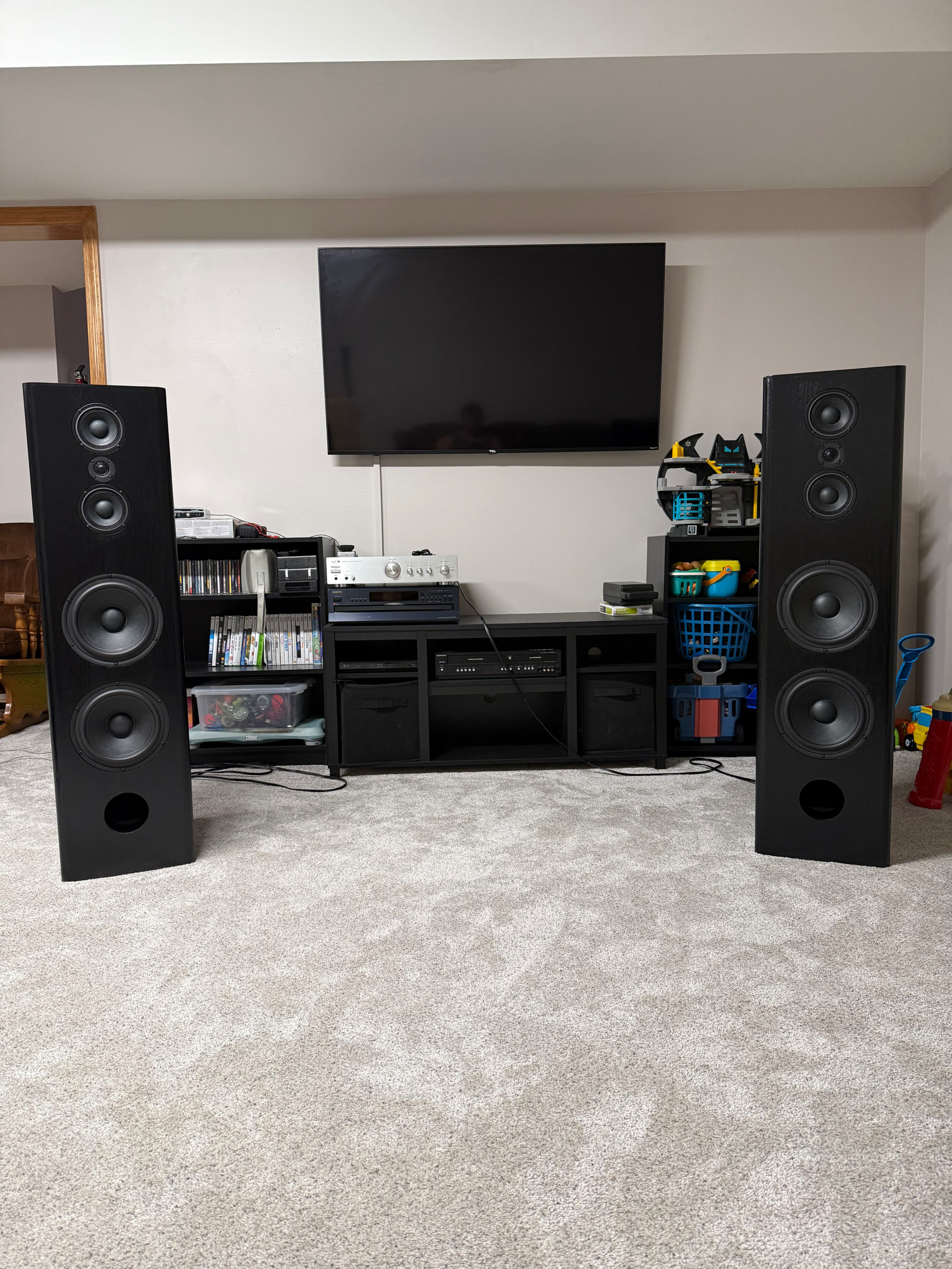

Classic 90s look! Black ash vinyl wrap. Love the look.

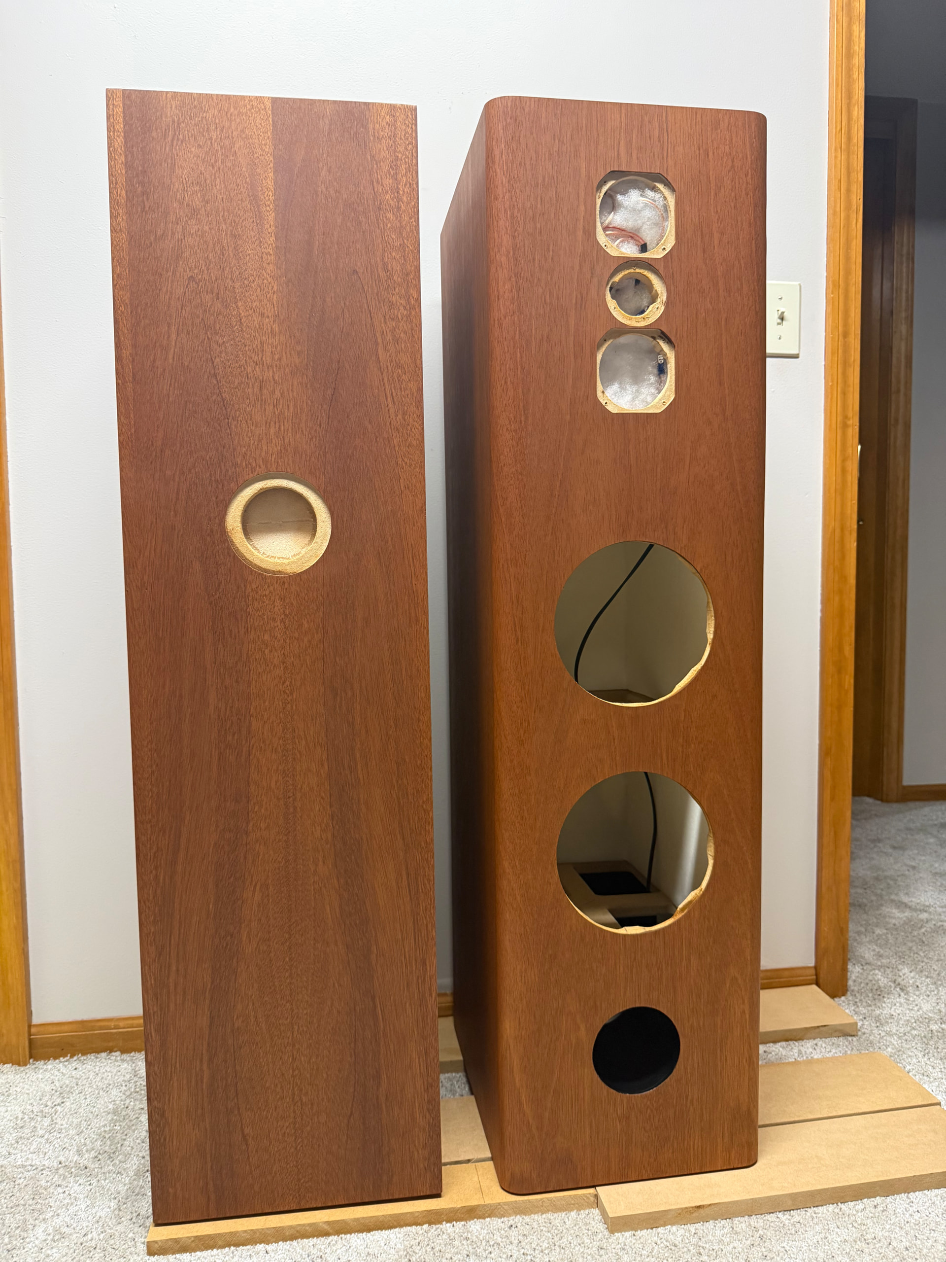

Almost forgot to cut the terminal cup hole before finishing them :rofl:
Rubio Monocoat, Golden Hour on Mahogany veneer. Reasonably matches the furniture in our living room. Process went MUCH better this time compared to last. Now I wait a week for it to finish curing, then hopefully next weekend I can start buttoning it up.

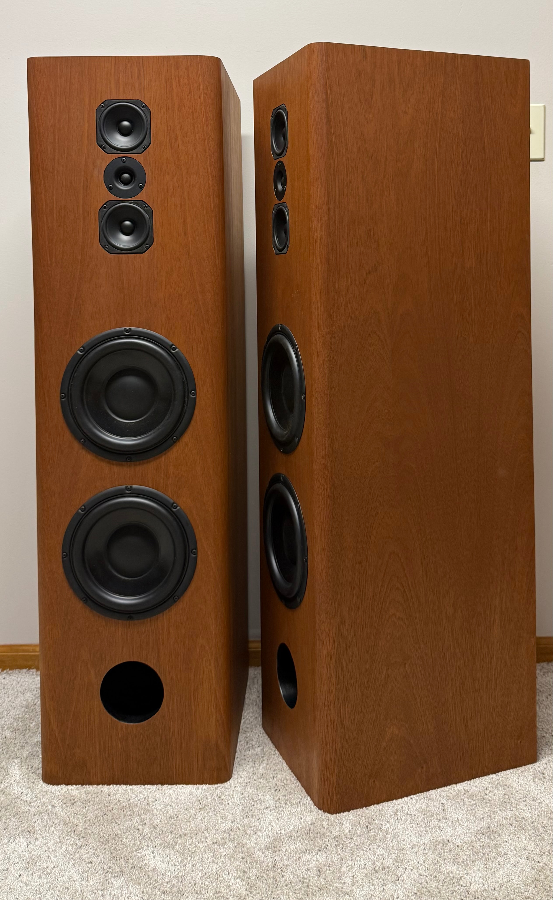

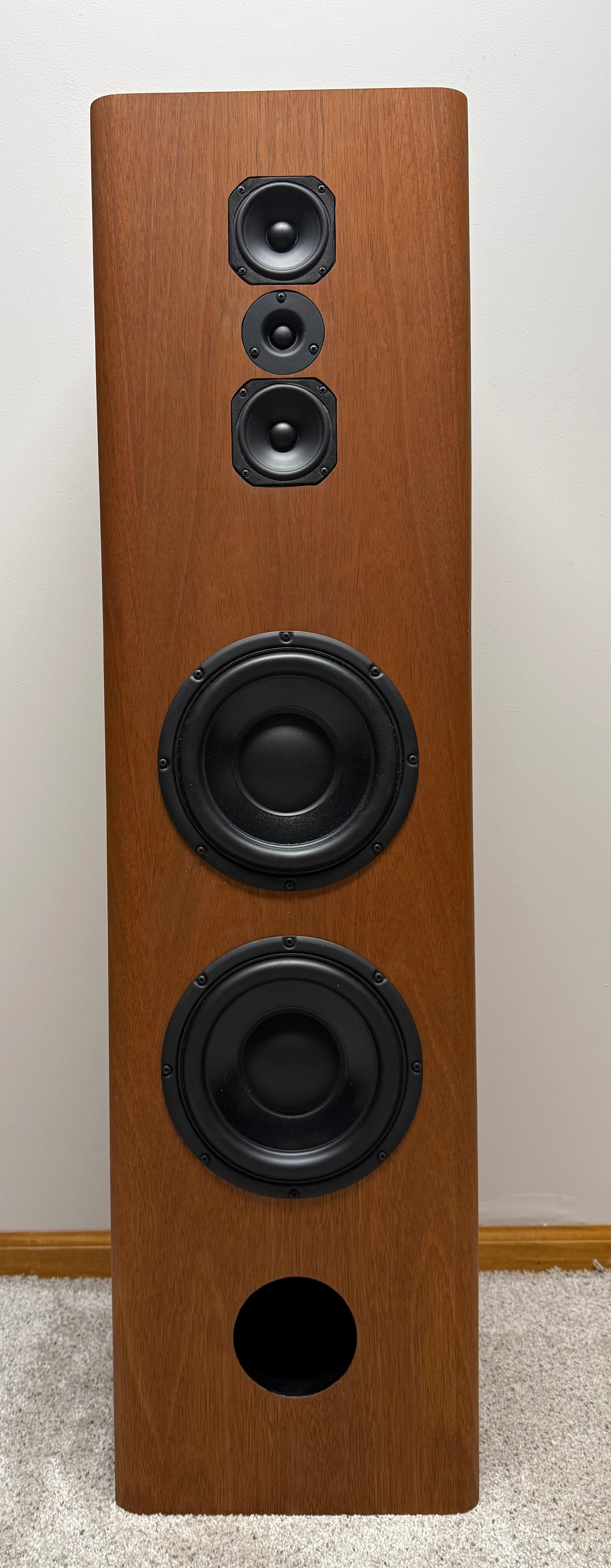

One down! With the limited amount of free time I have in the evenings, will probably take me 2-3 days this week to finish it up. Then one last measurement to make sure everything is wired right, and then enjoying them for a week and half before SDC
Aaaaaaand done! I think. Still need to measure but sound fine so far, 95% sure I don’t mess up final assembly

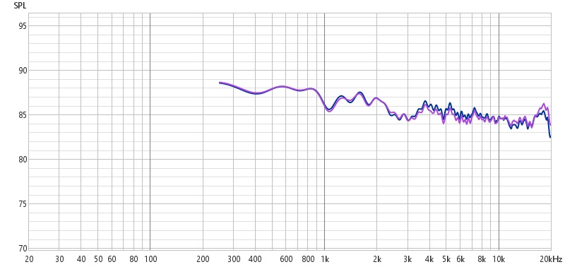

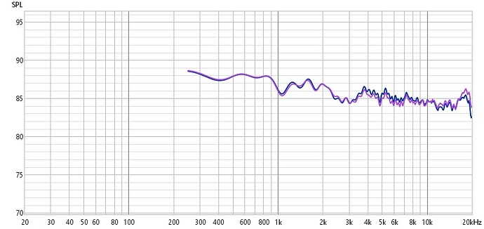

Left and right comparison of FR. Good matching between the speakers

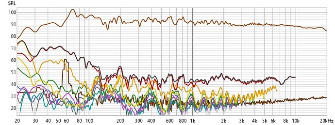

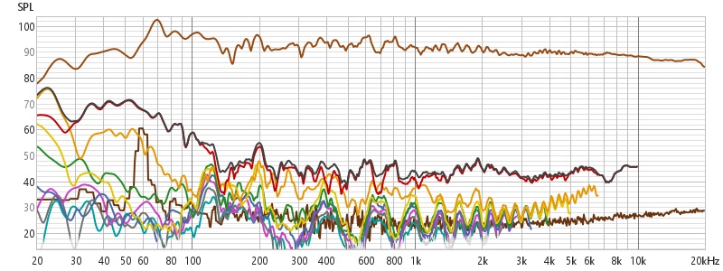

Distortion measurement 93db @ 1m. 200hz and above I’m under or right at half a percent, above 100hz it’s at or under 1%. Not bad for two $12 midranges and a $16 tweeter.

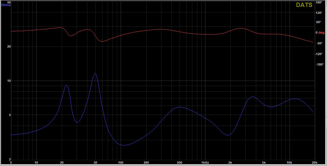

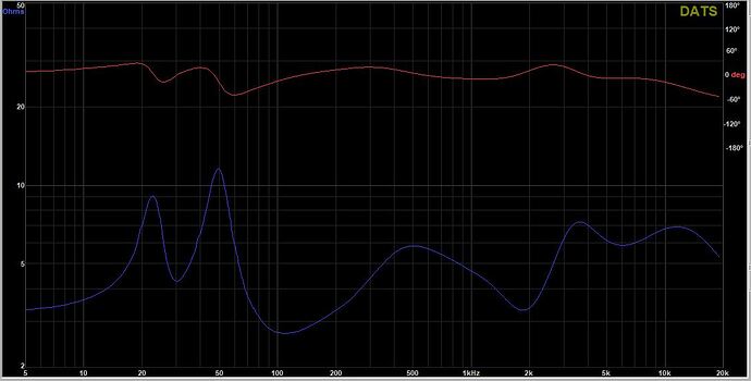

Impedance. Only dowside is they do briefly drop to 2.7ohm but I don’t think most amps will have a problem with it
