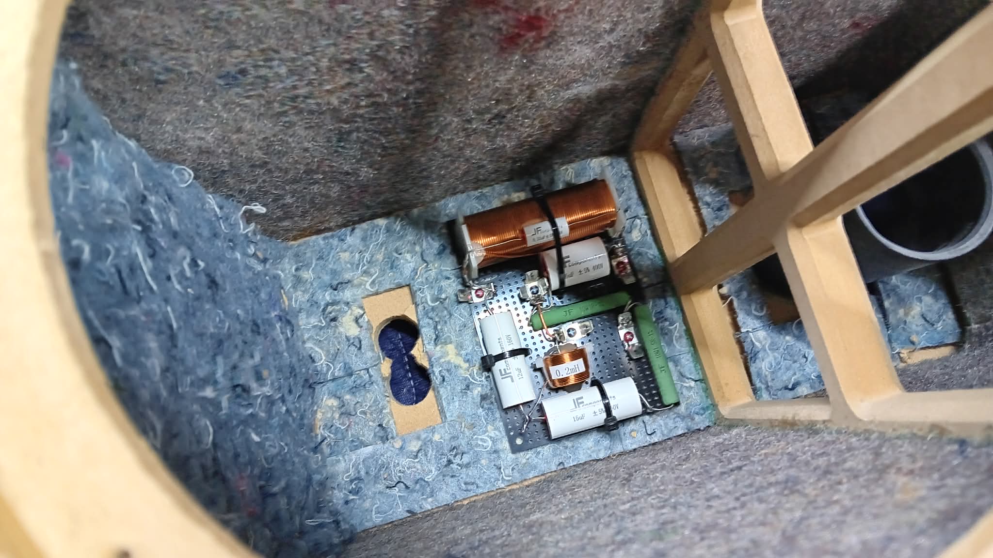

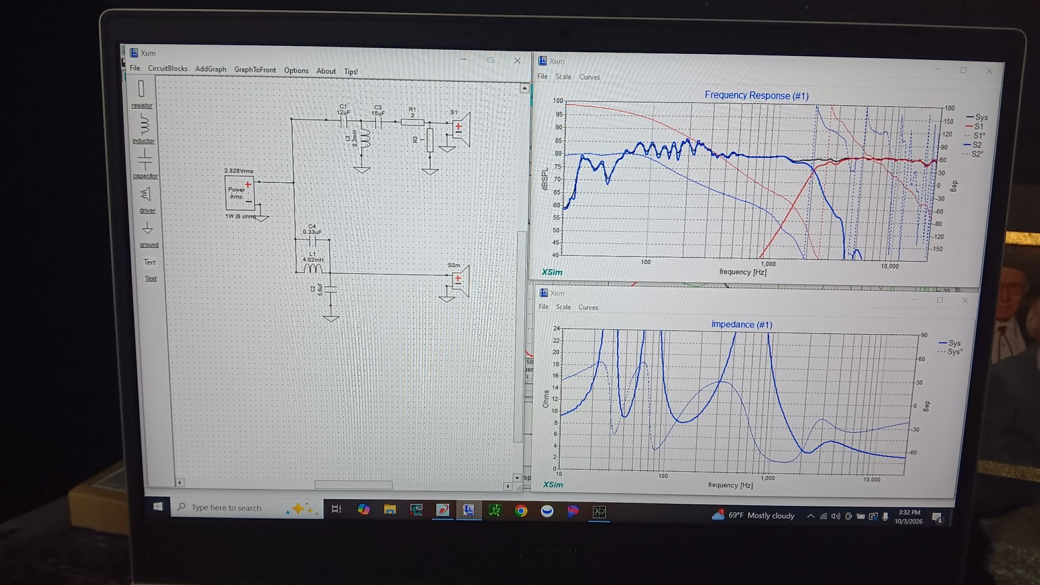

To anyone building these though I’d recommend a 3 or 4 ohm resistor in series with cap C4 (the notch cap on the woofer). As these are wired now it’ll present a short to the amplifier in the ultra-sonic region. This shouldn’t be a problem with a well implemented amp (IME) but some can emit ultrasonic noise and would likely have issues with the load presented by this speaker.
If I do end up making this a kit. I will implement that resistor in there like I had to do with the YTMac05 kit.
