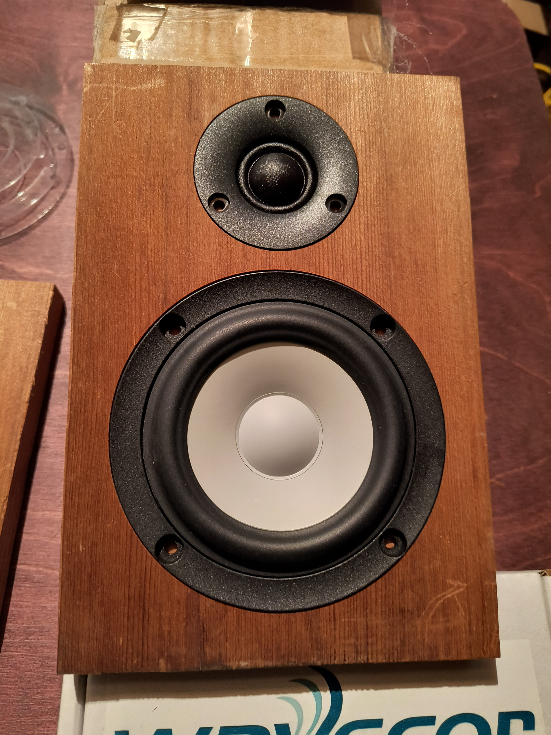

Coming this fall. This project could wind up as “how to pay too much for the Chachos” - but parts are on hand and I have some reclaimed redwood siding from my parents old house that needs a new purpose. A baffle was cut this weekend, so here is a sneak peek. Drivers are SB Acoustics SB12CAC and a little Wavecor TW22 tweeter.

Oooooooh, that should work out nicely!
Great Lil midbass!
So my Chachos are now your “standard”? Got it, cool!
Love that tight grain

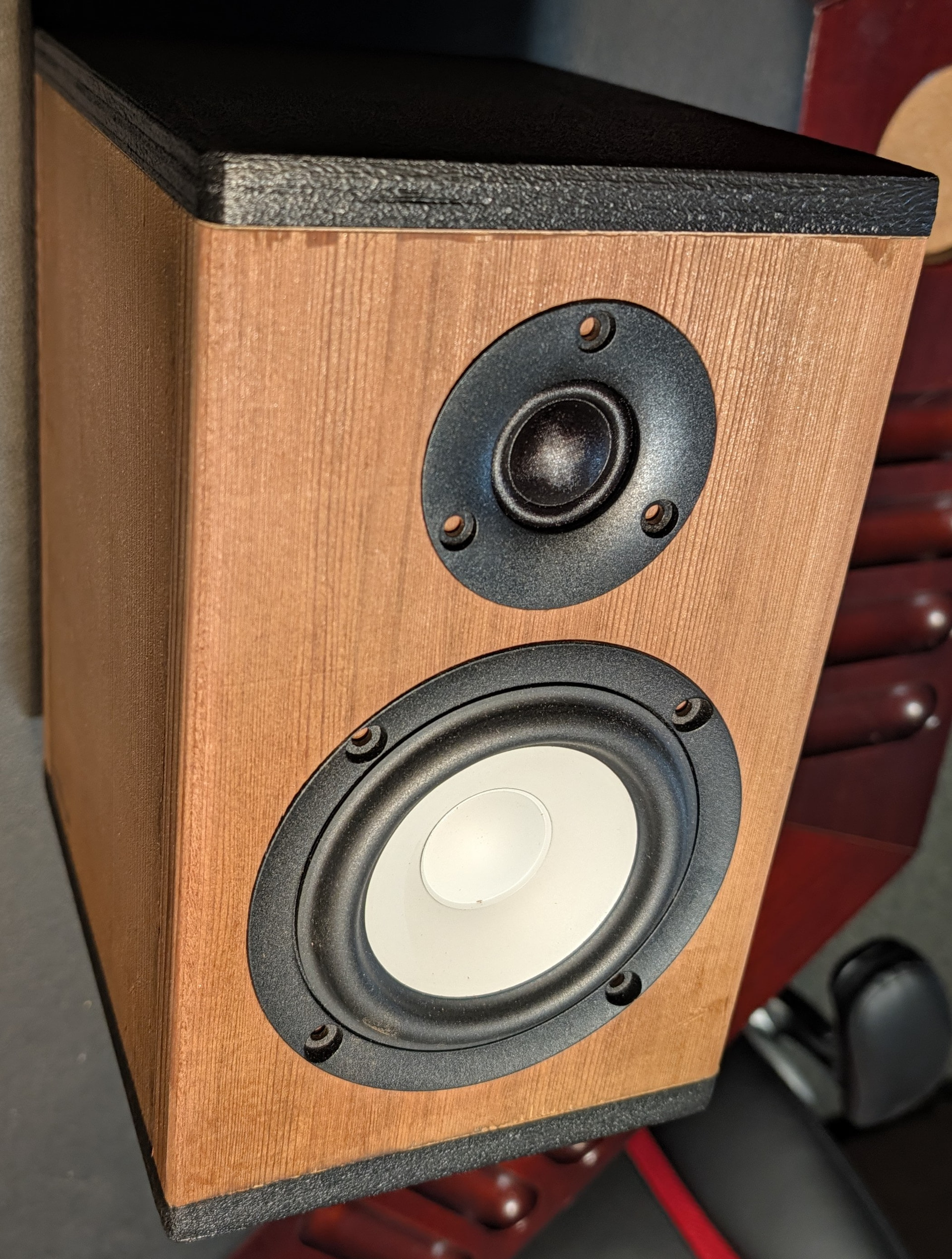

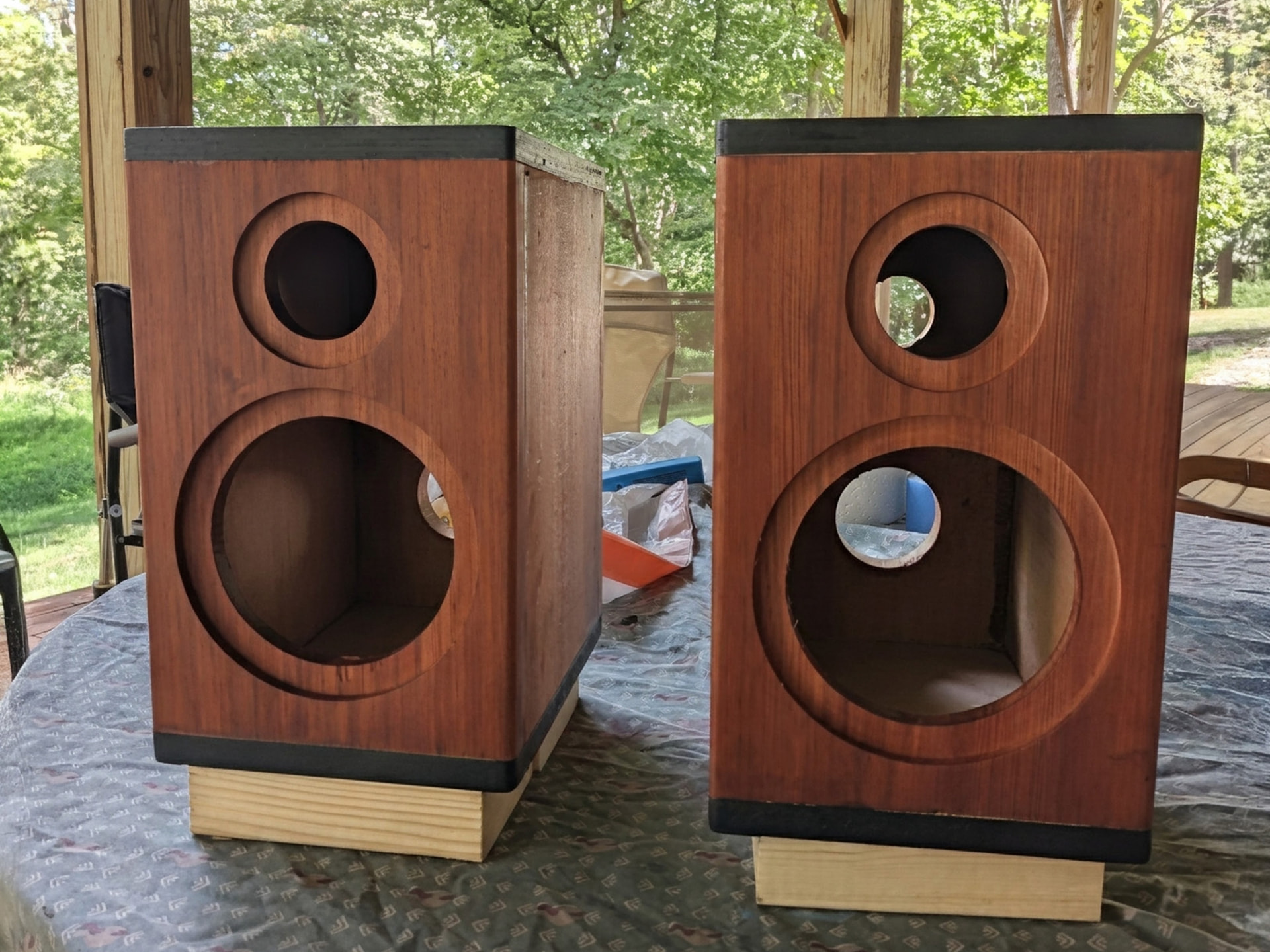

Making some cabinet progress.
Oiled up.

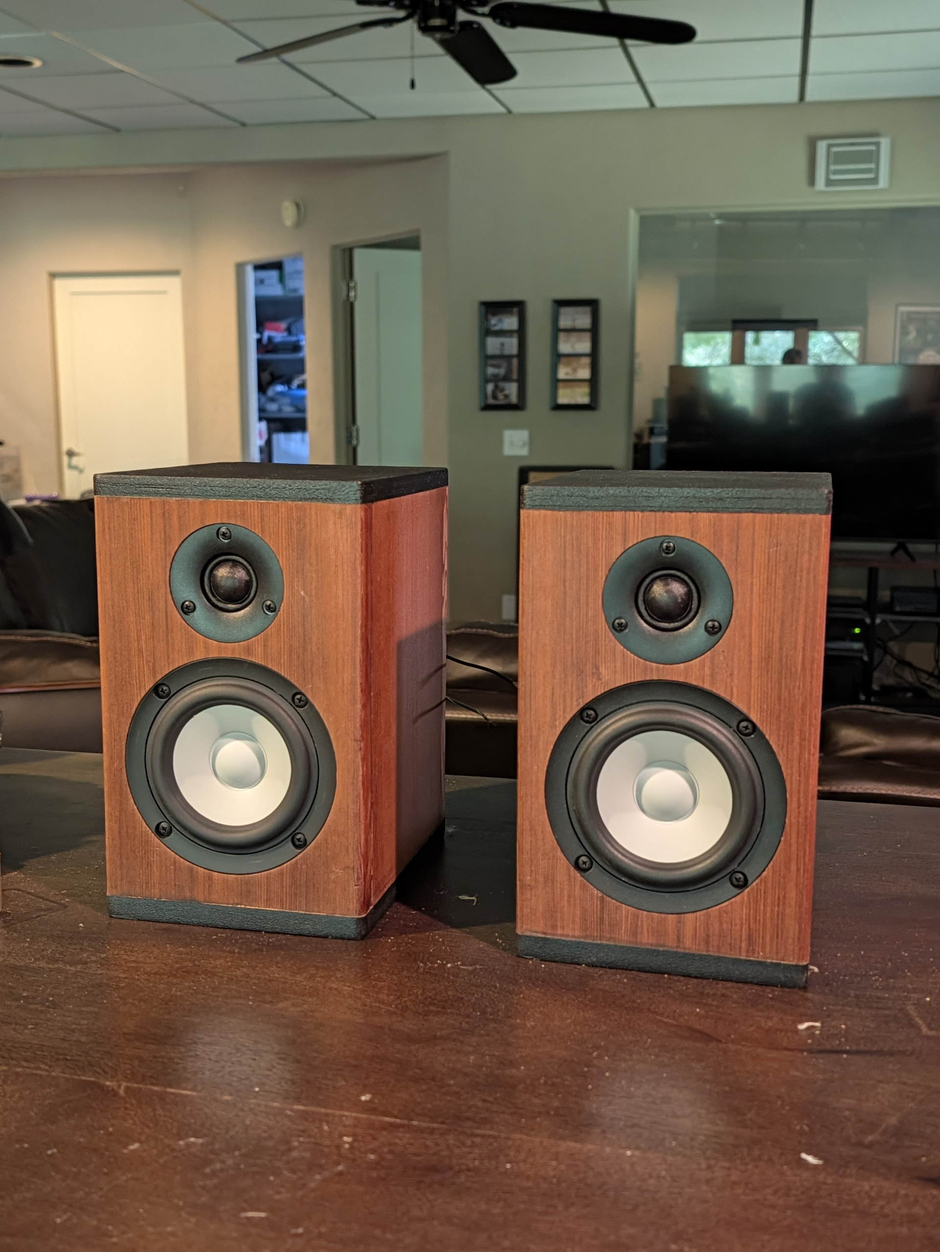

Ready for measurements and crossover work.

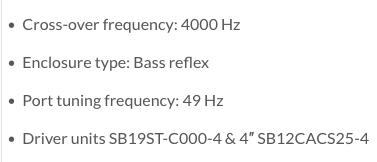

I dug into the dimensions and tuning on my freelance Micro-C’s vs. the kit version. The prefab cabinets for the kits look to be 0.1 cu.ft. and are slot ported. Key points:
I chose to follow Madisound’s recs for the SB12CAC and built a 0.15 cu. ft. box with a 1"x3.5" round rear port for a tuning of ~58 Hz. XO has the same values as the kit, from parts on hand.
