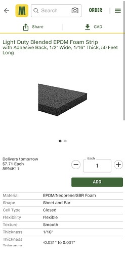

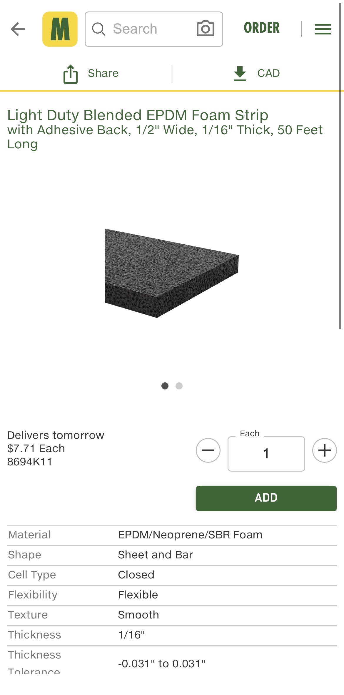

Then depending on how ugly it is and if it matters to you, a layer of 1/16" neoprene foam tape could dress it up a bit.

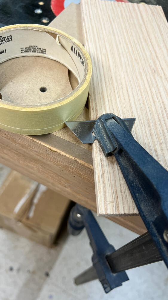

Sounds like a perfect excuse to make a quick little jig!
Very nice !
