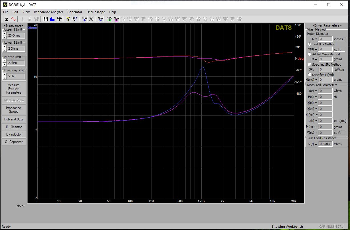

I’m not sure what’s going on at PE, but getting a pair of decent tweeters has not easy. A few years ago it was the ND28F-6. I ordered 2 and they didn’t match. One was close to the spec sheet. They sent me another one and it didn’t match either of the original pair.
I ordered 2 of the silkies last month to build JR’s latest Cabrini design and a pair of HiVi RT1.3WE to see if the aluminum SB woofer would work in Craig’s Keramiska design. All of them look wonky. I must have angered the gods of HiFi. I already have a ticket in the works for the silkies. I need to get some more measurements of the HiVis before talking with them about those.

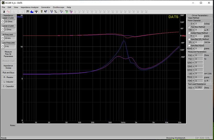

Here are the DC28Fs after break-in with pink noise for 26 hours
I realize this could be obvious, but have you re-calibrated your test leads and impedance in DATS? (I only ask, because I have got some weird results before and that was the reason.)
I ended up ordering one extra and all three were close enough below 10k. Looks like one of yours might have a leaky faceplate or something.
Yeah - I did calibrate the DATs a few days before. I’ll do that again and see if anything changes.
I didn’t even think to check if any of the screws on the faceplates are not tighten properly. I’ll look into that.
Checking the back cup on that tweeter would be worth checking as well.
Recently I had a tweeter doing something simalar and I pinched it from back cup to faceplate and worked my way around untill the impediance responce changed. For me it was a leaking gasket on the back cup.
Re-calibrated, checked that screws are tight and clamped the back cup in various places with my hand - still the same dip in Z.

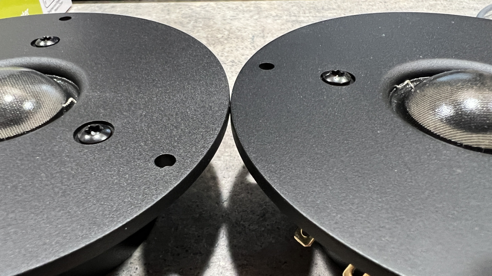

Follow up report - the replacement Silkies were delivered today. Even without any break-in, they are pretty much spot on. I was comparing the first ones to these and notice the faceplates are slightly different. The new ones have a very subtle texture, while the out of spec pair are more matte.
