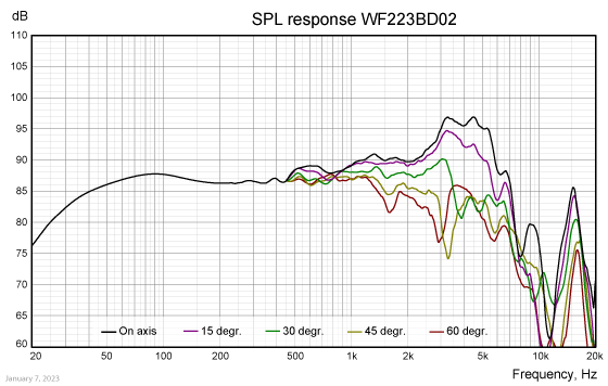

Just be aware that the graphs changed from 2015 to 2023 - be sure of what vintage driver you purchase by asking for the date of manufacture from the vendor - very different break-up modes.
This one is from 2015 → Wavecor WF223BD02 - 9″ Woofer 8Ω
Yours above is from 2023.
Same looking impedance though . . .

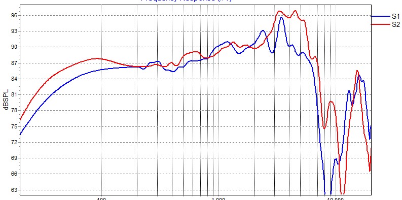

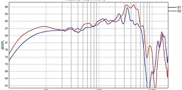

None of the BD02’s parameters changed when you compare Wavecor’s PDFs from 2015 and 2023. They only added some “after burn-in” parameters in 2023 that were blank in 2015. It’s strange the SPL measurements would change then. Looking at Wavecor’s SPL files, I would tend to believe the 2015 results (blue) over the 2023 results (red). The 2015 version looks more like an infinite baffle response from a driver with Qts under 0.5. You could ask Wavecor.
If that indicates that breaking-in your drivers makes them smoother in FR then I completely agree and see nothing wrong with that driver.
Ed - Thanks!
Did you just model them from T/S Params and come up with that or what?
Wavecor has a SPL file for download in both their 2015 and current spec sheets. I just copied each file from its respective spec sheet and plopped them into XSim.
