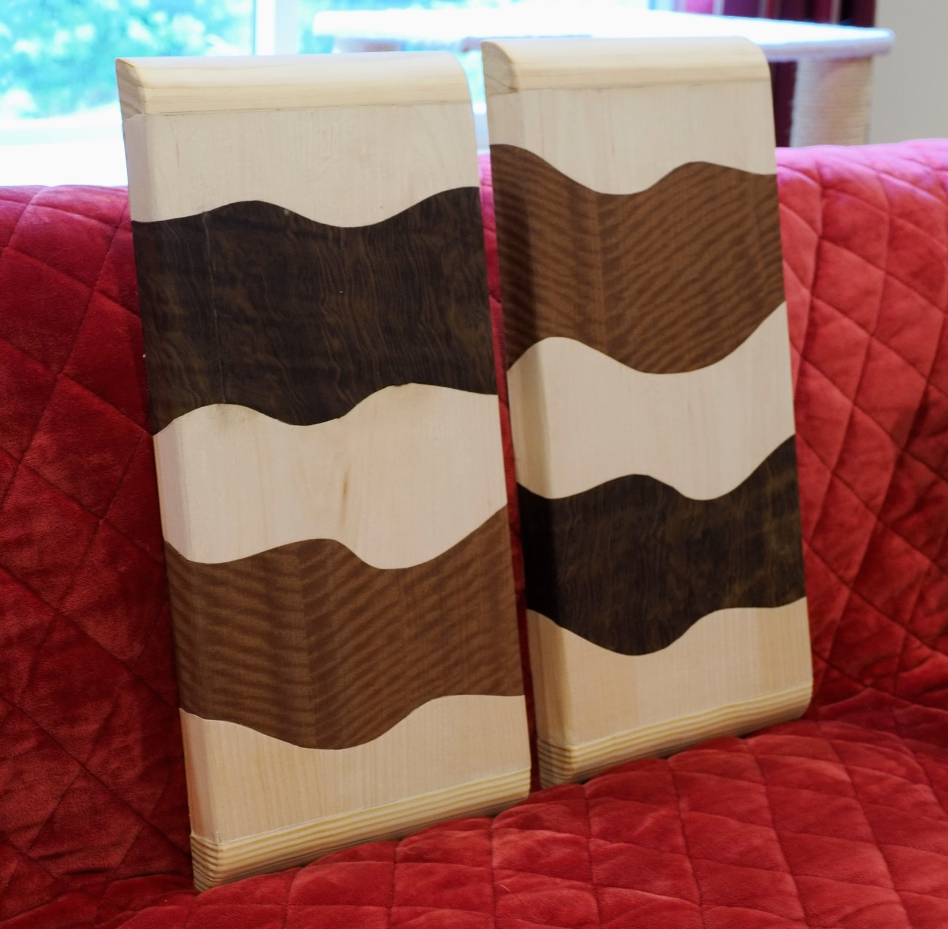

Getting all wavy gravy and topsy turvy curvy is all the rage in baffles.
I suppose I’m not trying to reinvent the wheel for the monkey coffin style, or with the grills. I’ve seen some wild engineered veneers that would be mega cool, but also possibly polarizing, and budget bending. I rooted around in my laminate pile. I’ve got some traditional walnut grain/color stuff, and a dark stained cherry looking stuff (along with alot of lighter color stuff). The walnut is my top pick sofar as I think that would contrast with the white and black best. But my wife has been doing alot of decoupaging stuff, which opens up my eyes to other possibilities.. Like the plaid mentioned.

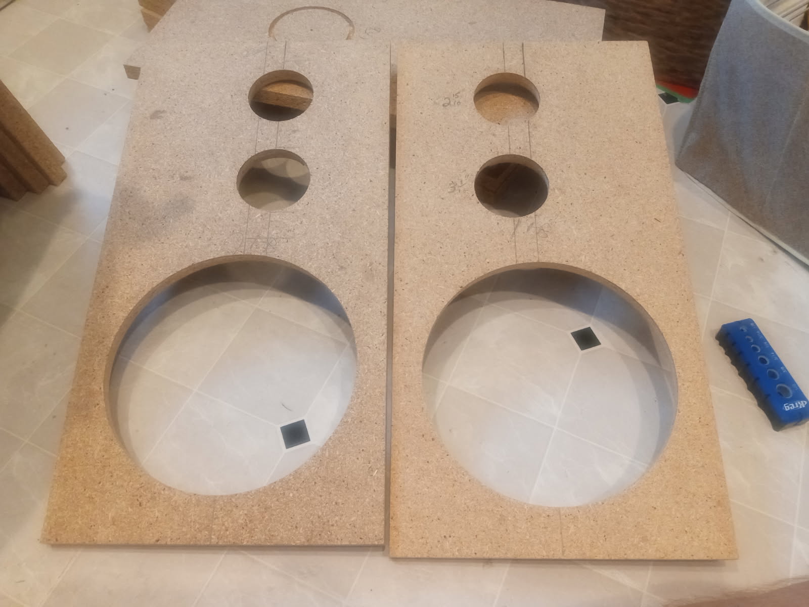

I marked up the baffle plates this evening for drilling the centers for driver cutouts and mid chamber rabbits. Slow going, as I’m suffering what seems to be “de Quervain’s tenosynovitis” in my back left thumb tendon/tendon sheath. Likely due to all the lifting of small ~40lb boxes of fasteners I’m doing at the new job (I need to stop trying to one-hand them). I started wearing a brace, trying to not aggrevate it… Been a constant annoyance the past few weeks, so I’d like to have it heal up.
Temps this afternoon dropped enough so it “feels like” only in the low 90s. So i convinced myself to drag the folding table outside and do some work with the circle jig.

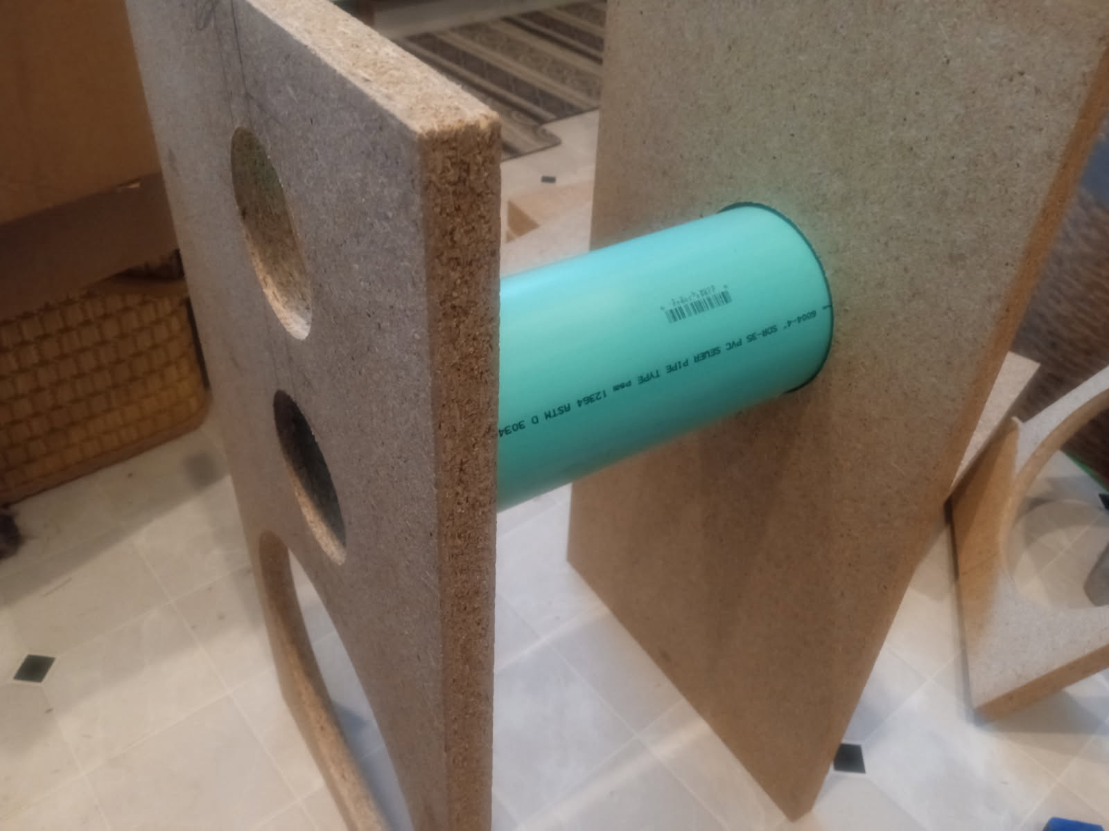

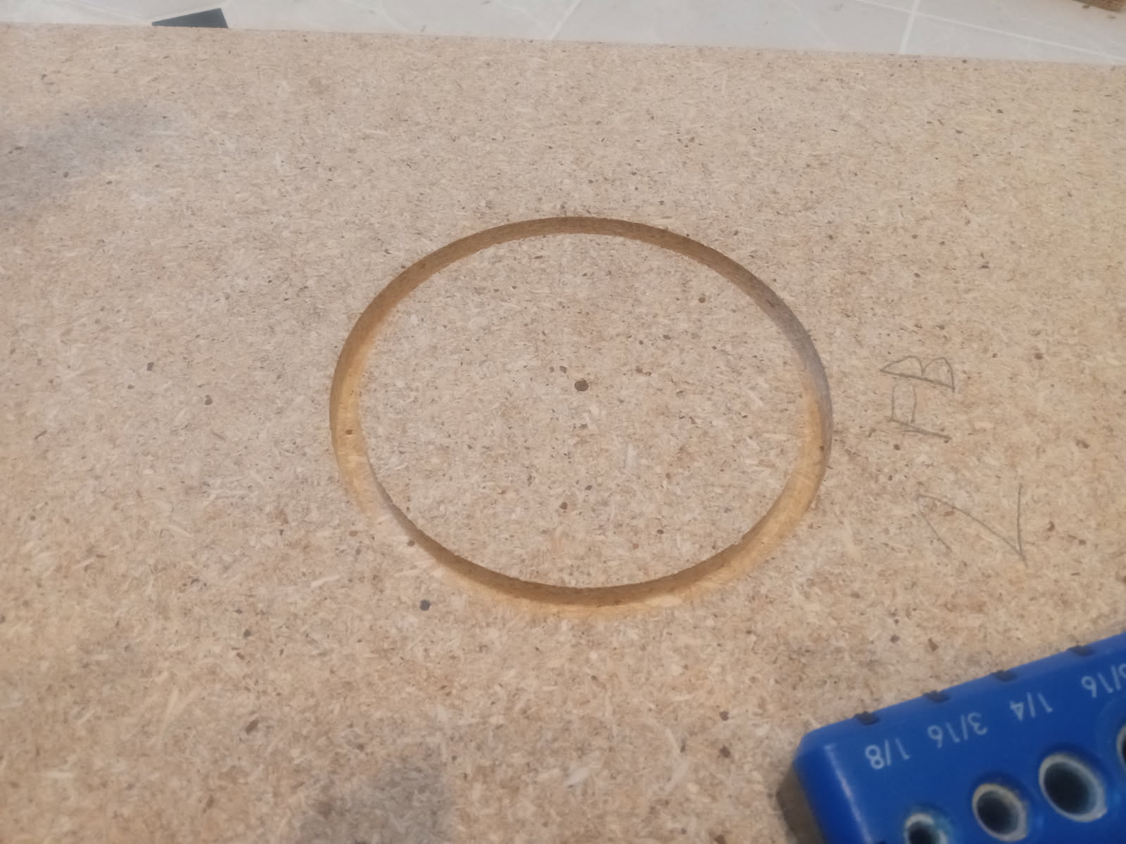

I cut out a rabbet of sorts to capture the 4" sewer pipe between the front and back boards.

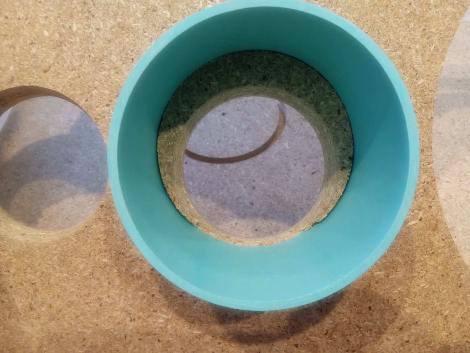

I used a simple drill guide, with an electric hand drill, through both boards to get the centers roughly aligned. The drill guide is not particularly tight on the bit so it can go off at a slight angle. Better than eyeballing it though. So I figured the 1/4" rabbet would be perfect for some extra tollerance on the ~1/8" wall pipe… Allowing the boards to line up properly at glueup, and gives some squeeze out space for the silicone I plan to use as the adhesive/sealant at the pipe joint.
Mid chamber aligned off-center for less induced resonance.

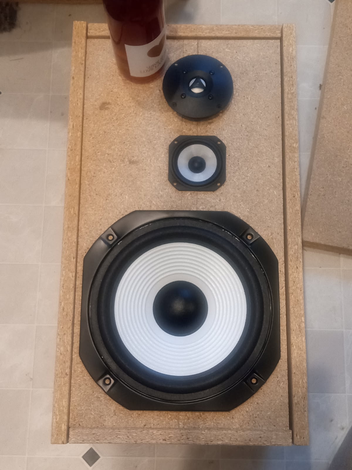

Forgot I’d need to cut out relief for the tweeter terminals, so it is perched on the terminals in the pic. And the wine bottle is providing counterweight to balance out the woofer weight teetering on the mid chamber pipe. But you get the idea :grinning_face_with_smiling_eyes:
I still haven’t convinced myself it is worth the risk (of me screwing it up) to trim flats in the tweeter flange. The terminals are not off at angles so there is not a whole bunch of gasket space left to seal if I cut flats. And I’m not adding back cups just to seal the tweeter space. Who do you think I am? :wink: Though I could meet in the middle and cut the top/bottom since the terminals are off to the sides. It would sort of carry the truncated theme while leaving an interesting difference.
I would vote “no”. It looks fine as-is and it seems the chance of messing the tweeter up is pretty high.
Yeah if it were an easier face plate to remove, sure. That one seems iffy.
Yep, probably going the path of least resistance…
