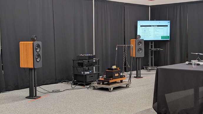

“FST Tower” speakers by Mattp. (aka “Continuum mid 3-ways”). These were the reference speakers used for level setting between categories during the competition. Drivers: Transducer Labs N26CR2-A tweeter, B&W Continuum LF27170 midrange, and Dayton RSS210HO-8 x2 woofers. Xovers: 500Hz & 3.2kHz. Cabinet volume: 1.8 cu. ft. Down firing port tuned to 28Hz. They sounded great from where I was sitting and impressed me as one of the best sounding speakers at the show. I think Matt should consider entering them in the competition next year! Here is the old PETT build thread on these for those interested in additional info: https://techtalk.parts-express.com/forum/tech-talk-forum/1497580-fun-with-fst-build-thread
Last year, Matt ran them for the judges and they gave him their thoughts. Being he works for PE, he can’t fully compete with the rest of us because he is an employee. That said, they are a very capable speaker.
Yep, I am not able to enter them but I am OK with that. Thank you for the kind words!

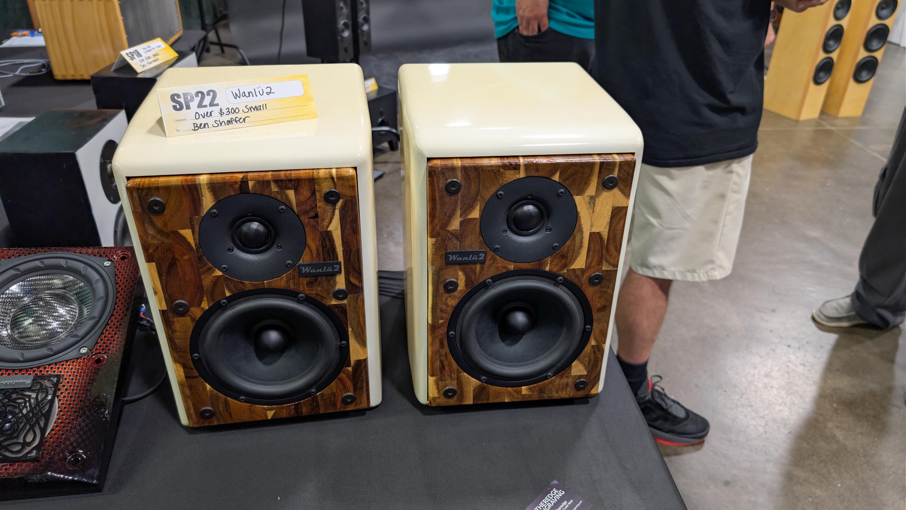

One of the best days in my speaker building life. The only thing Andrew Jones wrote on his judging paper was “The winner”. I’ll take that and run with it.
“Wanlu2” speaker by Ben S. @Wolf Over $300 small category. (SP22). Drivers: WaveCor TW030WA22 Graphene Textile dome tweeters and Misco Bold North BWX6501 Neo-XBL2 woofers. Crossover: 1.8kHz LR4. 12 parts with 2 notches on woofer. Sensitivity: 81-82dB.

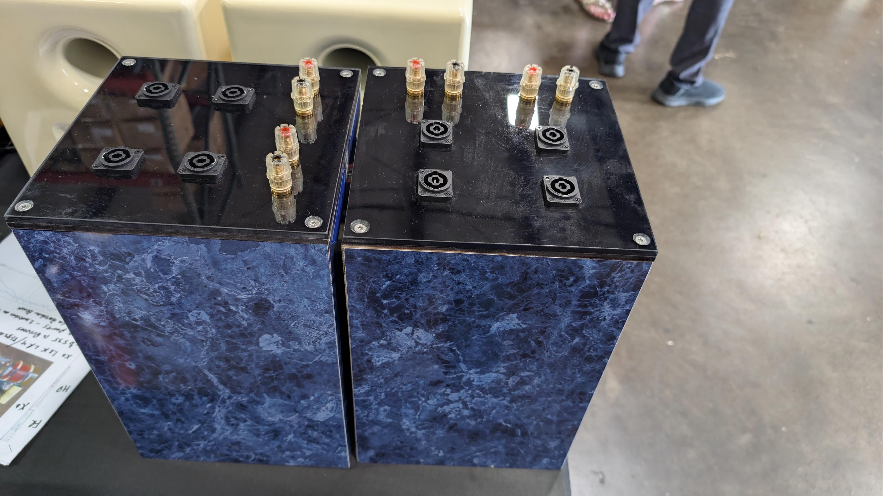

Crossovers are housed externally in a pair of blue formica “VersaCase’s” that have Lexan tops on them. These cases are designed to carry the xover parts, jacks, and wiring for 2 projects at a time. A very clever integrated system for fast changeovers on site. Just swap out baffles and then plug the drivers into the other pair of speakon connectors. Cool. :+1:

Pair of “Versacase’s” with xover parts for two projects:

These sounded phenominal. Nice job, Ben!

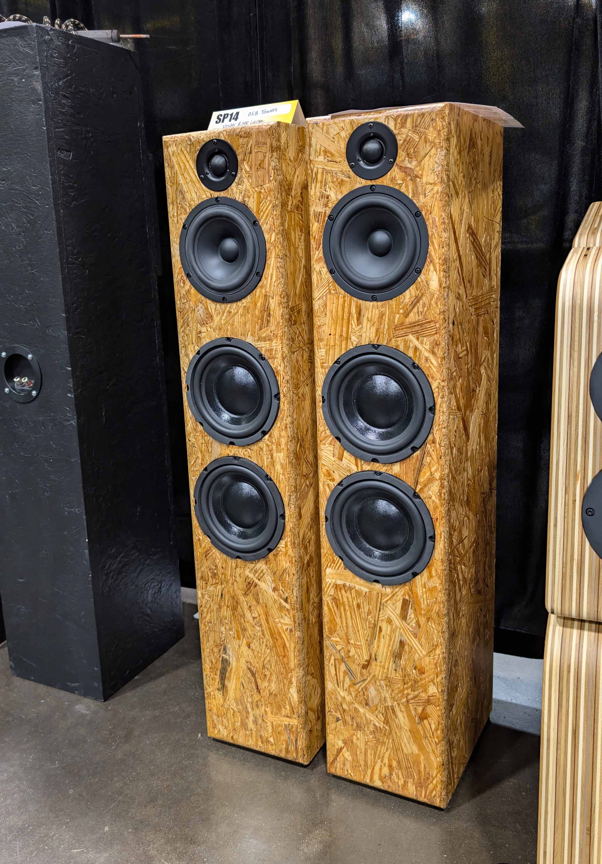

Pictures below: “OSB Towers” by Donnie M. Under 300 large category. SP14. This is a 3-way TMWW tower using a Morel KT-1 1 1/8" soft dome tweeter, an Aerial Acoustics AA-15NRXC60 5 1/2" paper cone midrange, and two Dayton Audio DC165 6.5" woofers. Crossovers of 255Hz and 1575Hz. Baffle is constructed of 3/4" thick OSB board. Sides, top, bottom, and backs are constructed of 5/8" OSB.
I bet those are sweet.

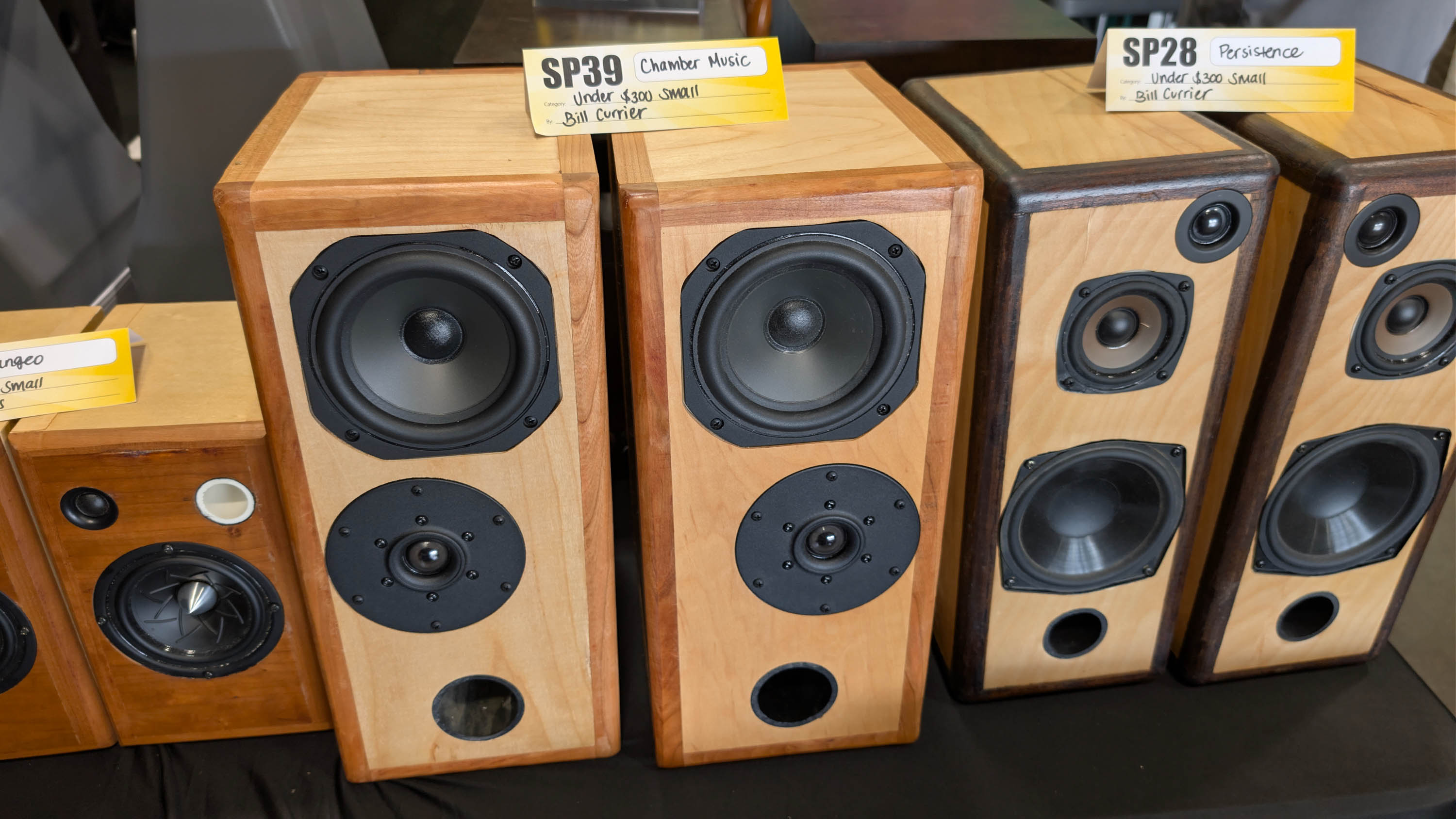

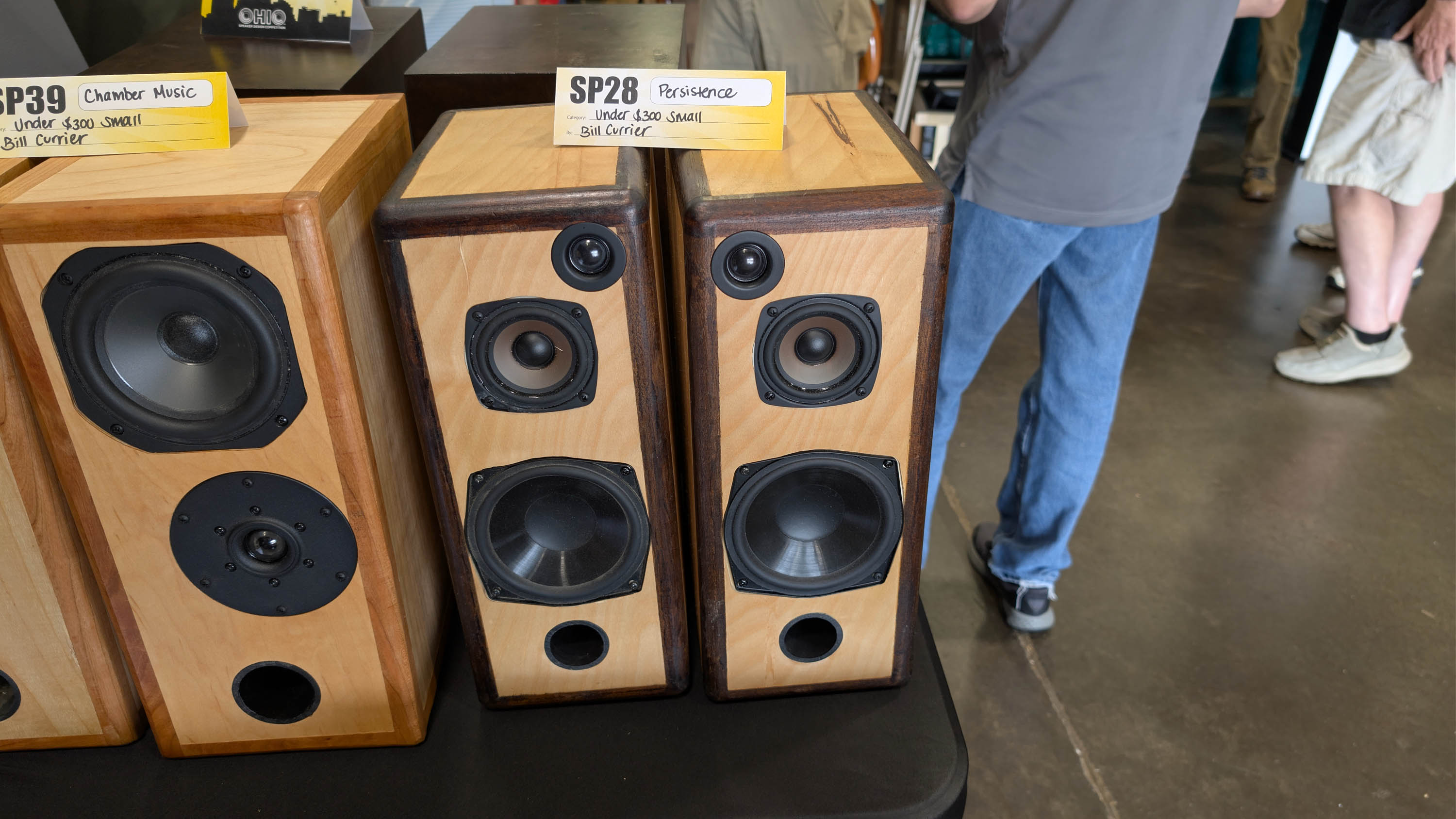

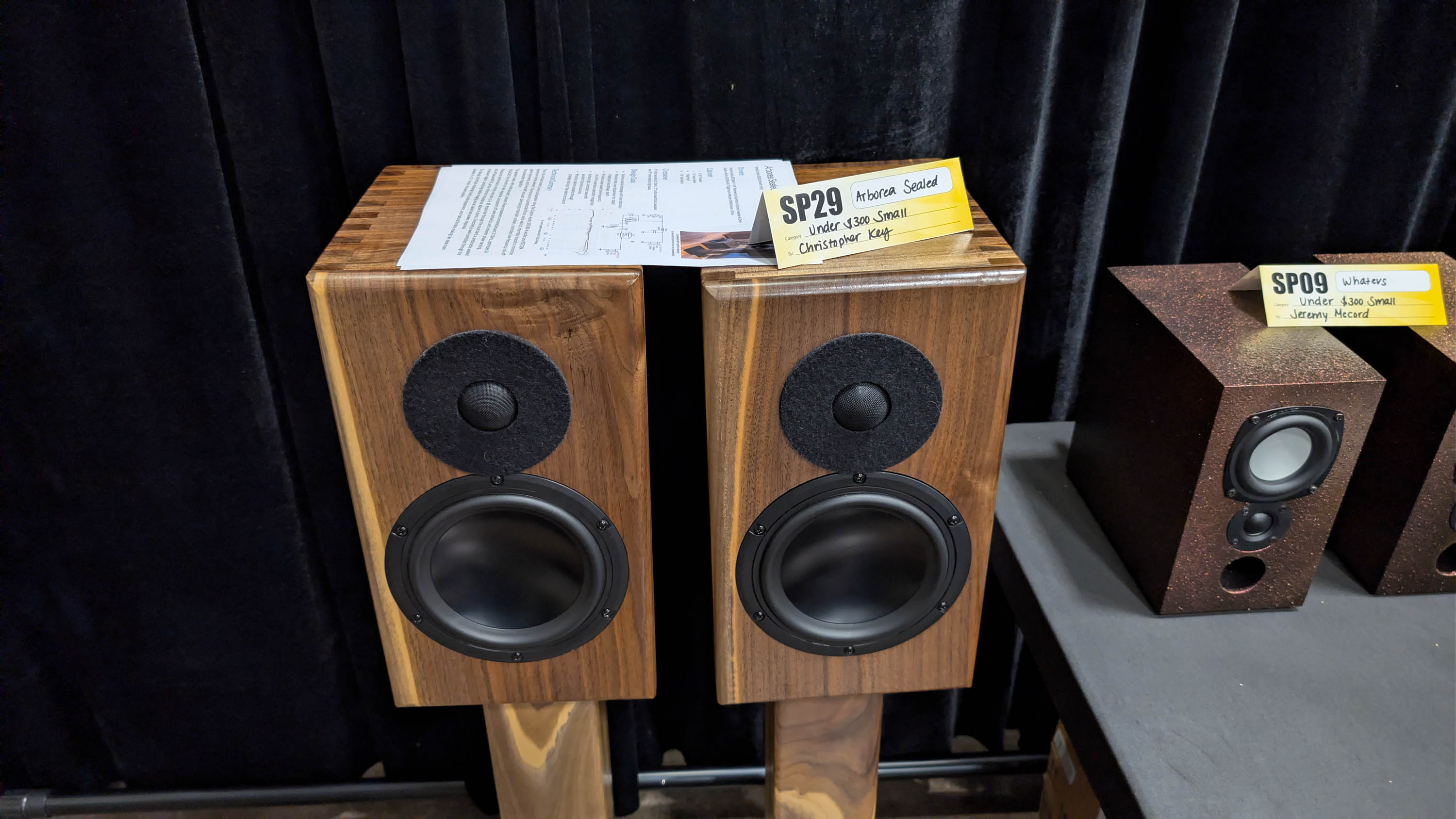

Some medium sized bookshelf speakers at the event:
The Tangeos and EDM’s were both very good!

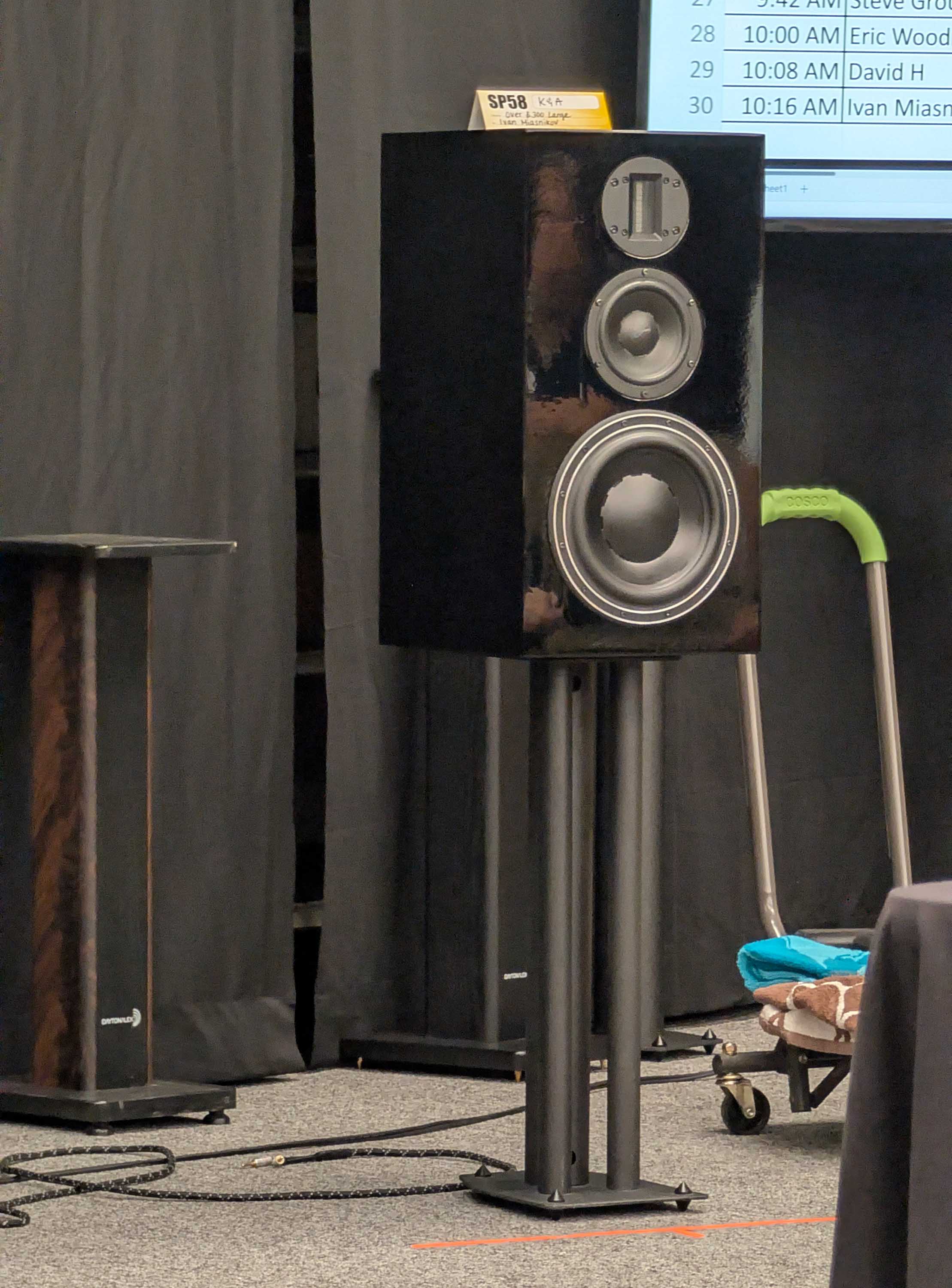

I don’t remember seeing or hearing these? Is that a home brew coax? I thought this was another coaxless year for Mr Jones​:face_with_tongue:

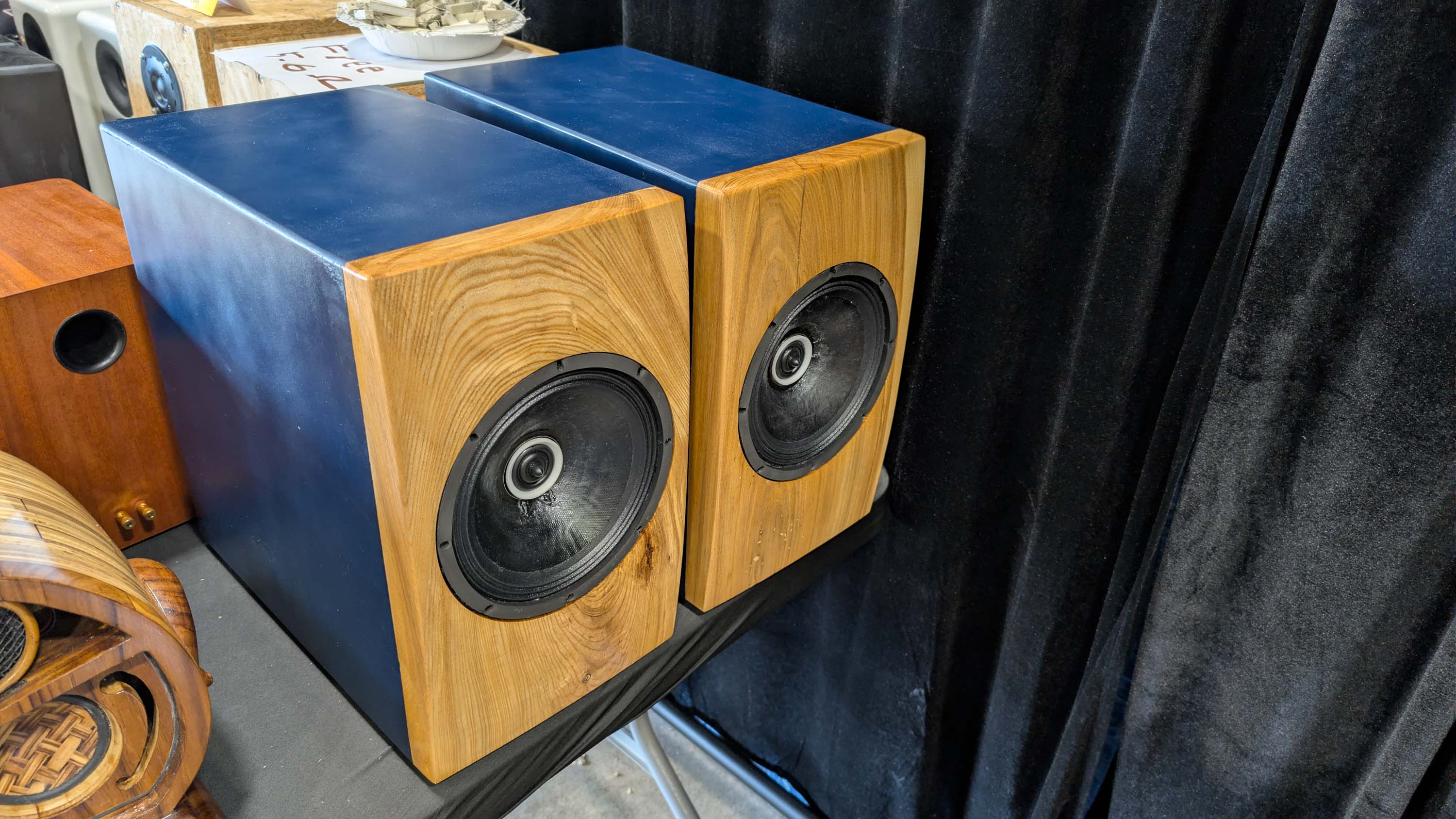

Crazy…I just got that same blue faux-leather for a quick project. I guess great minds think alike!
